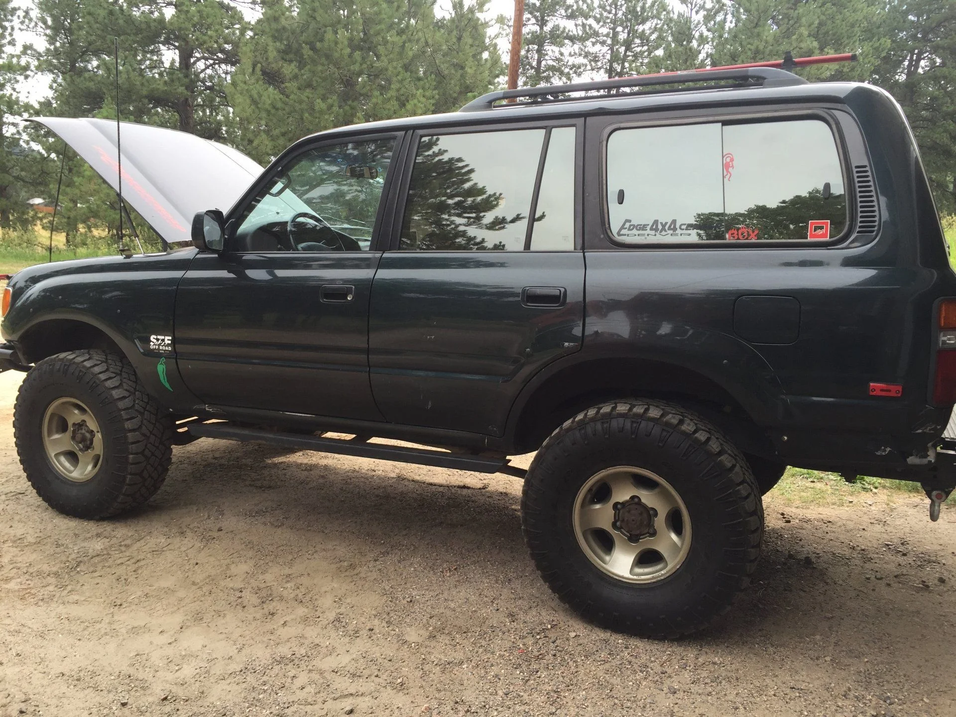

Installed Roger Brown's 1" body lift on my '93 FZJ. Huge thanks to @IronYuppy for the great installation write up here. I do have a few friendly amendments I'll offer to that installation write up to keep the thread together.
The lift did exactly what I needed it to do: 1) create a gap between my sliders and the pinch weld to get rid of a massively annoying slider squeak, 2) give me a little space above the cats to slightly reduce the heat in the cabin, and 3) get the lift exactly where I want it. I'm running OME heavies and a 1" spacer in the front with a fairly light BumpItOffroad tube bumper, and OME mediums in the rear with the factory bumper. The body lift takes me to right around 4" of overall lift; just right for my tastes and needs.
Hood is up because I'm chasing a bit of a short that's killing my FL Power fuse, but here is how the rig sits on 315/75 Duratracs. As far as the lift goes, I'm now done.

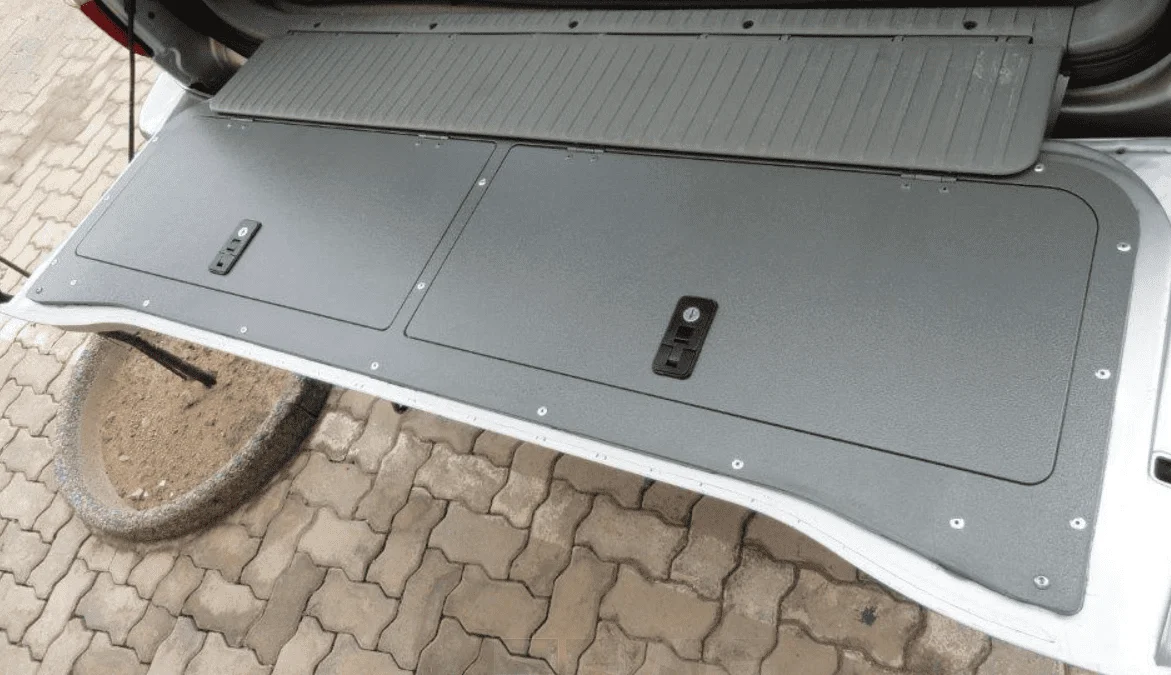

@reevesci add me to your list as well double lid!!
Dammit! What did i miss, what is the double lid thing you people speak of. I missed it somewhere in here. Do I need one too? :lol:
YES
It's pretty cool. It's on page 1070.
Or maybe it was 1082.
Or was it 1043?
I can't remember now. But it's freaking awesome. We'll tell you about it later.

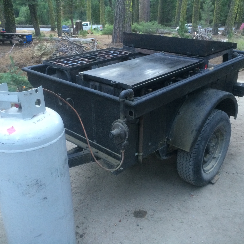

Is that a water heater inside your trailer?
