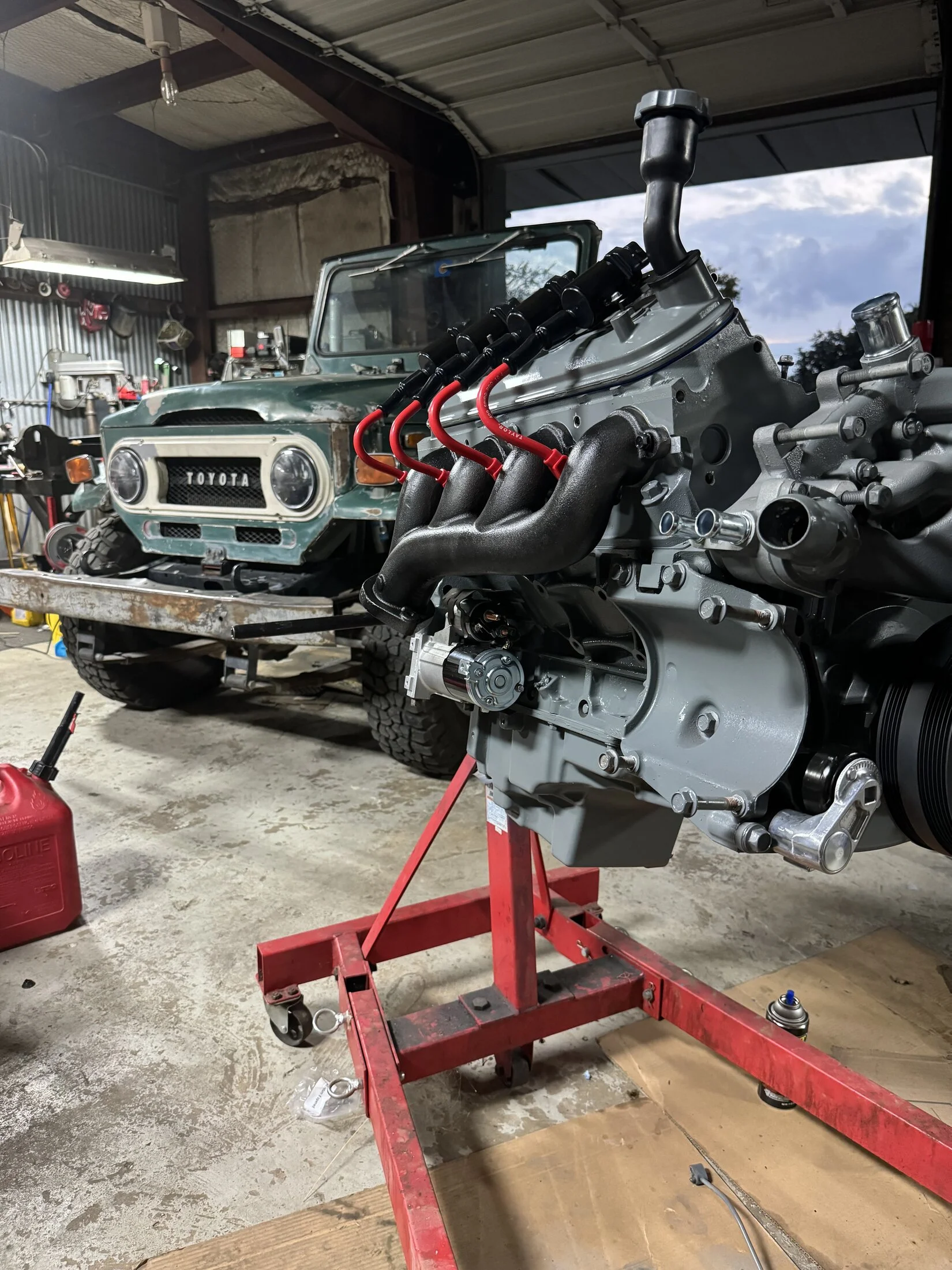

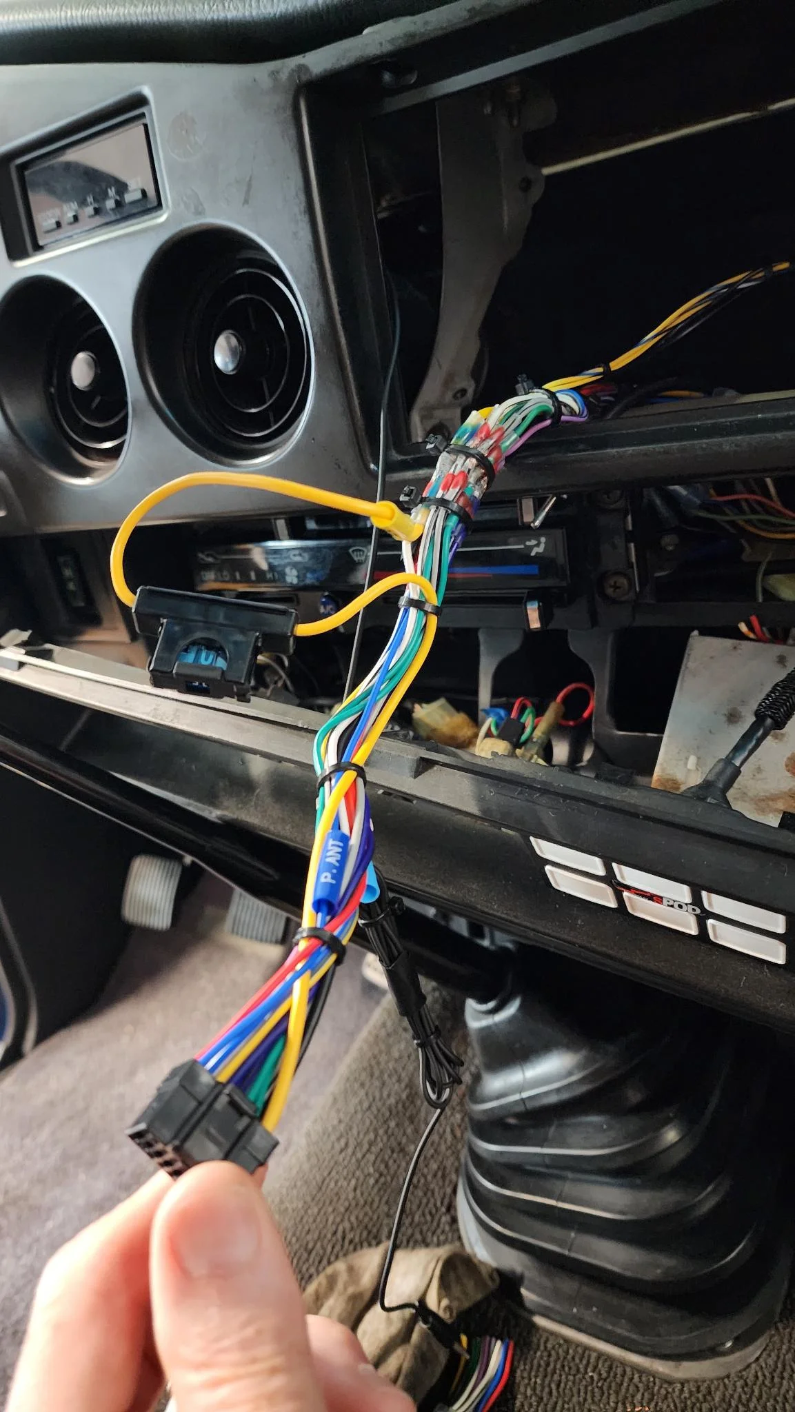

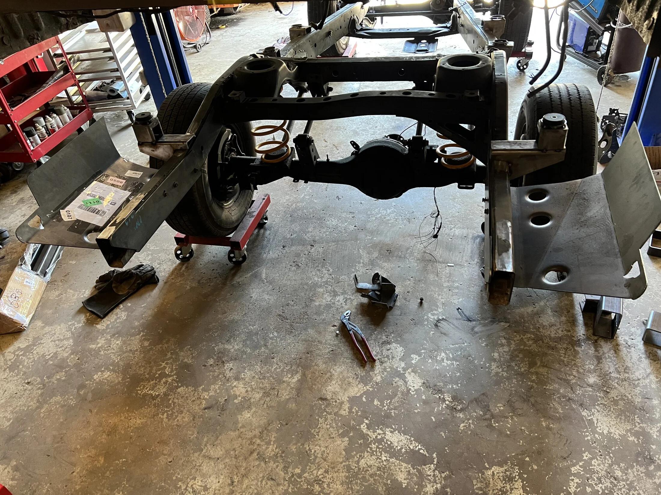

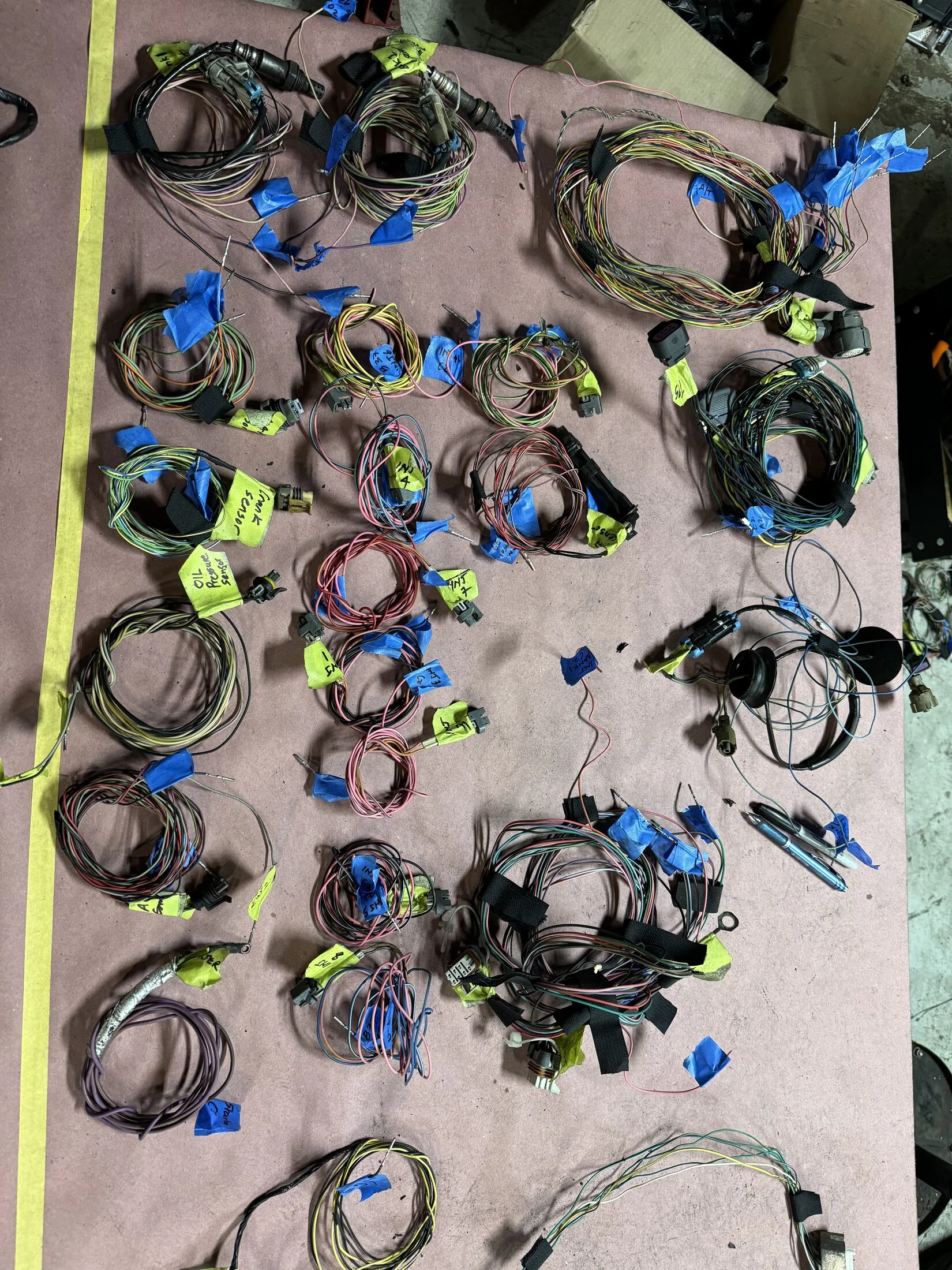

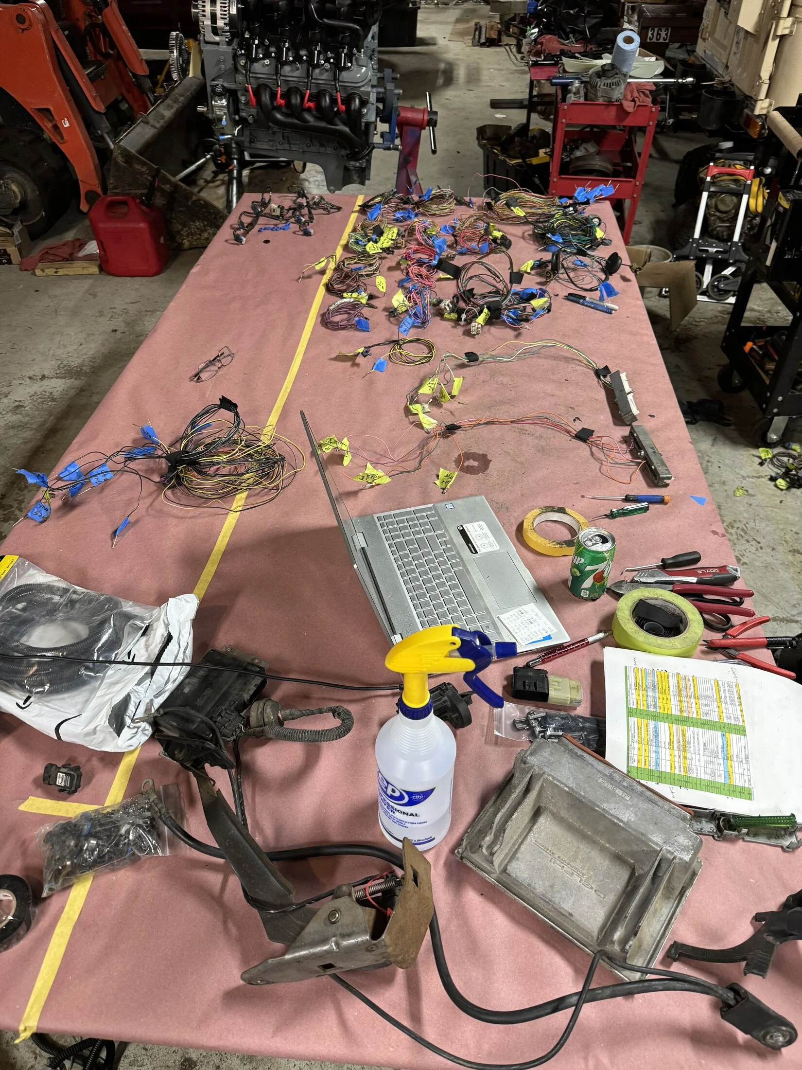

Got a few things done. Rear bumper, motor, wiring harness

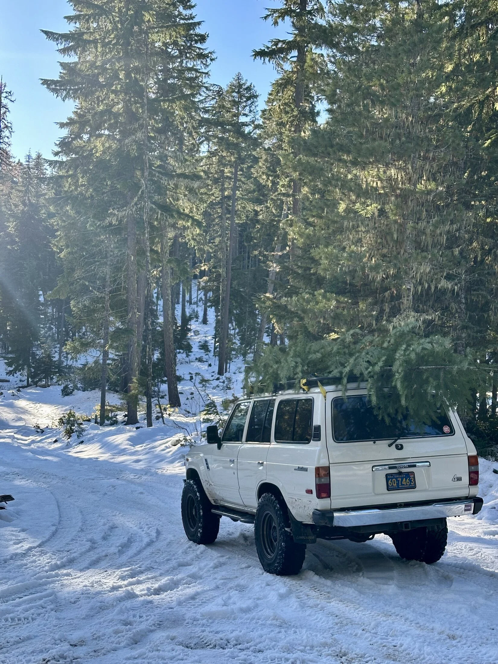

Yesss sssir. I use to have 255/85R16 Toyo MT, But availability is too limited and they're now really expensive... and, so, the deal for these Cooper AT3 XLTs was too tempting !
They look great.
Do they fit well on the 6” wide wheel, and have you experienced any uneven wear?
They look great.
No issues and after +/-18,000Km (11,184 miles) no abnormal wear problems. Rotation at +/-6000km (3,728 miles) and about 35psi of pressure.
I do my oil change and rotation about every 6000km

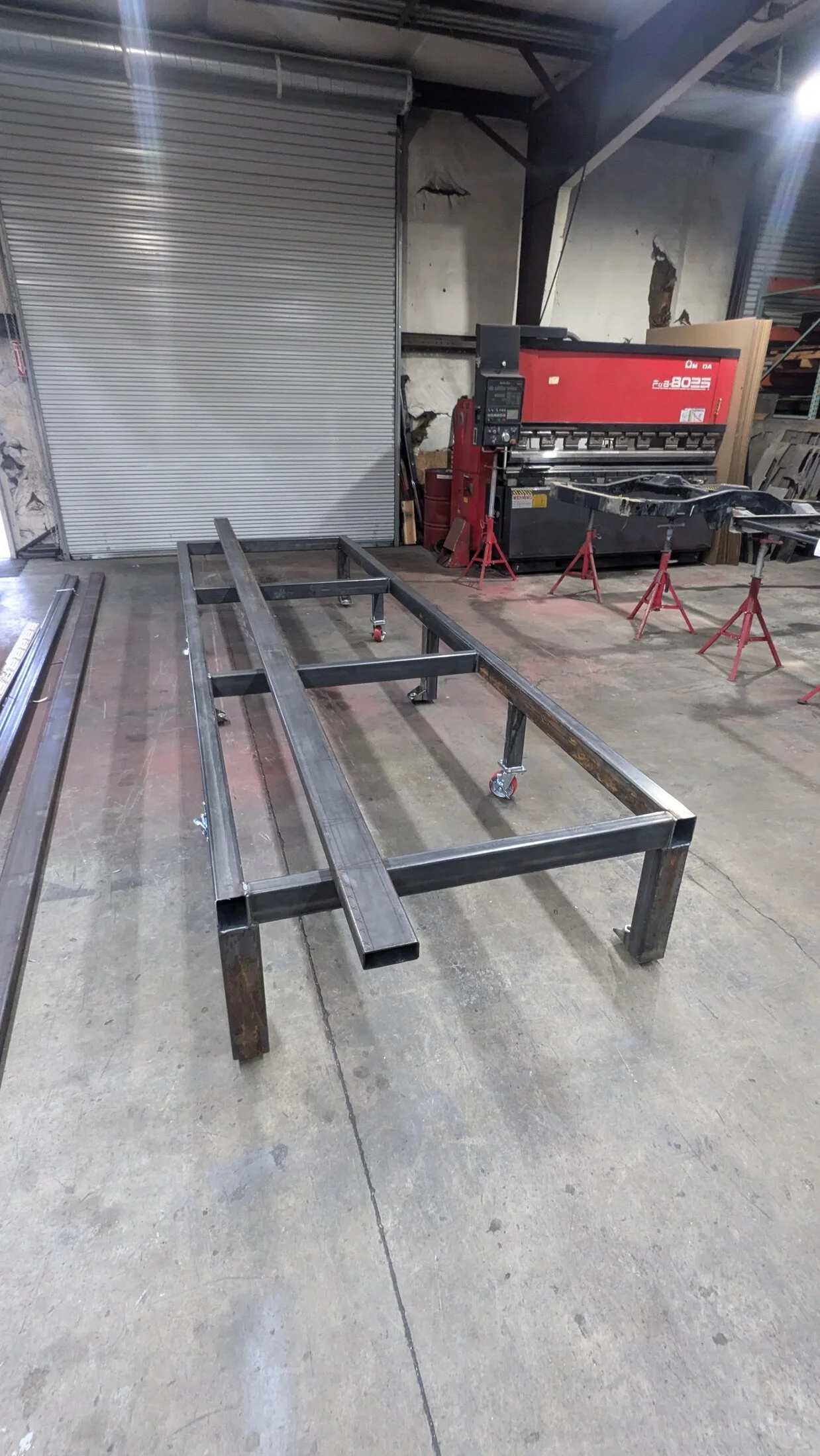

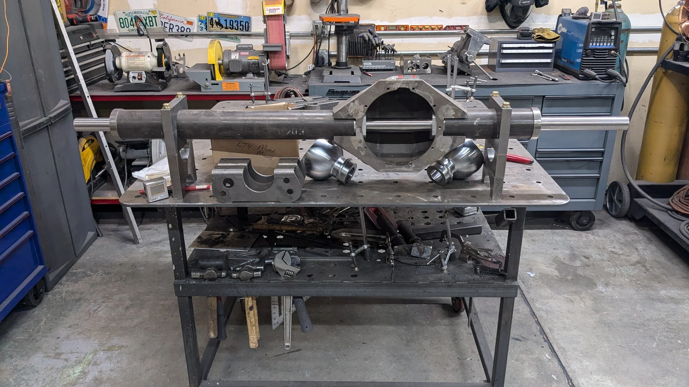

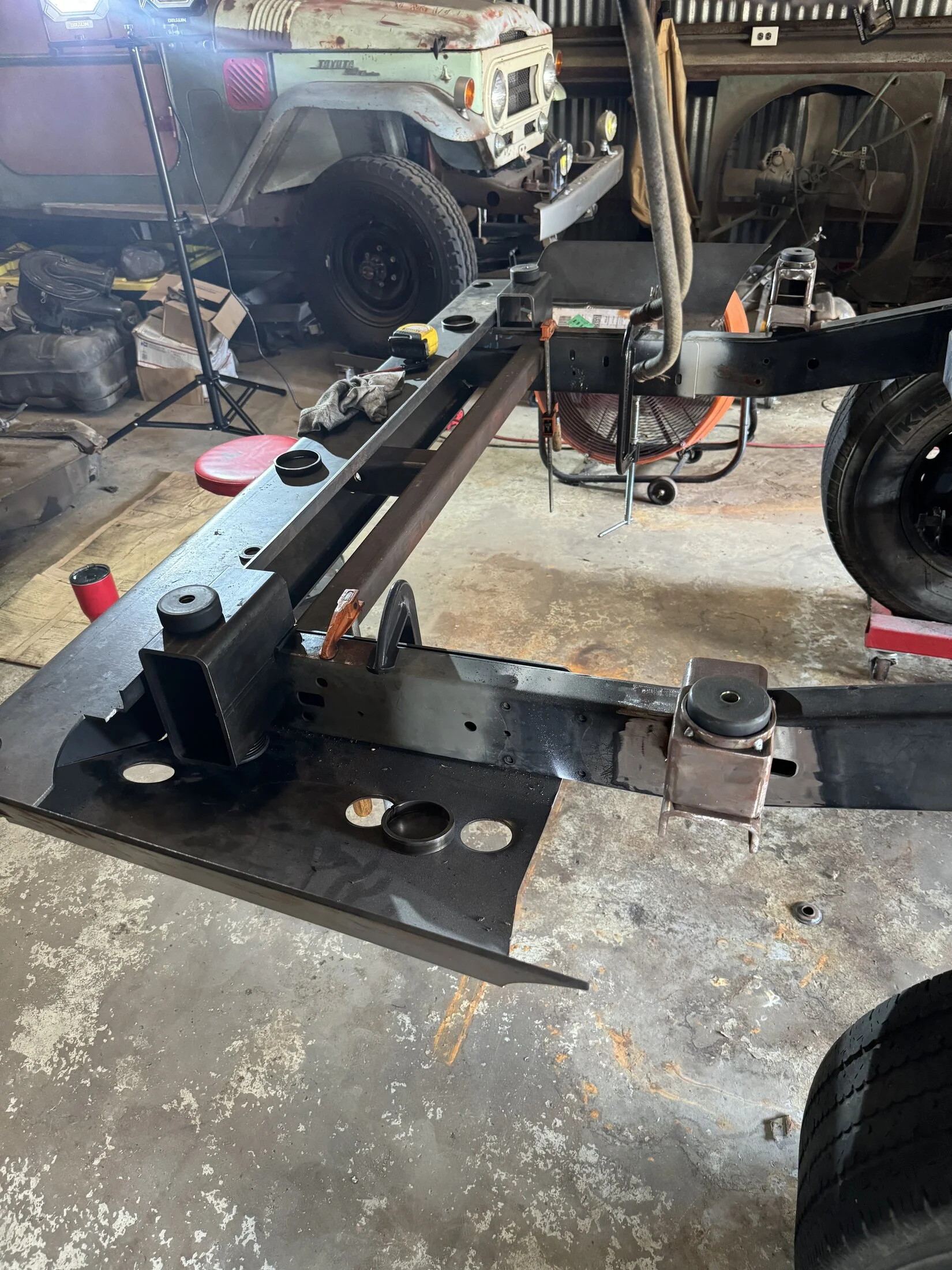

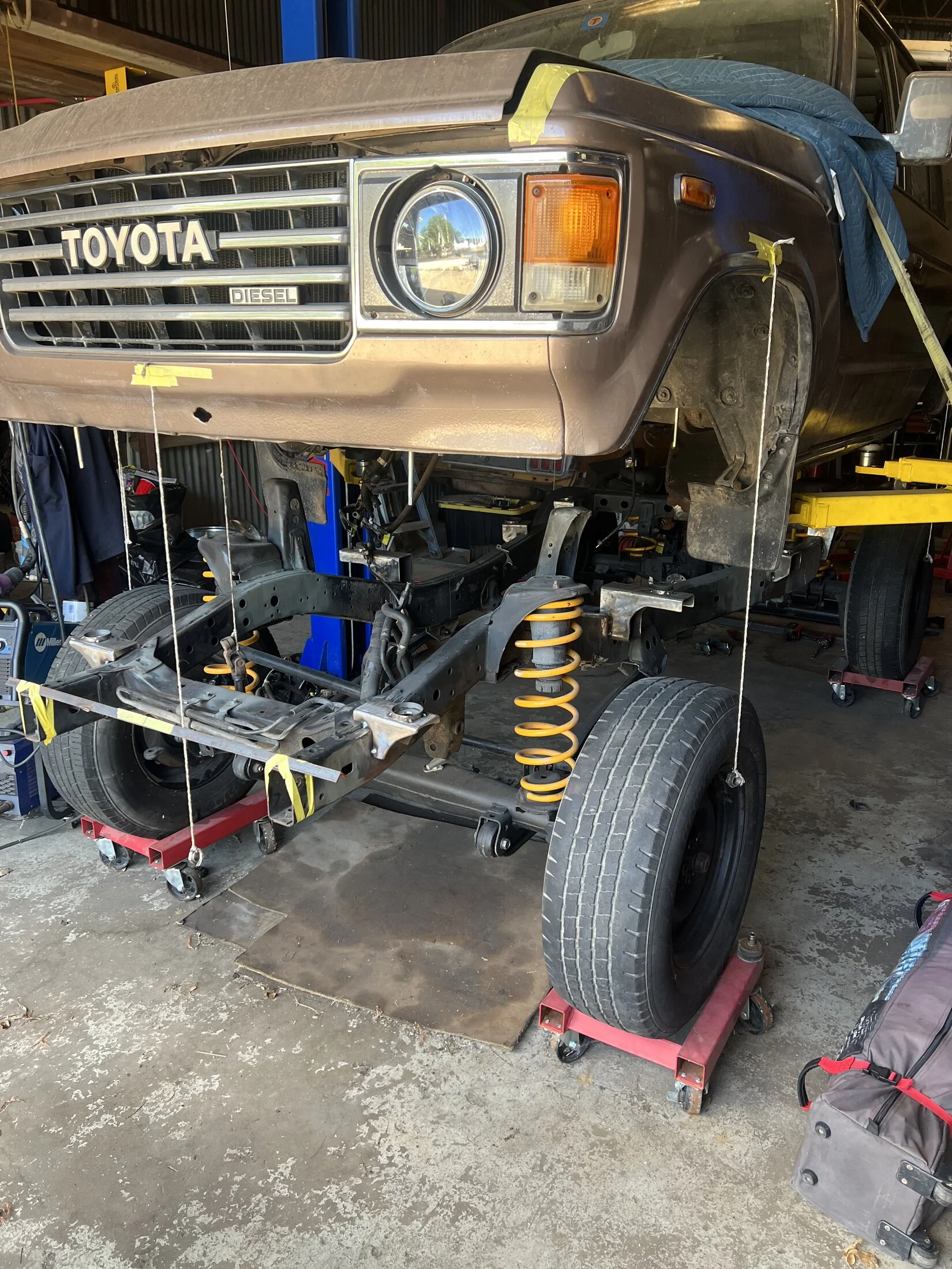

Setting up the new 60 chassis frame jig and front axle.
4 corner coilovers, 80 width axles, 4 link front and rear with OEM bonded bushes (TT adjustable). End to end boxed .188" wall laser cut frame rails and components. These will be set for Gen 4 & 5 GM motors with 4,6 and 8 speed transmissions.
