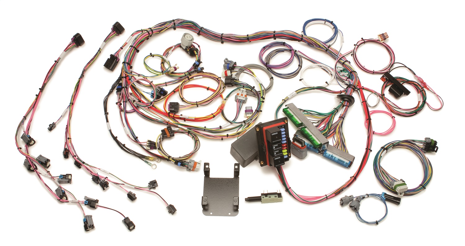

Depinning Delphi connectors, adding some wires, shortening some wires, wrapping in a relay for revese lights, and measuring for braided loom. If you are doing a LS Swap (or ANY engine swap) and looking for a harness, I HIGHLY recommend looking for a harness that has a fuse block with at least 10 Fuses.
If you look carefully at most of these harnesses on the market, a lot of them come with like 4 fuses. So your Transmission, coils, left and right bank injectors, and who knows what else are all protected by one fuse. Would you mount your light bars, arb compressor, Cig lighter, and stereo system all to one fuse? Nope. If you unloom the harness, youll notice a ton of pink wires going into one of the same size. Have an injector trip out your fuse? Goodbye TCC Lockup, and have fun figuring out what of the 9 things connected to that fuse tripped it! Also look for one using a bussman waterproof buss bar. So you can either build your own harness, buy a harness that has a 4 fuse box, depin and split your $700 harness and rebuild it or find something thats split up a little bit better.
This is a painless performance harness. Its got 10 fuses and its split out pretty well. If i wasnt so pressed for time, i would ideally like to split it out a little bit more for the fuses. This one at least has injectors on its own fuse, coils on its own fuse, etc. If i had more time on my hands, i would split it out to left bank injectors and right bank injectors, etc. My 60 is my daily so im trying to get it back on the road asap. Its been 7 weeks since i pulled the 2f, and 4.5 weeks since putting the ls in. Hoping to be done and back driving down the road in 2 or 3 weeks from today.
Also Slowly replacing as many of the funky old Toyota connectors in the OEM harness with Delphi GT weatherpack connectors
So is this not the harness that came with the LS, or am I misunderstanding?
No this a separate harness. This one is a standalone harness that goes in place of the stock LS one. If i had more time i was originally going to depin the original harness and build one out of it, but that would have added a few weeks of work so i just went with this painless one. You can build one out of the Stock LS harness, but youll have to unloom it and remove a ton of stuff you wont be using anymore and then reloom it. This harness pretty much drops in and connects the motor stuff to the pcm and then you tie in a few things from your 60 into it like AC Request, reverse lights with a relay, efans if you are using those, cruise control, power and ground etc.
This is the one I used.
I originally had a lesser quality harness on order but due to supplier issues went with this one and very very glad i did
