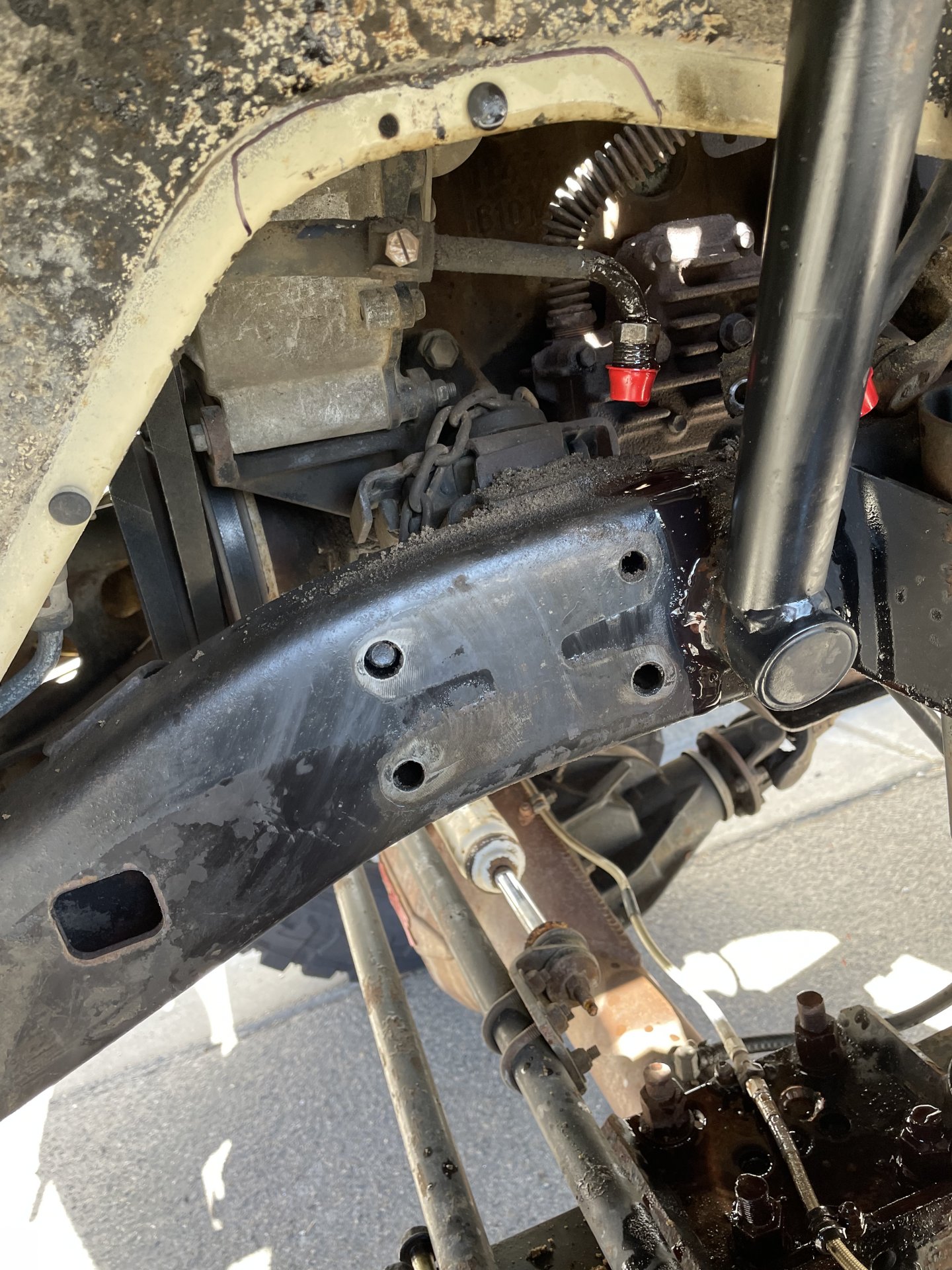

What's involved in the bolt up for pre-1985?
From what I've seen, pre-1985 cannot use the FJ62 and 80 boxes for two reasons. The bolt pattern is slightly different and those bolt holes are sleeved through the frame. Even if you welded the original holes up and drilled new ones through the frame you'd have to re-sleeve those new holes. If you don't re-sleeve them you could potentially hurt your frame or the steering box itself.
Re drill frame holes on 2 of them as it’s a semetric square bolt pattern on early 1985 and down 60 frames and offset mounting holes on later 1985 and up .. pic is of my later frame bolt pattern.
