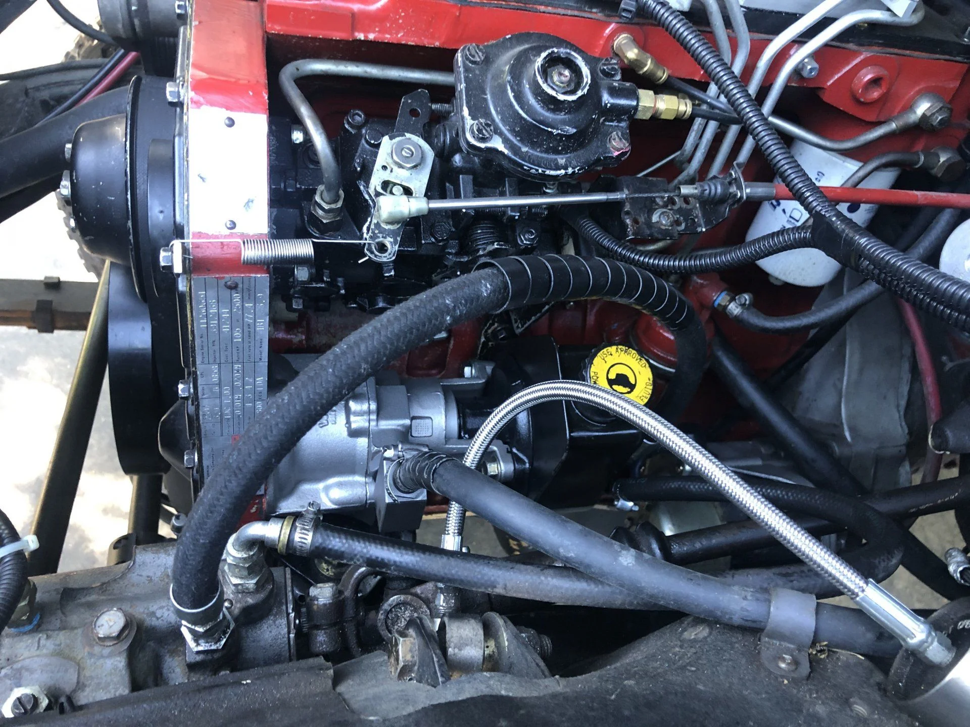

Replaced my Wabco vacuum pump that was leaking as well as my power steering pump that was weeping. Both were still under warranty.
Trickiest part is getting the bolt tightened on the top inside spot on the power steering pump. Needed a short 14MM socket and adapter for 1/4” hex head and tighten with a small 1/4” box end wrench.
Filled power steering pump and bled the system. Lifted front of 60 off the ground and rocked steering wheel back and forth.
Took it for a test drive and it’s all good now.

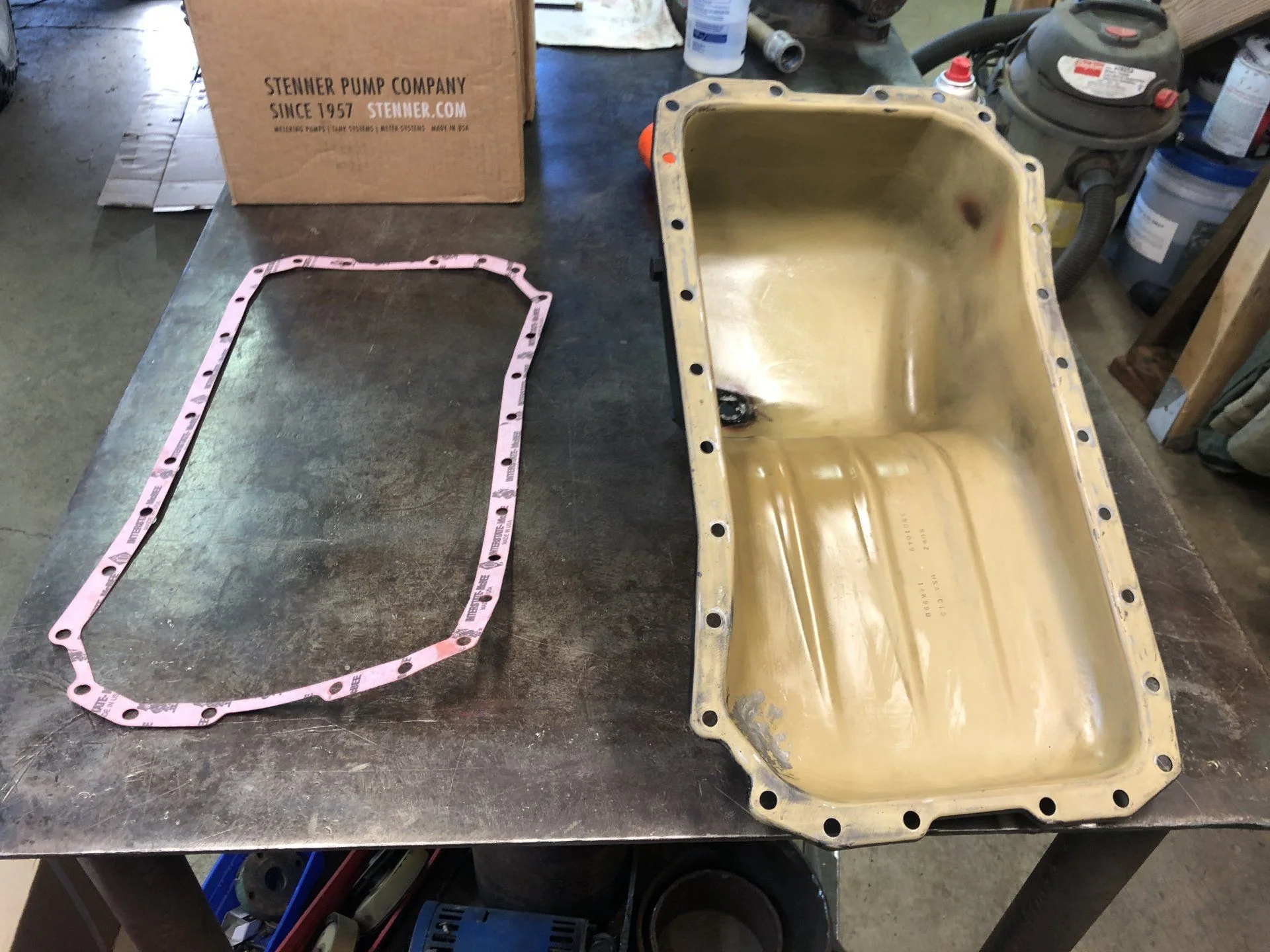

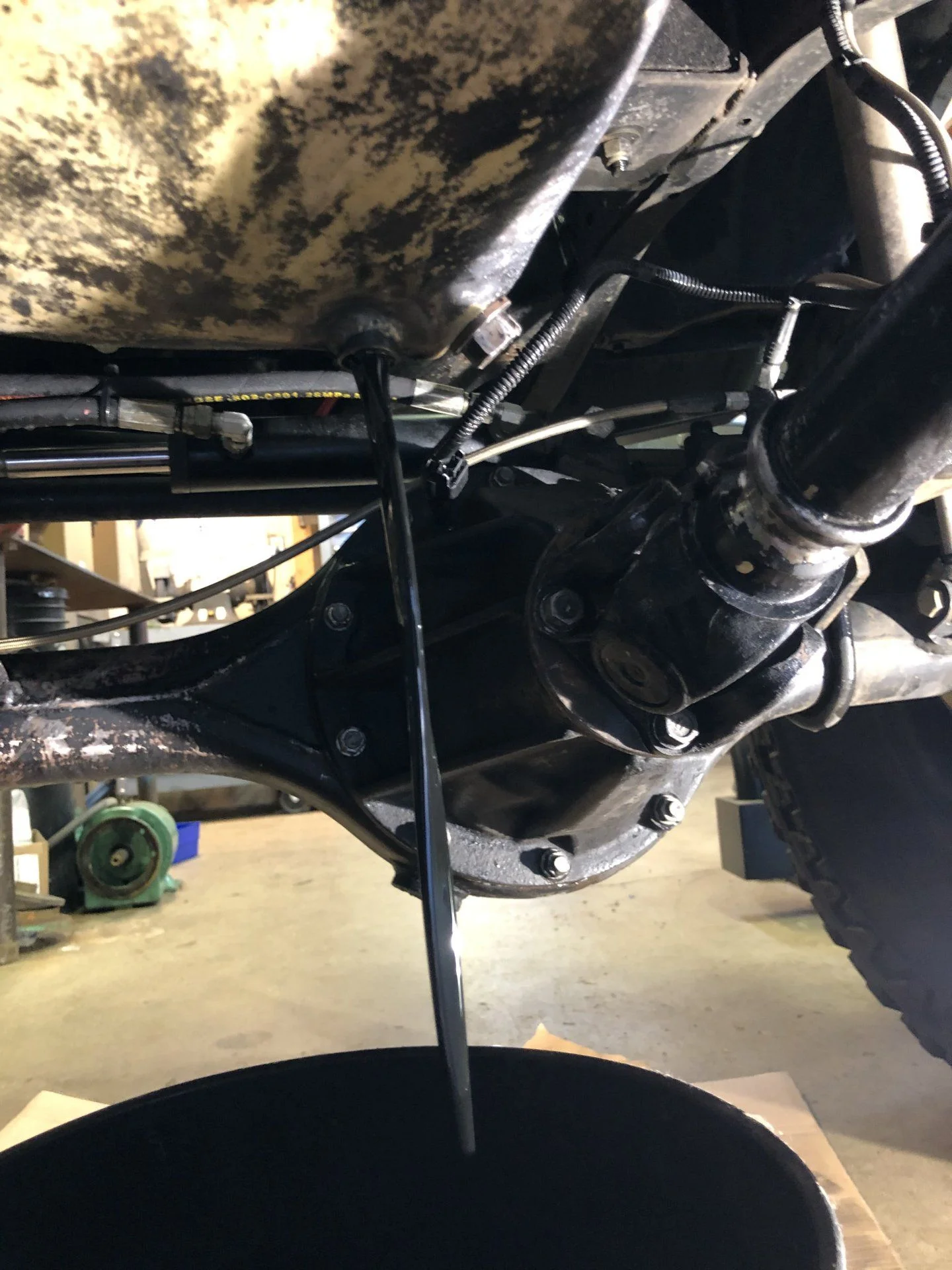

Since the undercarriage was now clean and I had time I decided to replace the oil pan gasket.
The new gasket I bought is twice as thick and coated the gasket with Permatex Motoseal. While the pan was out it was a perfect time to repaint the outside of the oil pan.
Now it’s ready for fresh oil and filter

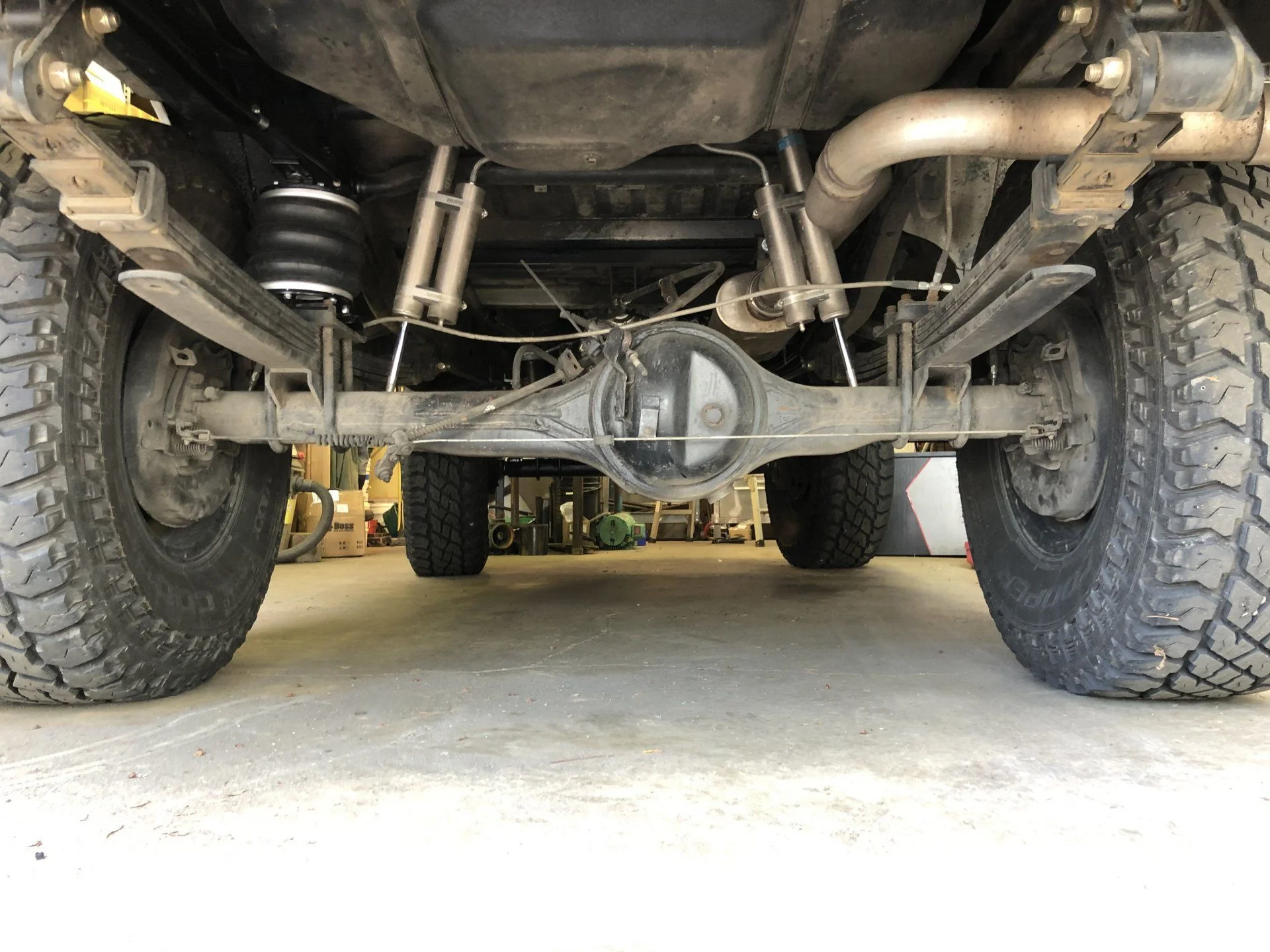

Yesterday was a great day for working on the 60. Finally had time to install my Boss triple airbags. I started on my drivers side because the spare tire had a noticeable sag of almost 2”. Also my passenger side has the 3” exhaust pipe that I need to reroute so the airbag doesn’t contact it.
Had to trim the u-bolt heads with portable bandsaw in order for the base of the air bag to have enough clearance.
Inflated to 60 psi and no leak. Took bag back down to 10 psi which leveled the rear of 60, 8-1/8” from top of tire to top of wheel well.

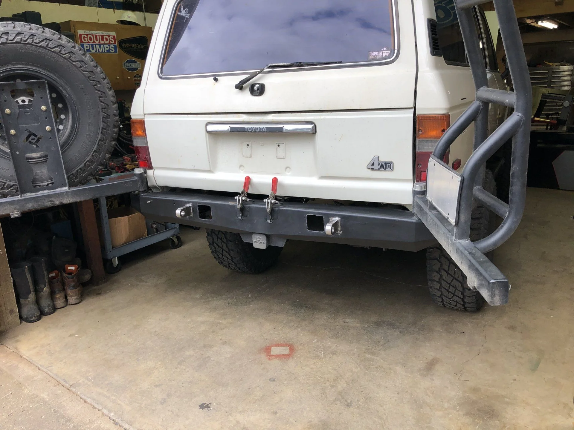

Next up was getting my Ruffstuff Clevis mounts installed. Instead of surface mounting decided to cut through bumper with Plasma Cutter and cut some flat steel and weld to the back side of the clevis mount. Then slide through hole and weld.
Painted the rear bumper and cut in holes for some LED lights.

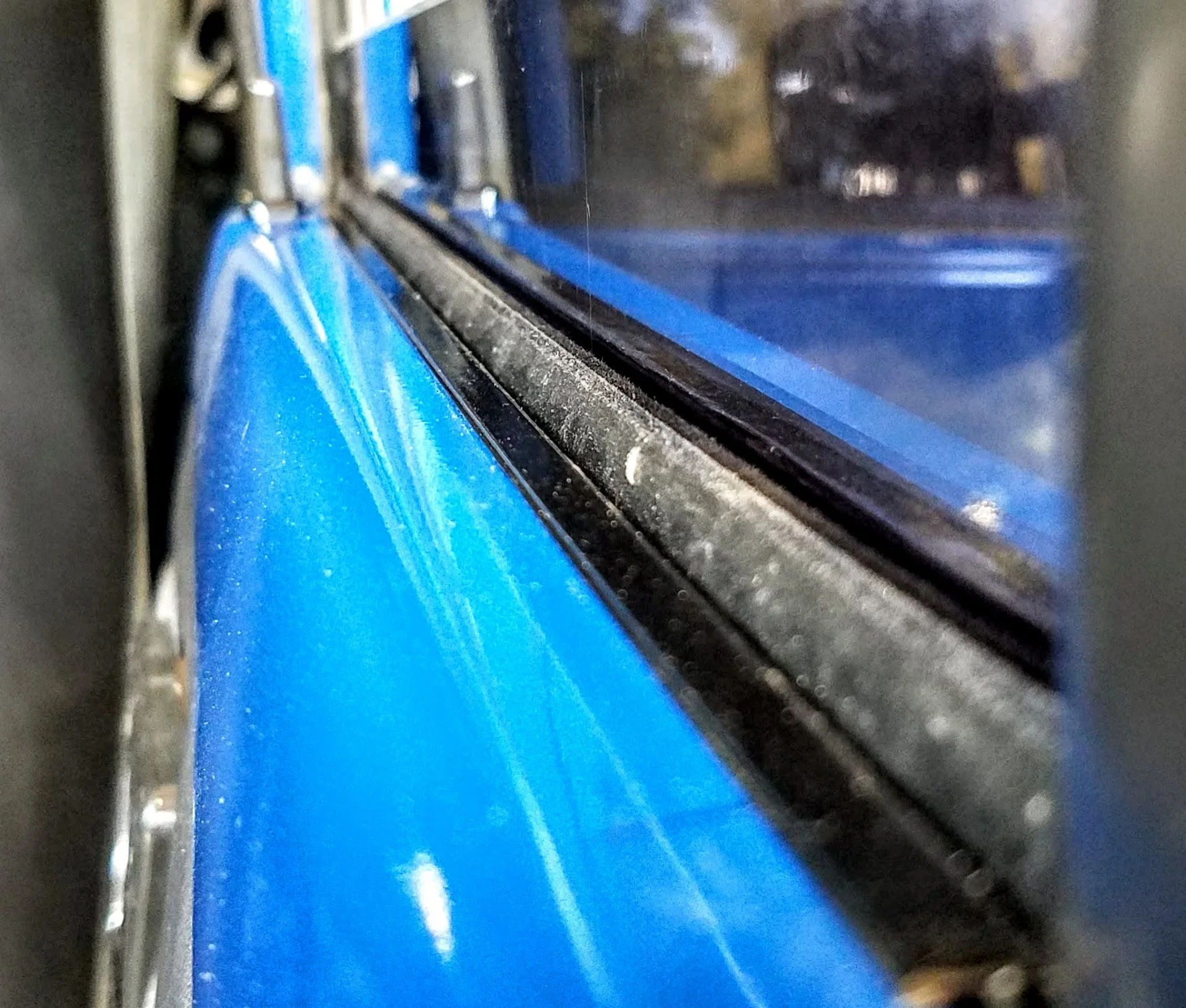

Did that make your windows go up and down any faster?
No. Only fix for a smooth roll up/down is a new regulator and window channel...

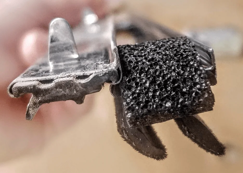

the vent windows (front) came with their own regulator that are in great shape...
Other than some surface rust on the regulator spring (corroseal worked great to make them new again)...
If anything it feels tighter as the new felts really hug the window...
The rear window driver side, even after some TLC it is hard to roll up...
the PS rear window is smooth as silk...

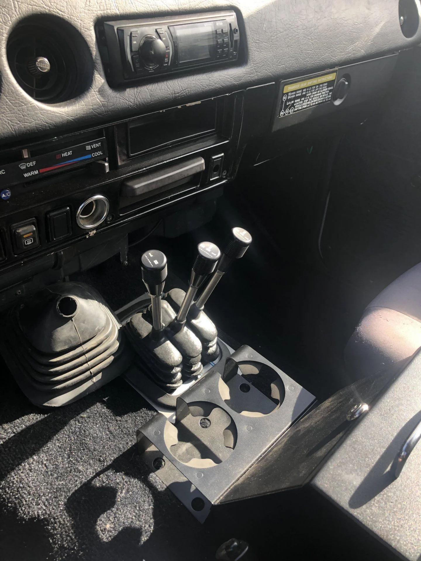

Got a bunch of parts powder coated while I'm waiting for the rest of my A/C parts to be delivered. Sway bars and all brackets, horn grilles and (homemade) brackets, and my tcase twin stick shifters now that I've got them bent the way I want them. So much nicer now, and should last another 32 years....

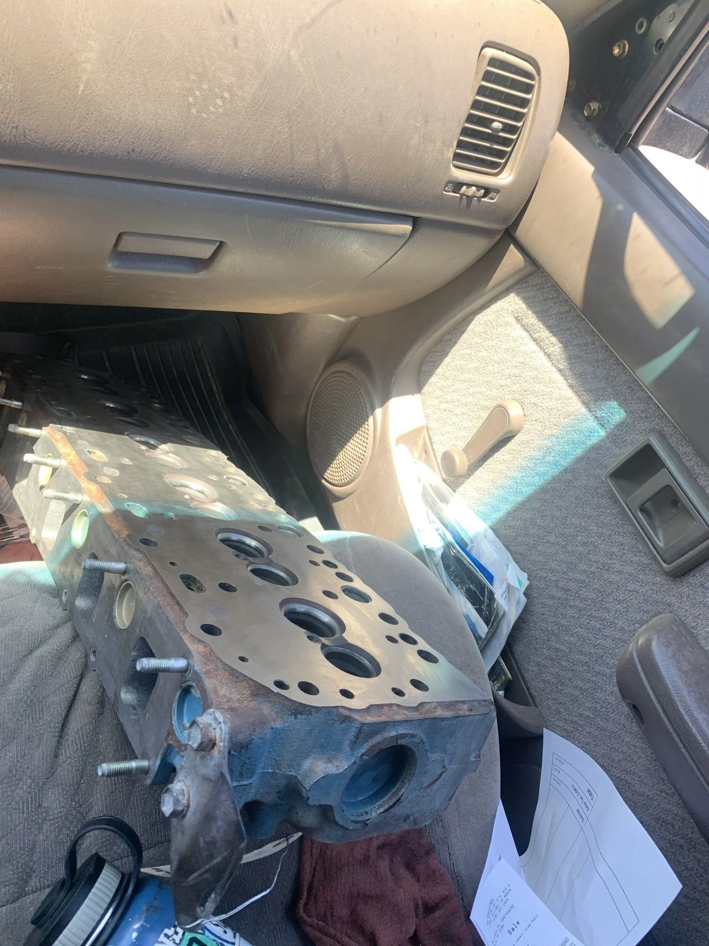

Finally got it back on the road. Lapped the valves, new stem seals and a fresh head gasket. Need to adjust the lash and fix a leaky injector, but it runs great! Thanks for keeping me motivated @CenTXFJ60
