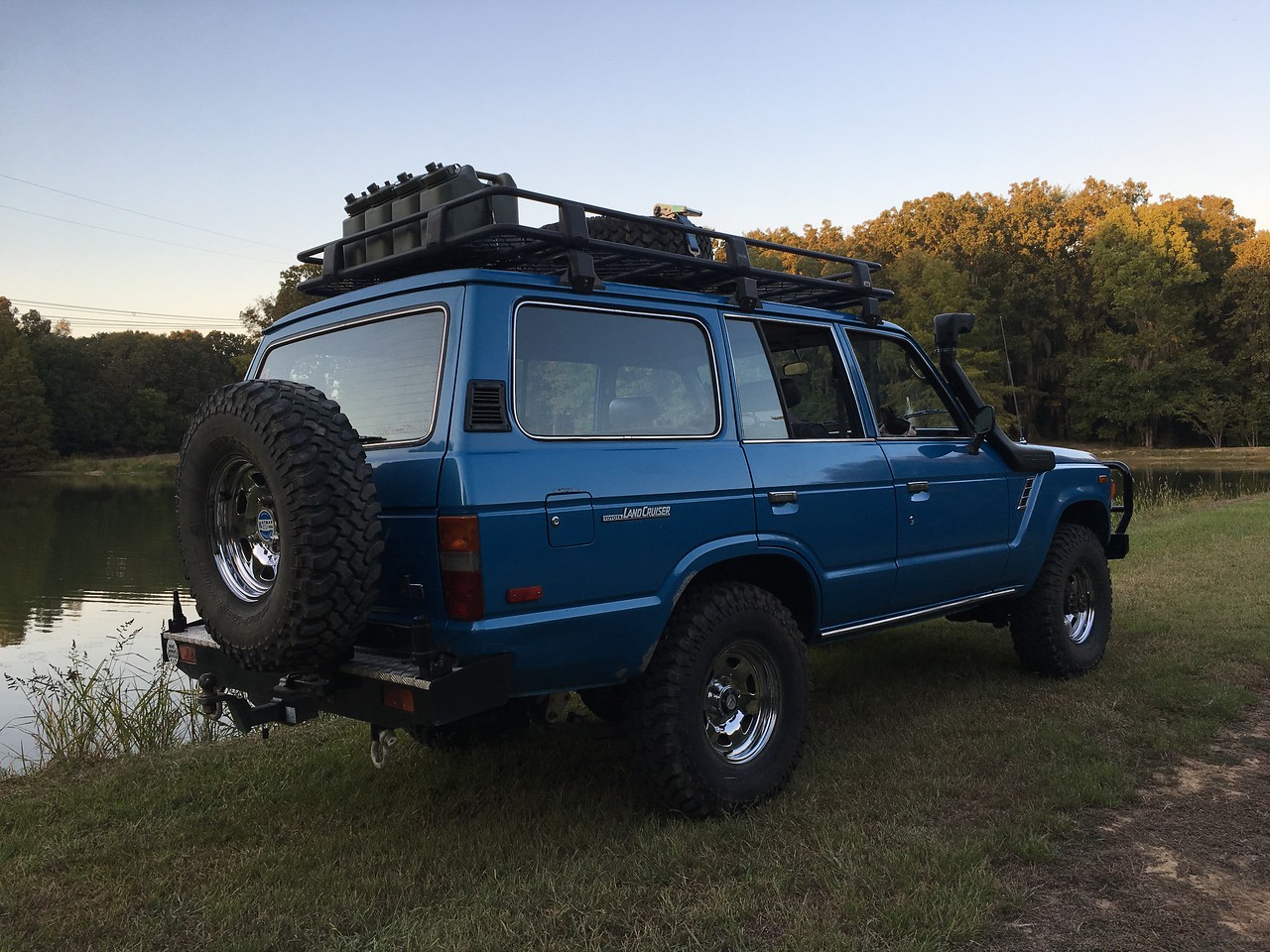

Hauled the boat to N AL for a day of water sample collecting on the Elk River. Mileage was worse than usual the whole trip, down around 10 mpg. Gotta dig into the 2F and sort this out.

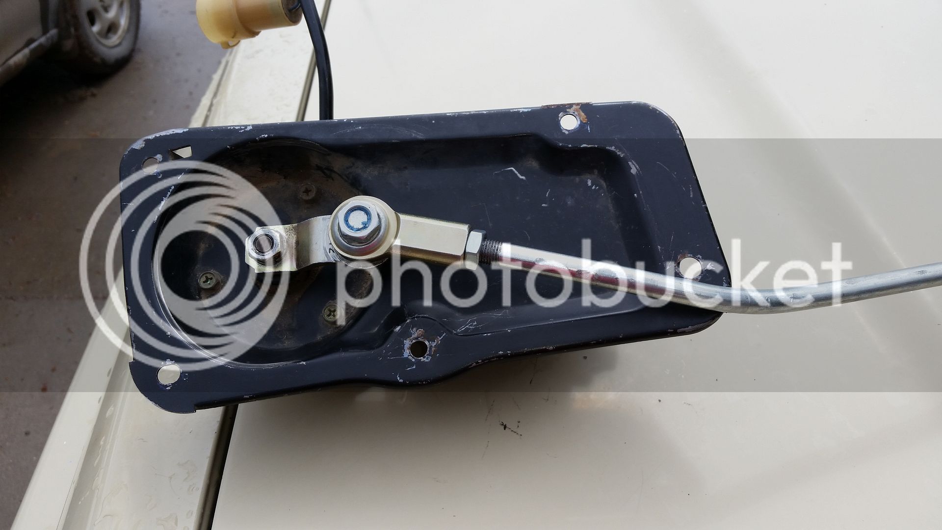

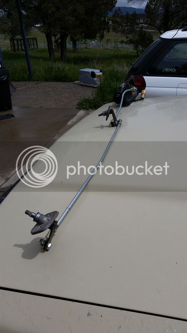

Pulled the wiper motor and wiper arm assembly and greased all pivot points. Then cleaned out 27 years of crap that was piled up in there.
Did this help your motor at all? Mine is lagging hard. On a dry window it won't even really rotate the wipers...

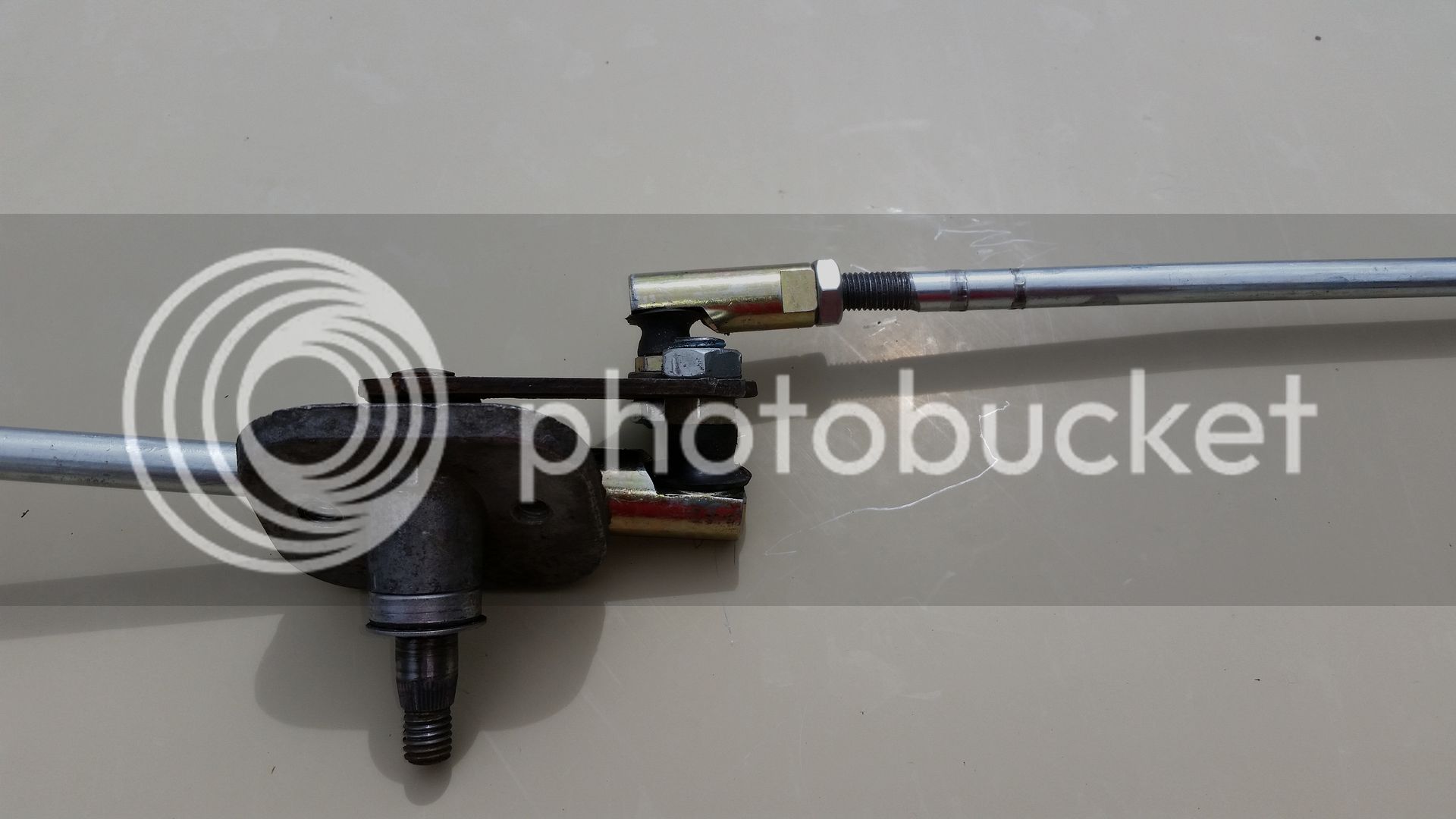

On mine the nylon bushing turned to dust so I built new linkage out of mild steel rod and heim ends.
If I do it again I'll likely use a regular heim on the passenger wiper.
I was thinking of doing the same thing...Great minds think alike!
I was planning on a through bolt to connect the double center section.
