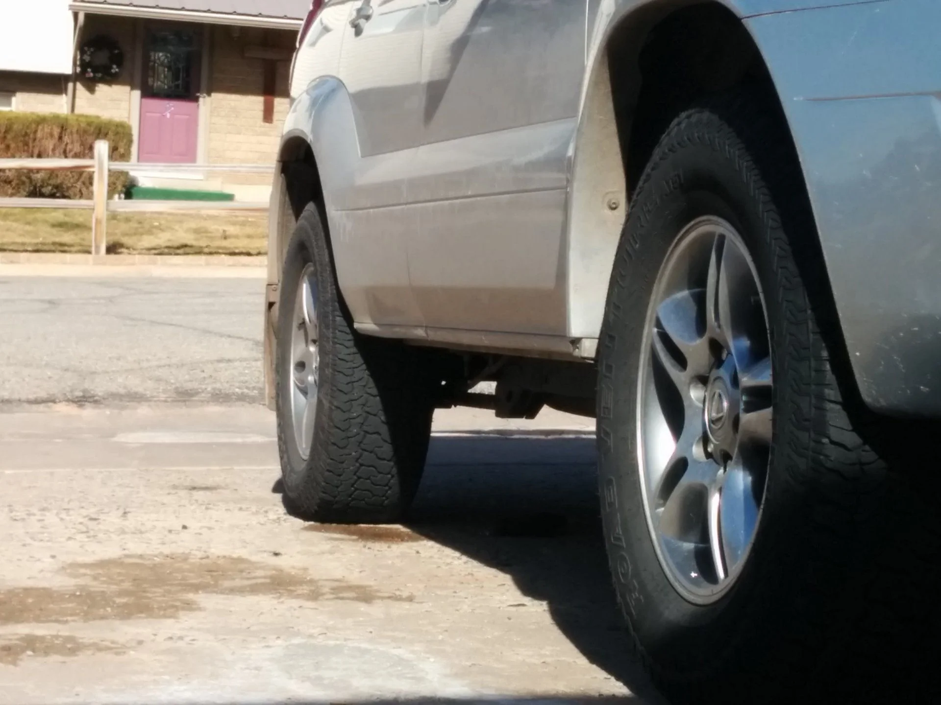

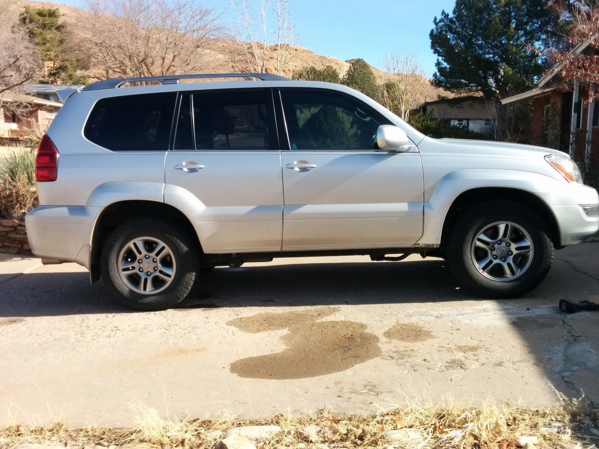

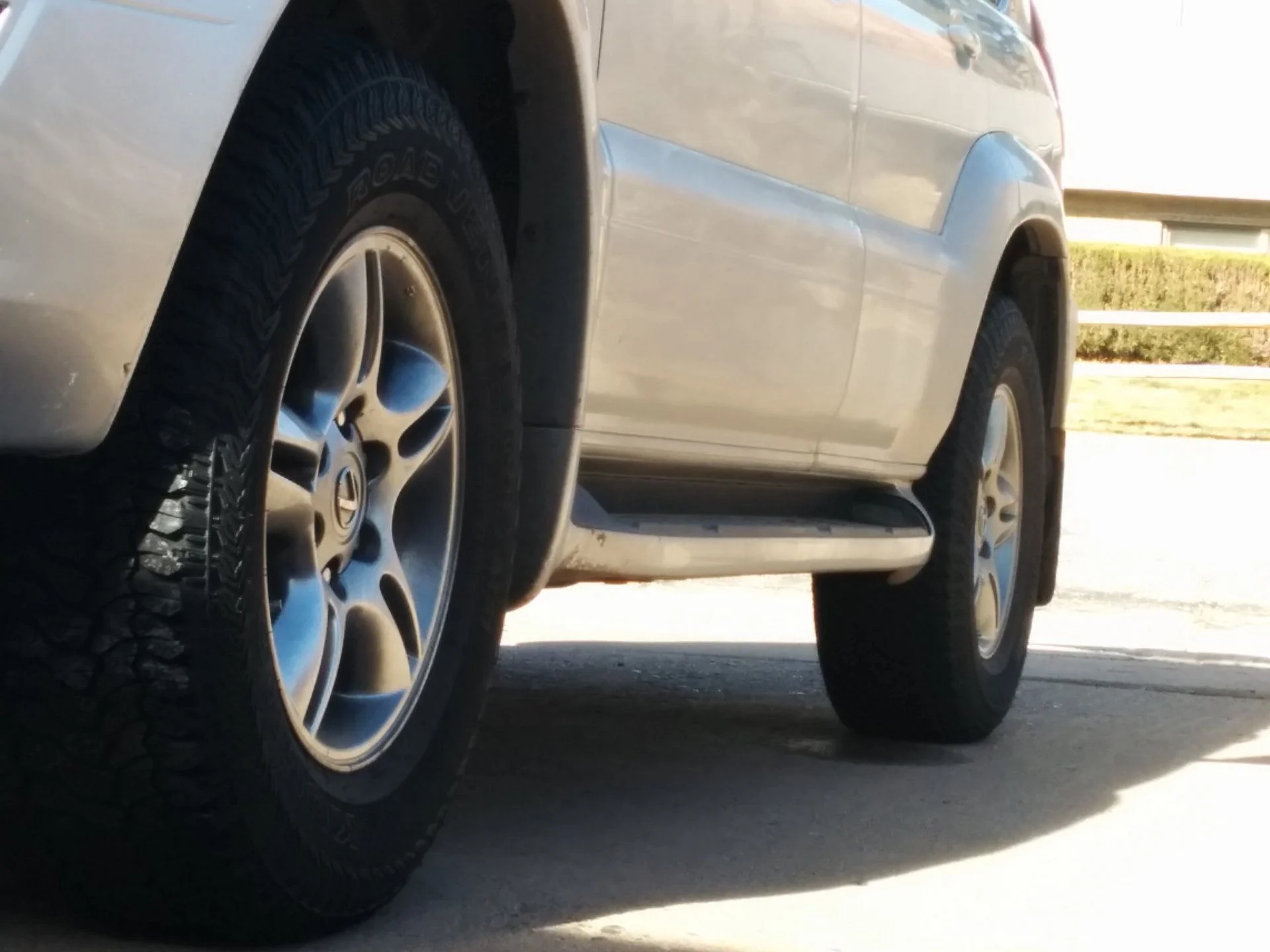

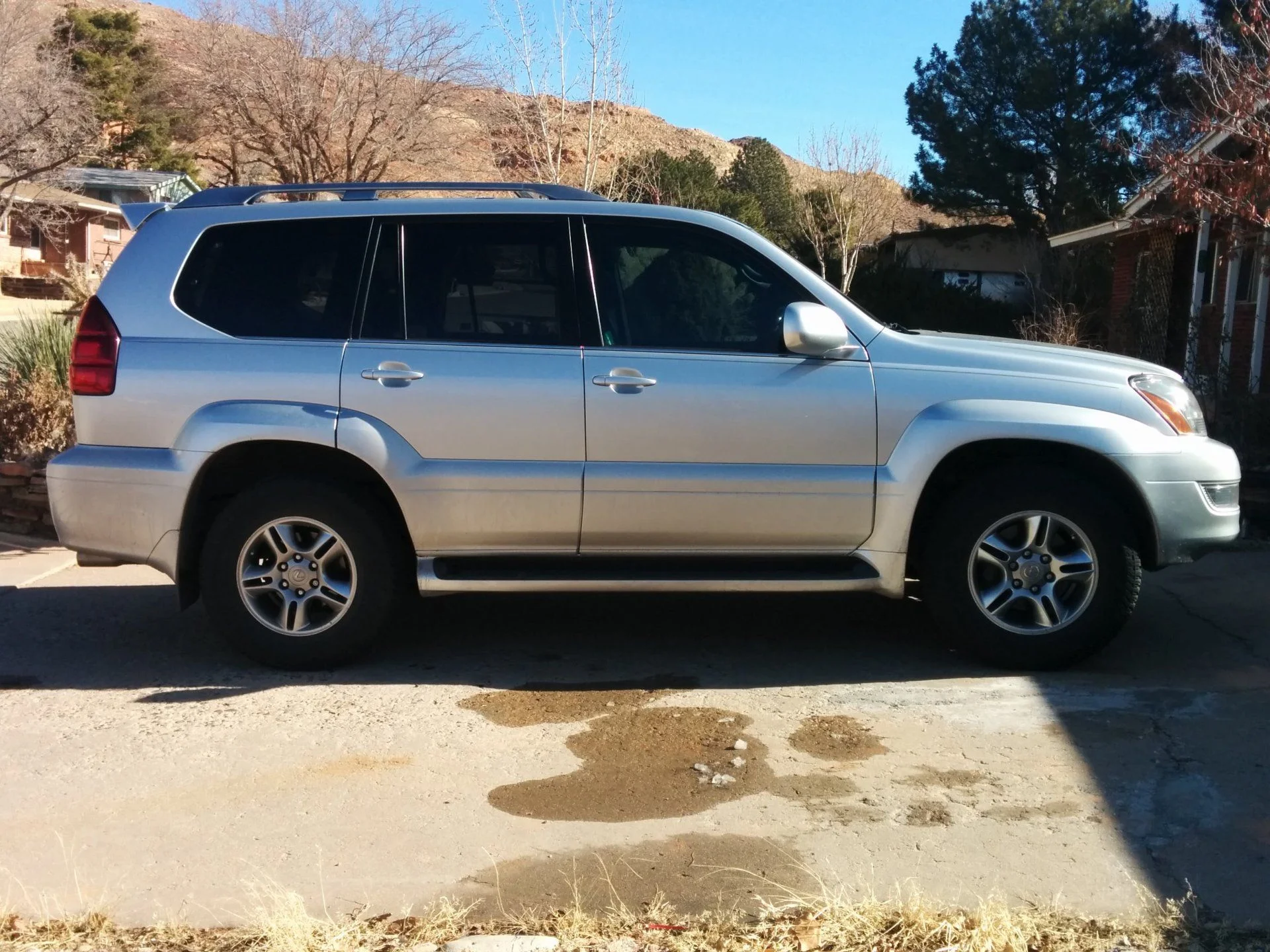

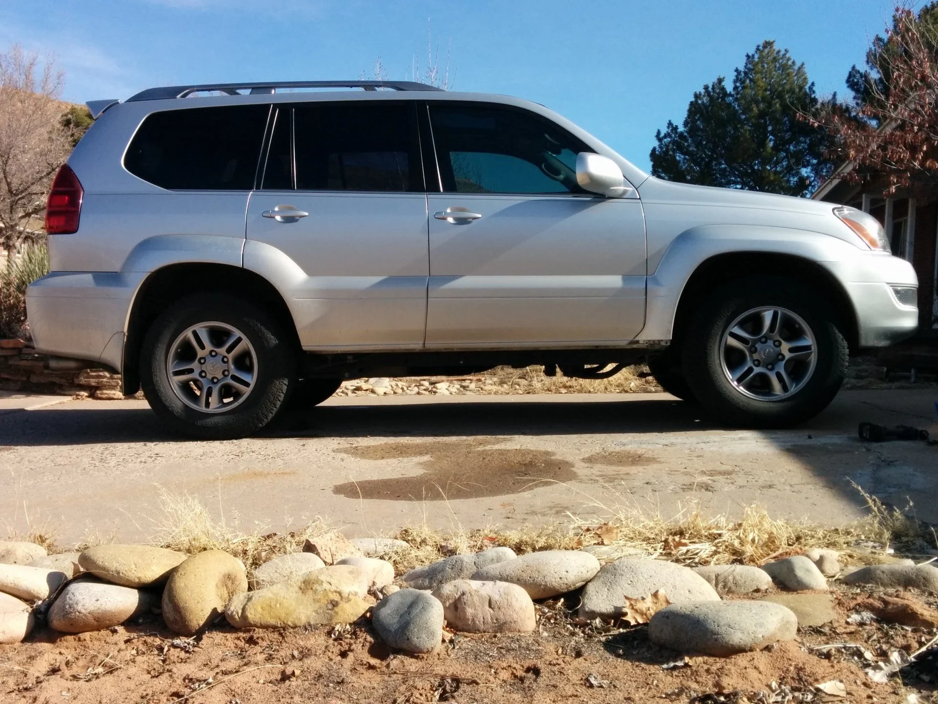

Installed my new Ironman Pro Foam Cell suspension! Eight hours start to finish by myself. Thank you to everyone for the videos and information on the swap. One new trick - when installing the rear spring and bushing, use the factory bottle jack between the axle housing and bump stop to create enough space to install the spring. Great substitute for a third hand!
Old front struts/springs did not want to come out. Had to wiggle and bang the housing to effect a release. Also, sawzall works great to remove the rear shocks - no need for penetrant oil
I love the upgrade!
how do they ride ?

how do they ride ?
A little firmer than stock; however, they absorb bumps and potholes better than the worn stock suspension. Cornering is firmer than the stock setup. Note: my stock suspension is at 172,000 miles. If you have less miles on yours, the result may be different. I am happy with the end result
