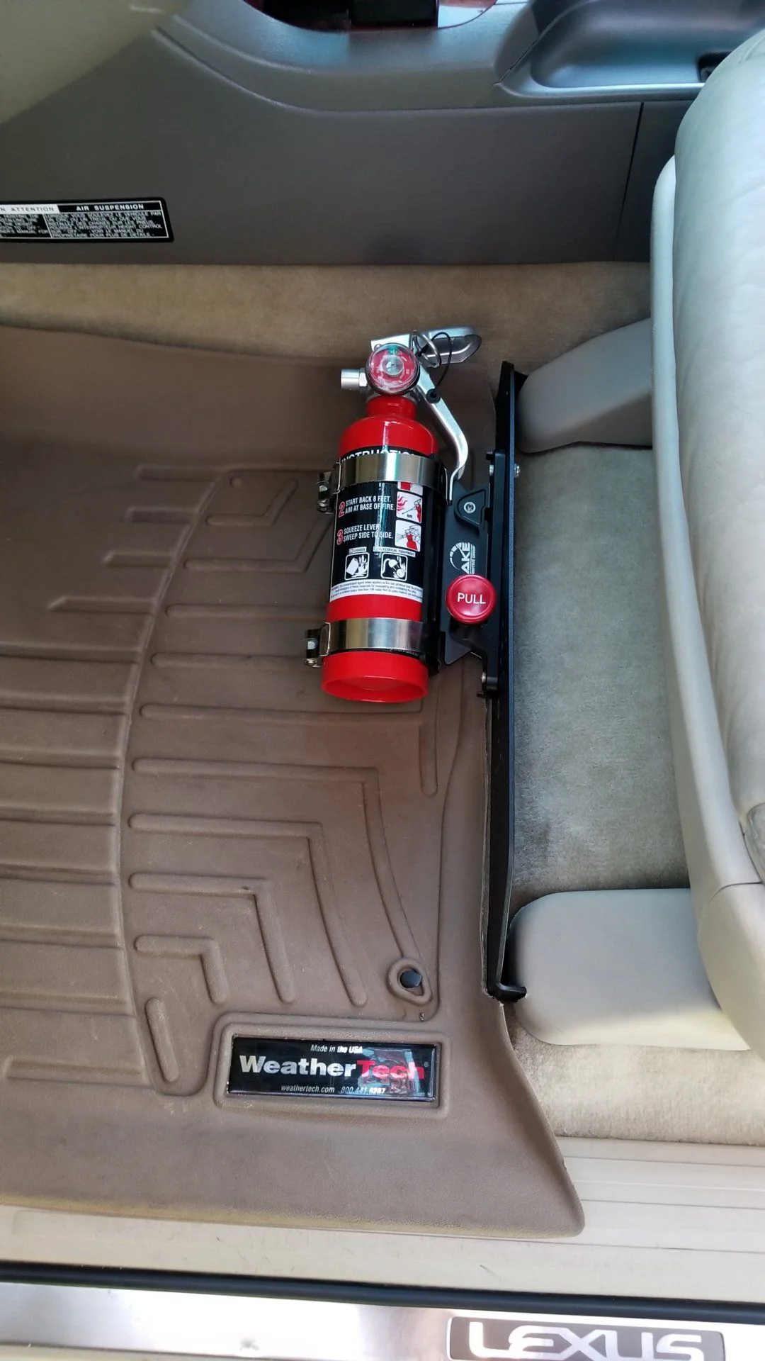

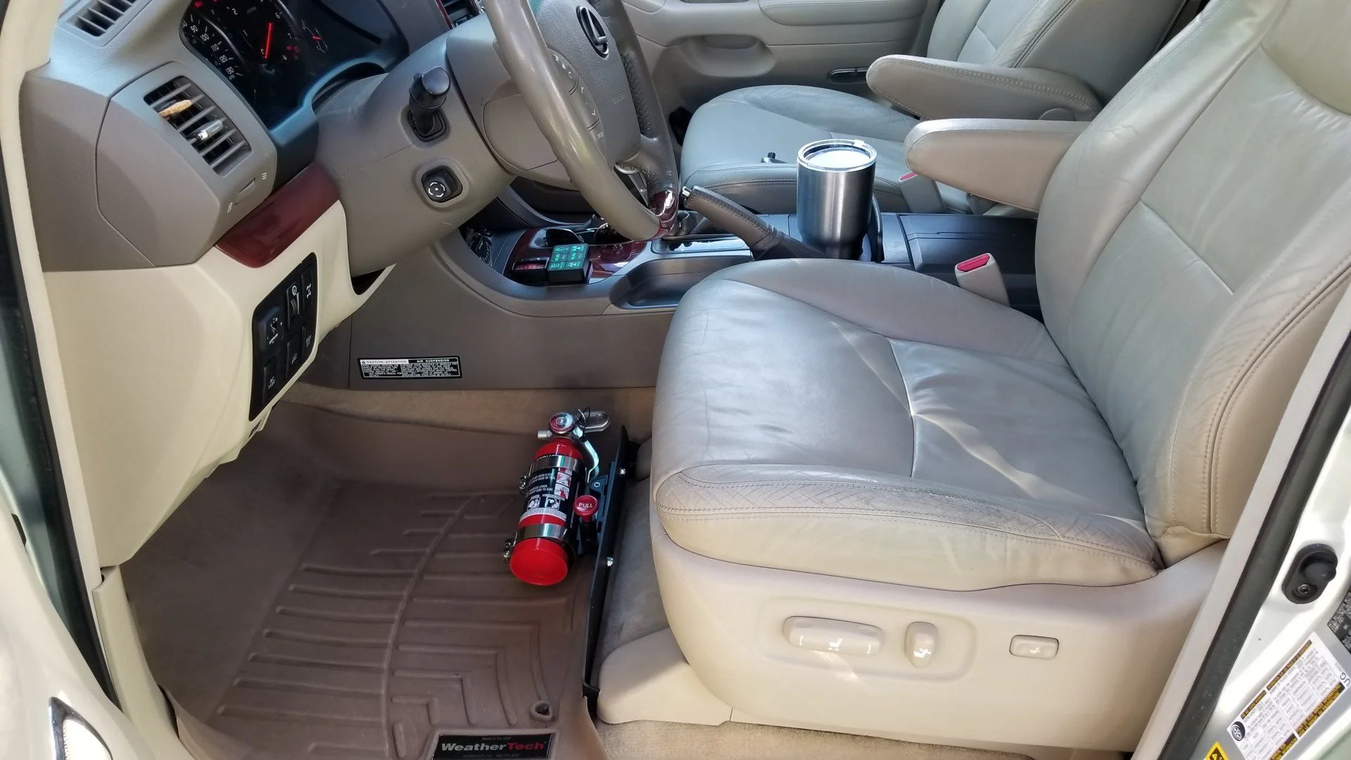

Safety stuff with the Wit's End Mount and a Drake qwik release. Seat is all the way back for my driving. Does not interfere with my entry and exit. Also had the wife (shortie) hop in and test it too. Good to go and right at my fingertips.
