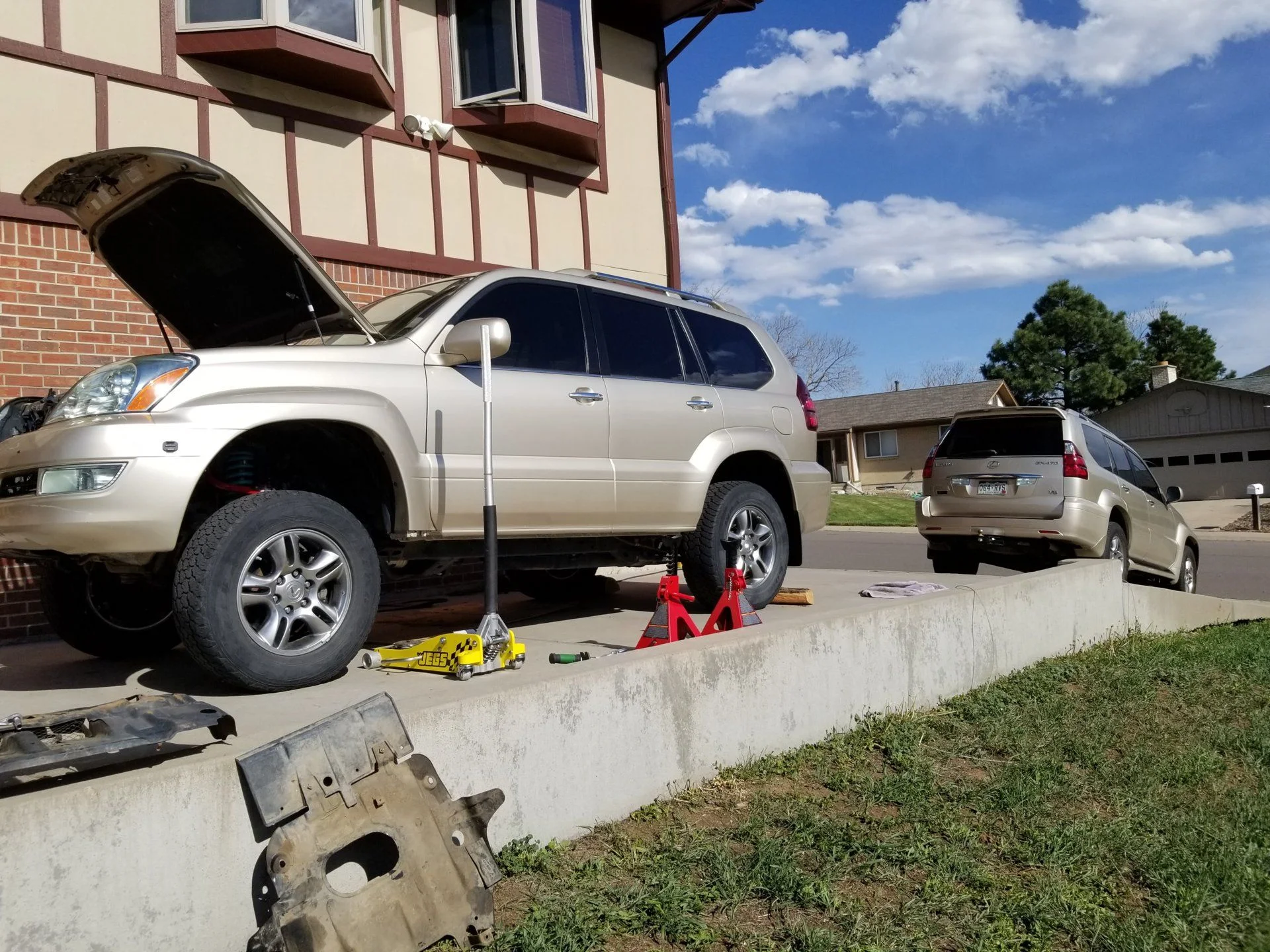

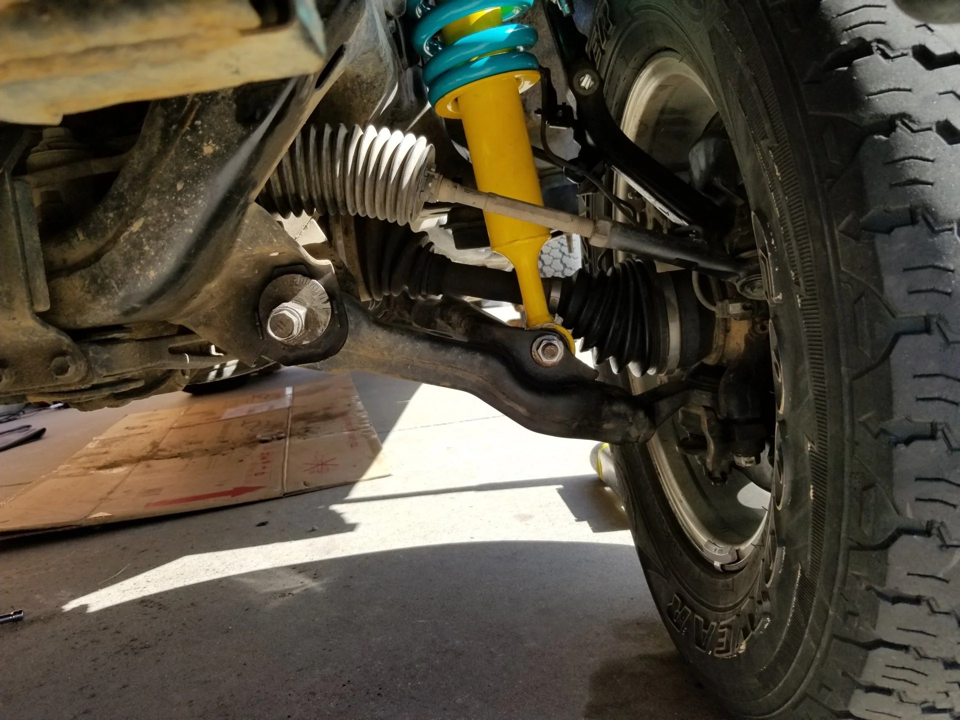

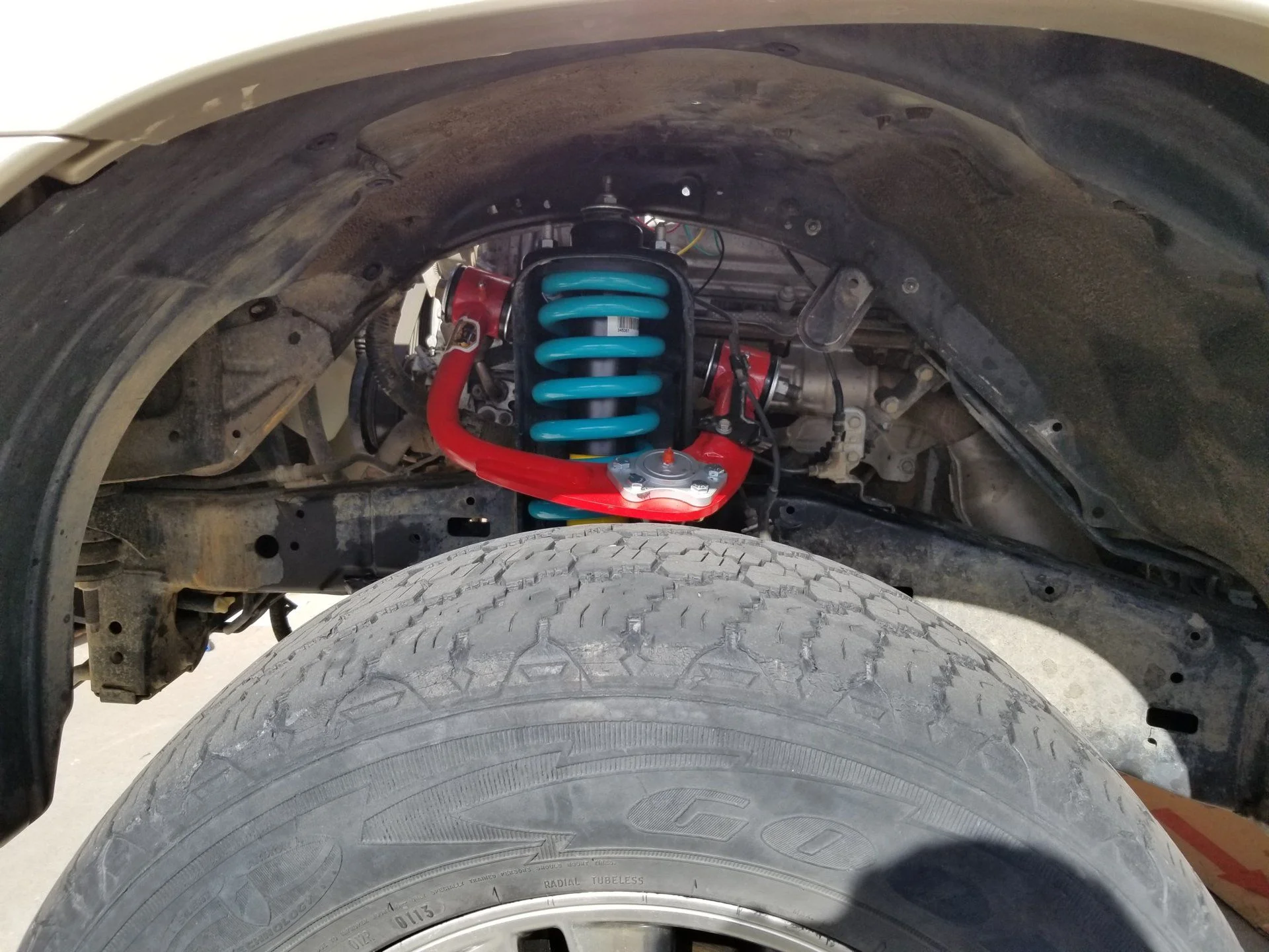

Got the JBAs installed and Dobinsons 3in for the front done today. The #4 hex screw on the AHC device was big pain. Also spindle dropped and skid control line may have stretched.. guess I'll find out when I start her up. Also had to cut off one of the sway bar bracket bolts so will be driving without the front for a while I guess. Looks pretty ridiculous as it is right now. The rear will be next week.

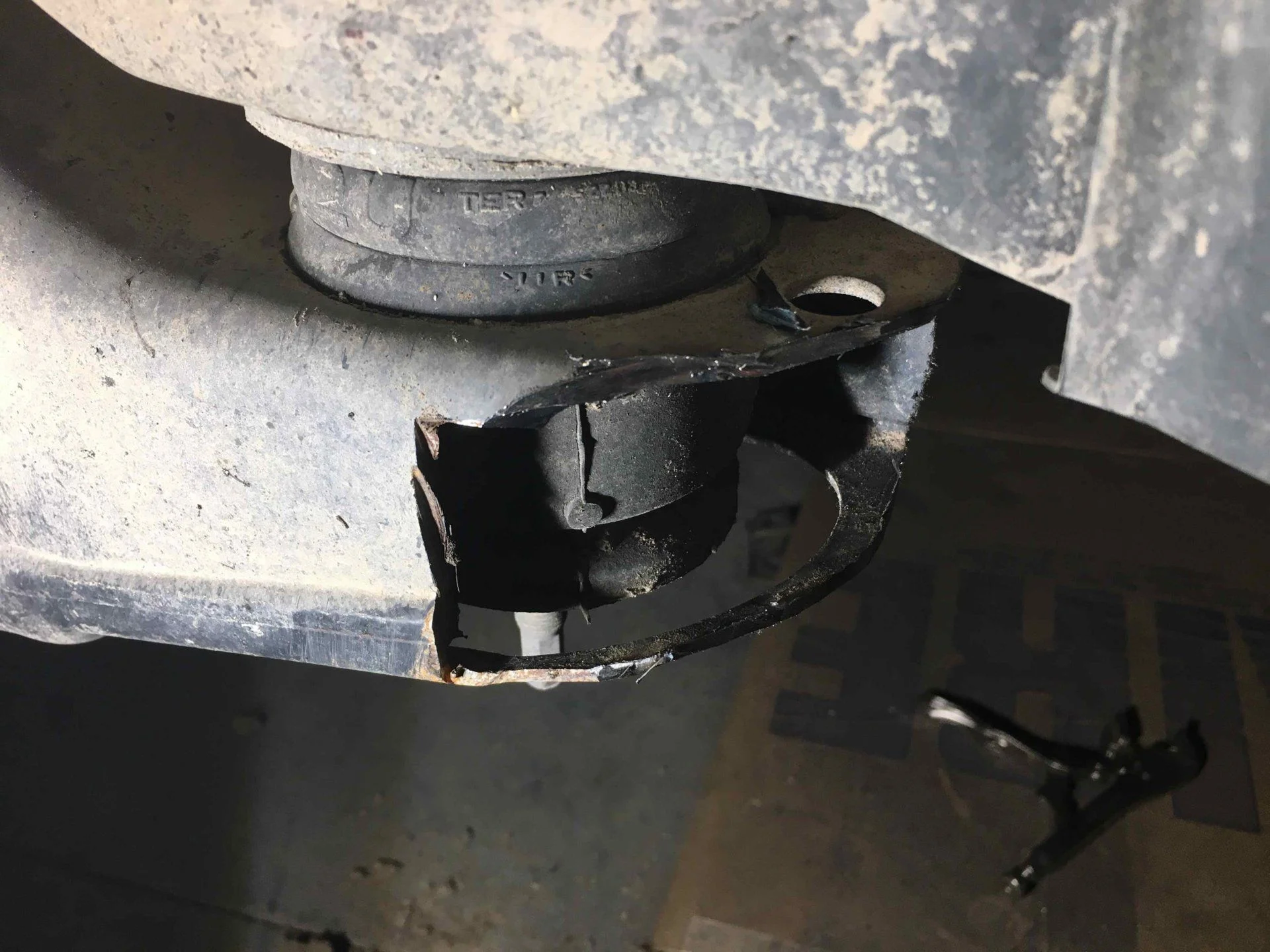

Just chopped off more metal because the tires were still rubbing the mount. Should I leave the metal ring at the bottom to weld the plate onto or chop it off and just weld the plate to the top and two sides?
That ring does nothing. I have had it chopped aggressively for years.
