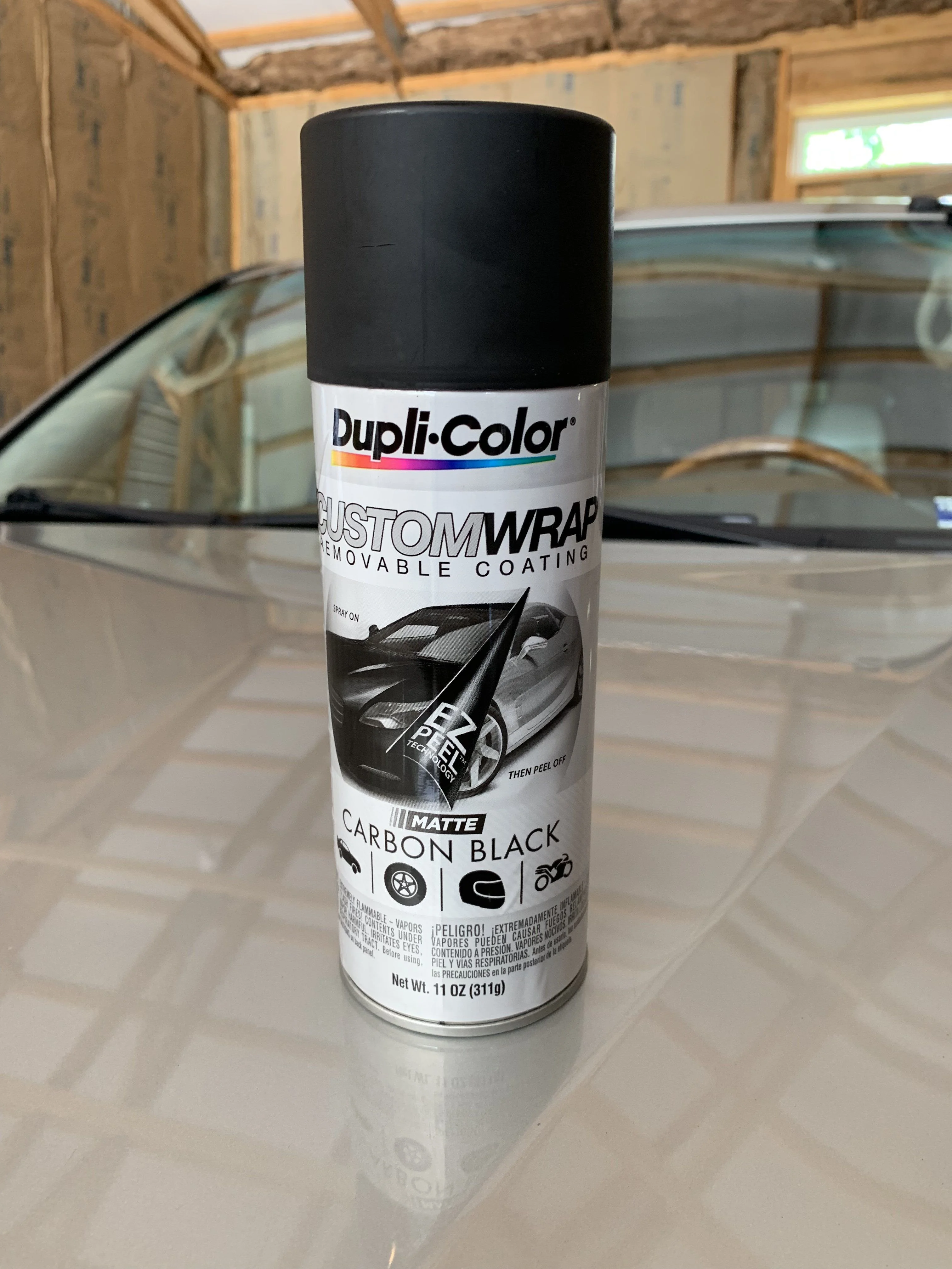

Did a little washing and waxing on some GXs. Also, tried my hand in some matte coating on my grille.
I need to do that to mine. What paint did you use? Any special process or just sand and paint.
This is what I used. Mine is a 2004 that spent the majority of its life in NY. I tried to take the grille out but the bolts were pretty corroded. I just used blue painters tape and newspaper to tape around it. I used a degreaser to get all the bugs off. Then I applied light coats, so there were no runs, until I liked the look of it.

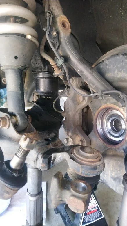

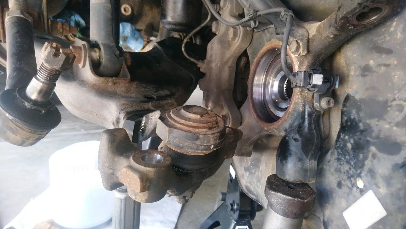

I swapped my driver's side cv with an OEM junkyard axle I found for $50 (in excellent condition). Will clean and reboot the one I pulled to use on the passenger side. Used a new seal in the knuckle, but not in the diff - hoping for no leak there.
Not a bad job. I did find there's no reason to pop the lower balljoint from the knuckle, once the 2 19mm bolts are removed from the LCA, there's plenty of space to swing the knuckle/rotor/etc out of the way. Cleaned everything up and used some 303 Protectant on the new-to-me axle boots, so hopefully this one lasts a bit....
