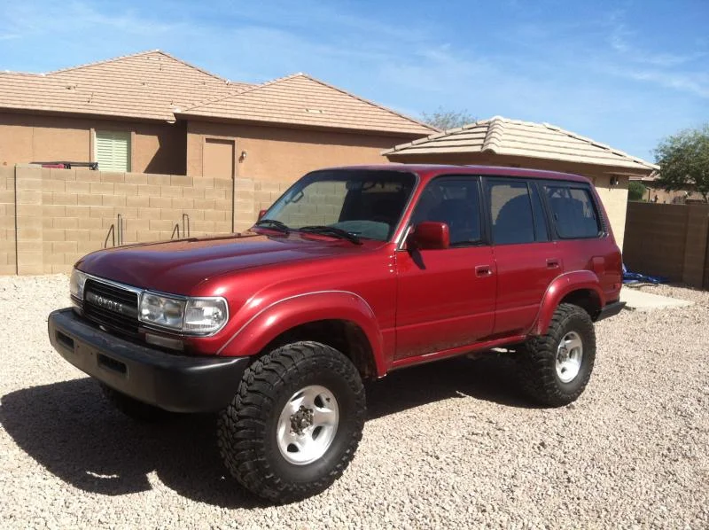

I installed some new shoes! 37's and a 4x4 Labs rear bumper kit!
Looks good Marcus - you going to paint the bumper or posder coat?
Hope to see you on the trail again soon :cheers:
I going to paint the bumper once I clearance everything for the 37's
