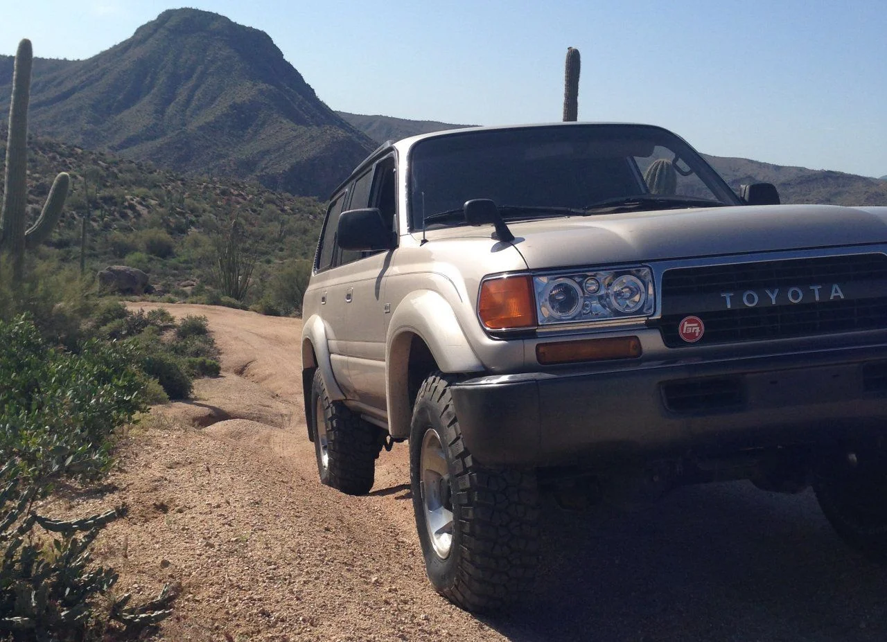

Sunday, in my backyard. (Powerline Rd. in Rio Verde)

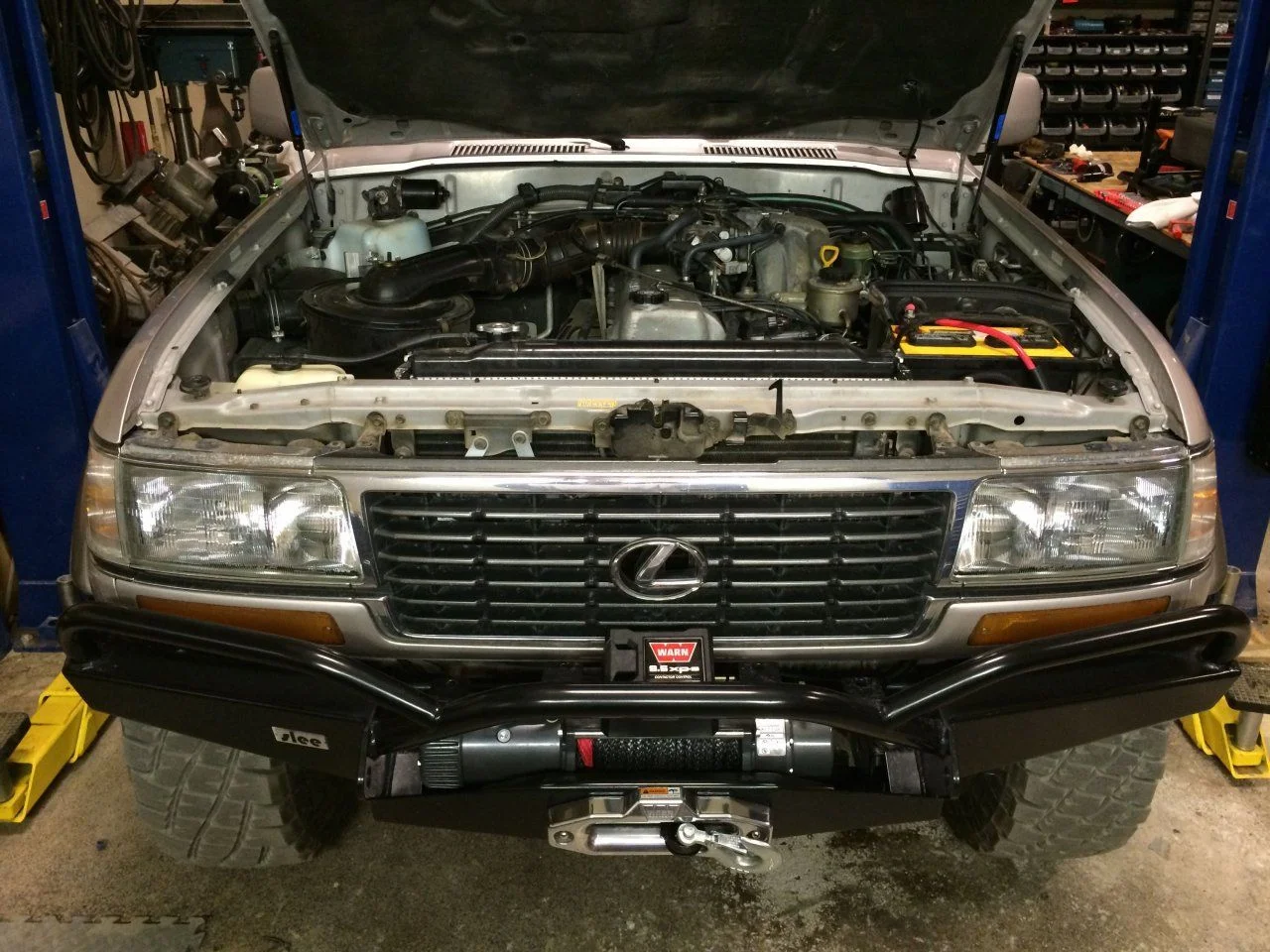

New Warn on Slee:

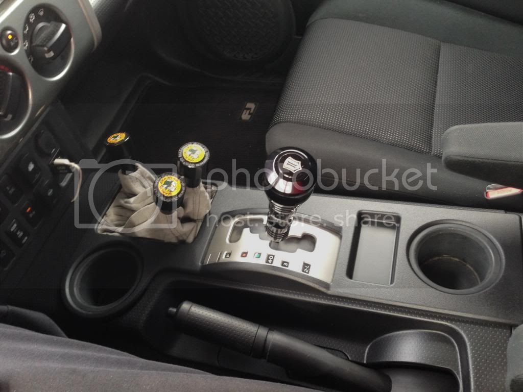

I finished up the triple stick interior today. I had a local upholstery shop sew up a triple boot! Inside is done!
That's looks awesome Marcus. Let us know how you like the set up.

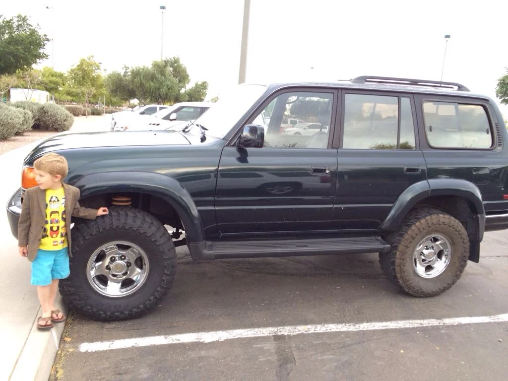

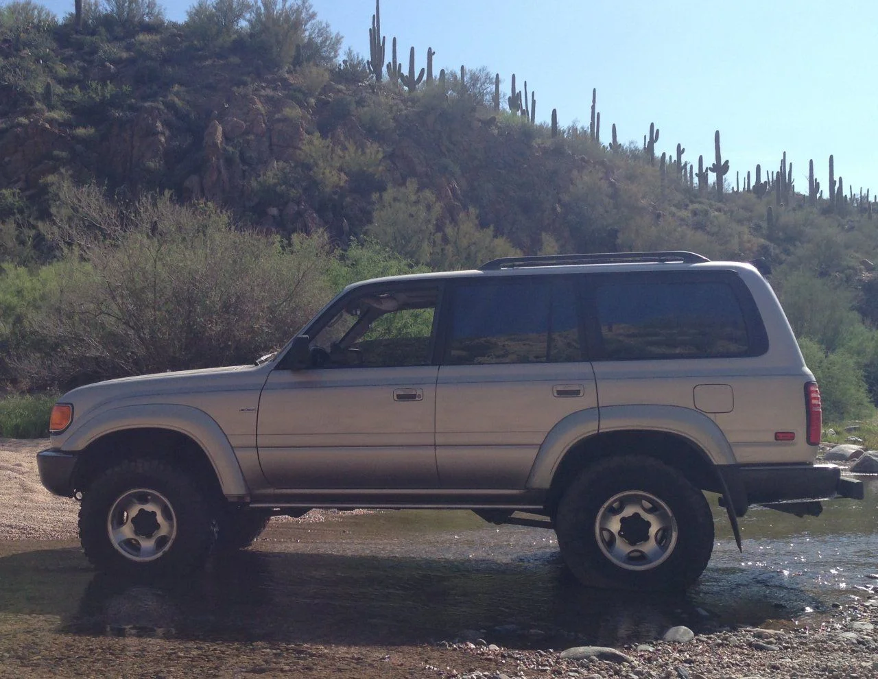

Got it out of the shop: used 315s, used 4" ironmans, new omeL shox. Drove it about 100 miles around town and on the freeway; getting used to the height and taller/wider tires.

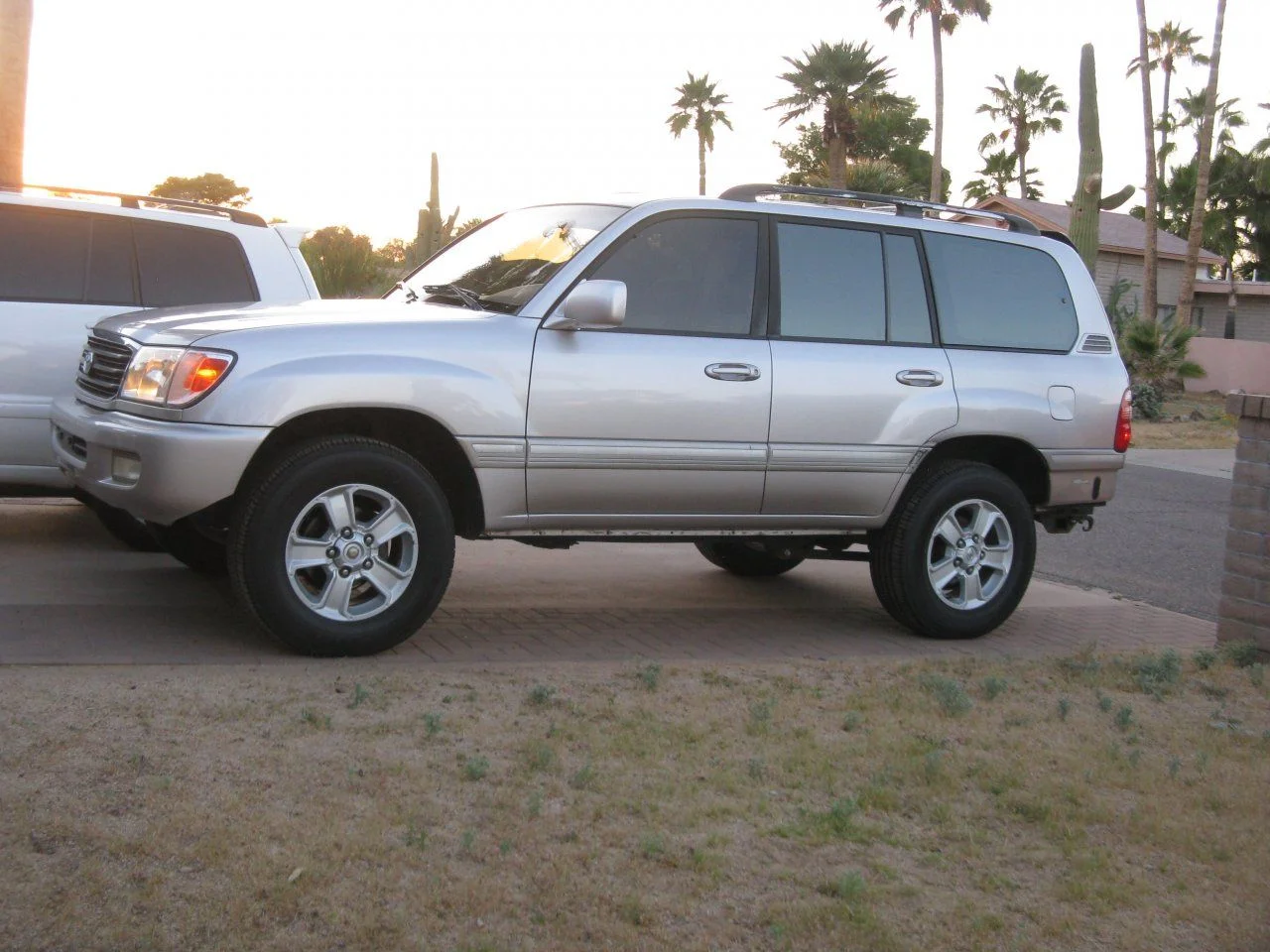

car smells like weed inside, door locks like to lock and unlock at random,wires and heater ducts fall on your feet when driving, the wrong-color steering wheel contains horn and airbag and cruise that don't work, cluster lens (glass over the gauge cluster) is missing (gives a nice 3D effect to the gauges) High beams don't work. Oh, and tail light guards and serious bull bar out
Replaced cluster lens and the 'D' light bulb. (CBT parts), eBay clock spring and blinker/wiper switch ($50) fixed the high beams, horn, and cruise control. Removed the front bull bar wings,tail light guards, and sunroof wind guard thingy. Had it detailed at Fat Fender Garage; they removed the gold pinstripe and put the clay bar and buffer to it.
...via IH8MUD app
...via IH8MUD app
Whoa, it looks really, really nice--British Racing Green is my favorite color for these rigs--it's a clean look without the pinstripes. I have to get my pinstripes removed now.

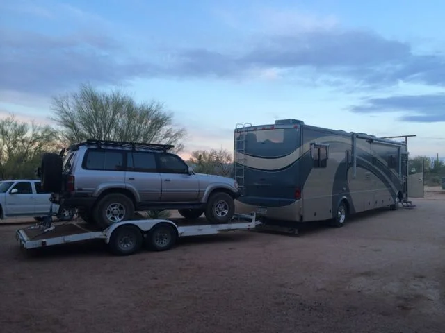

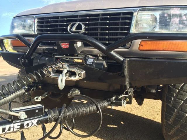

Had a custom baseplate made and supplementary brake system and wiring installed at B&M Bumper in Glendale. Towed real nice, but I did know it was back there, not on stopping, but accel. They are fat piggies.
