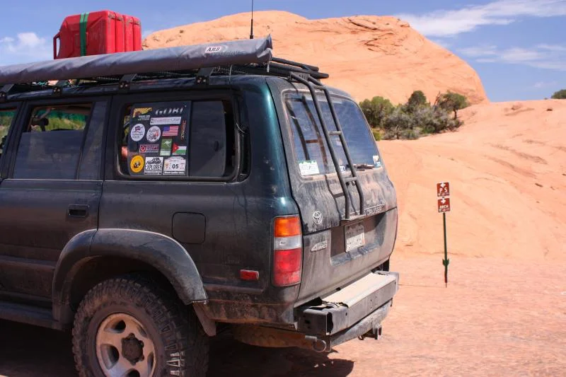

Correct you need to call them. Here are the pictures they sent me back around Xmas
Just buy it so I can check it out:flipoff2:
Hoe does the bottom mount to the hatch?

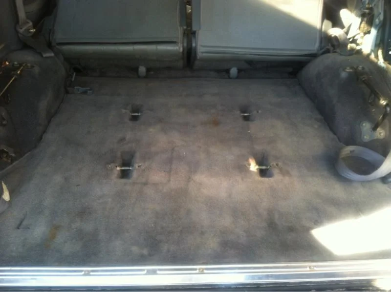

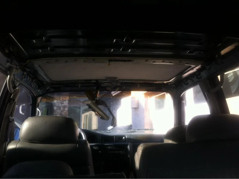

Changed out the old broken sunroof and the headliner and interior trim is all getting a bath. Also installed rear seats and cargo area carpet. This cruiser is going to be pretty clean when I am done with it...
Sent from my iPhone using IH8MUD

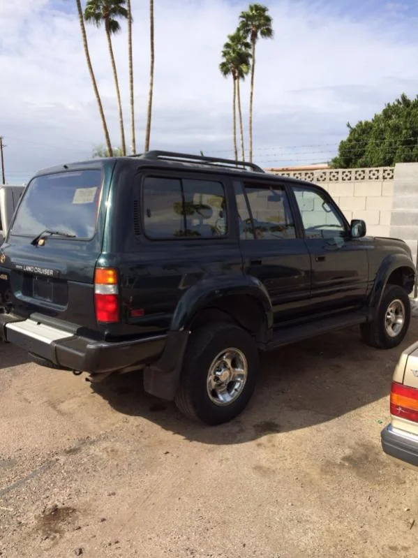

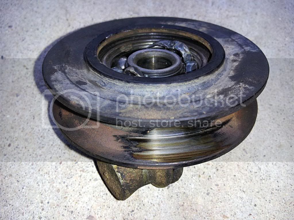

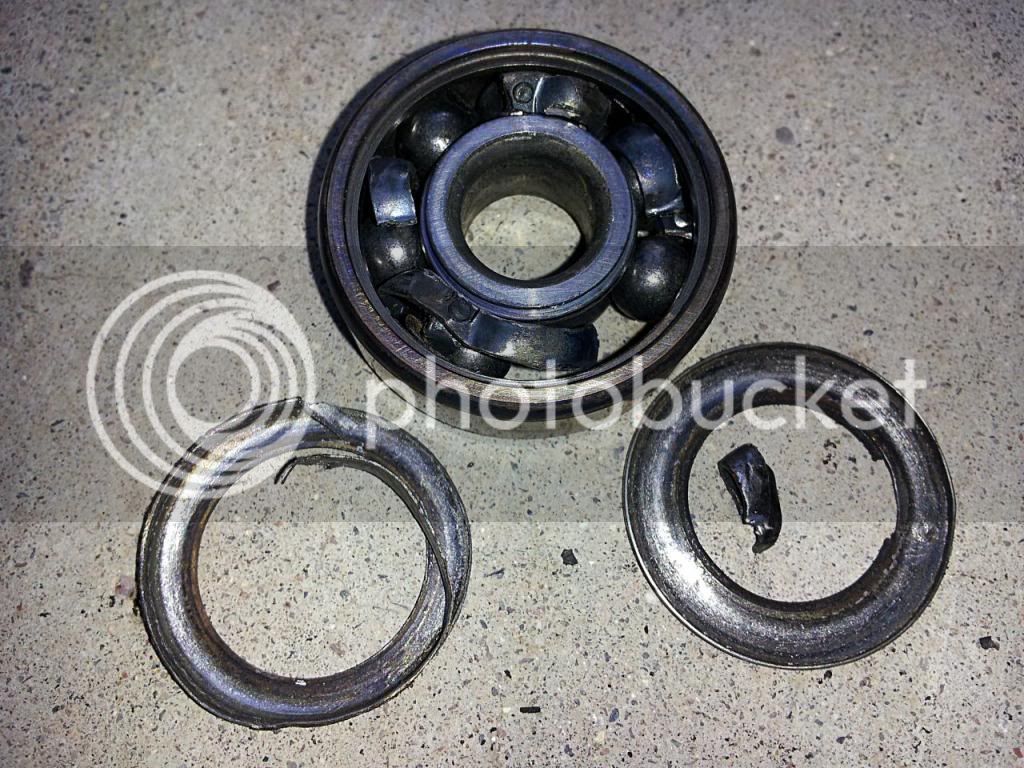

Found a nice sized puddle under my new (to me) 96 80 series. Thanks and props to Kevin and John for replacing the hose that seemed harder to fix than the PHH!
Also thanks for diagnosing a *hammered* u-joint in the front drive shaft. It's cool that once all of the needle bearings are gone, the joints use the lack of grease and the accumulated rust to round out the inside of the bearing caps. Only on 2 of the 4 sides of the cross though.
Turns out that was the vibration at 75+mph. Sans front drive shaft, it's smooooth at 80 and beyond!

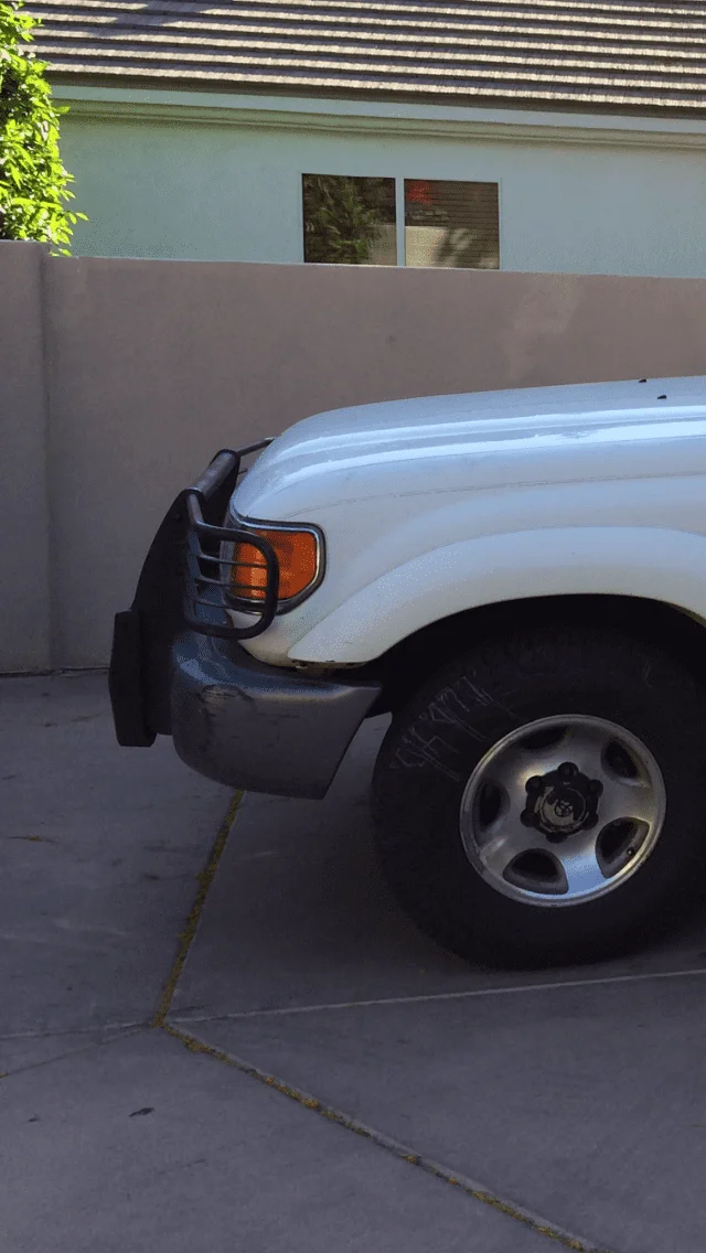

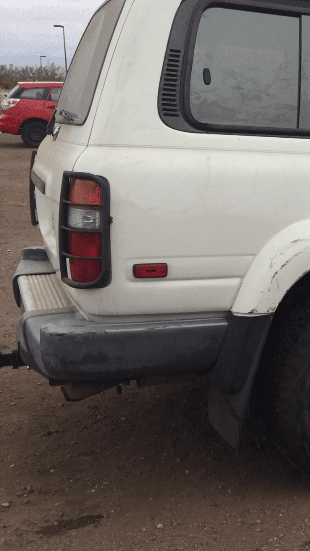

Lastly, thanks for the ridicule about the following:
car smells like weed inside, door locks like to lock and unlock at random,wires and heater ducts fall on your feet when driving, the wrong-color steering wheel contains horn and airbag and cruise that don't work, cluster lens (glass over the gauge cluster) is missing (gives a nice 3D effect to the gauges) High beams don't work. Oh, and tail light guards and serious bull bar out front.
perfect to take out on the trail tomorrow :hillbilly:
