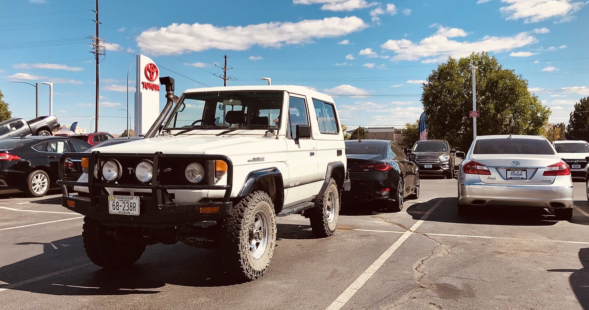

Maybe someday you will be able to buy one from a dealer in the US...:hmm:
Or not.
I'd love to see them Change the 25 year or older rule for import exemptions to say 15 years. 1995 is still a fairly modern vehicle that does most everything I want but doesn't have anything I don't need or do anything I don't want. There is also tremendous economic value in driving a vehicle that is no longer depreciating, but is unique enough to be going up in value and getting compliments from people when you drive it.
Lobby your lawmakers. That's the only chance you have. You will fail miserably, but you tried.
I hear ya and would love to see the rules relaxed as well. On the other hand, it's great to at least be able to bring in 25+ yo vehicles relatively easily. I'm more concerned that the rules will tighten one day.

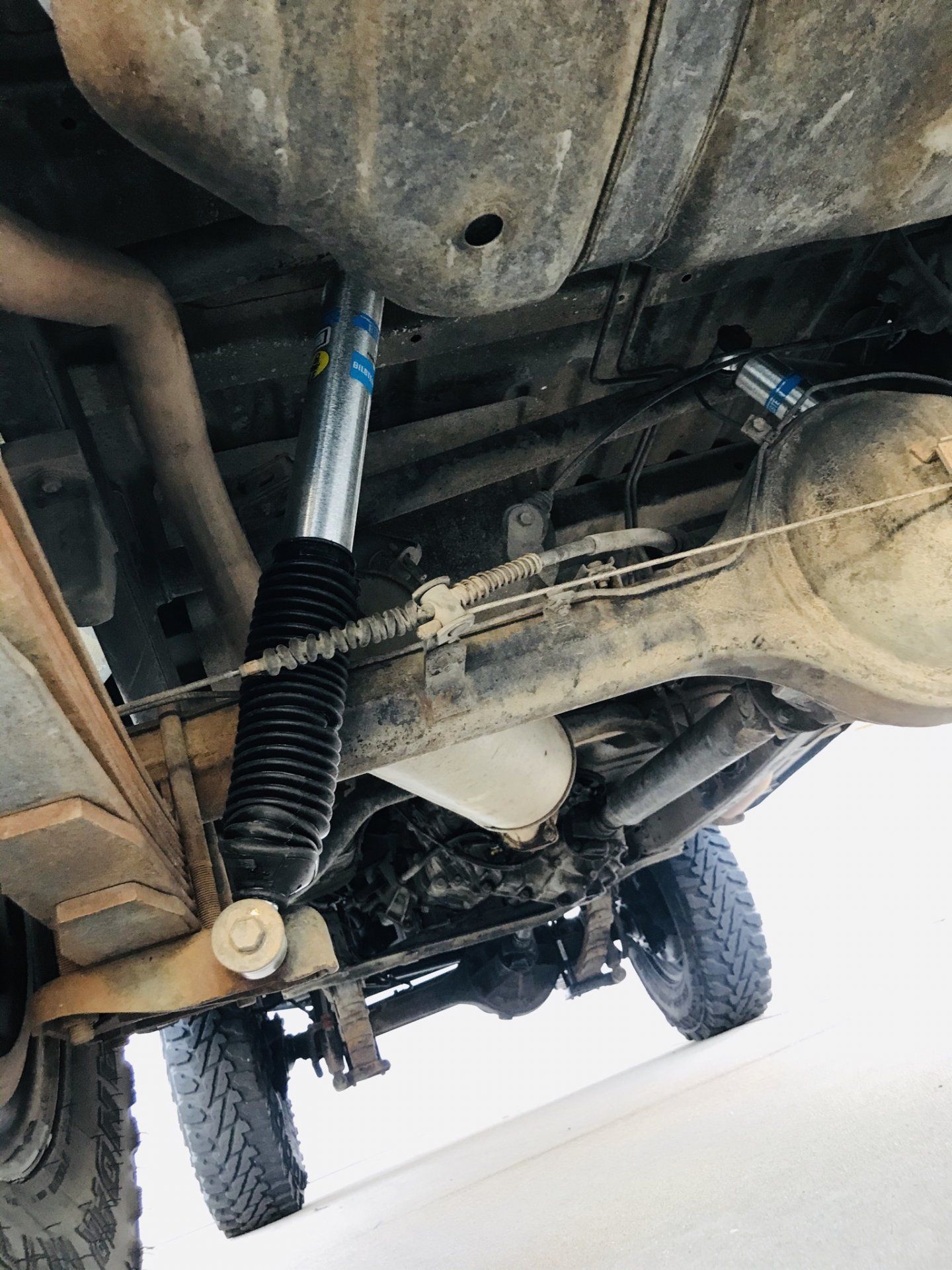

notice any difference with the Bilsteins?
For sure. the Bilstein are much less harsh over bumps. They seem to absorb everything much smoother. I haven't done the fronts yet, but they are on the very soon list. Once I get all the shocks on, I'll have a better feel of the whole system.

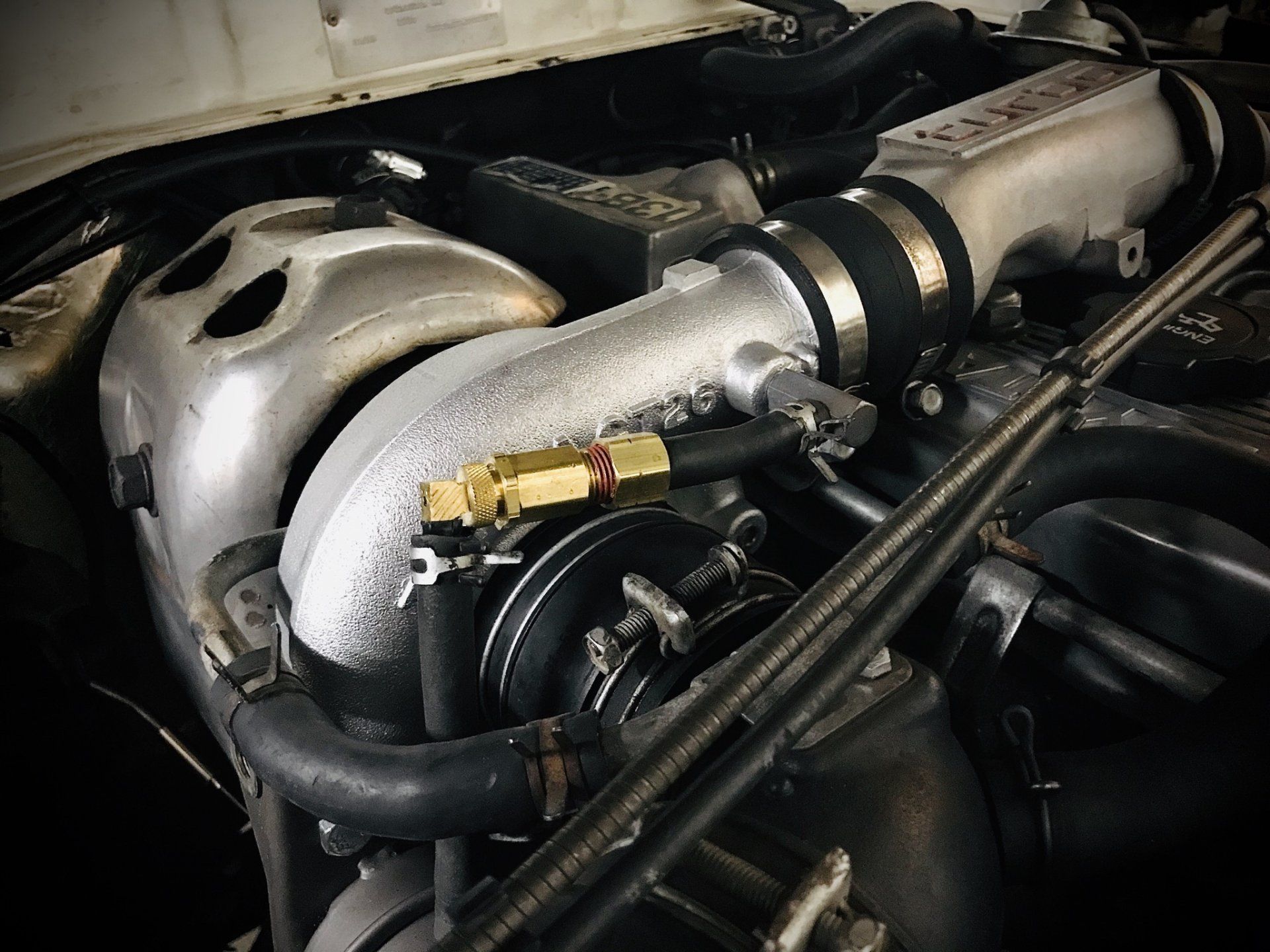

After billowing plumes of exhaust when cold-starting the 75 when temps have dipped into the 30s, I installed one of these in the lower radiator hose. We had just north of freezing temps last night, so I plugged it in for about two hours this morning and the Cruiser fired right up. No smoke, no sputtering down the block, it blew hot air immediately and aside from letting the gear oil warm up a bit drove like I had just finished driving it. Highly recommended. I'm going to get a timer and have it run each morning from 6-8am.
My hope is I'll be able to run this off our 1200W Renogy / Sine Wave home battery when camping too, since most of our spots are at 10,000'. Nothing ruins peace and quiet like rough cold starts. I think if this is a 500w device we'll be able to run it for 1.5 hours to help out without draining the house battery (which charges right back up once the truck is on anyway).
