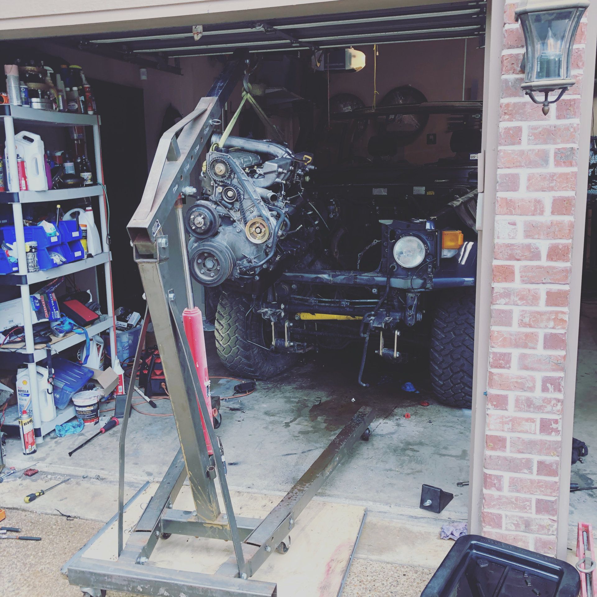

Proyect HDJ75 (will be pickup)
Firts suspension test with LX450 axles
Pending:
- rear spring perches on way
- searching 80 lower arm bracked
- searching front lateral control rod
- searching 78 crossmember
Only that for this year
Regards.
