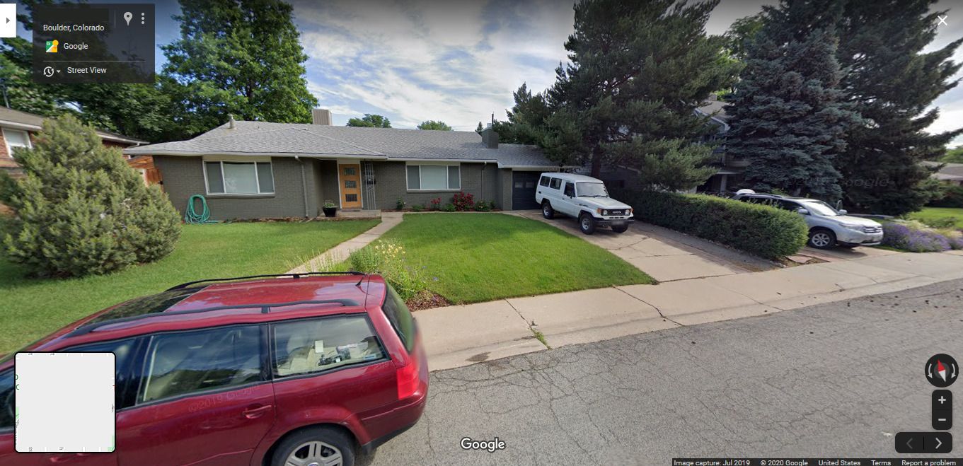

I noticed today that Google used this image for the shop....
Ha! I had to check, and this is the one they used for my house:
My house is hard to spot :D

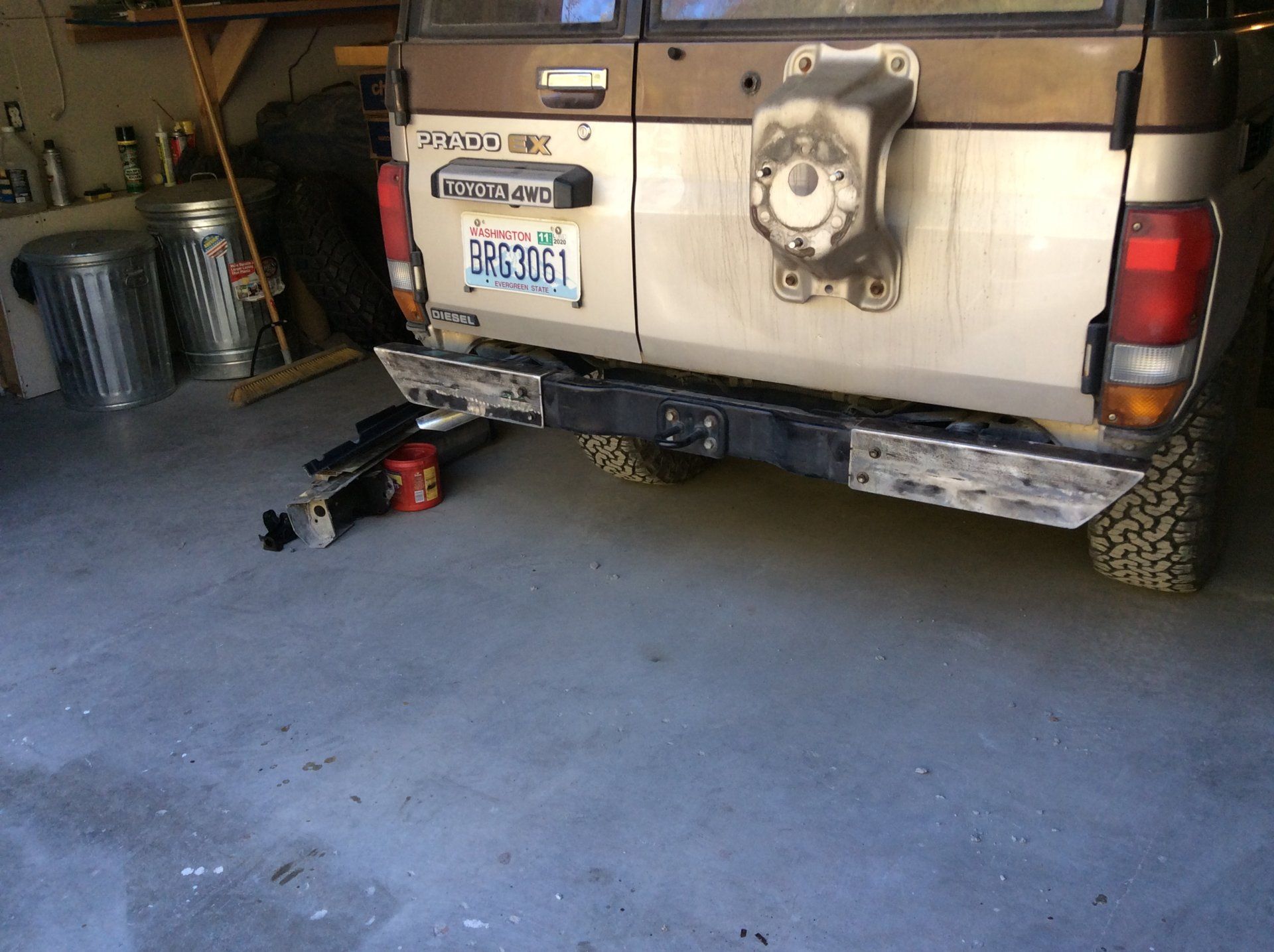

Started work on my new rear bumper. Original bumper was cosmetically good but structurally weak. Could not use a high-lift on it without completely deforming it. New bumper will be 2x4 .125 wall with rock sliders to the rear fender well. Receiver hitch will be welded bottom center. Will try to have some angled corners so it doesn't look too boxy. Style will have to follow function with this one. I need some space for swing out tire and equipment carrier I also need to be able to climb on it and jack it. So it won't be as low profile as some of those sexy rock crawler rigs. Got the basics tacked together today. Angle trimming full welding and detailing tomorrow. Grinding and painting by Sunday. Pics later.

Bumper taking shape. The bj73 is from Spain so it has those goofy blacked out lights on the back corners. Tail lights brake lights and turn signals were mounted in the bumper. I was going to mount the factory lights as is inside the new bumper, but they are too deep to fit. I'll do some surgery on the lights use only the original lens and lamp sockets and configure them into the bumper. I intend to have Jack mounts fuel can mounts etc.. covering up the original blacked out lamps on the corners.

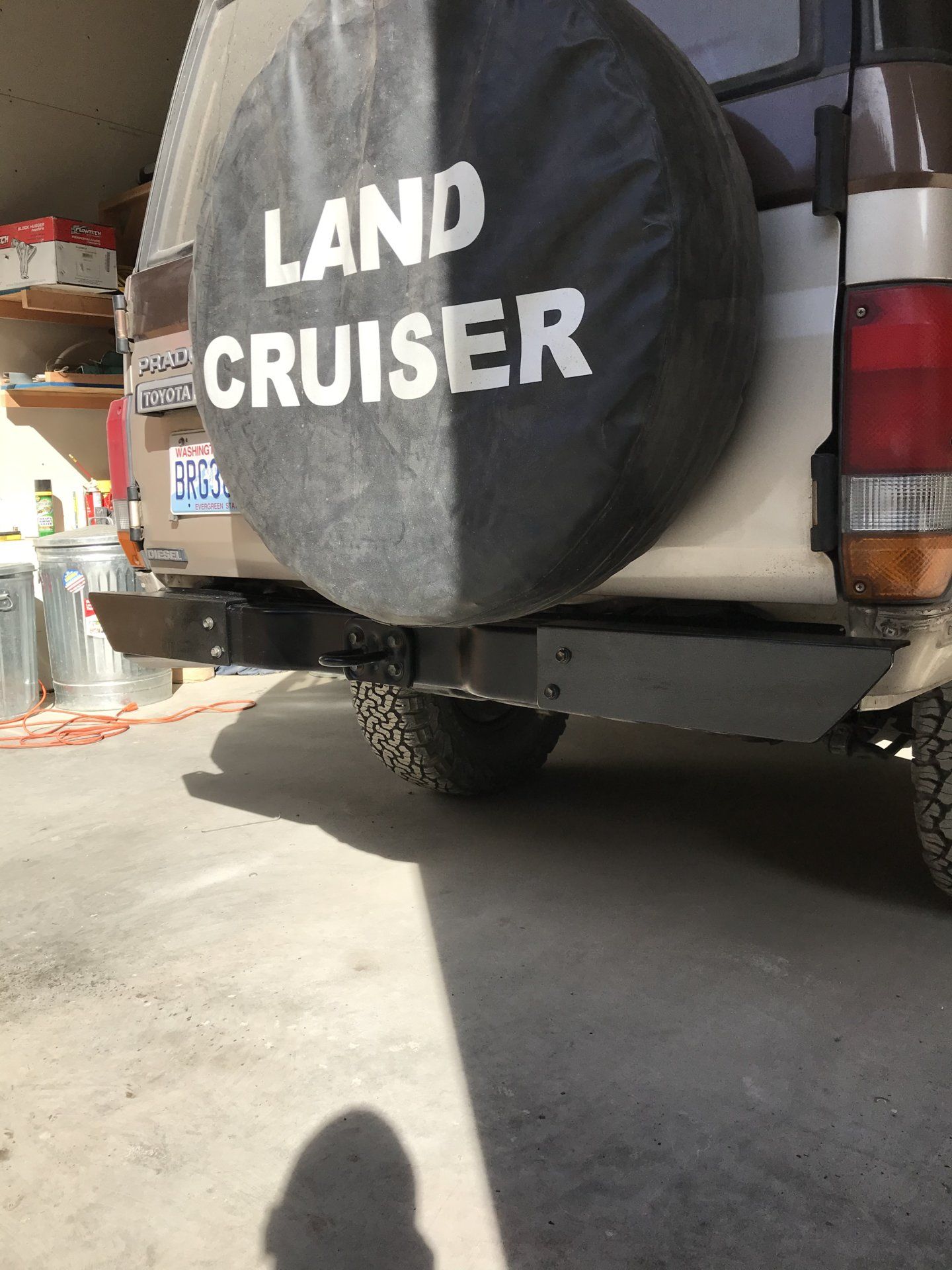

I was looking on line for a budgety high clearance rear bumper. I stumbled upon a picture of what i thought looked like a very practical solution. Just a couple peaces of 3/16” angle and flat bar cut and welded together. A day for the paint to dry and boom.
A classy lookin rear bumper. Just made from junk i already had layin around. Getting rid of that flimsy oem rear bumper gained me about 2 1/2” inches of additional rear end clearance.
