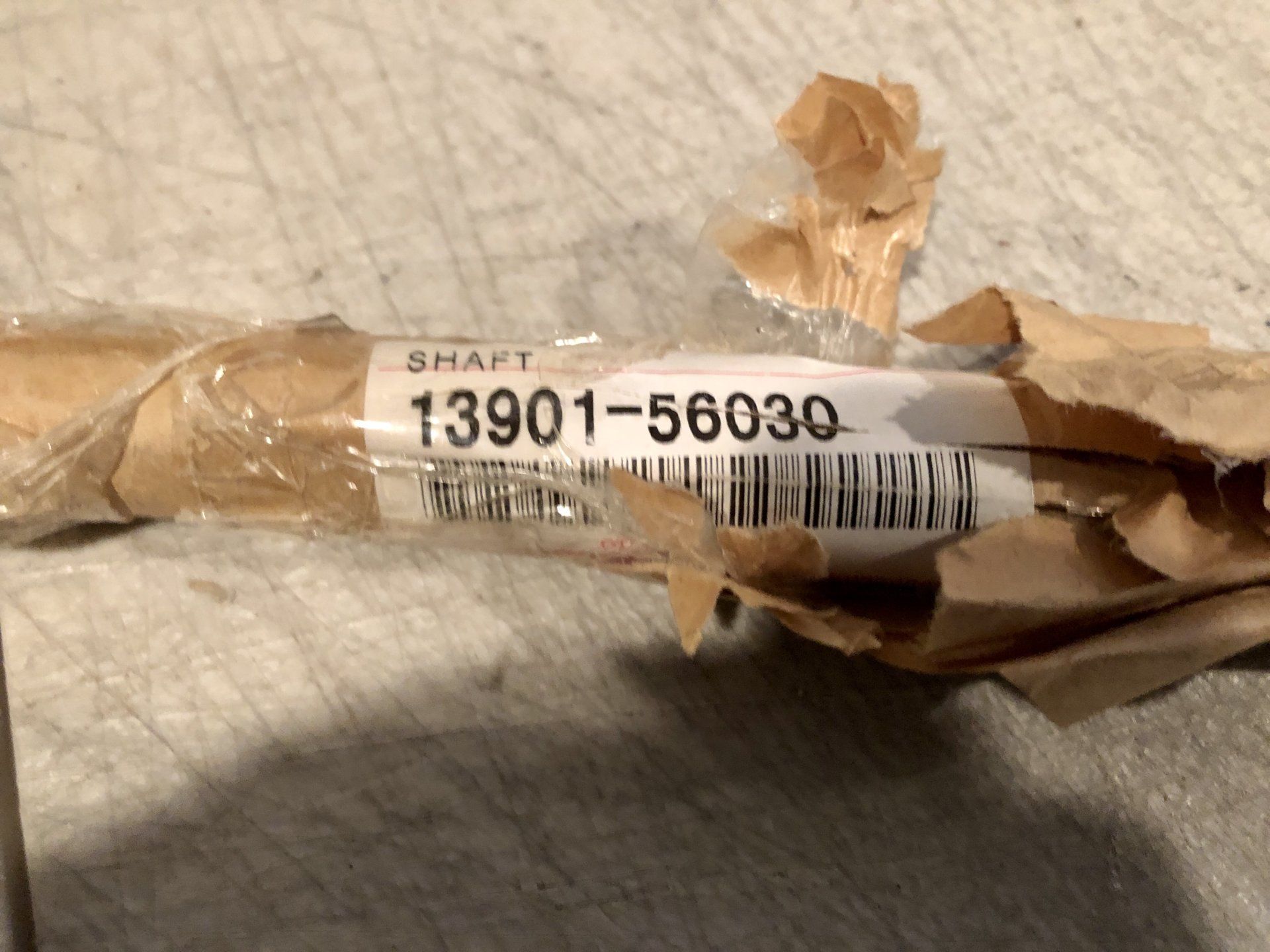

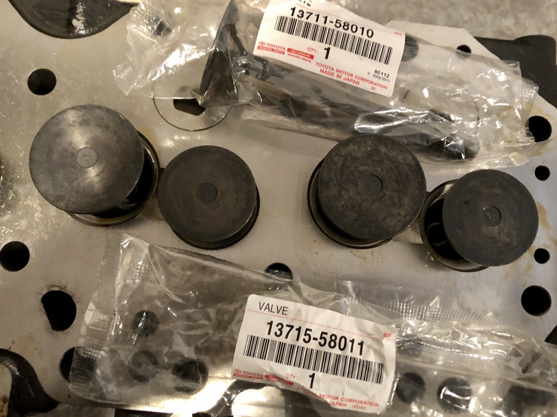

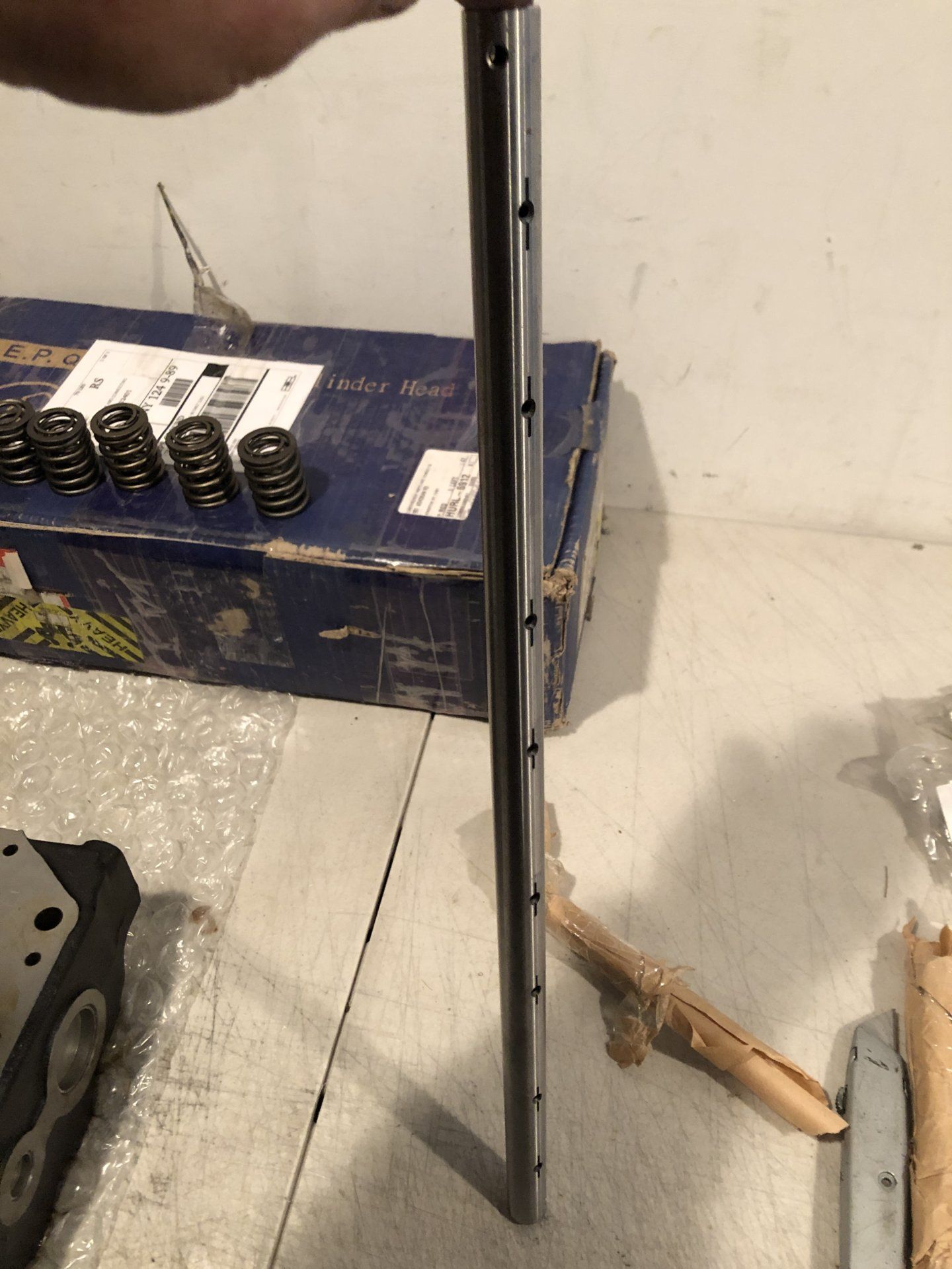

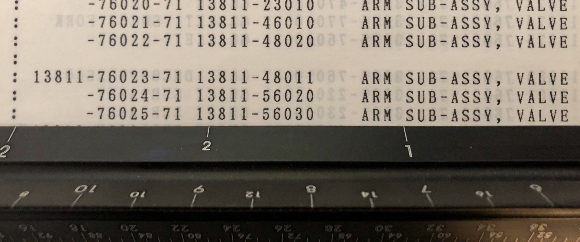

Luckily, I sat and thought about the arm situation and then had my "aha" moment.... 3B's were put into Toyota forklifts.... Off I go and pull out the conversion book:
And the rocker arms indeed crossed over:
So, called my Toyota Forklift dealer and the parts guy said these were good numbers. I asked if he could see national inventory and he unfortunately said he didn't have access to that. Bummer. So, I went ahead and ordered 4 of each. No harm in not trying. We'll see in a week or so if the arms are indeed available in Toyota Forklift format.

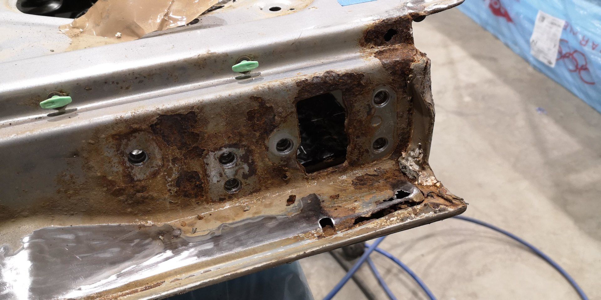

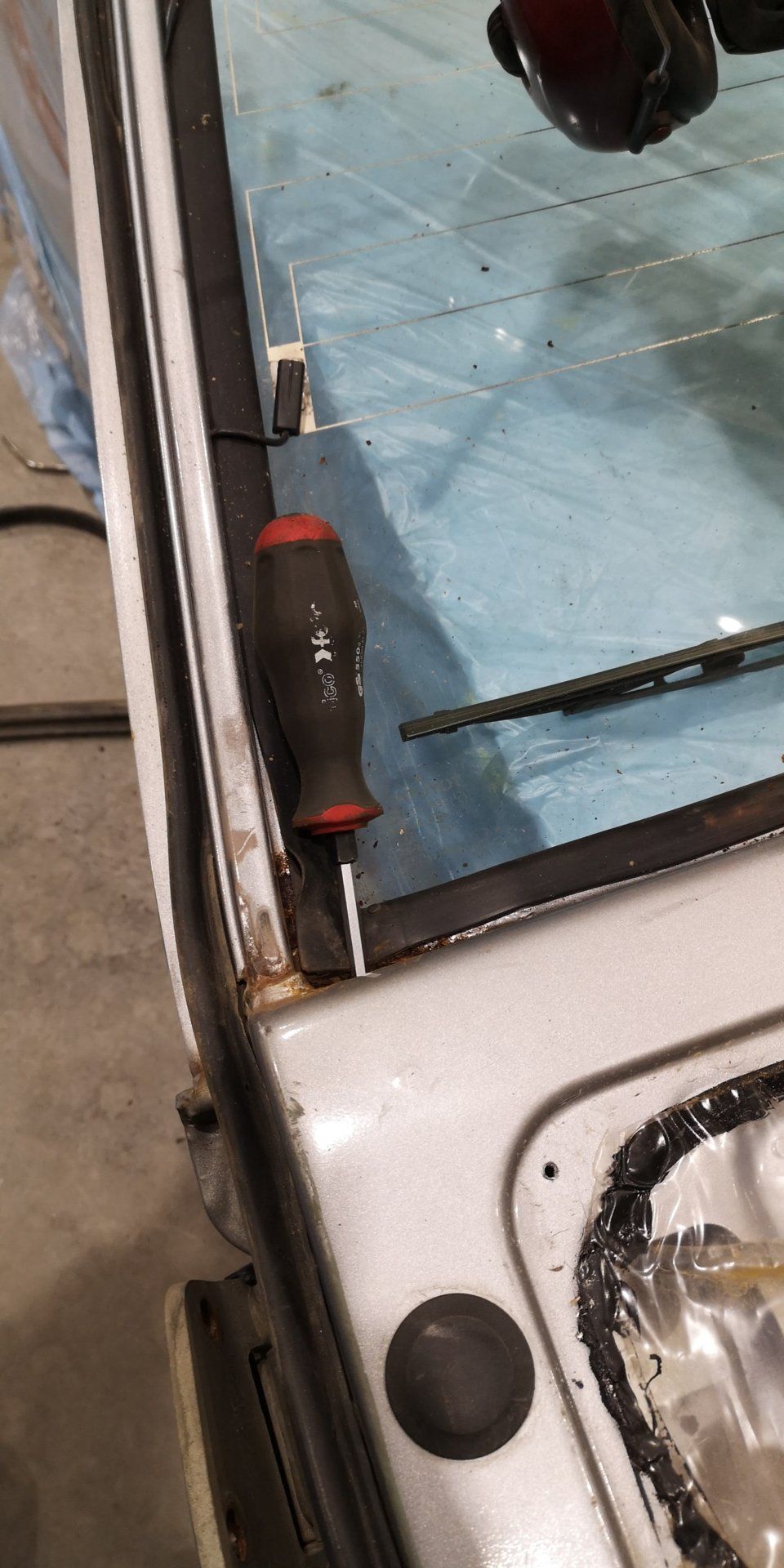

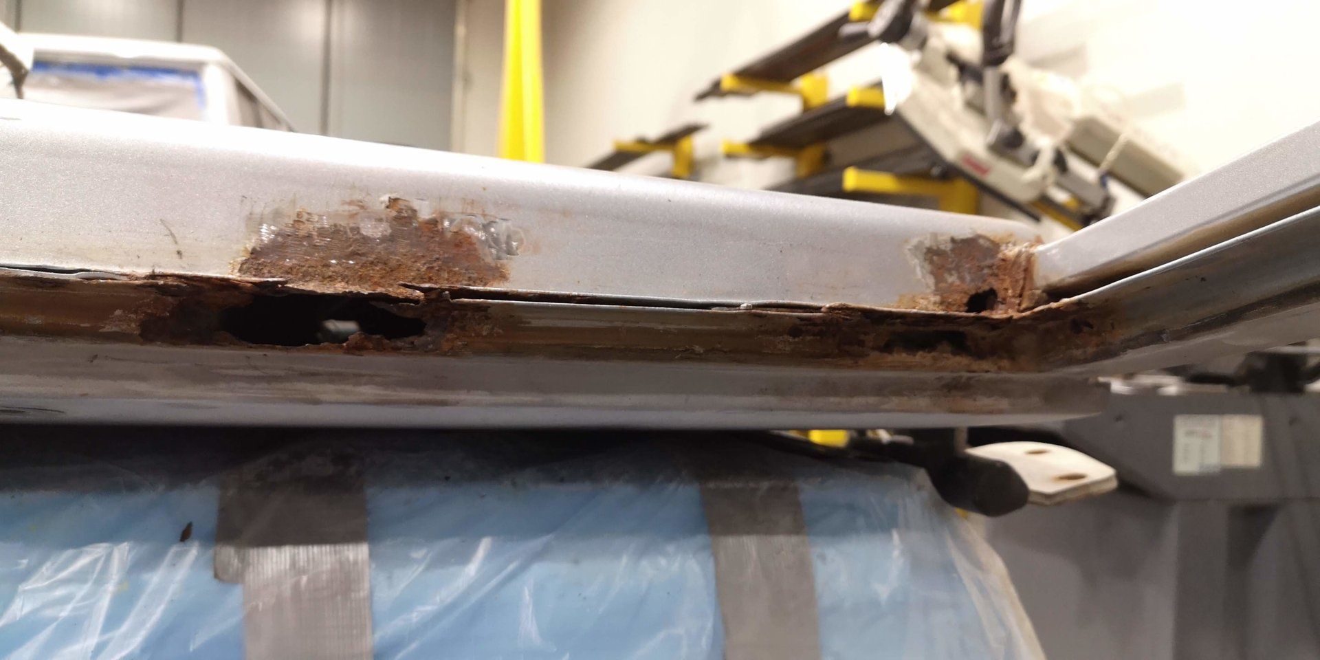

Hit what you can with a wire brush and then saturate it inside and out with a "rust converter" sprayed from a pump up garden sprayer. Spray inside panels with a thinned out asphalt roof tar after the rust converter sets. Use "kitty hair" filler as your base filler.......If you don't drive in saltwater it should go at least 10 years before the rust comes bubbling back.

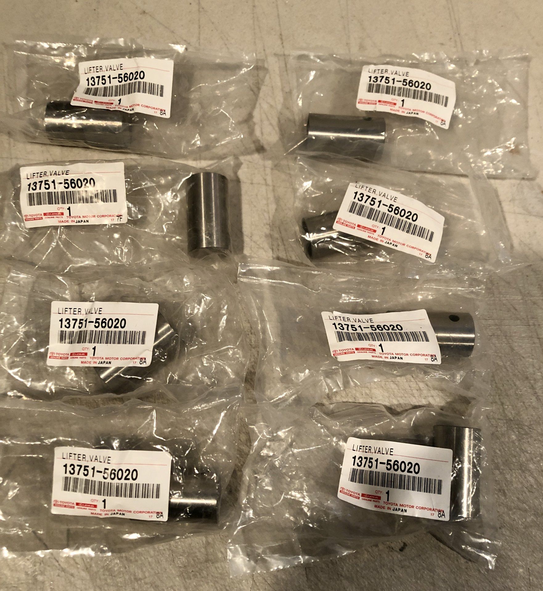

Best to have new OEM parts....View attachment 2253308View attachment 2253309View attachment 2253310View attachment 2253311
