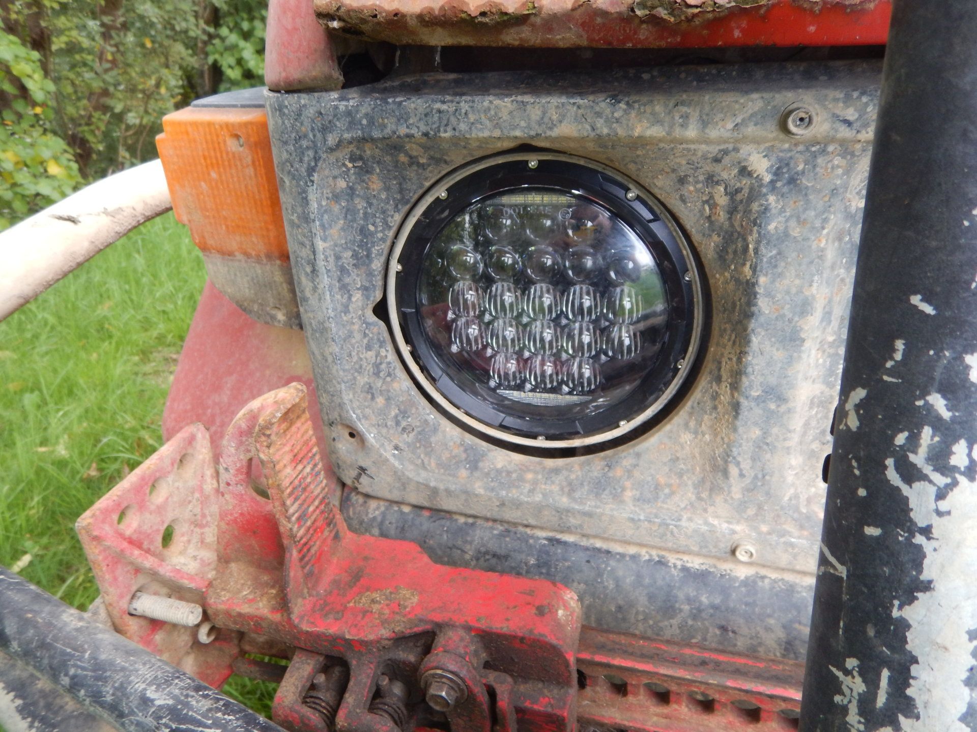

I bolted up a set of cheap LED head lights
I bought them for my 40 series but I don't think they're legal on the road in new zealand, so i threw them on my bush truck
Its kinda like putting lipstick on a pig
But there is some decant light coming off them

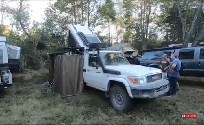

It appears that some of our own were YouTube celebrities at Expo East. :)

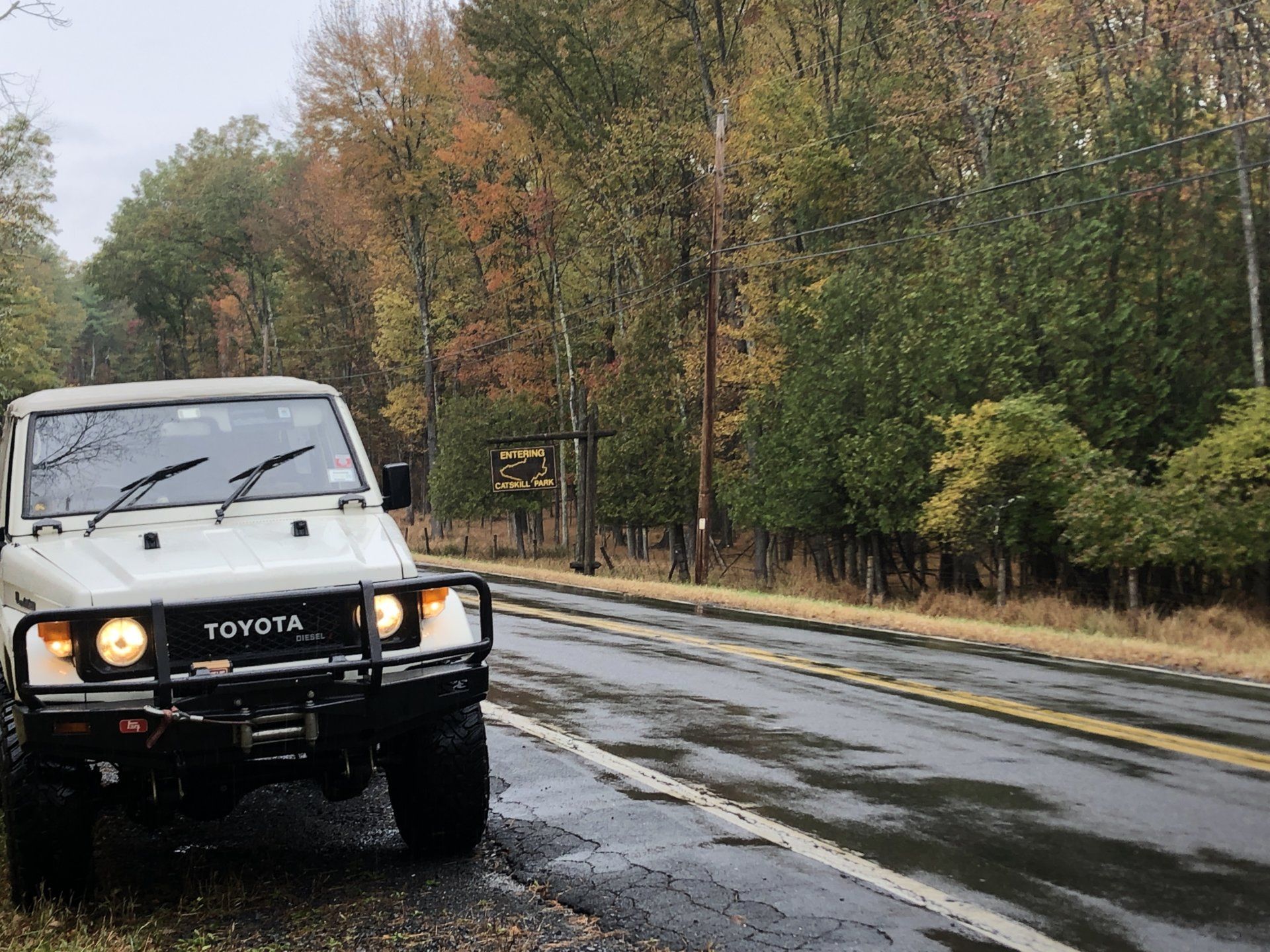

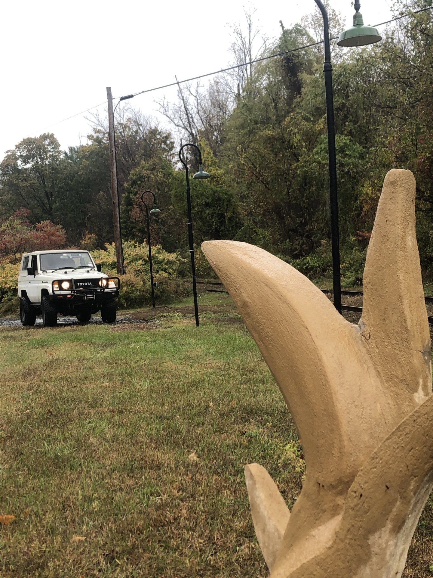

Fun time for sure....not as many 70s as I thought would be there. Maybe 5? Saw a 75 pickup, Andrews Troopy, Nicks 77 was there(didn't see it though) and maybe some short wheel base ones. TONS of 80, 100s and 200s as you would expect and an insane amount of Tacomas. Tacoma overload. There were 3 60s that were probably the cleanest 60s that existed. Gorgeous. But the best one, and I'm biased because I have one and because I sold parts to the owner, was this one....
Hell yeah, can't be too many 45LVs on the east coast!

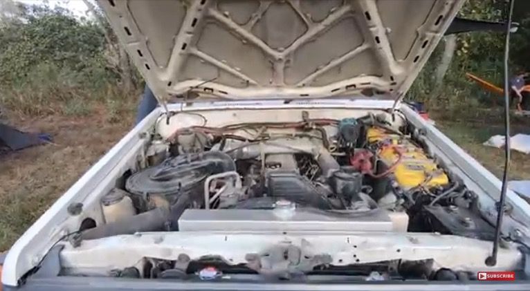

I left the Expo on Sunday, drove to a trail in VA, proceeded to have a fan blade break off and go thru my radiator about midway thru a 17mile trail. Not a challenging trail but challenging enough and slow going...especially with a radiator with a big gash. Was able to limp it to my folks house in NoVa about 200 miles away, ordered a radiator from Partsouq in Dubai Sunday night and by Wed at 830 AM, a new radiator was in my hands. Popped it in and drove it home to FL 900 miles without issue. Even had time to give it a good wash while waiting for the new radiator. Truck was filthy from TN still.

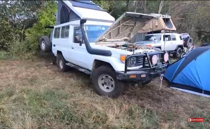

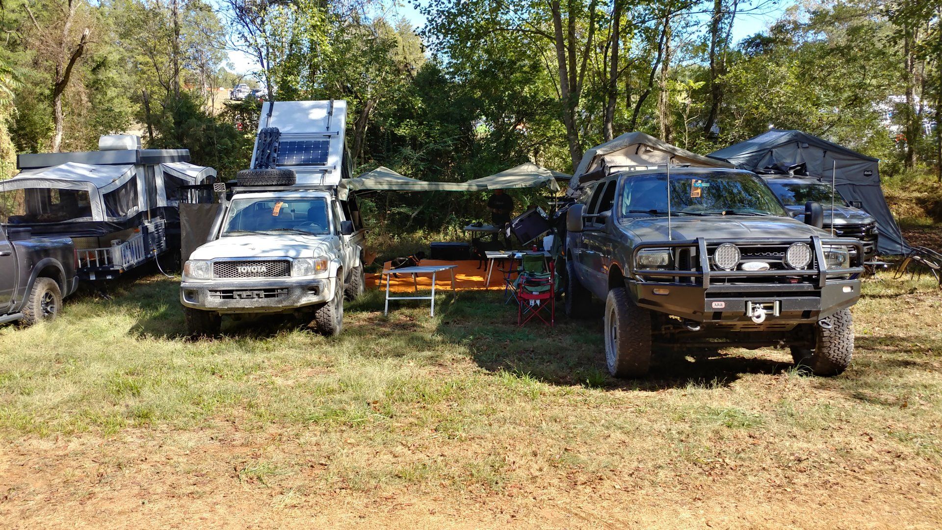

Our spot at Expo....
When times were good.....before the fan and blade went their separate ways:
Maybe 20? Hard to know for sure. When I saw that one my jaw dropped and there was nothing else that mattered. I knew that truck from it's build thread and a lot of convos the owner and I had discussing things...mine was being built at the same time.
