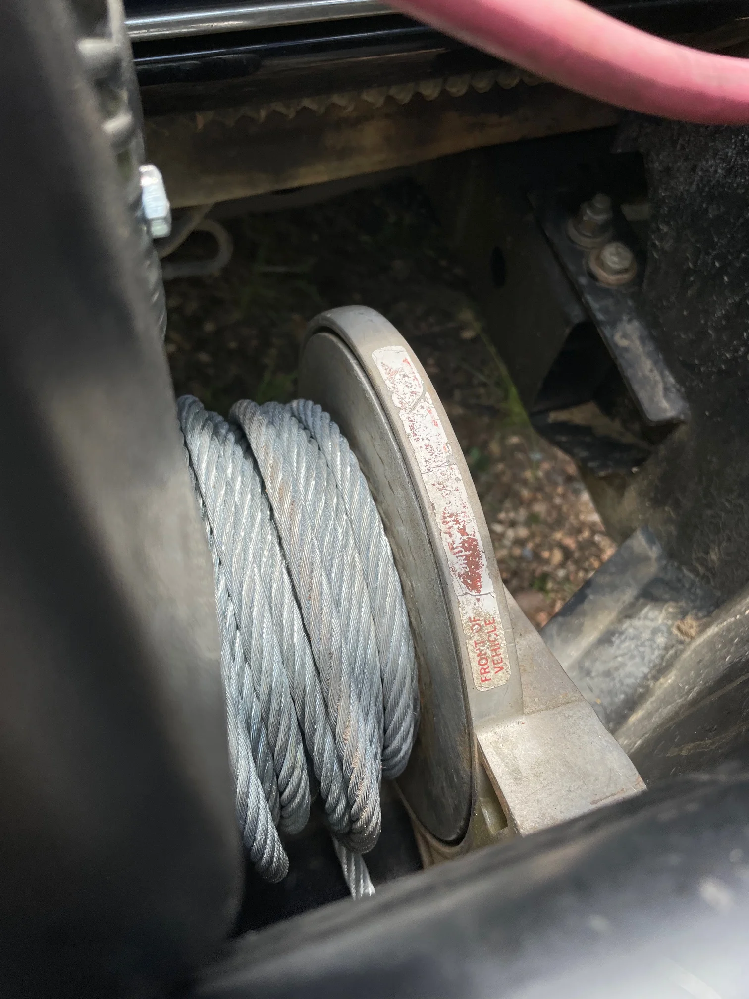

I wondered how much 3/8" cable could be spooled on vs the original 150' of 5/16" cable. Is that all you could fit on the drum or just what you happened to have and it fit?
Scott in AZ.
This is one side of the drum, the other is similar so maybe 150 of 3/8" would fit.
