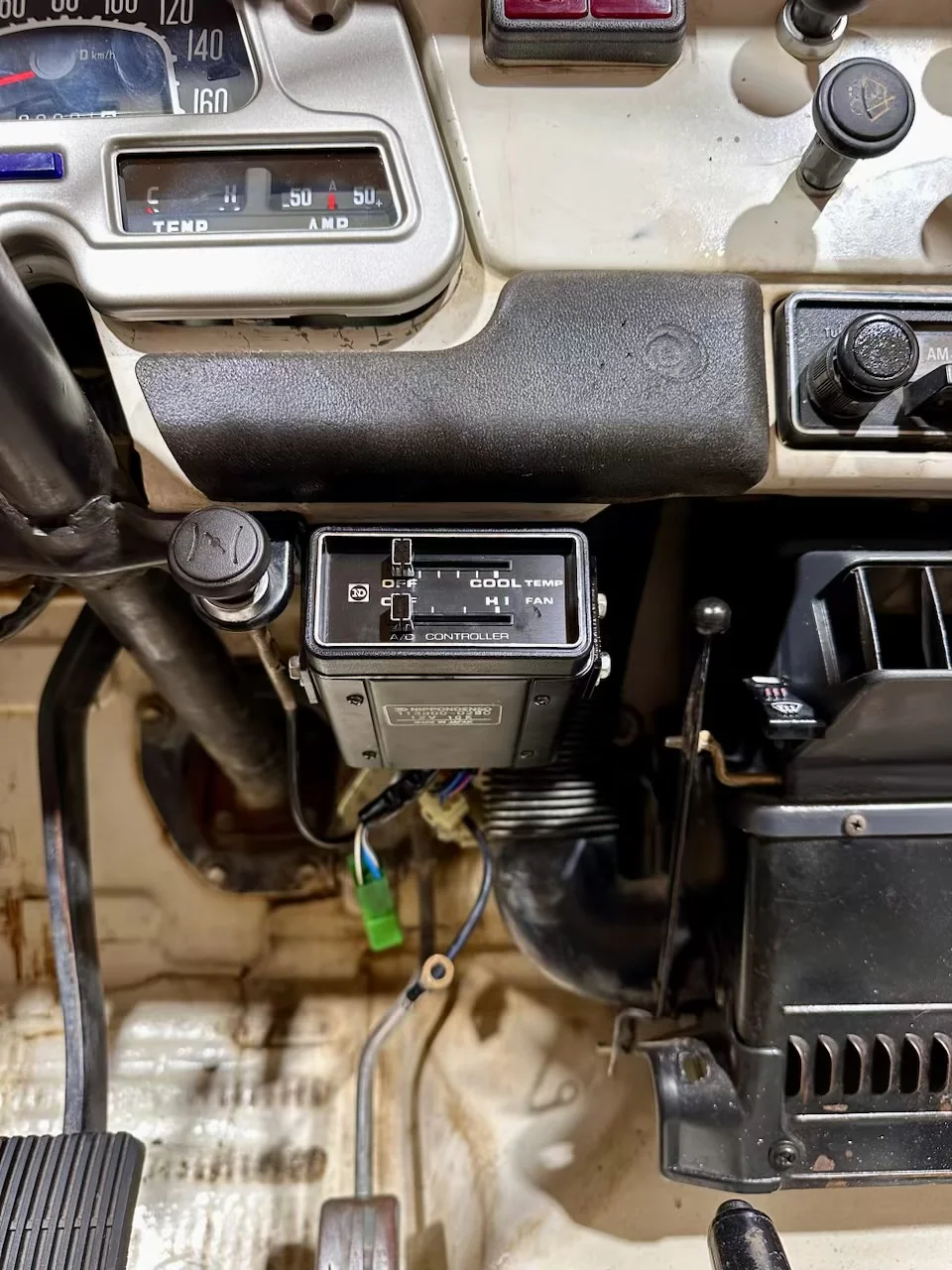

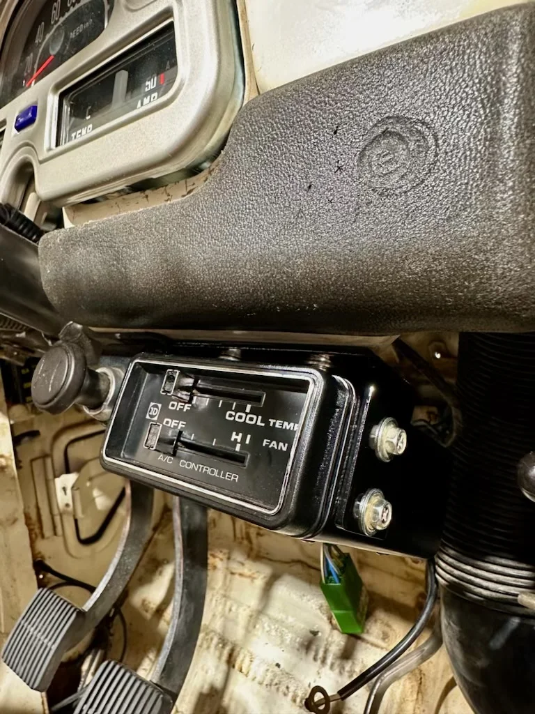

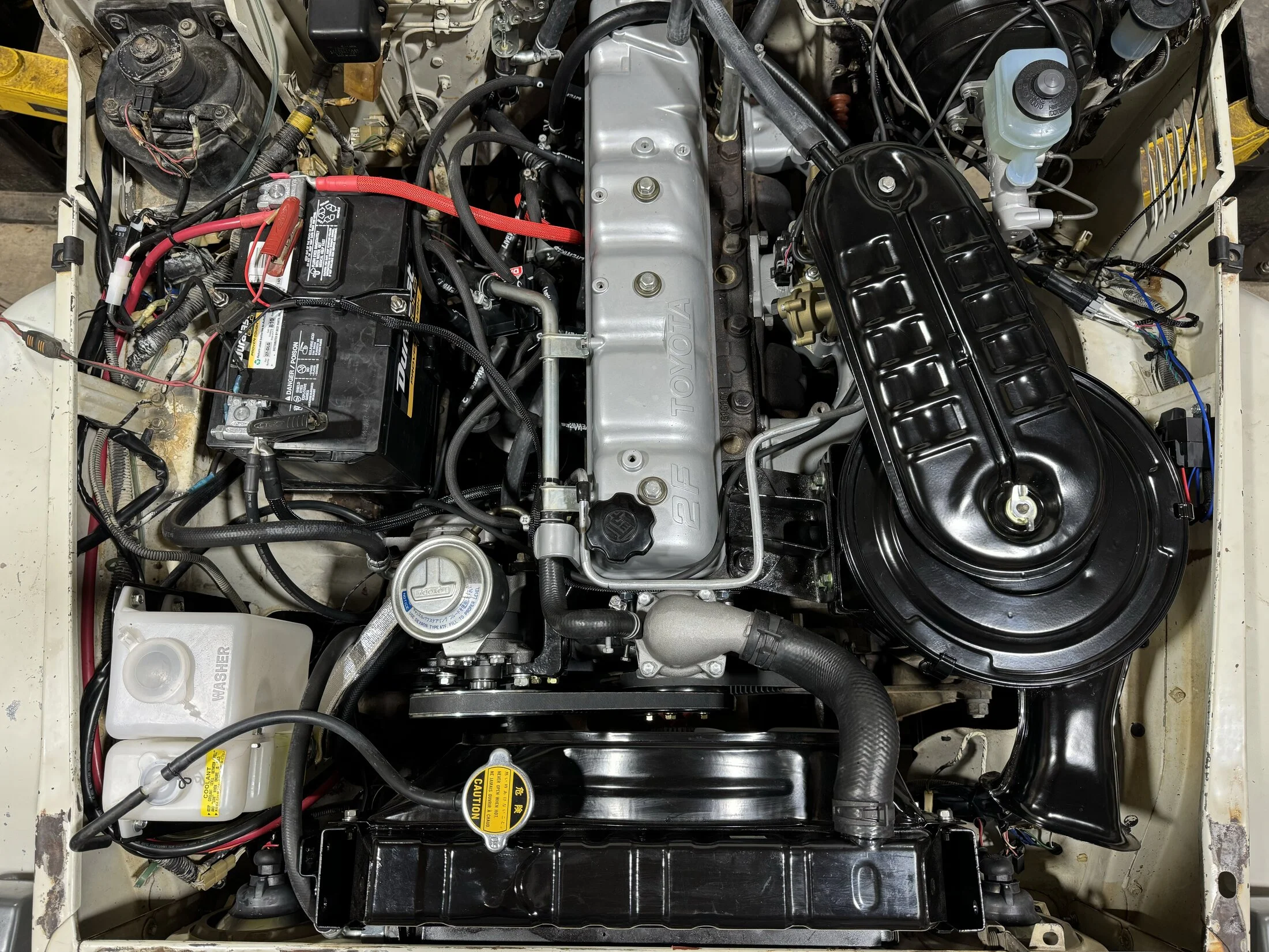

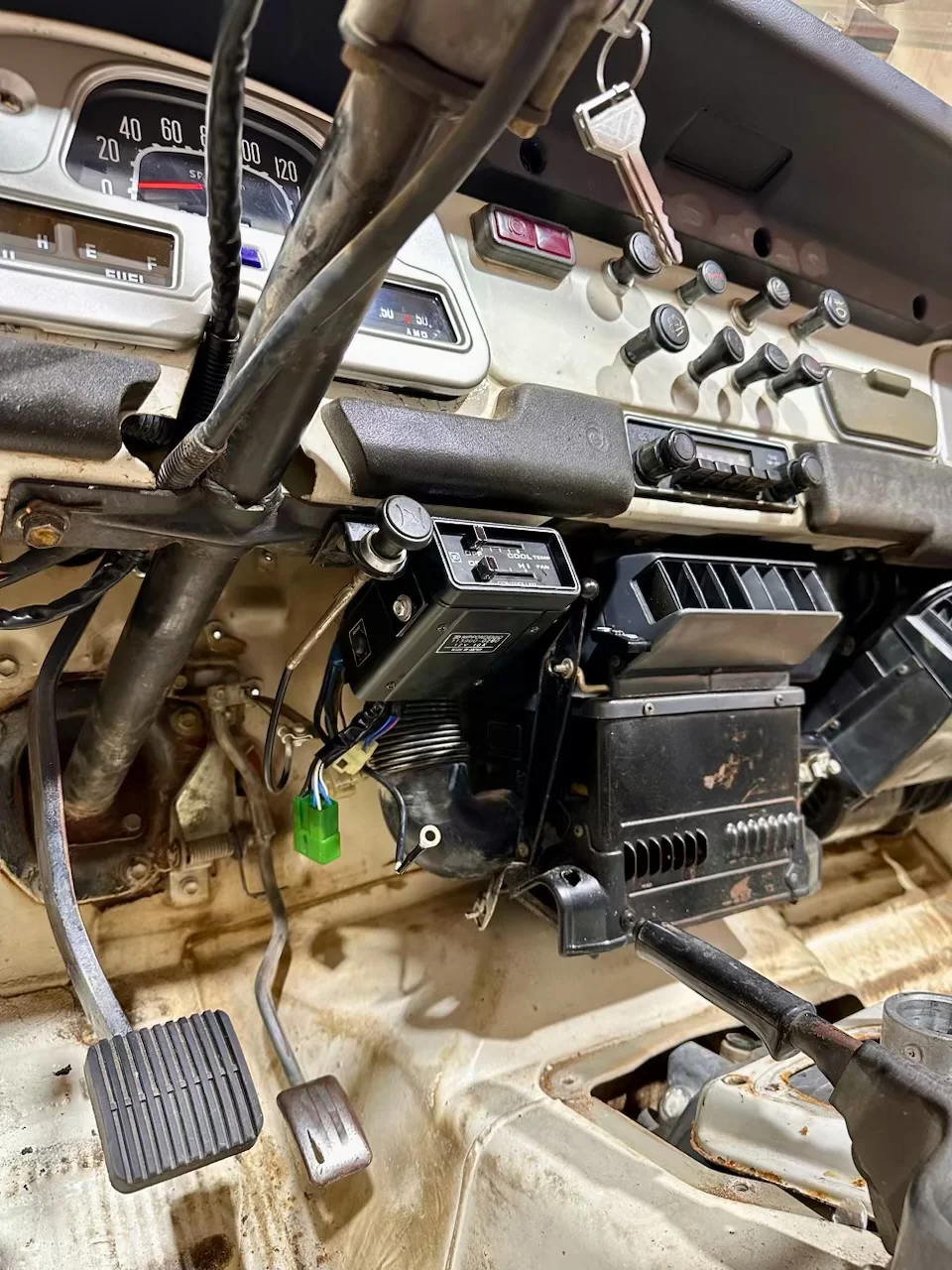

Aight. Got the AC pulled and the leak fixed and the coolant filled.
IAC is set.
Timing is set.
All of the gauges are working in the new cluster
Was a very very productive day.
The list is getting shorter.

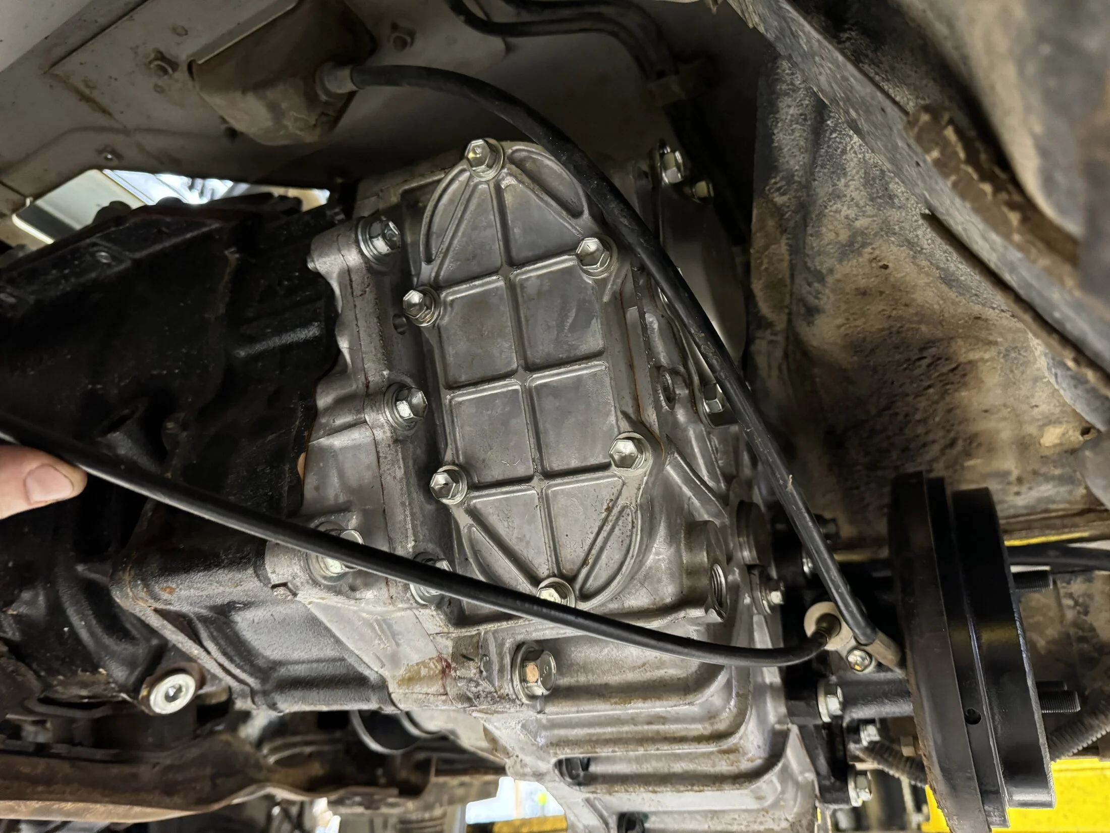

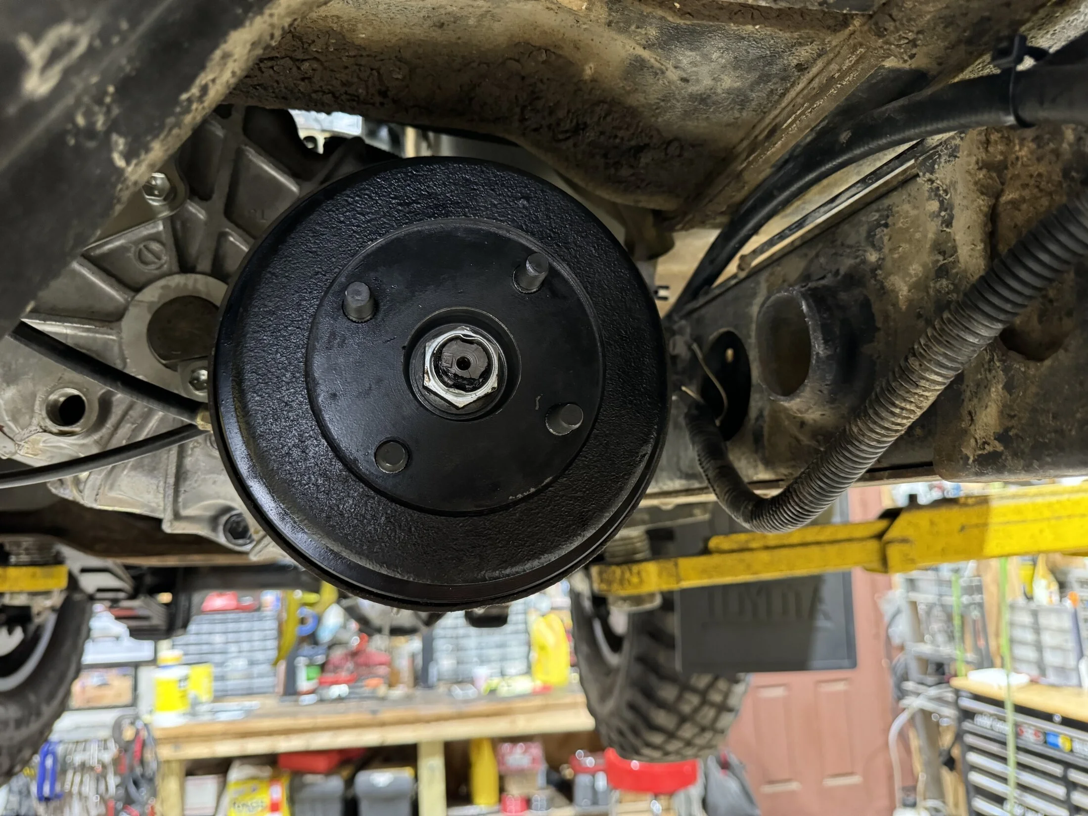

Good things. The ebrake cable and speedo cable had the extra 4” to allow for the H55
I would love to see how Toyota did the torque tube in FJ45s with the factory 5 speed and the under fuel tank. Anyone out there have one?
I can’t say for sure about the FJ45 but at least to the best of my knowledge the HJ47 never came stock with the 5-speed H55F.
Japanese and European market BJ46 models are the only variations in a long wheelbase I can find of a 5 speed and that's only from '82 to '84. All FJ45 models worldwide appear to have been 4 speed.

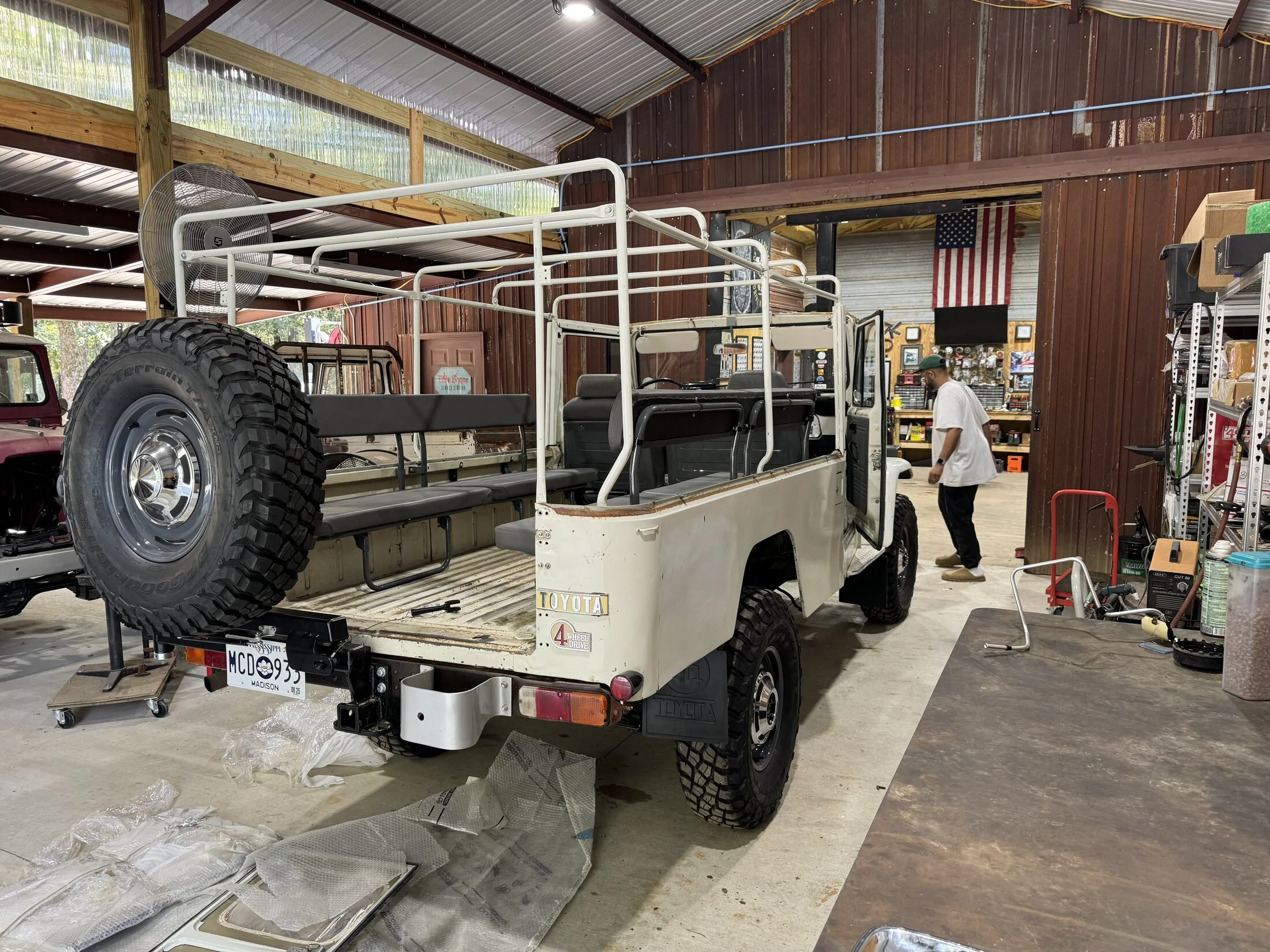

Wrestling 150’ of steel cable off the drum is always a good time.
I did an h55 swap years ago on an 83 hj47 pickup. Besides the bellhousing clearance it all bolted up. It was very close to the torque tube( no ebrake on the later models, but it barely snuck in. Also did an 82 bj42 and it was very close too, but fit! Another great build Nolan!
Yeah the Ebrake was the game changer here. Zero chance it goes back in where Toyota said so.

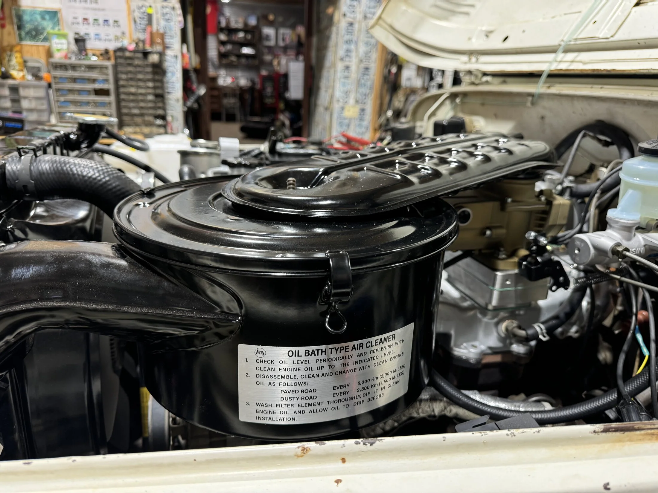

Finally got the throttle cable installed so I could install the air cleaner.
Engine bay looks 💥💥💥💥

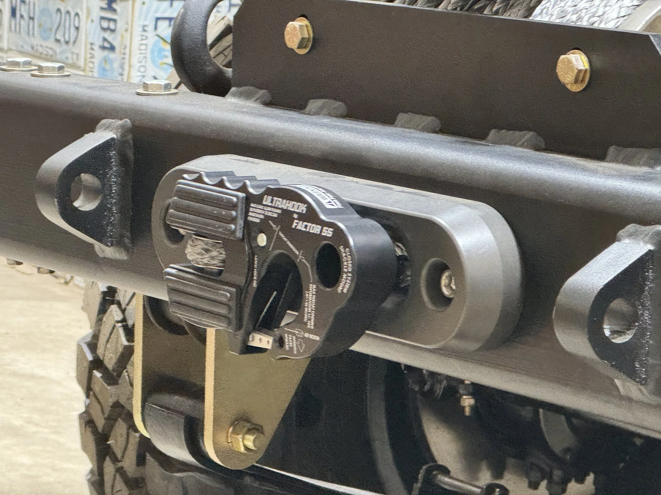

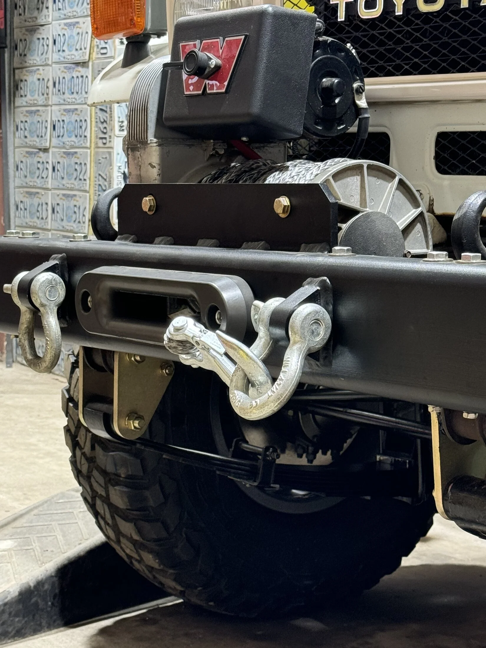

Ben did not like the space age hook so he got a Warren hook
