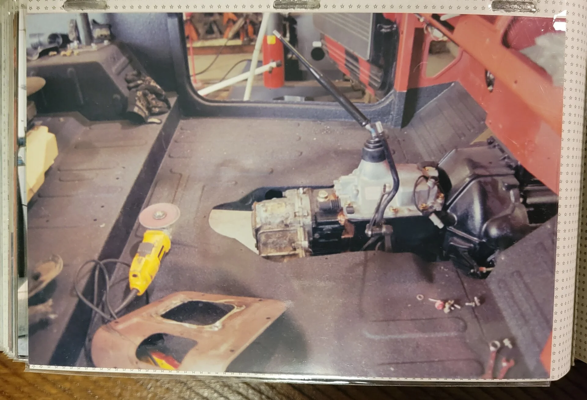

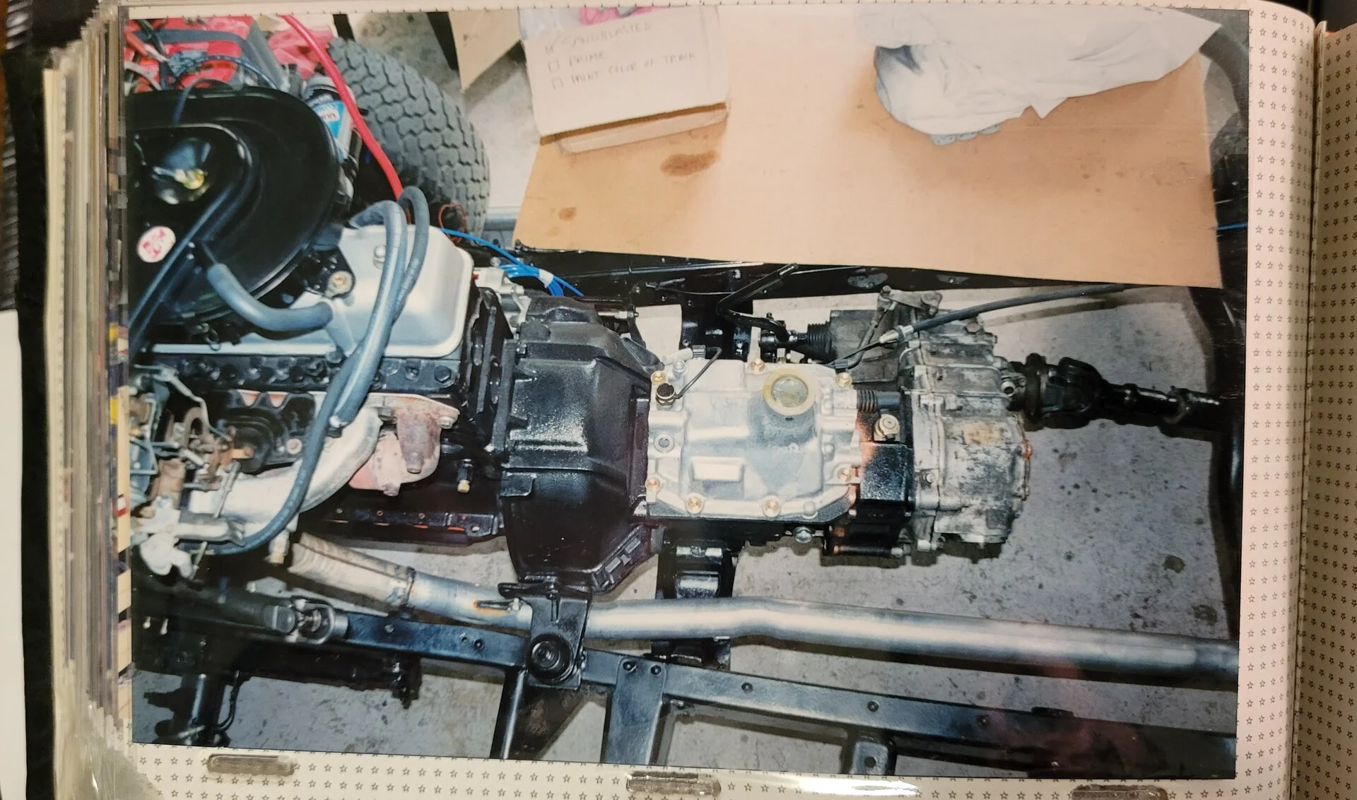

( Setting up the H55F in my 1972 FJ40, circa 2002. Same transmission has never skipped a beat :cool: )
