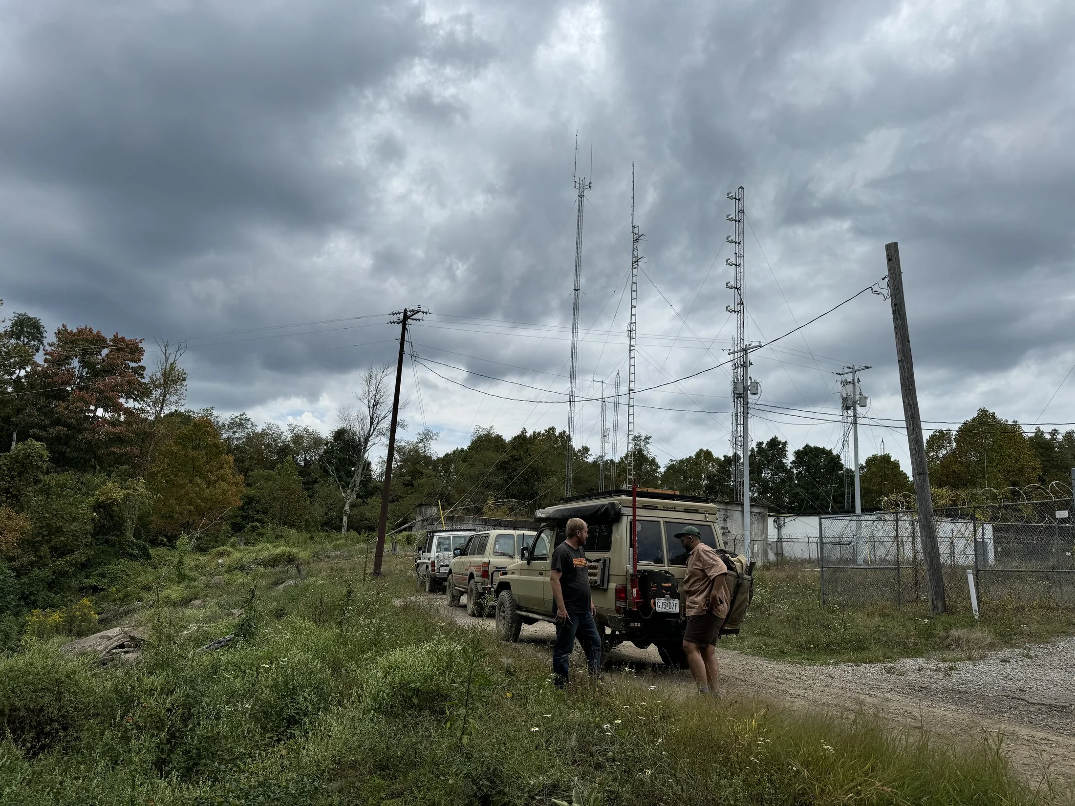

Holy crap, thank goodness I towed these things. That place is a LONG way from here. 1100 miles round trip. It’s pretty amazing. A privately owned 77,000 acre park. We rode hard for 2 days and maybe saw 5% of it.
We got back yesterday and unpacked and cleaned up the trucks a little.

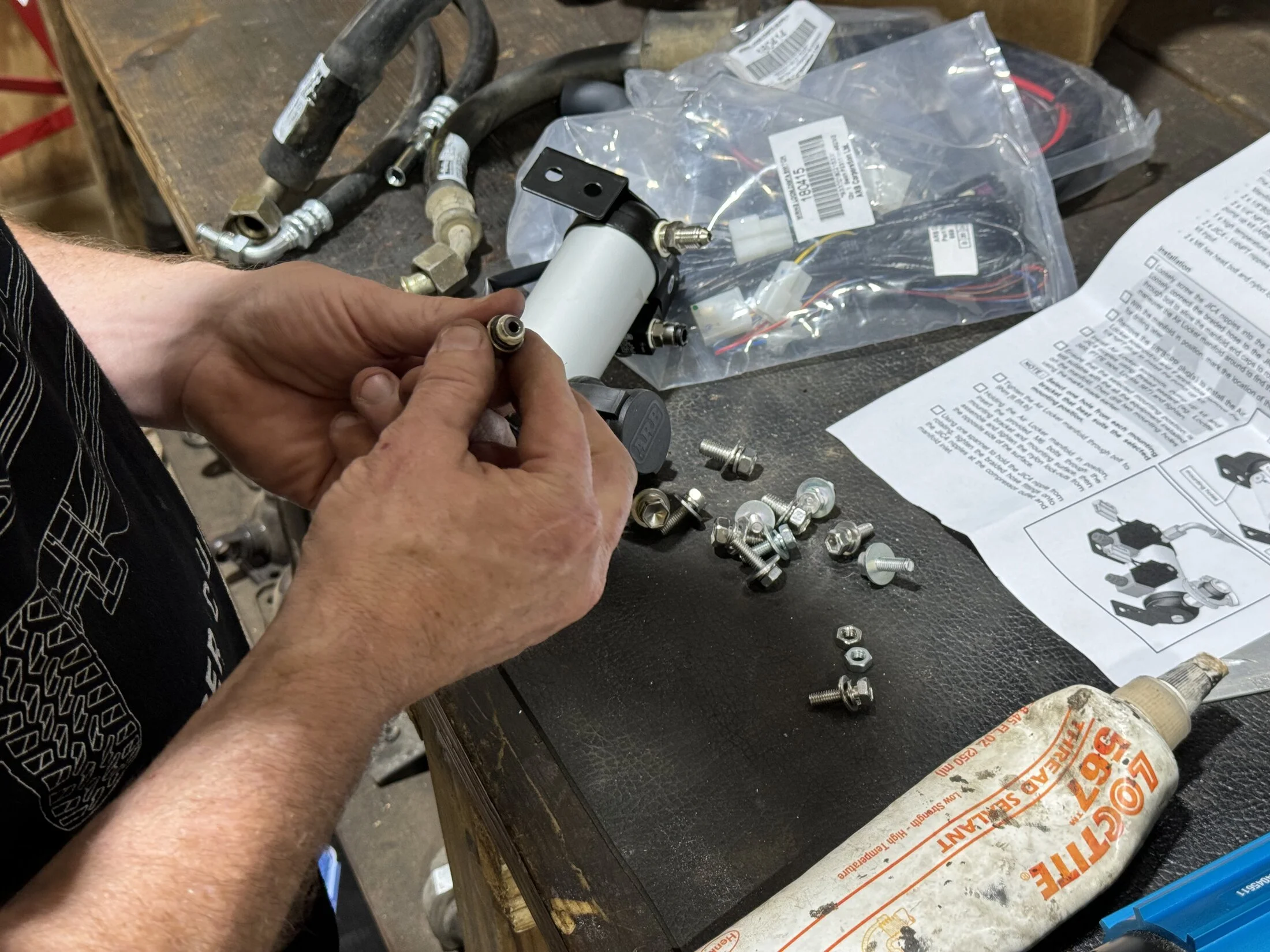

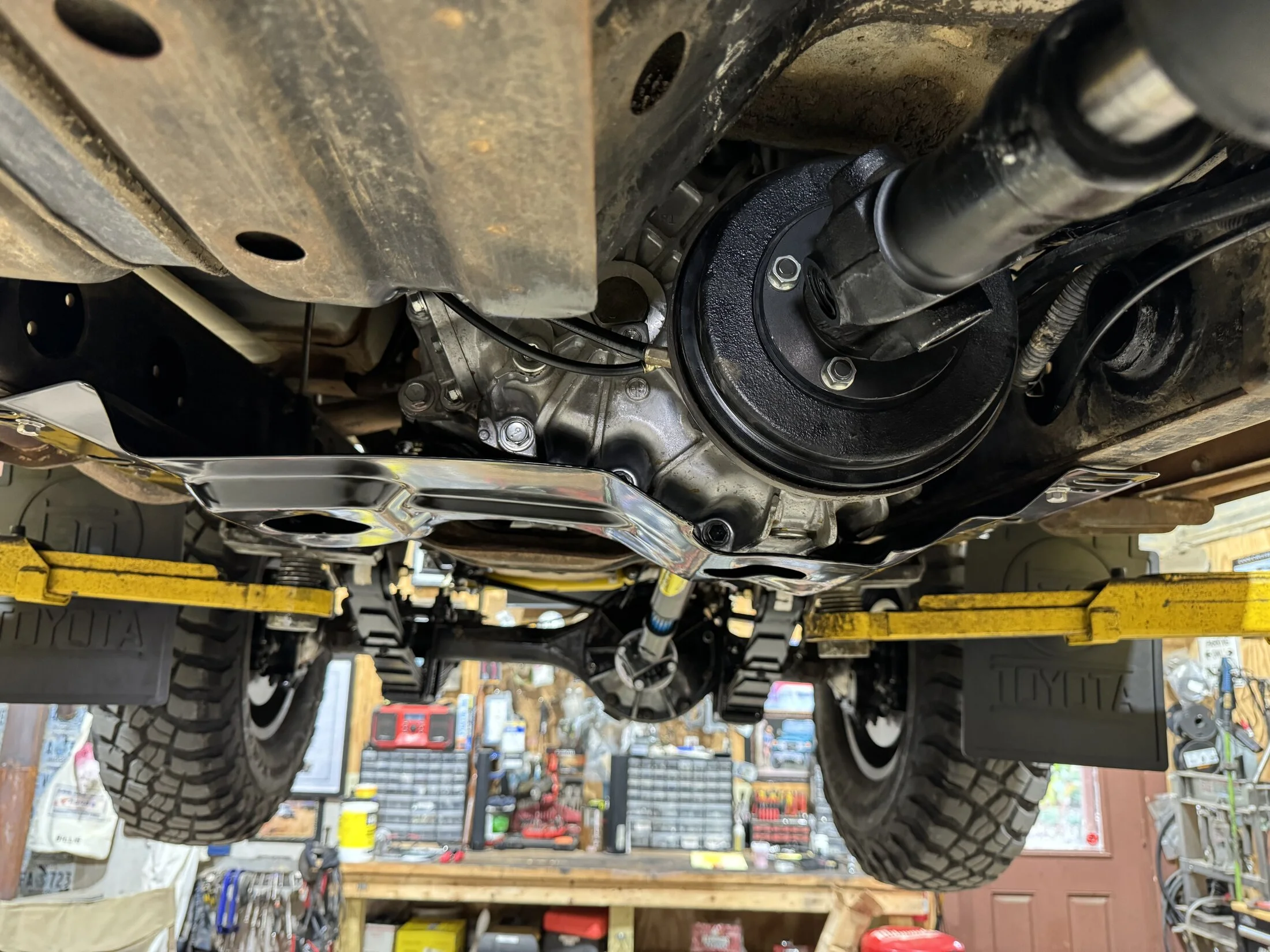

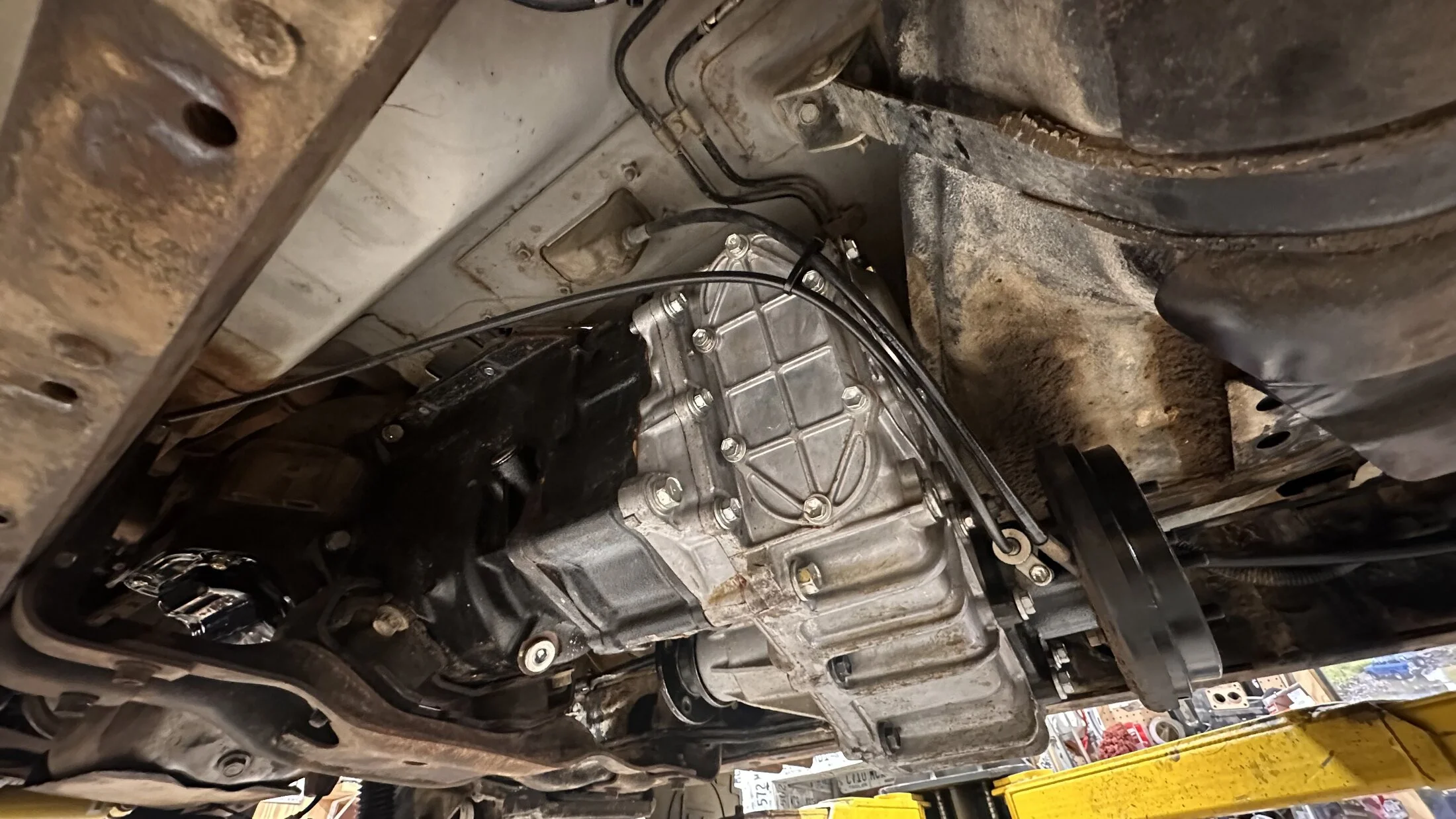

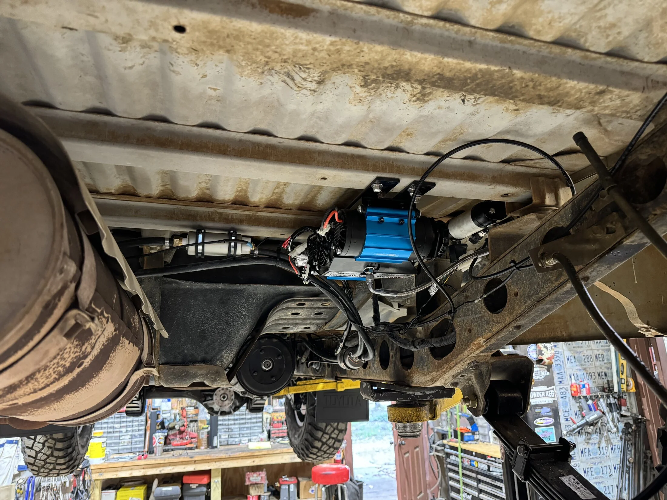

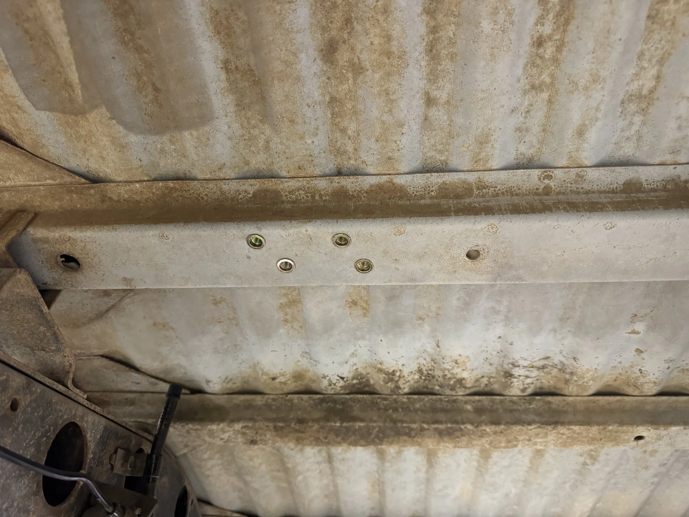

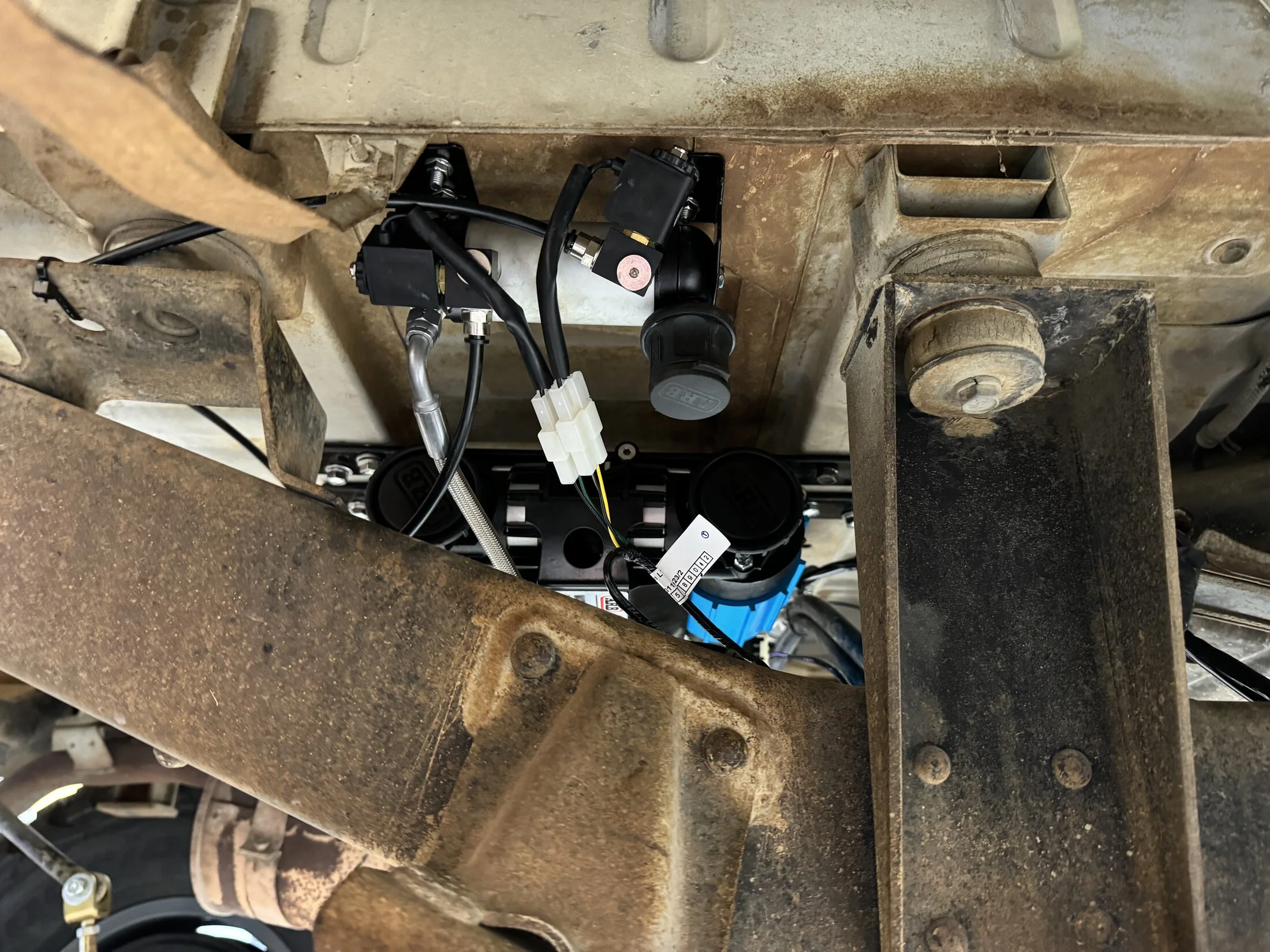

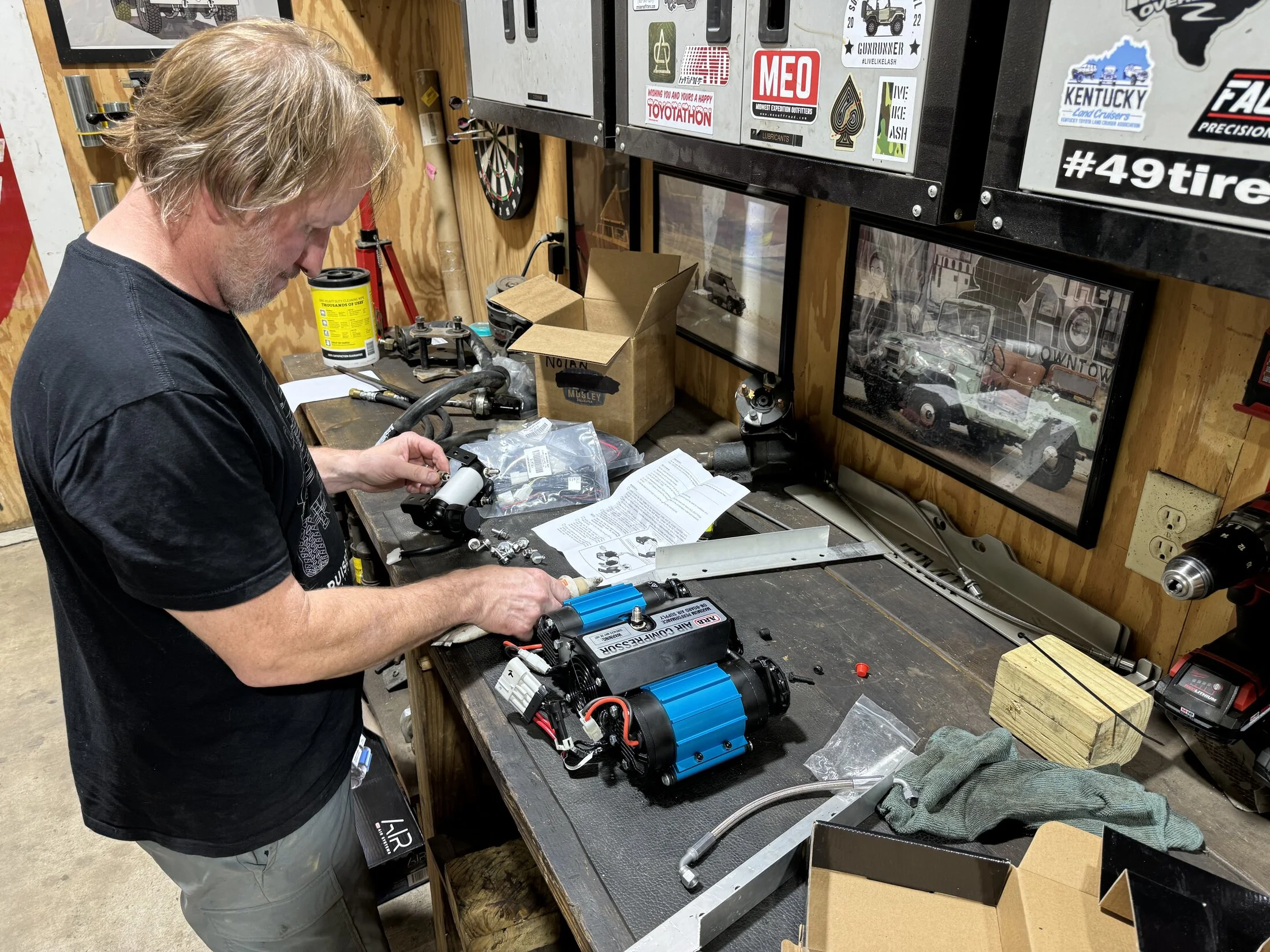

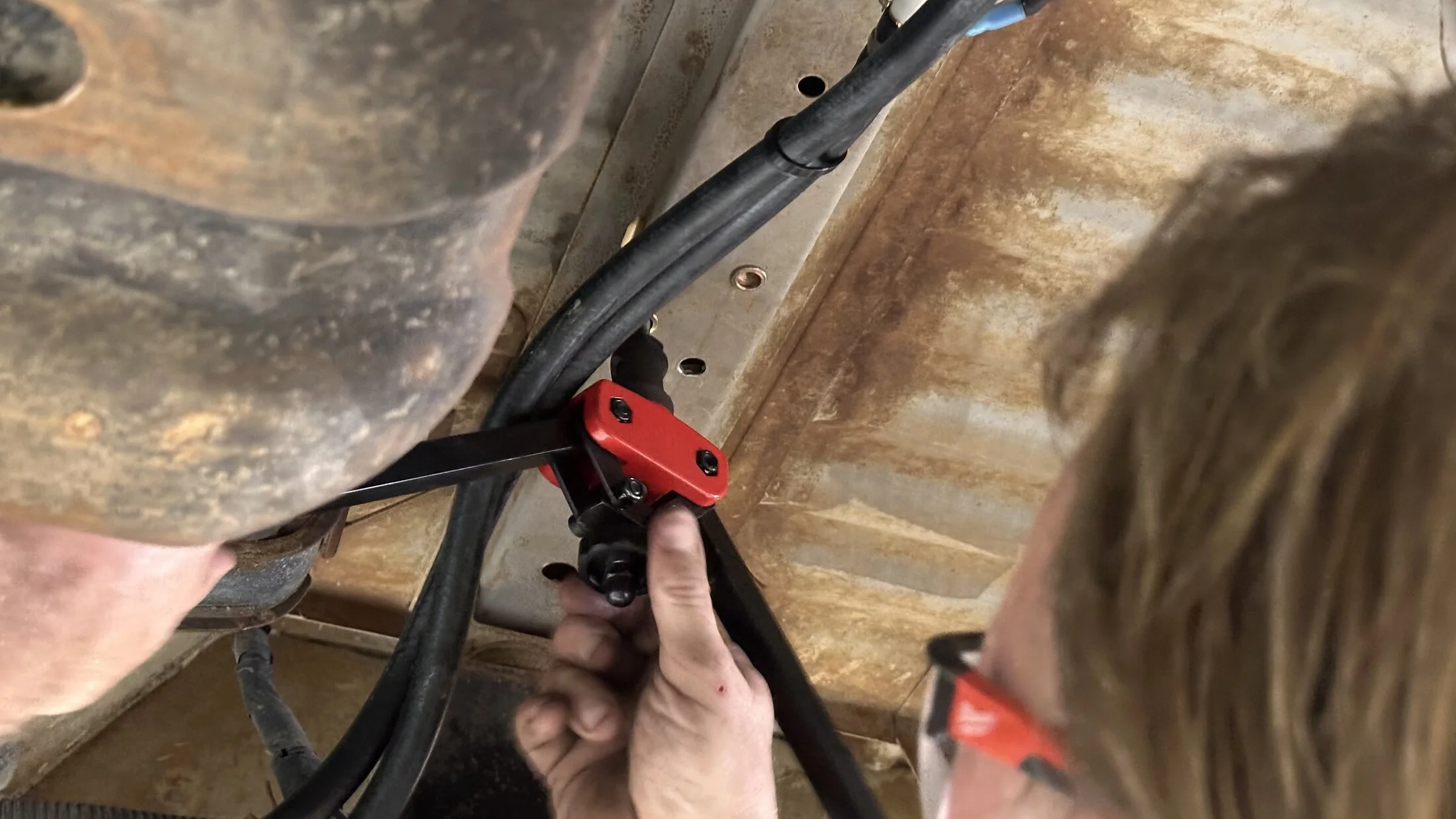

I got back at it at noon and got the interior put back in place with the new brake light switch. I spent the rest of the afternoon making a mount and mounting the ARB dual compressor. Tomorrow I’ll finalize the wiring and hopefully I’ll have some driveshafts so I can take this thing for a spin
Is that black air line from ARB ? It looks larger than the old blue stuff ?
It is. I have no idea what they provided you back in the 70s when you built your 40
Is the compressor isolated to prevent rattling through the floor?
The mount is insulated but you will hear that thing anywhere you mount it.
The last 75 I built we put it under there and it’s a decent location. We built a big expensive box around it that every time we go out I look under there and it’s clean.
Not planning on a cover on this one.

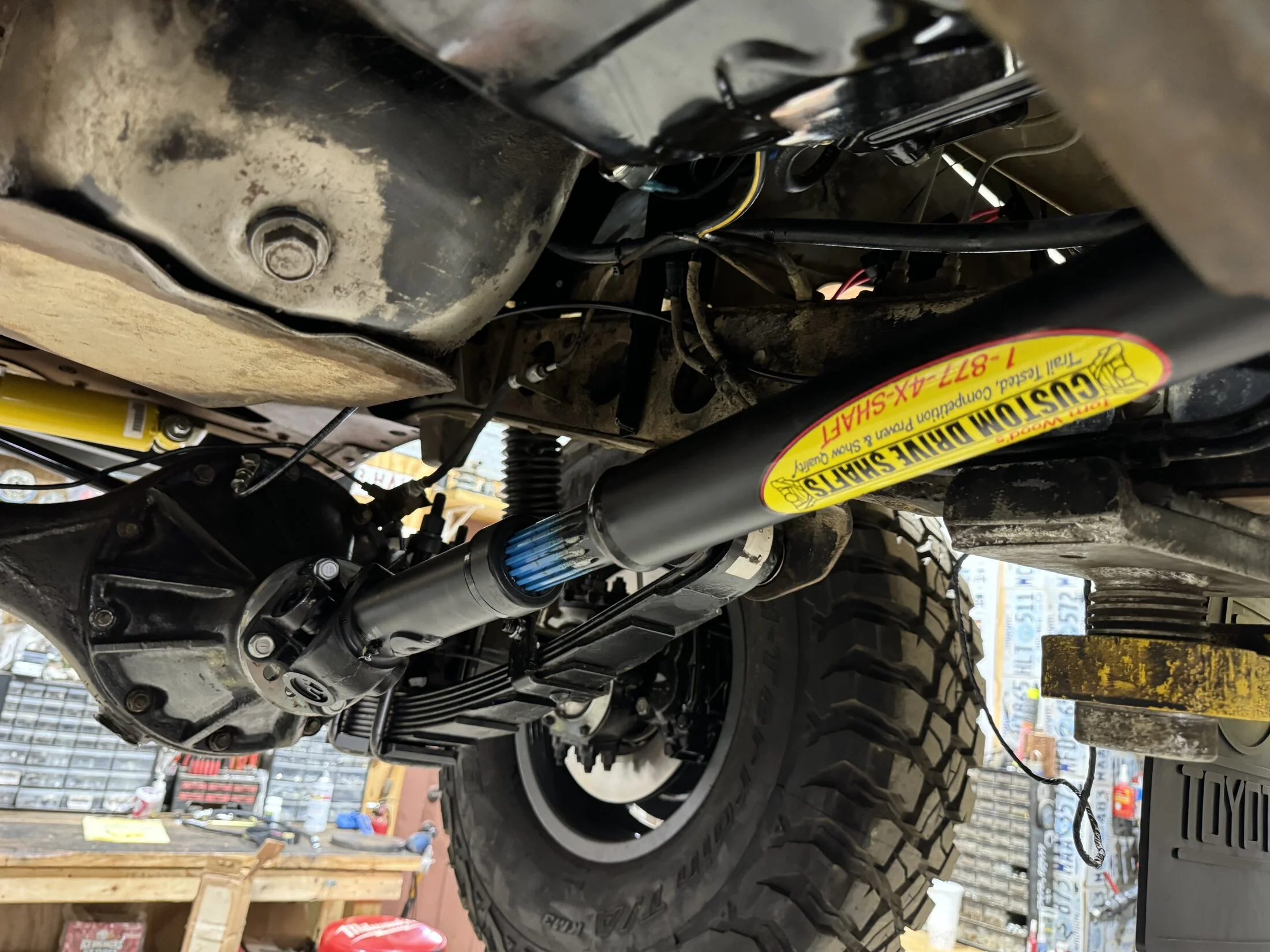

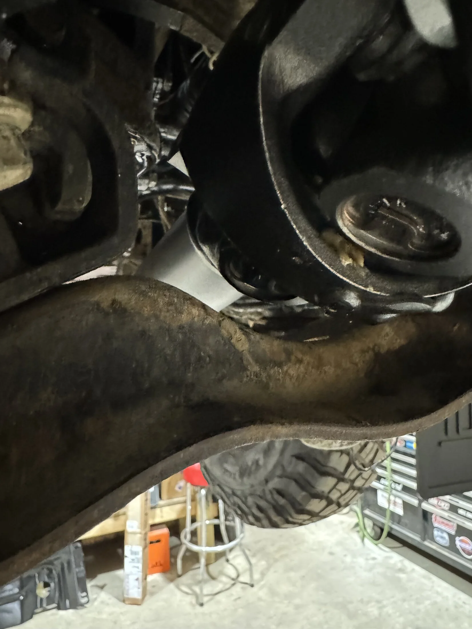

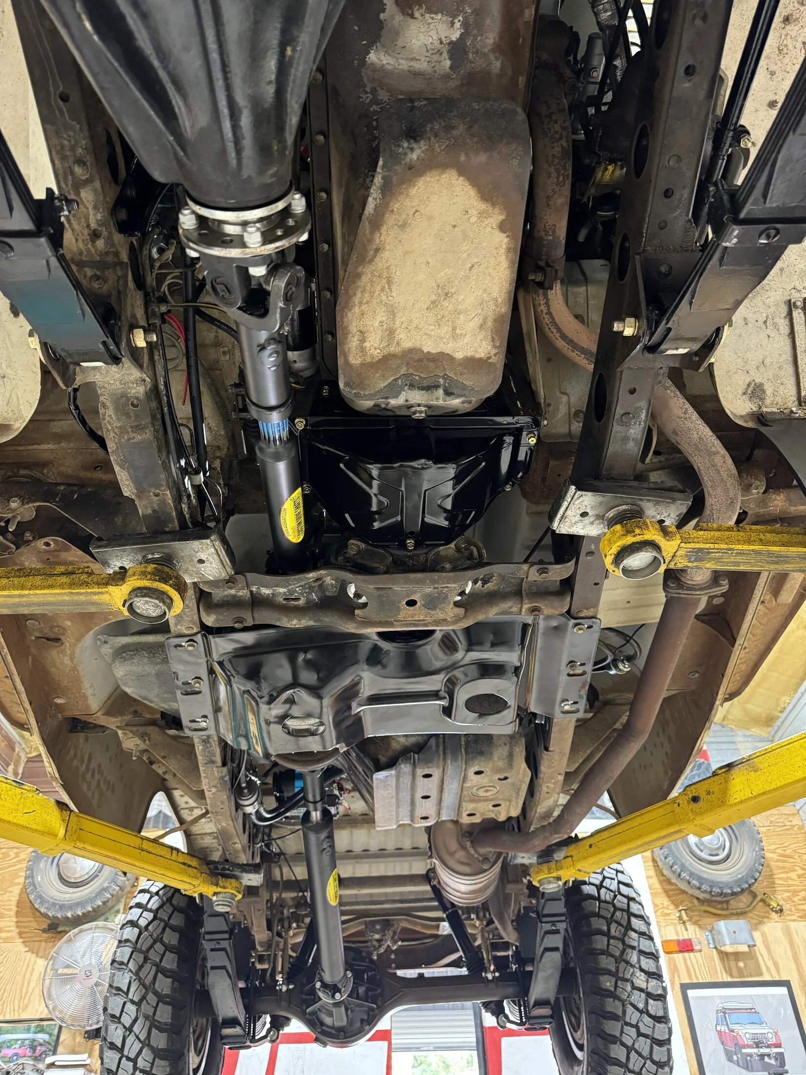

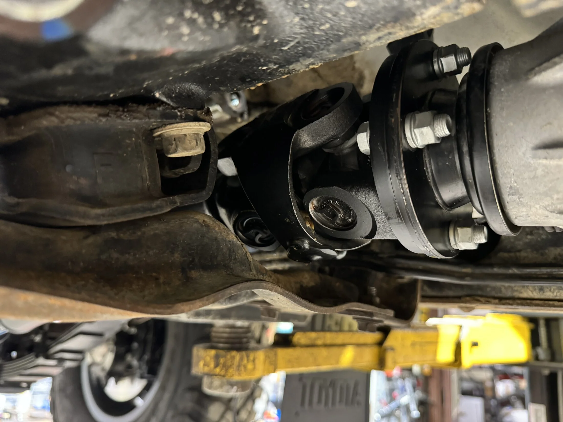

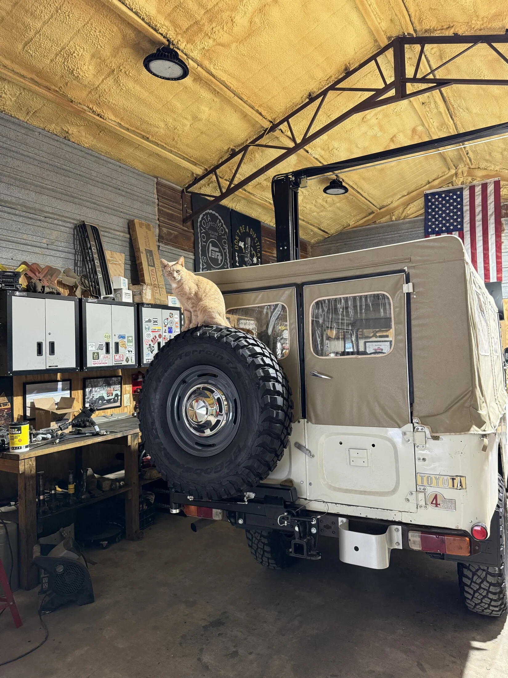

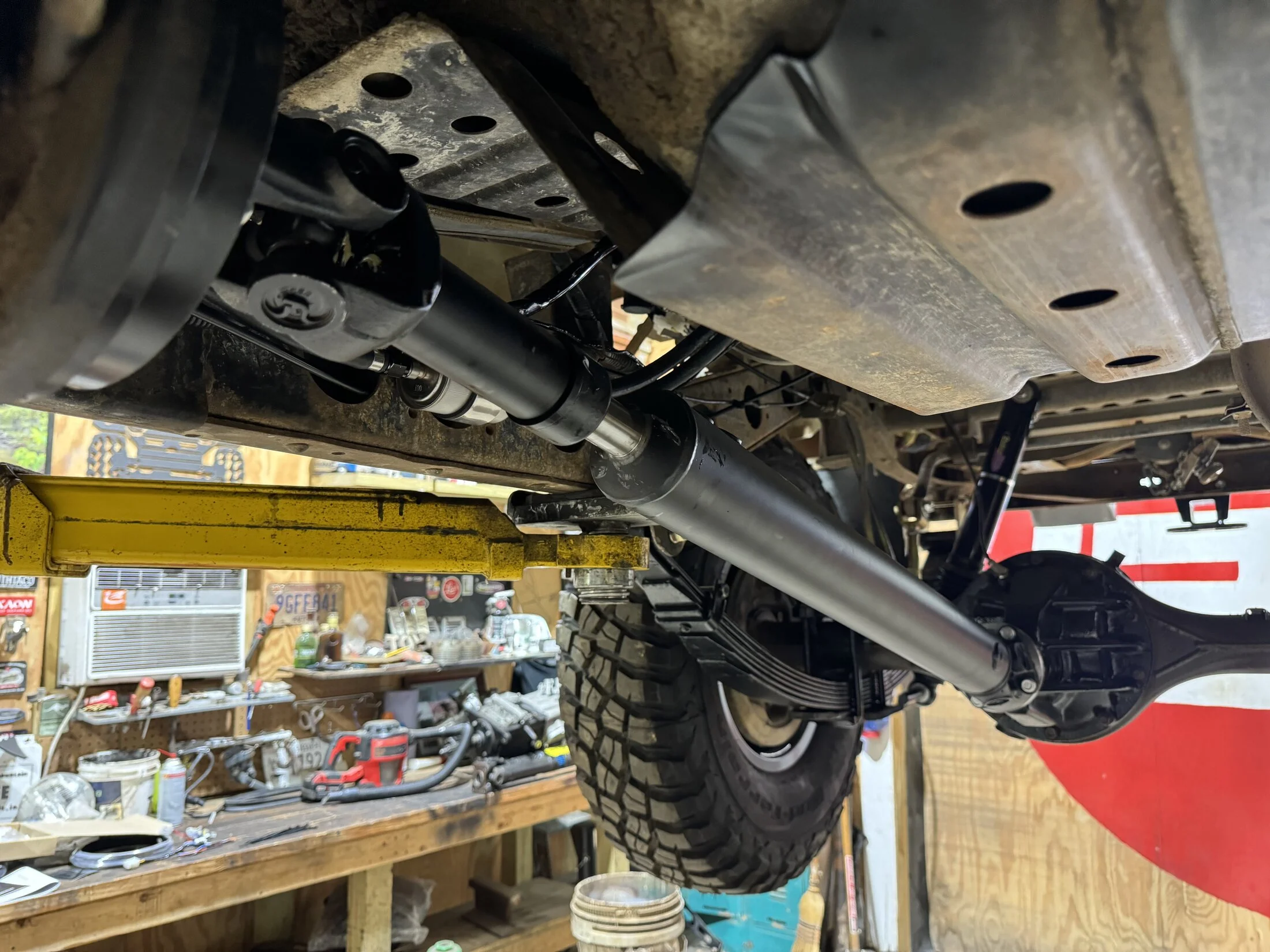

Driveshafts are in. Double cardan in the front to push it forward before it starts to drop. This is due to the extra 4” of the H55
Large tube rear
I have also run a few under the loadbin with success. Only change I make is to remote mount the filters, they can rattle off under the truck leading to the ARB sucking in water/dirt.
