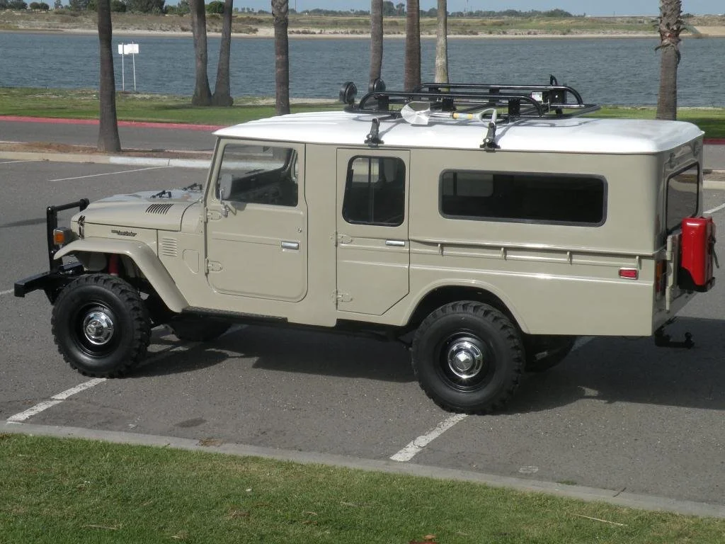

I showed a picture of this truck to my wife and she didn’t walk out the door so I guess that means I can get one…
This or a 4 door 45 is what my dreams are made of…
4 door 45s are simply gross abominations.
I always have an opinion
I’m partial to gross abominations.
I also have one too, and an opinion 😉
Three doors it is!
A troopy was the start of the end for my first marriage. Immediately walking out is not a sufficient test. 😆
Good to know. A couple days ago was 19 years… I should not get cocky now.
Nolan, I didn’t see but what is the seating arrangement going to be in the back of this bus?
Keeping it jump or going bench?
We have plans. Ben had FOUR boys.
Sept 3, 2005 for me...you too?

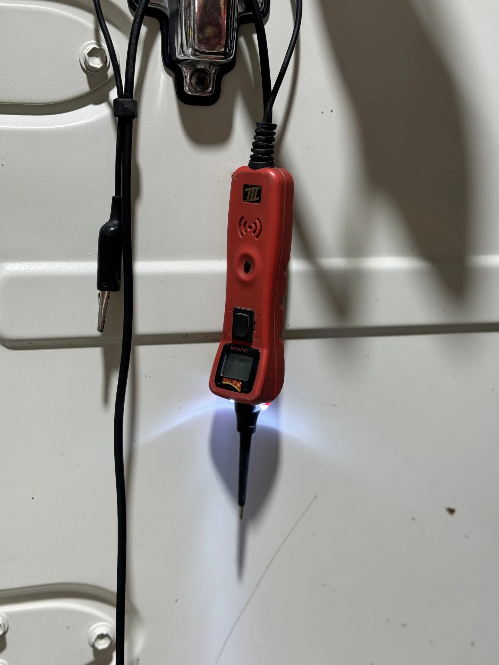

When I left this thing last week I was not getting any fuel to the sniper. I got that issue fixed.
Next thing was there is no tach signal unless I let off the key and then it bumps up to 125 rpm as it’s dying off.
Without a good tach signal these things won’t crank.
I rewired everything. Picked a fresh switched12 off the fuse box and still nothing.
Sat on hold for :45 with Holley and he thinks the ignition switch in the Cruiser may be the culprit. Not sending the proper signal until the key is released.
Maybe. Not sure what else to check. I confirmed the DUI is sparking.
So I ordered a new switch from Kurt. While I wait I’ll do things that do not require it to be running.
