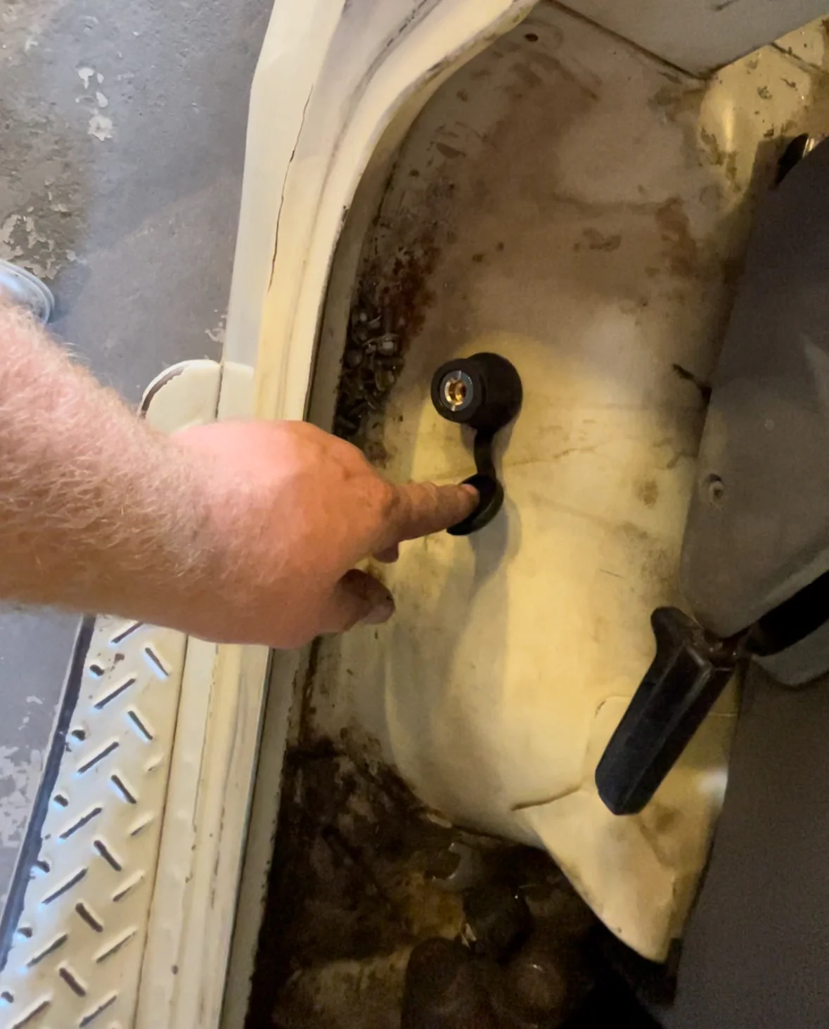

Jason added a remote bung from the underbody compressor to the tub to make it easy to access.

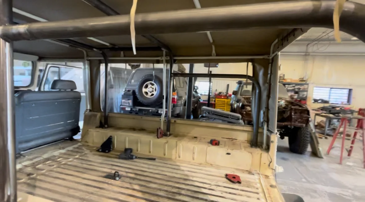

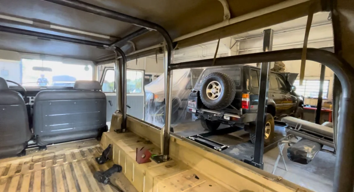

Next they made seat extensions to give Ben more leg room

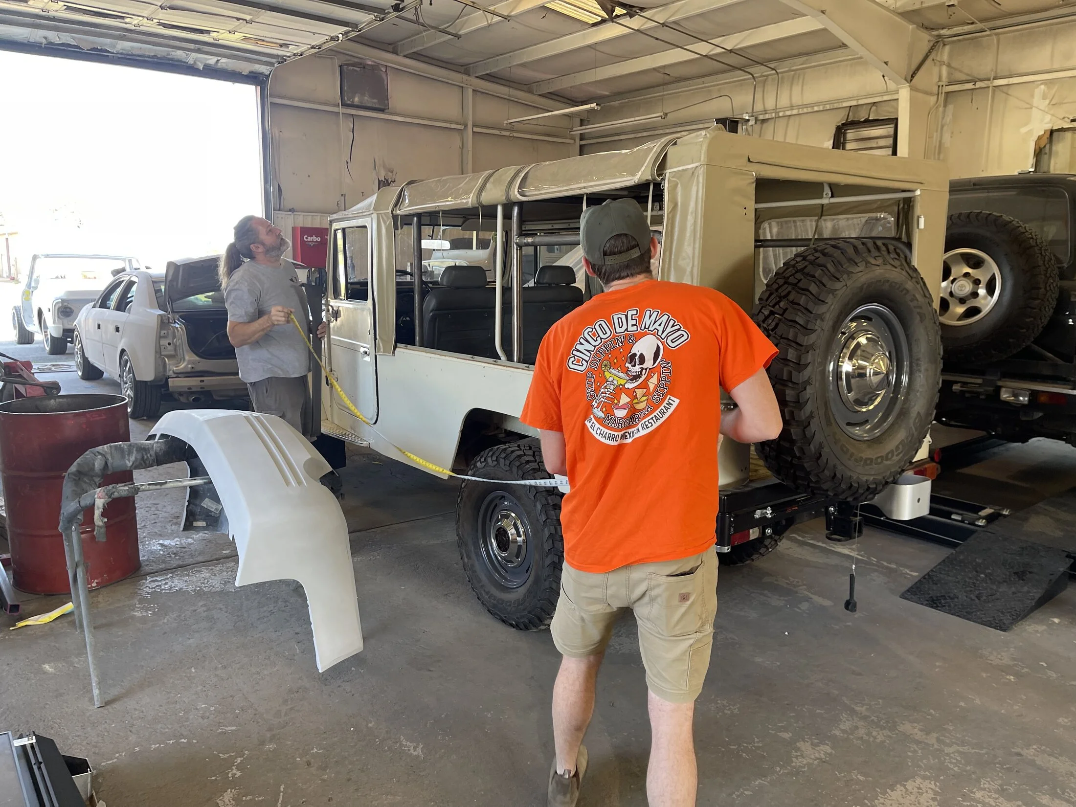

Finally, here is a sneak peek at the real meat of this trip to Missouri.

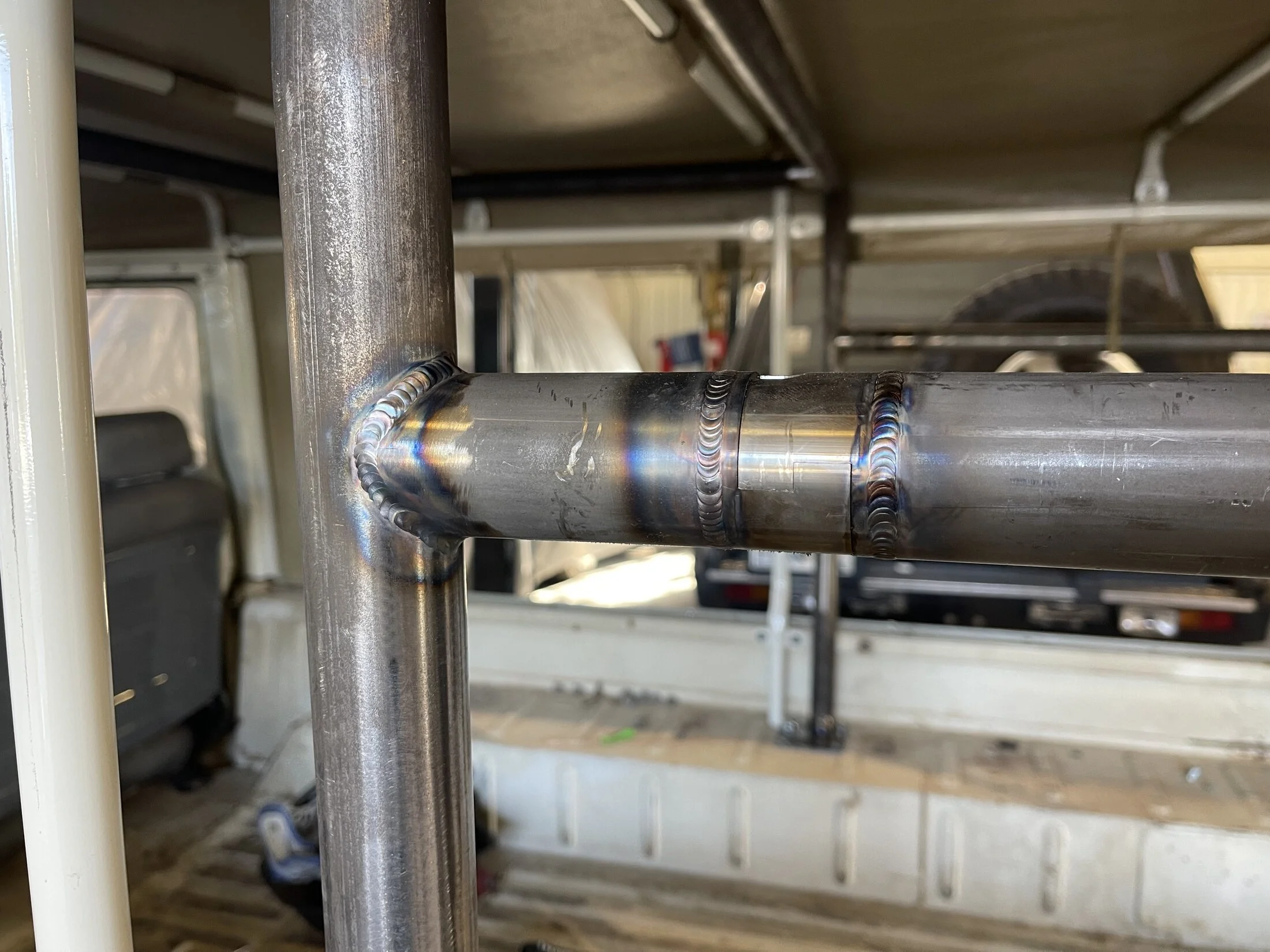

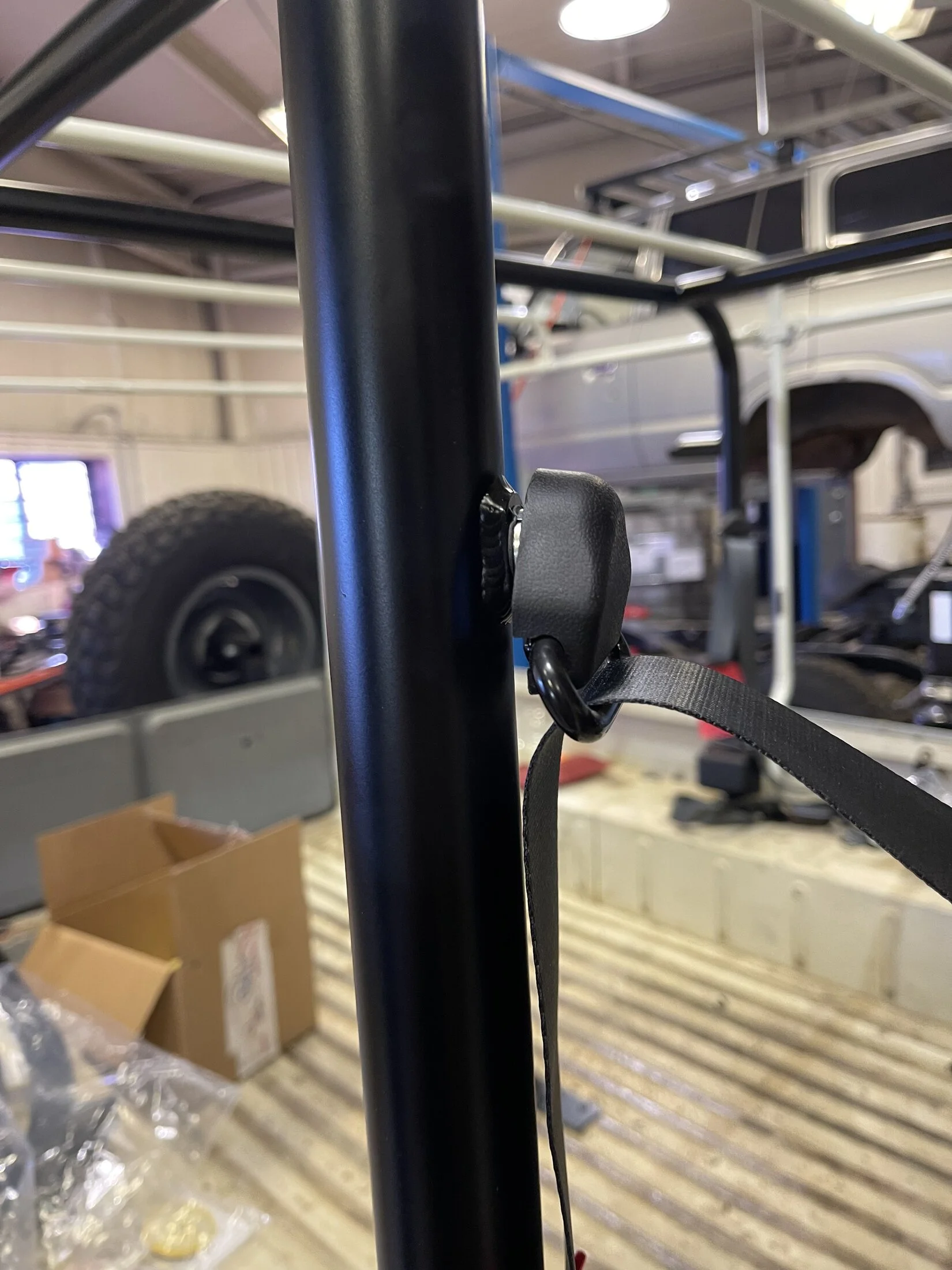

Double hoops for the passengers for shoulder belts and safety. Work in progress. Thanks for the update @Ozark cruiser
@clrussell thanks for checking in on things. hopefully they aren't trying to install that bumper in the pic above on my truck! :)

Bench or jump seats in back?

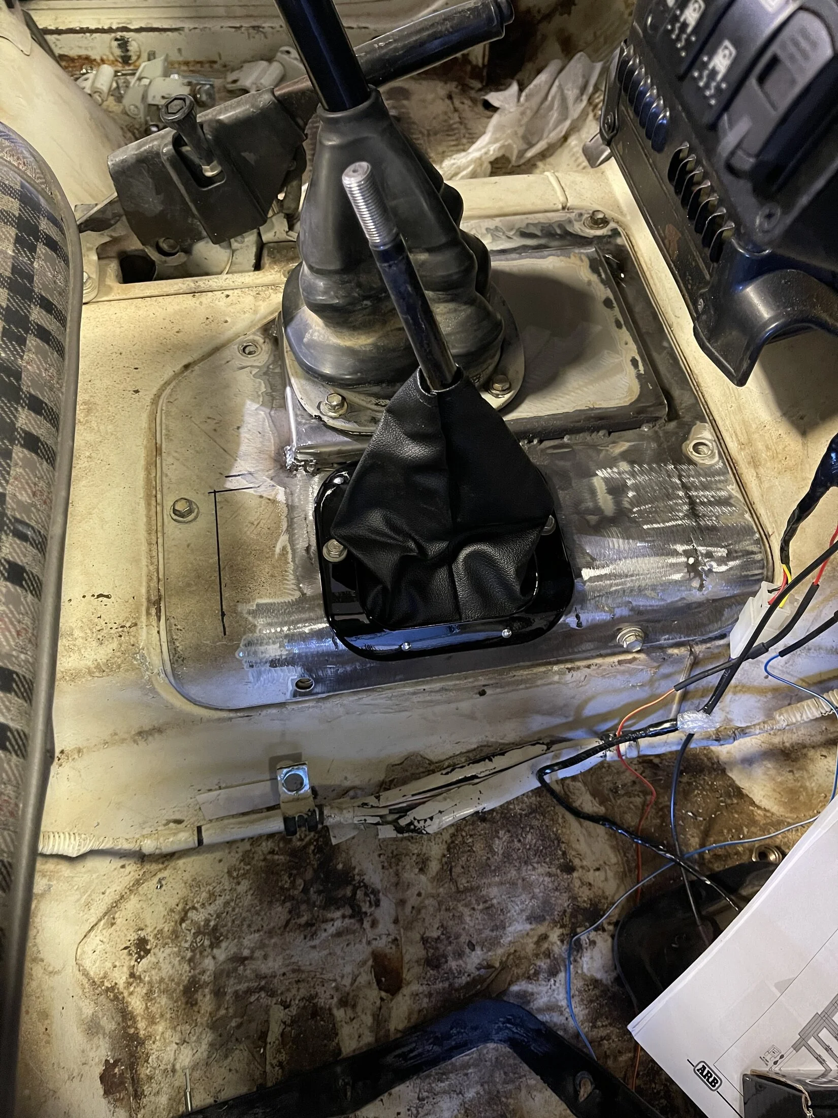

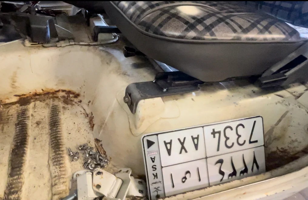

You did say the transmission hump was a major job …it certainly looks like it….
Beautiful fit though
