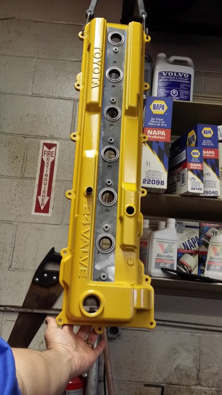

Idk what it’s called, but it crossed my mind to the “heritage Toyota yellow/orange/red stripes diagnal..... I’m just not sure that multi color is doable in powder coat
Yknot123 did you pain the plastic caps black? I was thinking about doing that also. Looks good!
Do you mean the Toyota lettering and the 24 Valve letters? The spark plug wire covers are OEM plastic black.
I used the old spark plug tube extension gasket to seal plug hole. Left the old PVC valve and grommet in place. Installed all new anyways. Then spray painted the whole thing several times with heat resistant paint. Went to Autozone and found color I liked. After the red dried came the letters. Took a piece of still cardboard a little bigger then letter size cut to size. Then spray paint a even coat of high heat black on cardboard. Then gently laid on top of letters and removed pretty quick so no runs. Did several times and done. All outside during the winter.
