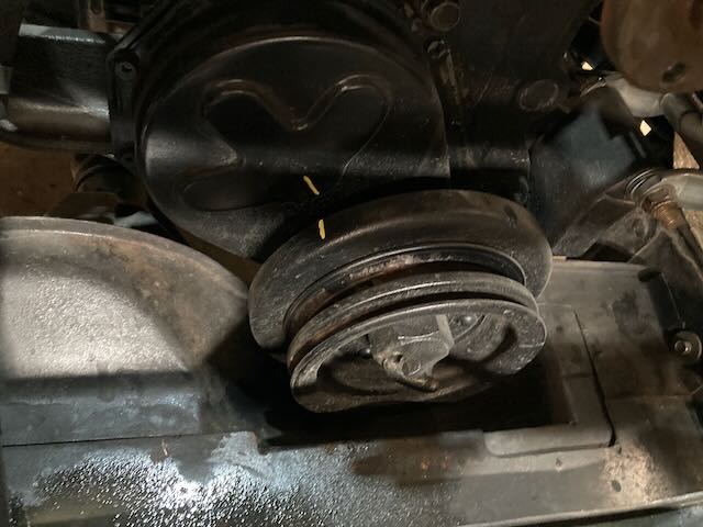

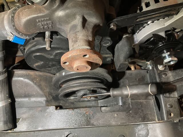

Another way to turn over the motor when doing valve adjustment, if you happen to have your radiator out, and plugs out. Use a screw driver to turn the motor, easy. I added a timing marker on the crank/timing cover to help find the one hiding behind the little door.

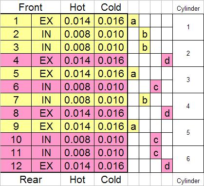

This is a popular table, I've used both, it works the same either way. Engine will sound like a sewing machine once its done, no ticking.
I am making a portable version of this chart. What are the "a", "b", "c", "d" columns?

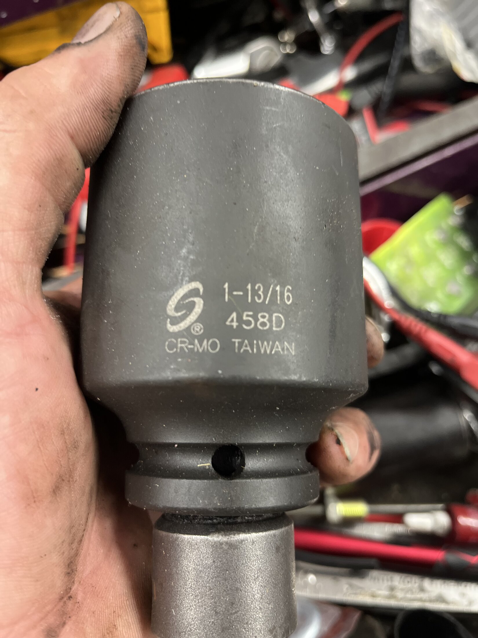

Plugs out. Cold engine. Spin engine with the alternator pulley nut. Set valves to cold specs. Replace plugs. Fire it up and let it warm up. Check again hot as a go-no-go scenario just to confirm everything's good. Re-adjust any outliers.
