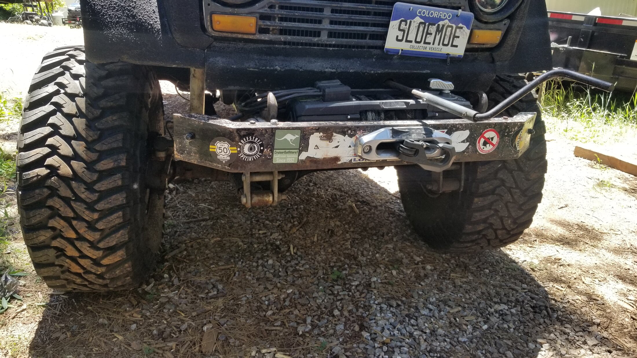

I've tried a variety of methods, including using a remote starter; hand crank; and pushing/pulling. But my preferred method (because I'm lazy) is using a 1/2" drive 46mm Crow’s Foot Wrench for Crankshaft Pulley Nut. This provides a a level of precision and a nice vantage point for seeing the flywheel through the window. (1-7/8" will work if you don't have 46mm)
The stock handcrank is the preferred tool...
I have a hand crank, but it interferes with something under the bib…I’ve read that’s the easiest way to roll the engine for a valve adjustment….i need to play around with it and see what is iterfering with shoving into the balancer…..
So I still running an F with a press on balancer….no hex nut to grab on to…..just the claw spud for the hand crank.
