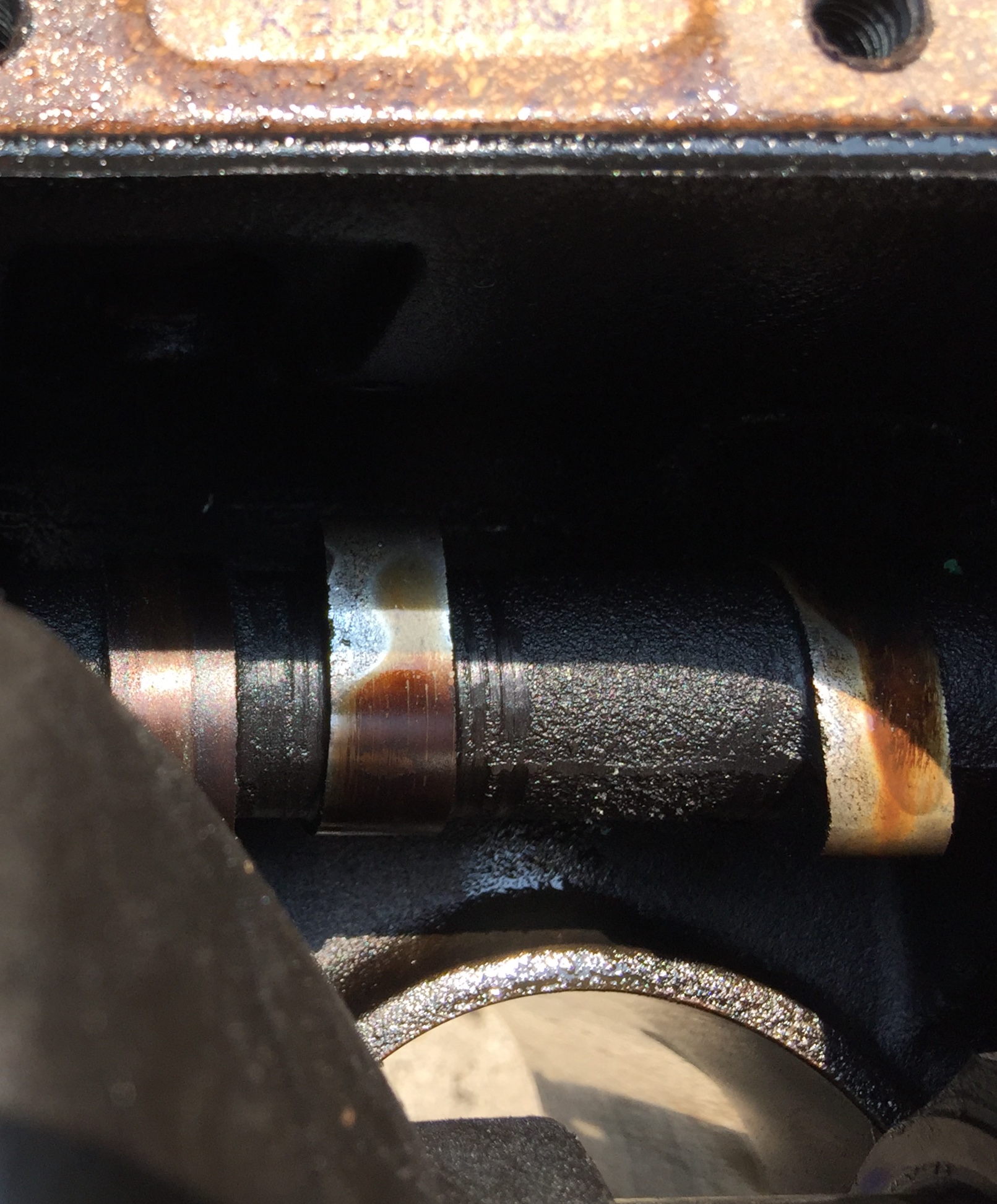

Okay, so you get to the point where you reset the lash on a few valves. It must be wear that is present somewhere between the valve seat and the non-lobed part of the camshaft. However, I learned of an engine builder who was actually measuring the amount of cam lobe as well. A plung-type dial indicator with a magnetic base can tell you how much the valve actually opens if it is measuring the travel on the valve spring retainer. It could be helpful in determining how much cam lobe wear is affecting valve opening. There is no point setting valve lash properly if cam lobe wear is preventing the valve from opening as much as it should, and there are specs for cam lobe wear - about .014-inch. (if you measured it at the top of a pushrod with the rocker arms removed).
What’s neat about these engines (I6 with side cover) you can pull the valve train, rockers, push rods and lifters, and actually get an ‘eye-ball’ on the cam. If you suspect a cam issue, you can see it. If you can see it, it’s not self healing, and requires further disassembly.
The attached picture is a F cam with over 100k, this engine ran strong….till it broke a piston. However, the cam was also beat and should have been replaced longe before the piston issue. Notice the ‘crinkle’ on the lobe ramp, indication of work hardening. I never did figure out if this was a lubrication issue (low ZDDP) or just normal wear for a high milage engine.
Great tech here Mark, very informative.
