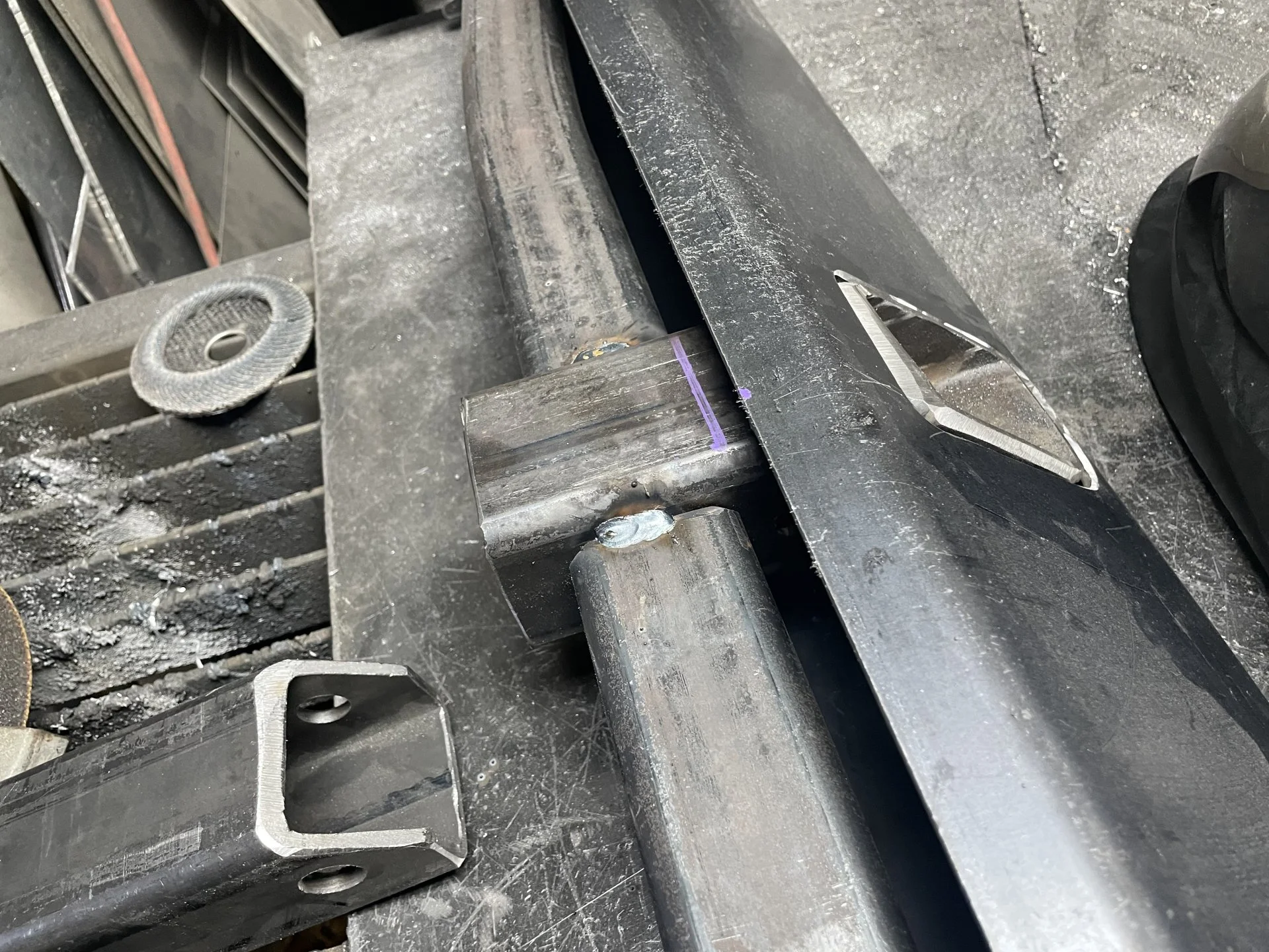

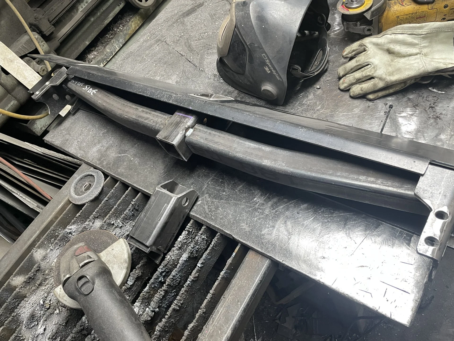

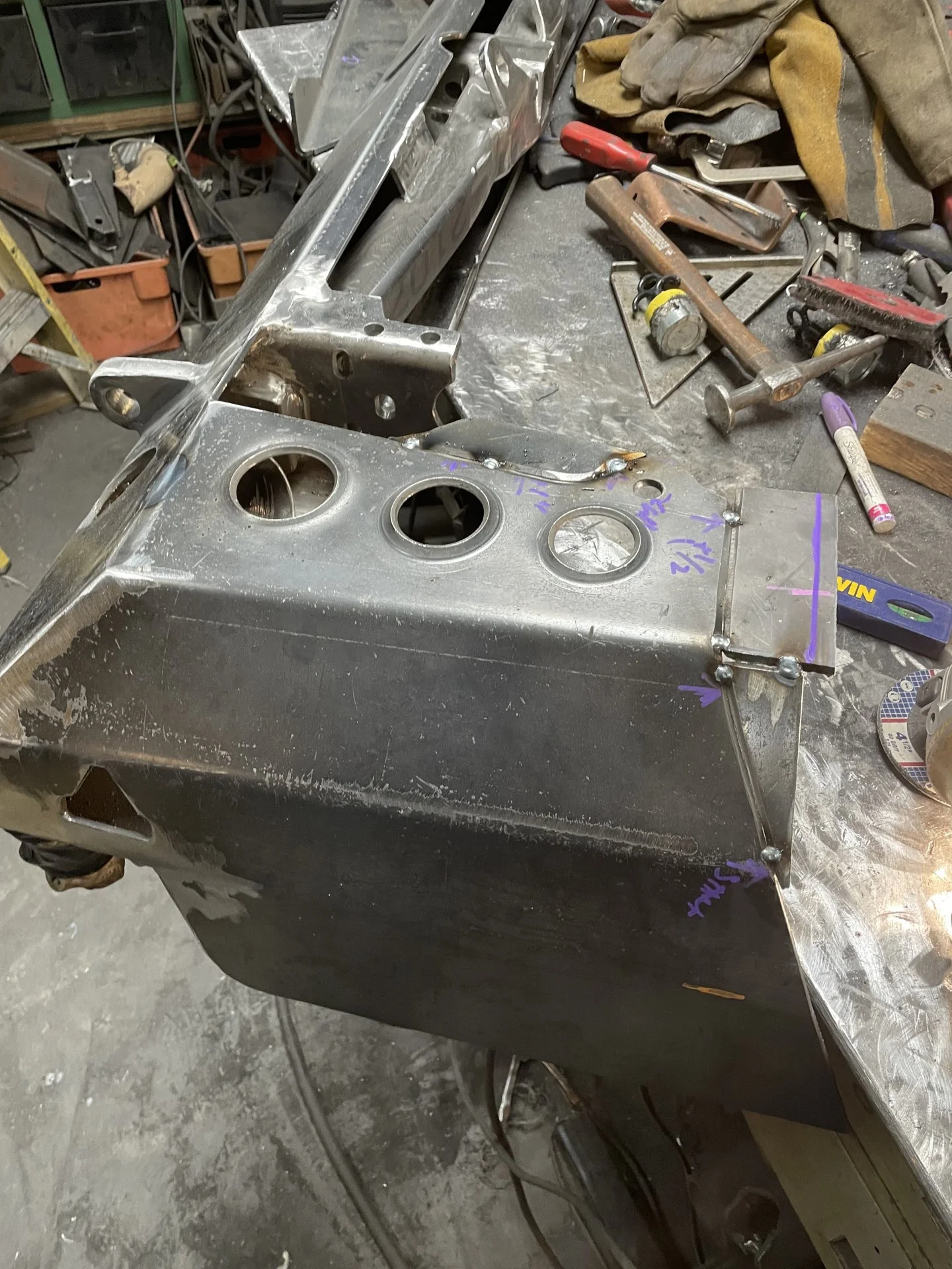

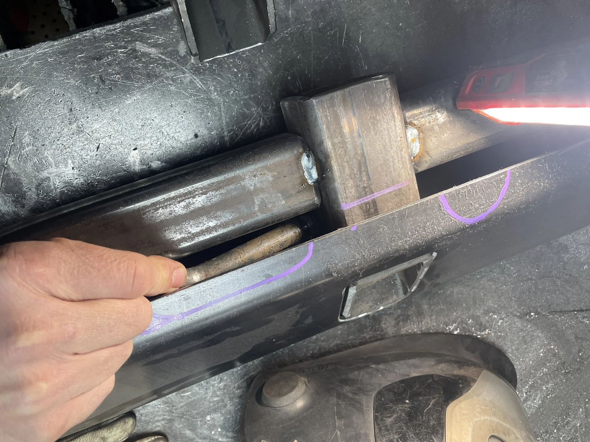

Been putting a lot of time in on the 4 x 4 labs bumper. Let me be clear -- their products are great -- however, I like the idea of a kit, so I can adapt it to what I like....
Much like my 80 series 4x4 labs rear bumper, I Customized it a lot -- I may just start a new thread on it… but here is the big change. What I loved about their design was the integrated rear hitch structure. What i did not like is how short the place is between the front of the receiver and the pin -- as well as how this is designed to project out of the face of the bumper. I get that it was designed that way so you could get to the hitch pin... but I came up with another option.....

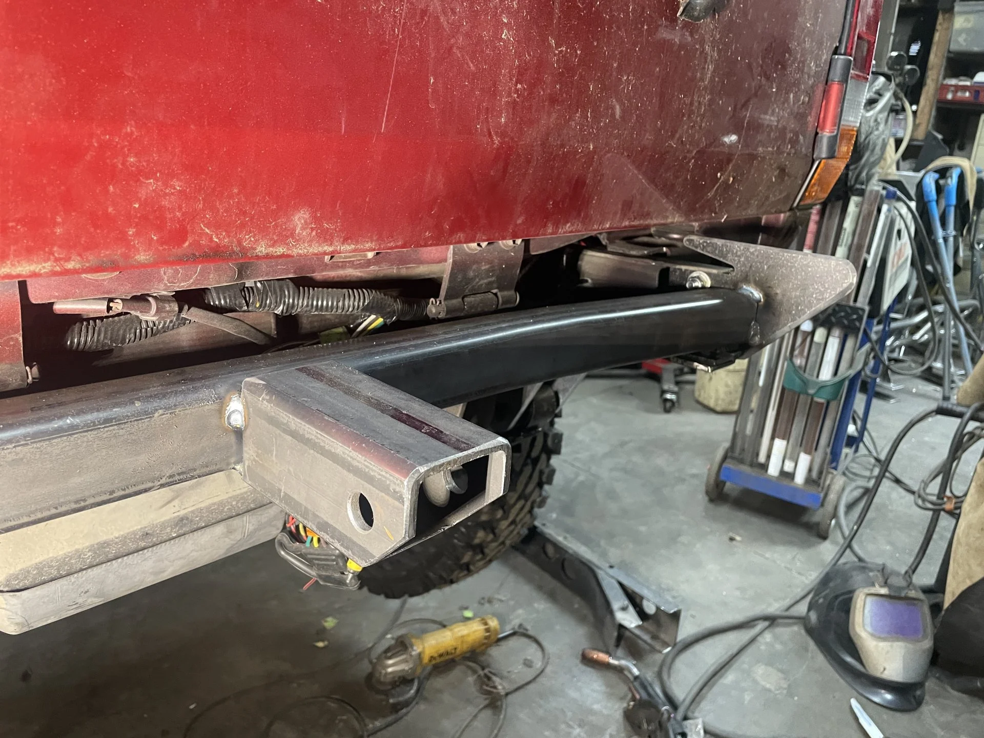

Here is the as designed setup....
Here is what I came up with....

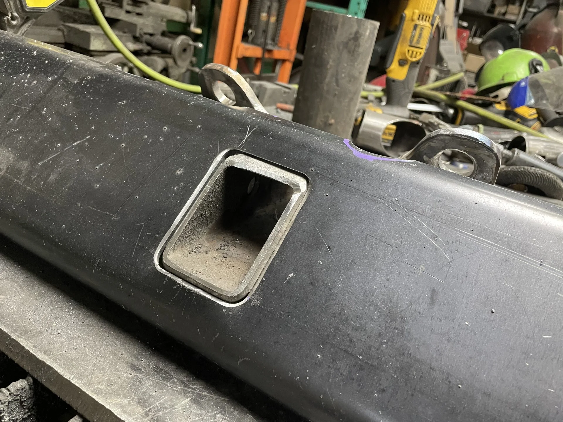

Then, I cut out where the purple marker is on the bottom, so you have room to reach up and put the pin in....

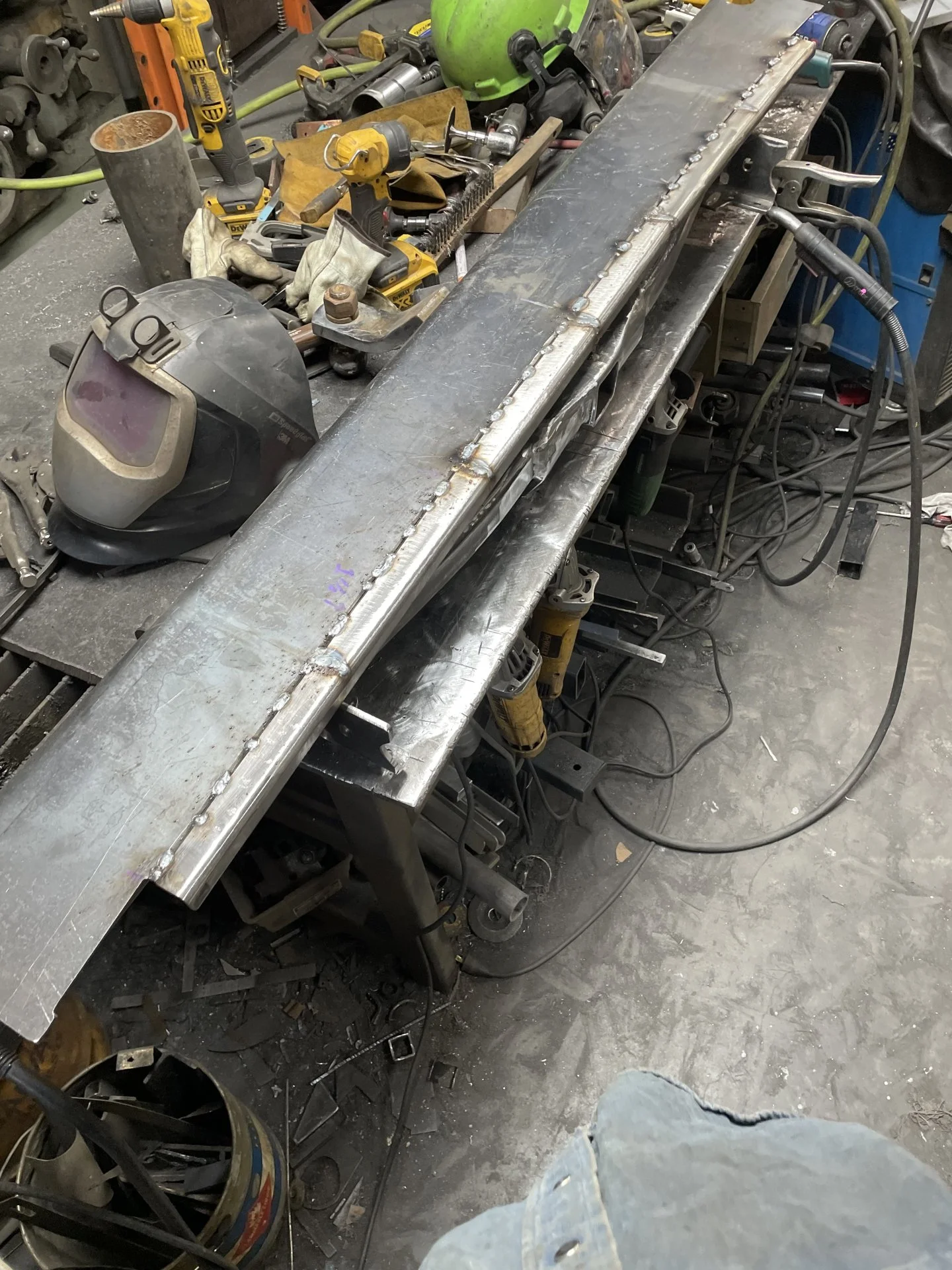

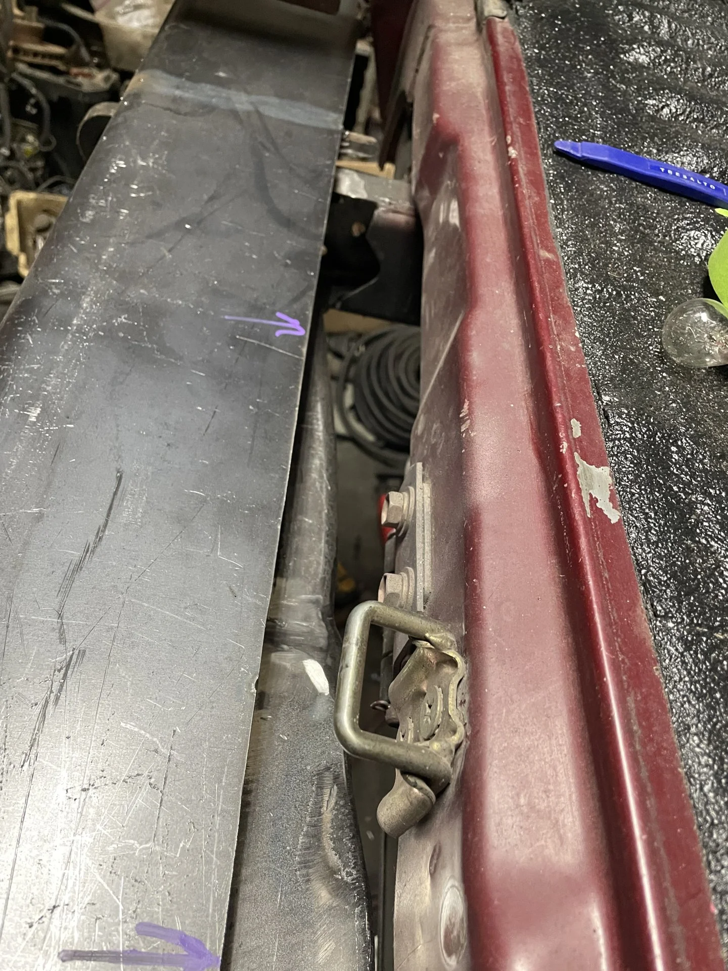

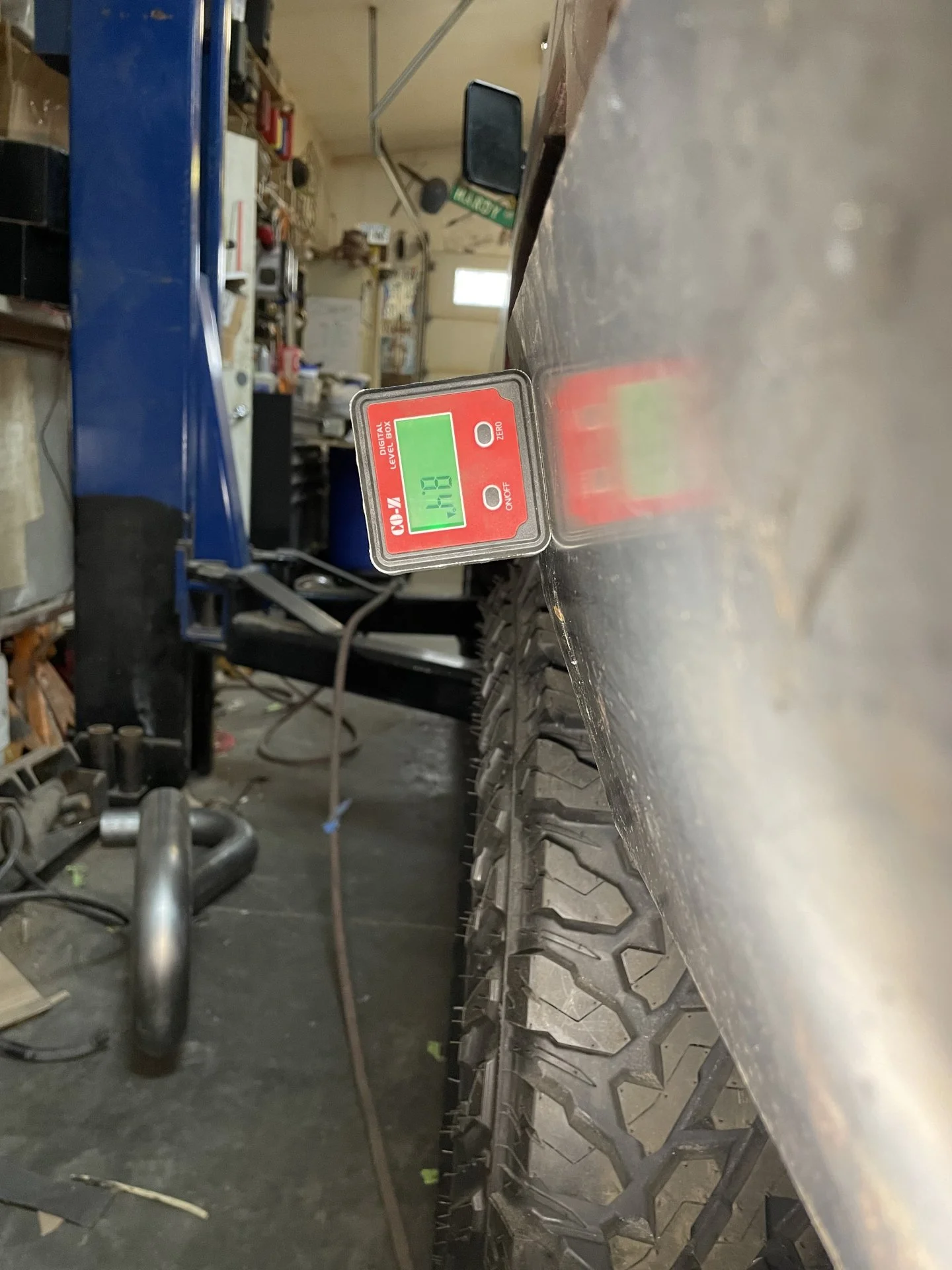

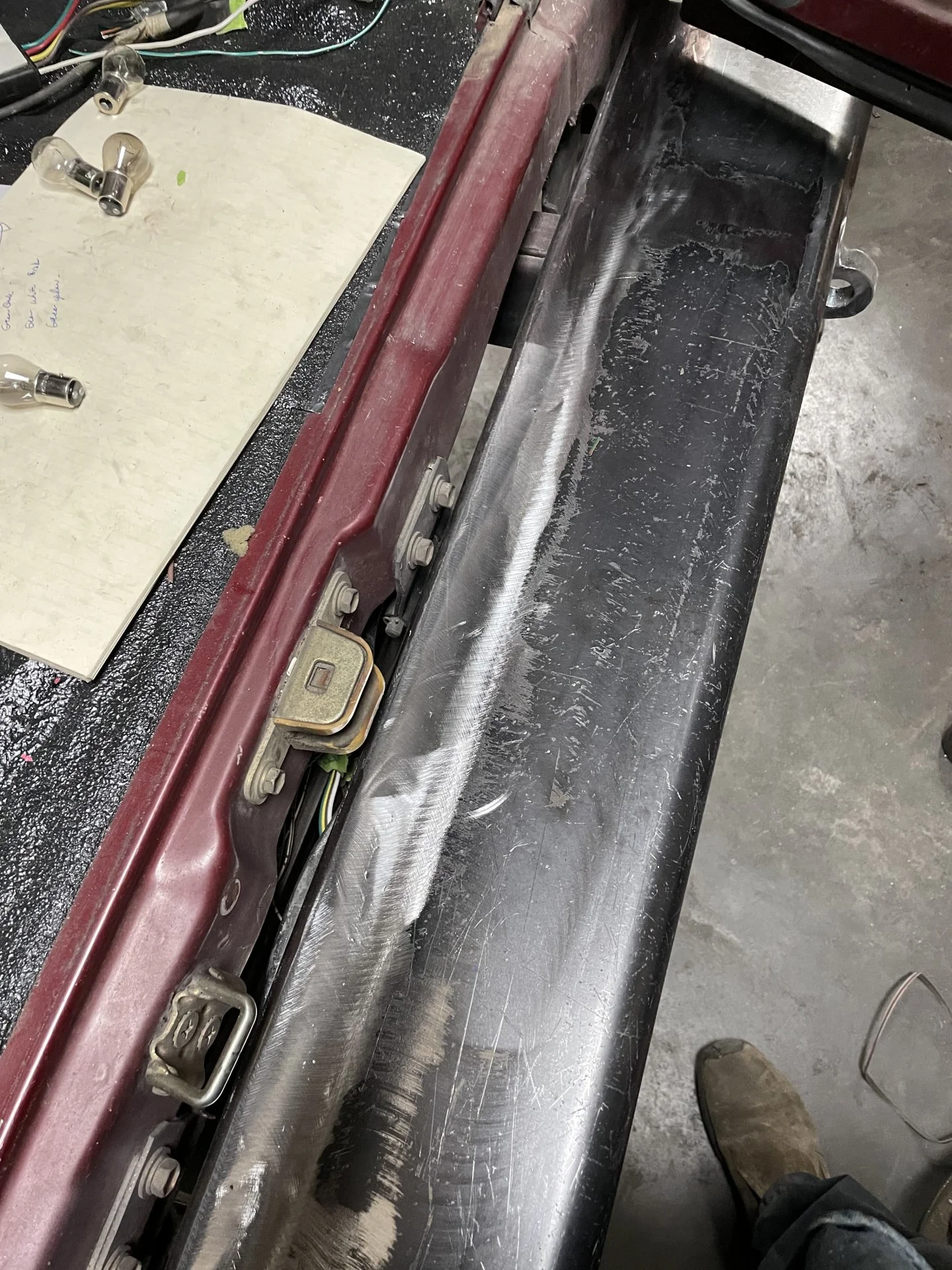

When I test fitted the bumper... loved the look... but when I opened the rear doors, you could reach your hand through the gaps... so I added 1.5" of material there. I used some scraps from square tube, so it rolls over and adds some strength as well.
Sides stood out too much for me, so I put a slight bend at the body line where the bumper top plate is.
And the 4x4 labs top trip cap - 1.25" pipe is larger than I wanted to look to be, so going to 3/4 pipe up top.

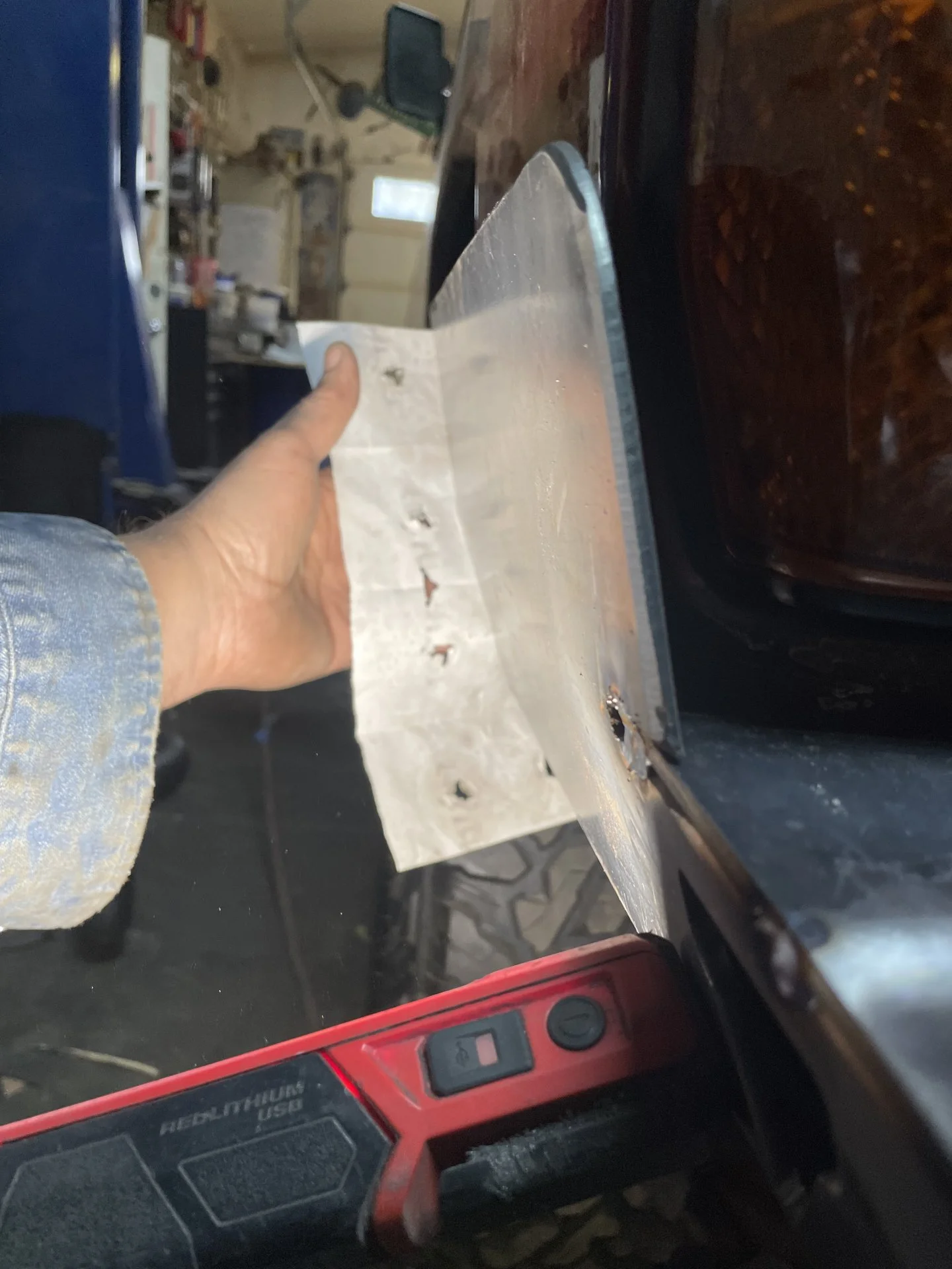

Here you can see how I slid the side forward about 1/2 inch and changed some angles slightly so had some filler pieces to make. My goal is to have the bumper go flush to the wheelwell, and put mounts for cheap mudflaps to bolt on....
Here you can see what I added - about 1.5" to extend the bumper to the wheelwell. Also added some structure on the bottom to give more strength on the body mount.

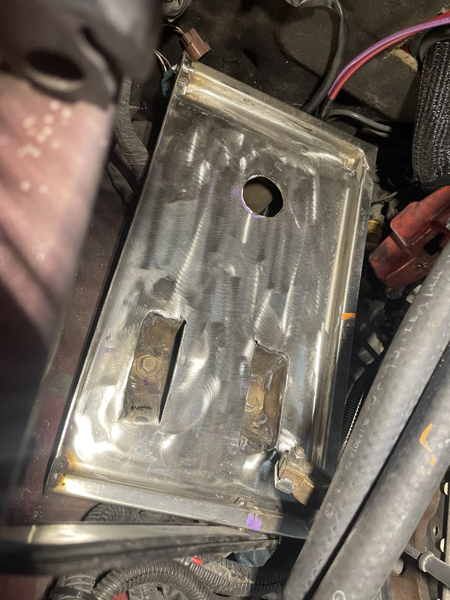

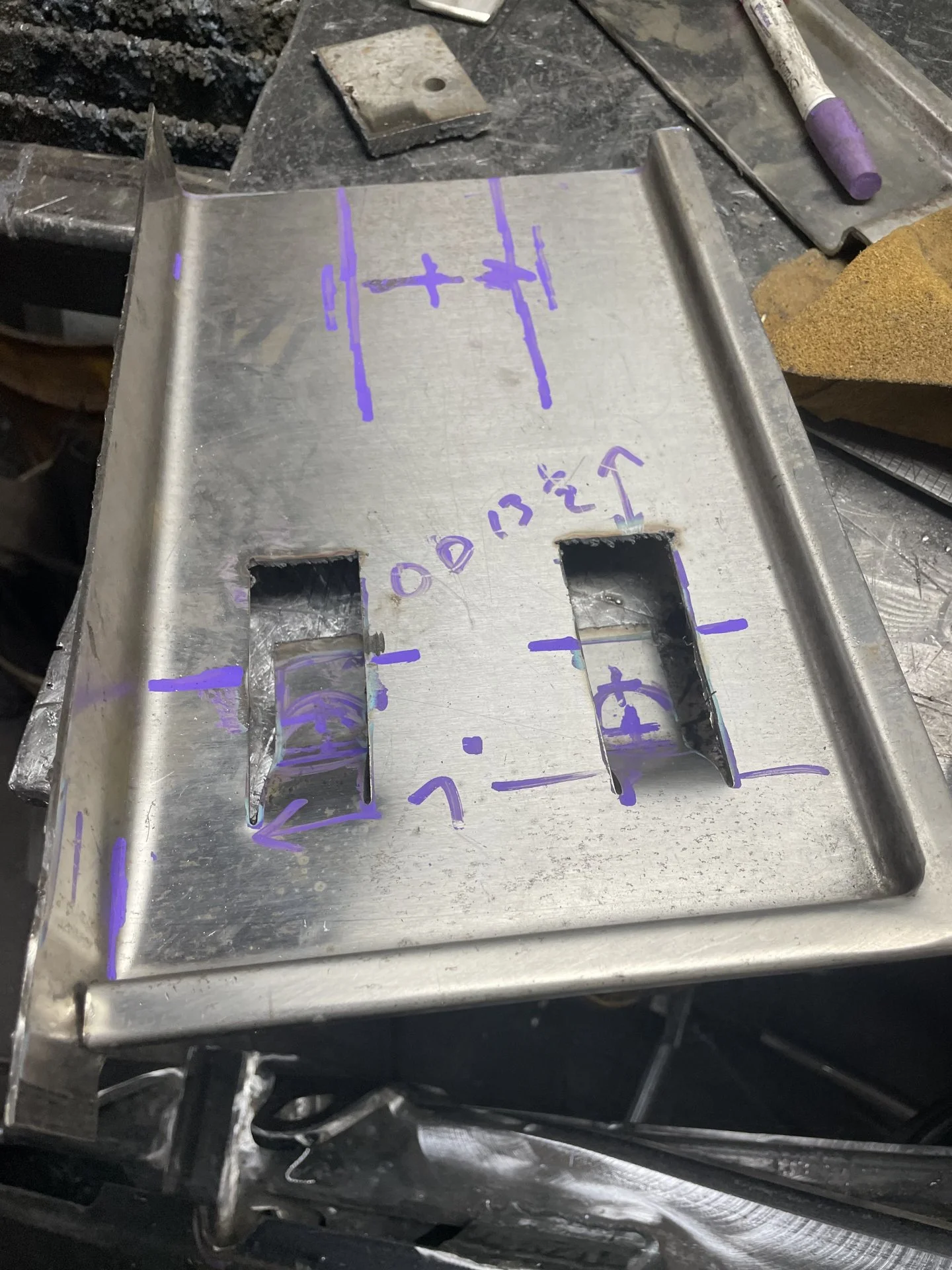

Pulled the battery and sure enough the battery box was starting to crack…. Thanks go out to @Loober for inspiration and @cruiserdan …
Dug around my scrap metal pile and found an old door or serving tray, not sure what it was….. But it was heavy gauge stainless steel and It had the perfect lip. Fast forward a couple hours and I had a new battery tray.

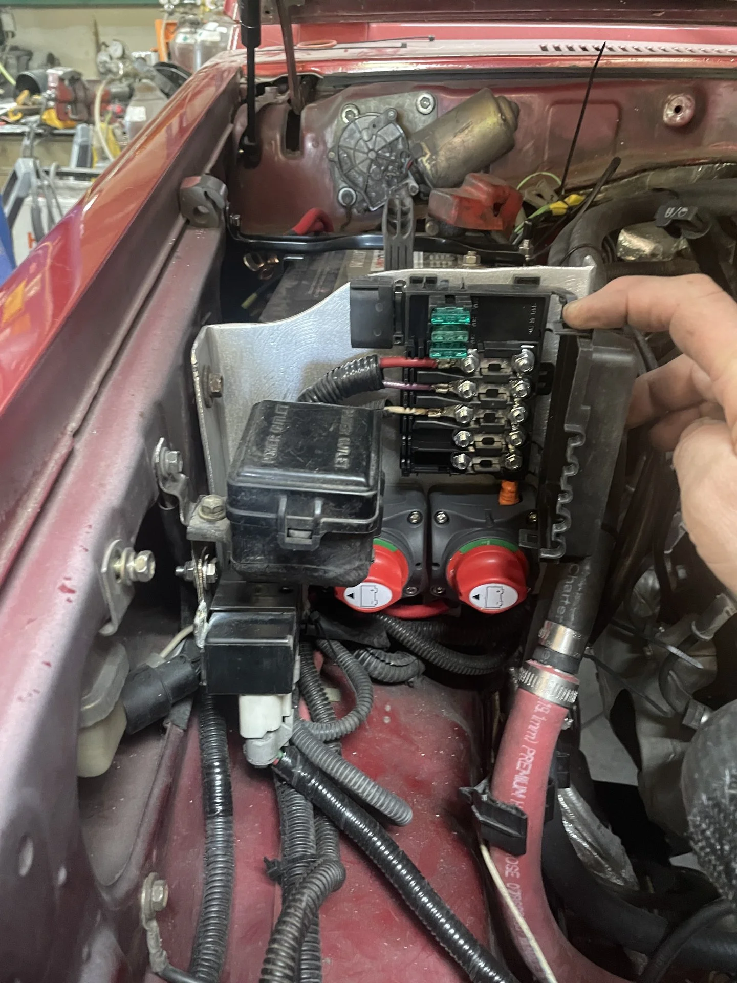

Got the panel made for the engine bay these box, and wired up a few things. The disconnects below are for that box and the one in the left is for the winch… since the airbox is gone I mounted the factory additional power source on the fender with the Volvo fan relays below it.

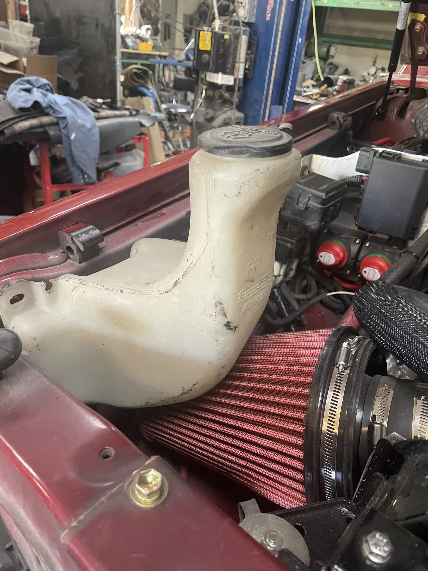

I know there’s tons of configurations, is there a windshield washer bottle for The driver side? Not much room with the air filter.
