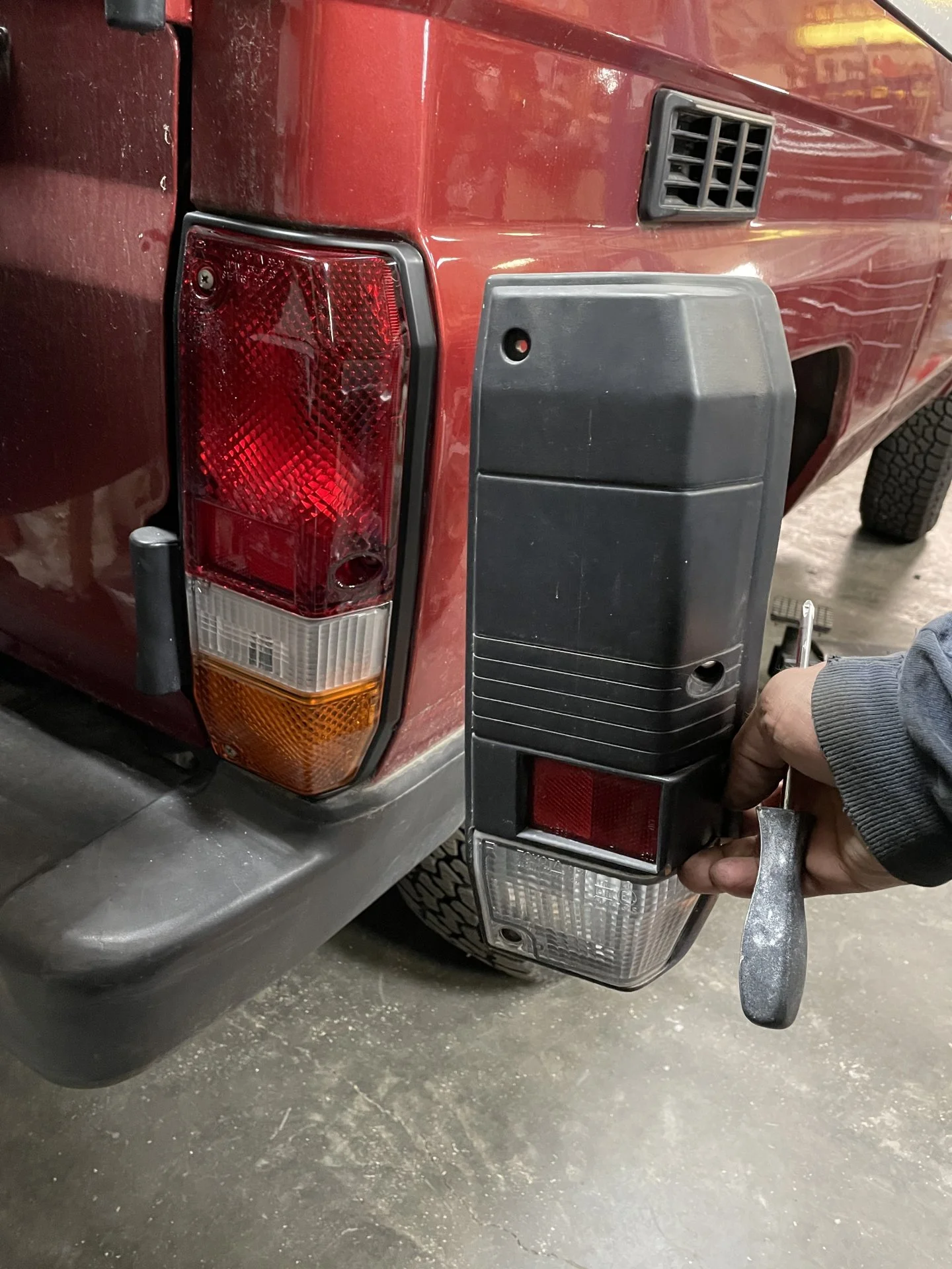

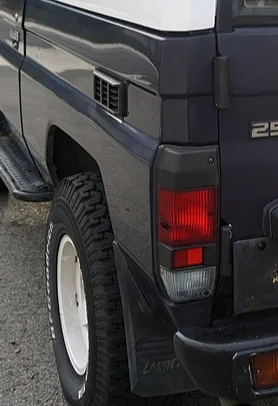

Beat me to it. Looks like that is correct. There should be reverse on either side and I believe a low vis/fog light on the one side.
No idea on what combos there are for original upper+bumper rear lights. I was referring to single upper rear combo's only.
Mine has reflectors in the bumper only to cover the holes. It used to have a trailer hitch, so all lights had to be moved up to make sure the trailer isn't blocking them. In EU the lights on both, trailer and trailing vehicle, must be visible at all times.
So, in your combo there surely is more space to accommodate two reverse and two rear foglights at same time. But,again no idea what is common in that setup...
Be carefully if you wire or rewire it differently as it really makes trailer wiring difficult.
Yes, I am wiring the trailer wires right now as I am doing this... so going to integrate it all while I extend the lines to the driver side.... Mine is a 92 from Spain so has the bumper turns and brakes/park and it sounds like one light on both sides are reverse. The only question is how to turn on the fog lights, the one extra light on the driver side... The passenger side is blacked out in that spot.
I had turn tail and brake in my bumper. I wired to that with my new bumper and lights. My reverse floodlight on the roof rack is connected to the left rear backup in the body. Toyota uses a 4 wire vs 3 wire tail light. If you use a 3 to 4 converter it will burn out if you are 24v. It may be fine with 12v. LED s cause other problems with the flasher............after all aftermarket lights and converter burned up I cut holes in the tail light housing and each housing has 3 seperated 24v led bulbs. My trailer has tail only and I drive conservatively with trailer.....fog lights use factory switch and wiring. My light bar is 24/12 v led.

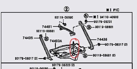

The battery hold down was missing when I bought this... so just ordered another one.

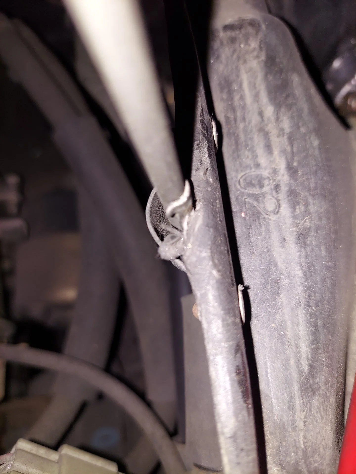

Went to install it and realized that the bolt was missing as well, and it does not appear to be a standard part sold separately, and when looking at the lower tray, not a straight normal bent end piece either -- but I am not sure. Anyone have one loose that they can send me a pic of what the end of that bolt looks like and I can make one?
The end of that bolt is encapsulated buy a metal cover that is riveted to the tray. I can't feel or see what's under the cover.
The end of that bolt is encapsulated buy a metal cover that is riveted to the tray. I can't feel or see what's under the cover.View attachment 2982420View attachment 2982421
Thanks for those pics.... Only idea I have short of buying a new tray is I can drill through that metal cap that is riveted and make some sort of curved washer to follow that profile....
I can tell you that the trays in my BJ74 have been into at some point because mine has little bolts and nuts instead of rivets. The tray I photographed is a vehicle in the museum.
Weld a tab on and use a j hook from just about any other toyota
