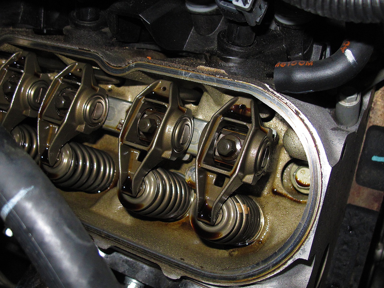

Is the other side of that cab and bed good? You should have no problem recouping a significant chunk of what you spent parting the rest the donor out. Typically a good Ly6 goes for about $1500-2K around here. They're sweet motors though. Drop a used LS3 take-out cam in it (probably $150 on ebay and 45 minute job to swap it) and get it tuned and it will be even better

So, what does this take-out cam do? Is this to get rid of the variable valve stuff? Trying to research what the best thing on wiring to do is, and can't find many instructional information to adapt the harness. Sounds like I need to reprogram the computer to get rid of emissions and other stuff anyway.... any advice?
I have basically zero Gen 4 experience besides swapping hard parts, I've never actually messed with an E38. I didn't realize that was a VVT motor, maybe better to just leave it alone? Not sure.

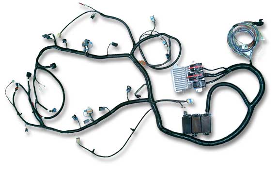

So, back to the engine/tranny. I have this running engine, but the question is do I break apart the harness to tie to the truck or do I buy a new harness??
I could not find a good video or website with instructions for dummy to do this.... and what I read talked about reflashing computer for stuff... So, I called PSI this morning, I can send the PCM and TCM (take out of tranny) to them and they program everything and send me a standalone harness.
'07 - '14 LY6 (6.0L)/ L92 (6.2L) w/ 6L80E Standalone Harness - https://www.psiconversion.com/products/standalone-wiring-harnesses/ls-58x/ls-6l80e-6l90e/HAR-1074.html

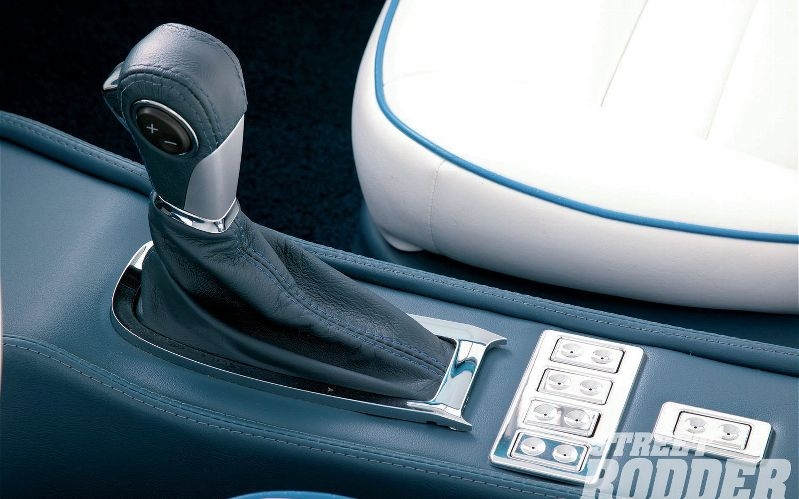

i do need to still find a shifter.. Found this one, looked pretty good. Thoughts?
It’s not that hard to strip down the original harness to make it standalone like that - just tedious. I’d say it takes a full day if you’ve done stuff like that before, maybe two days if you haven’t. Just depends what your time is worth
The guide should be online
Info dump, it appears the engine is a L96 engine variant. That is a 6.0 much like the LY6, but had flex fuel from the factory.
It has VVT, and it sounds like I need to get rid of this, as it is common fail. What I am confused about, do I have to do the camshaft swap, or is this something that is computer driven that can be taken out on the ECM and that is all we have to do?
