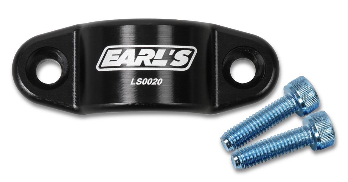

With the L96 out, I can start looking at other issues. First up was that it had an external oil cooler. Not sure if I need it or not, assume not as the loads will be never be close to what that truck would tow, so planning on blocking it off. Found this kit.
That Earls oil cooler block off is a joke, just grab the one of the other engine you have sitting there. They’re free from GM :lol:

I am going to run this blockoff plate that has provisions for 1/8" NPT. Amazon product ASIN B00LV4IJSY
