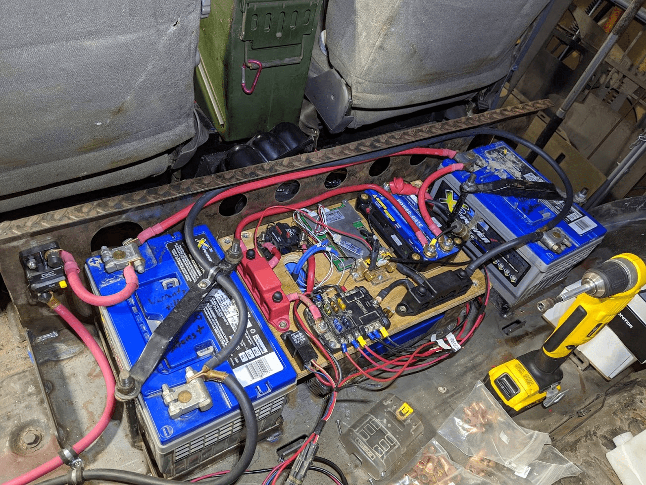

After 6 weeks, my wiring project is finally finished. Everything electrical has been function tested multiple times. I am STOKED. Next up, sound deadening.
Here's some highlights. I put a full blown write-up in my moonshine thread.

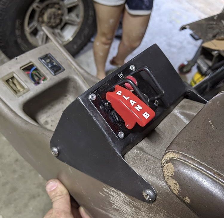

Went over to @GLTHFJ60 ’s place on Sunday and I supervised while he fab’ed up this badass bracket for my in-cab winch controller switch panel from 12-Volt Guy. Turned out great!
Photo credit: Johnny. (Again, supervised by me, so it’s not like I did nothing!)
