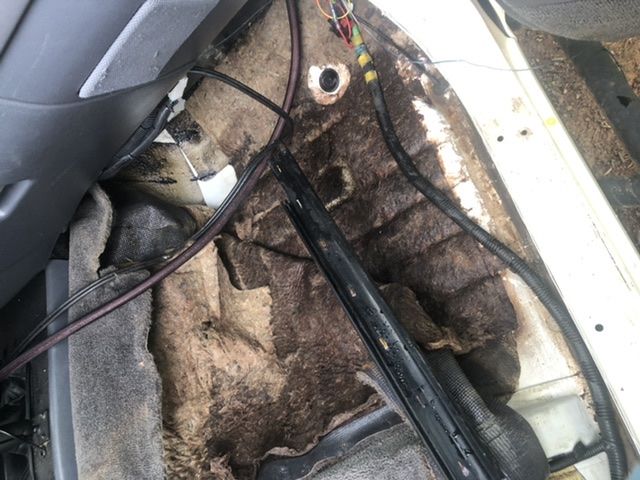

lots of water in passenger floor. Sunroof drain clear, any ideas?
2nd the windshield gasket. Eapecially if its not the original. Most installers do t realize the rubber also gets sealant. They install dry and they leak. My 80 leaks on both sides
Windshield is original, and looks fine. It’s only wet on the floor pan, can’t see any water coming down from the top. Also looks like there is water draining from the pinch weld
@pkniland
Seal about 6-8” across and 3-4” up each lower corner with packing tape or that fancy chrome stuff I use. Start on glass and end on metal, encapsulating the rubber there. Hose it down really well in one corner. Check for leaks where mentioned above. Then do the other side. That’s the quick and dirty test. The long and painful test is to do the entire gasket like that but it’ll for sure stay dry after that, pointing to a bad gasket, and then you’d have to remove a perfectly functioning repair just to replace a gasket. It’s maybe a one beer job. 3 if you’re lucky.

@pkniland , check the drain hose on the A/C
I found another thread about sloshing in the rocker and clogged pinch weld drains. I think they are filling up in heavy rains and overflowing into the floor. I think they are either clogged or rusted shut. At least I think that’s what’s going on
