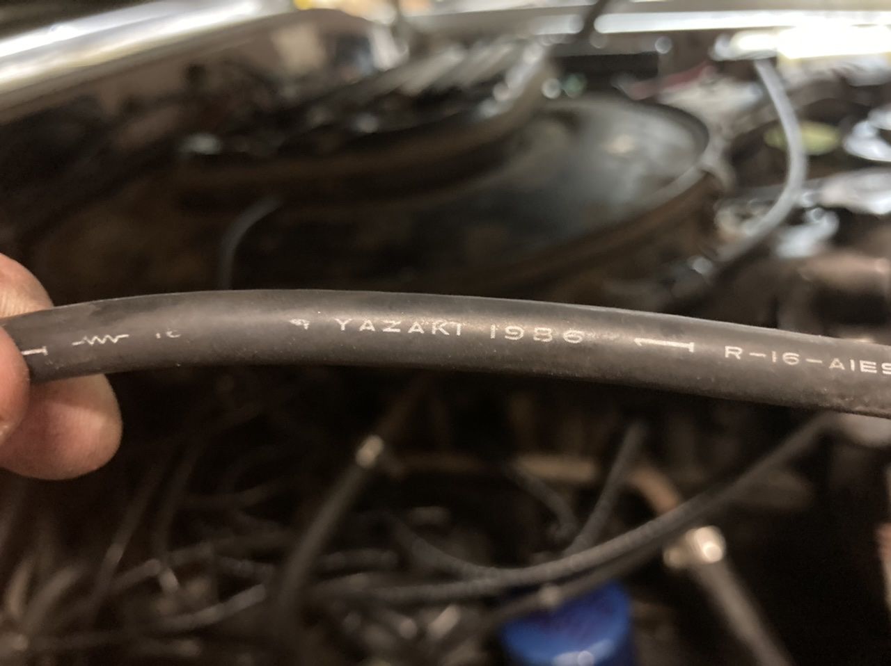

I changed out the plug wires in my 60. The old ones were OEM and looked to be in ok shape. “1986” is printed on some of the old wires and “1987” printed on others (it’s an 87 model 60). Is this the year the wires were made? If so, is it really possible that the wires are original issue after 33 years and 260k miles? Pretty amazing if so.
Unless you got some NOS on those wires, that is crazy!
Hadn’t thought about that. It would make sense, since the wires looked like they were in good shape (still pliable, no visible cracks). It’ll remain a mystery. New OEM wires replaced the old ones. Should be good for another 30 years.
