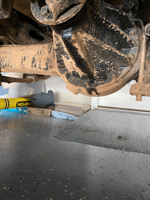

when i got back from uwharrie today, i started cleaning off all the mud and noticed this leak:
looks like the pinion seal? i just drove around a bit more and it doesn't seem to be an active leak. i haven't used my 4wd in a bit and wondering if that might have played a hand in it?

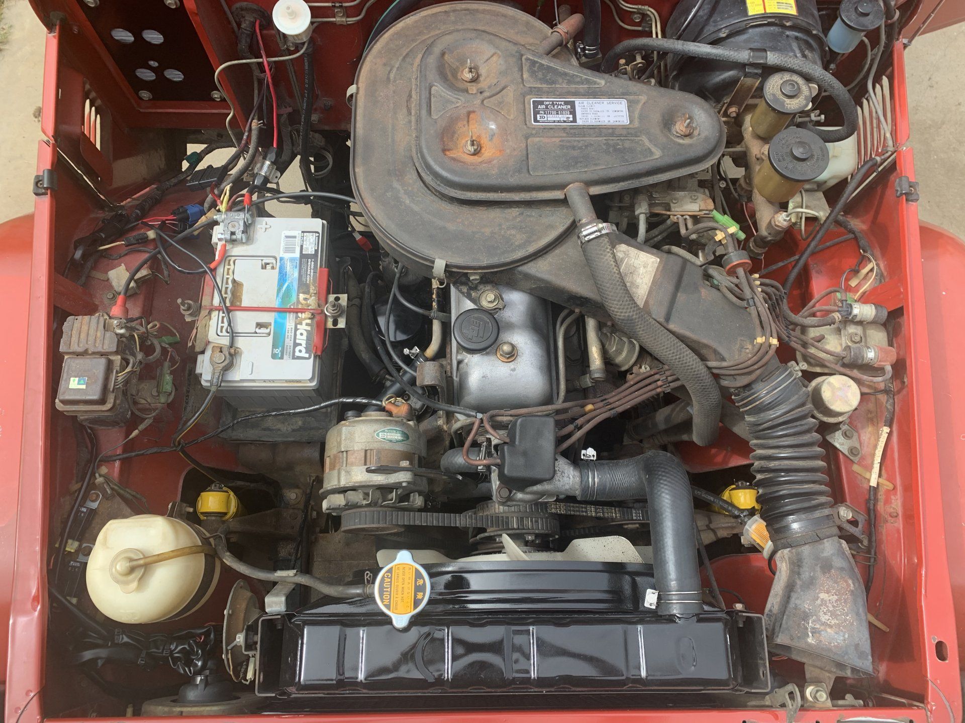

Improvements on my FJ40 continue. Knowing my limitations for talent and time and my lack of the proper tools, I decided to hire someone for the next round of upgrades.

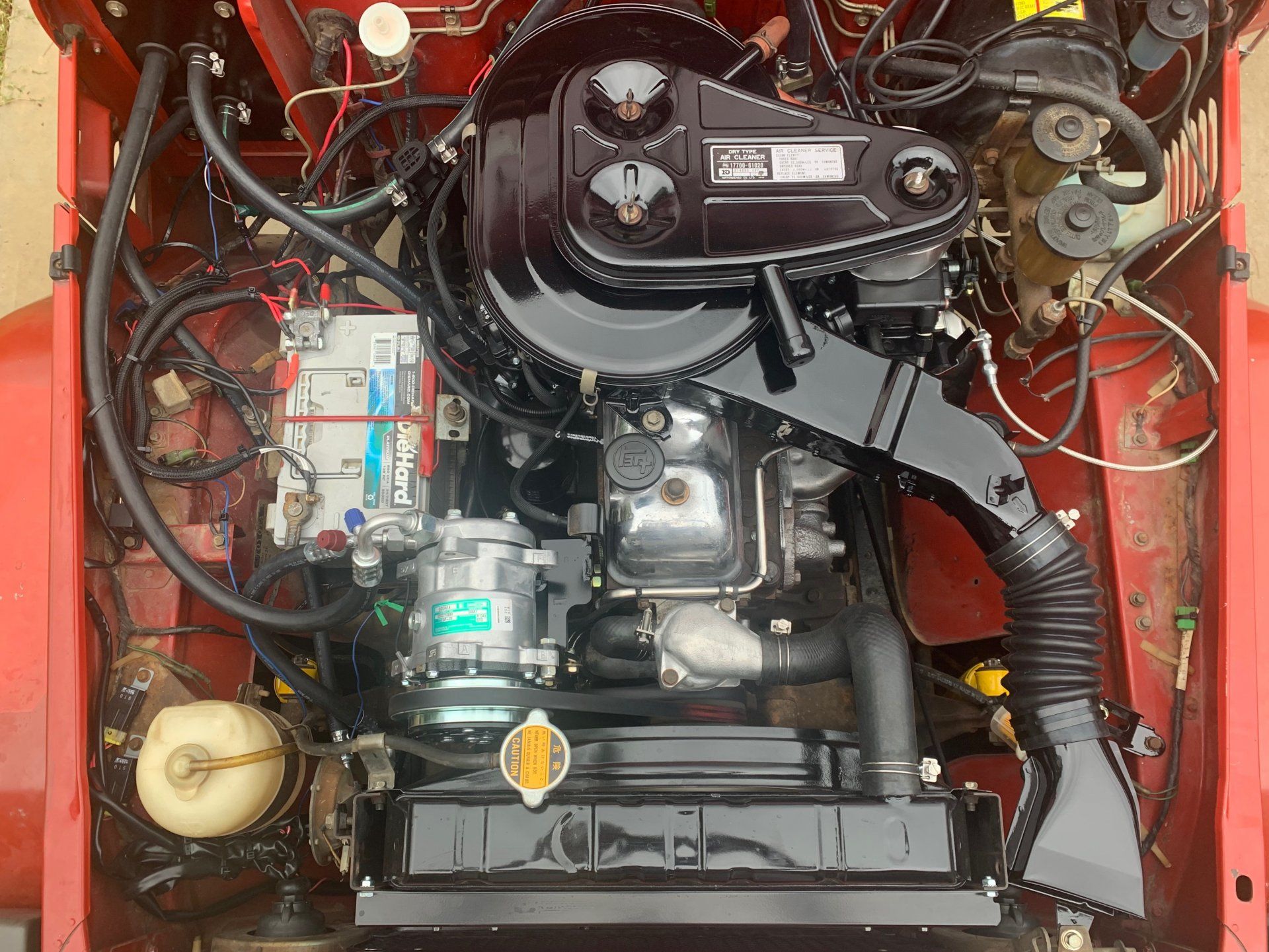

The first picture is of how the truck looked when JP (@ClemsonCruiser) picked her up a few weeks back. I’d removed the blower motor in preparation for the Vintage Air install. The picture below it is the after shot, fully de-smogged and with the Vintage Air, Holley Sniper EFI and DUI dizzy installed. Among other things I asked JP to fix the exhaust leak(s), adjust the valves and repaint the air cleaner while he was in there, and he surprised me by polishing the valve cover and cleaning up the intake and exhaust manifolds.

I’ve logged over 3 hours and 150 miles of mixed driving since picking her up (most of was taking the scenic route home from North Augusta) and I’m loving it. It’s so incredible to drive around in 90+ degree heat with the windows up and feel cold air blowing.
JP is branching out from only doing nut and bolt restorations to doing work like this. I highly recommend him if you’re like me and lack the skills, time, tools and patience for multi-banana wrenching jobs.
Before you pull the third, replace your axle breather first. I had a similar problem a few years ago. My factory breather was completely clogged and I replaced it with a longer 1/4" oil line and a lawn power fuel filter and then ran the filter up near the fuel filler neck. My leak went away.

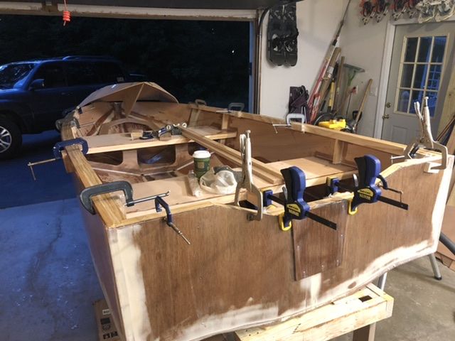

So close.
Hope to have the build done by next weekend. I’ll still need to put on a few coats of epoxy to water proof and add flotation foam, but it looks like it WILL hit the water this August
