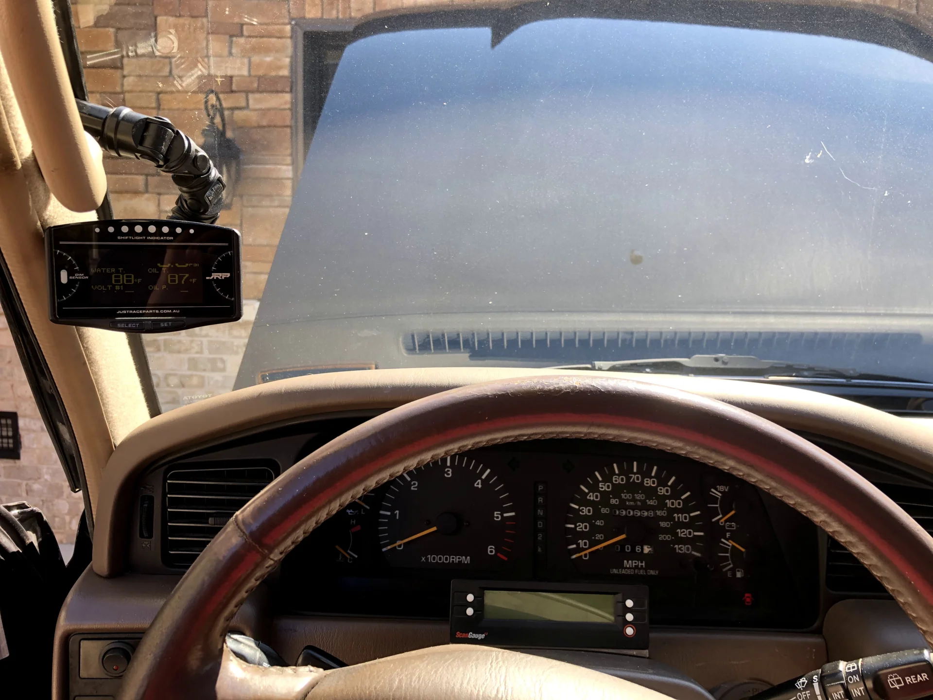

Different rig but
Wideband
Boost
Fuel pressure
Spark adv
Trans temp
Iat2
Coolant temp
2 gauges total
Jeff, that looks like a neat set up.
Where / what / how did you run the various hose / wires?
Thanks
Wideband AFR, boost gauge. EGT is kinda irrelevant in the petrol world, but very important for diesels
Thanks
All the sensors requiring tubing, etc. are out under the hood. They all then wire back to the computer which is remote from the gauge you saw. I zip tied the computer under the dash near the steering column, Will take a couple of pics later today and share.
Thanks for the kudos - it's a nice setup - very compact for al the info it provides.
