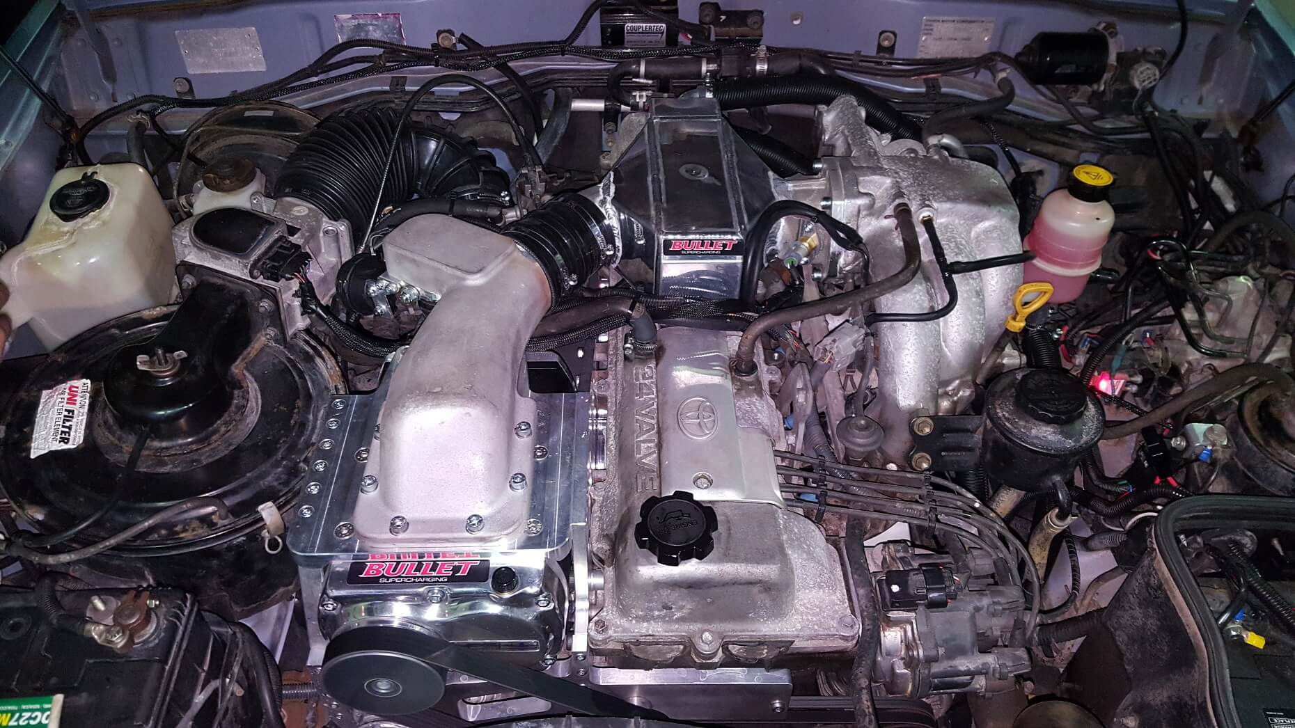

I spoke with Tom from Bullet Cars about an hour ago. You can get his super charger for $3900 american dollars delivered.
@scottryana - Sorry I forgot you were running that already. Where do you think the stock limit is in terms of boost? Do we know, or have an educated guess where the fail point for high awhp is - head lift, transmission, birfs? I vaguely remember seeing a youtube video of a modified Cruiser in the middle east pushing over 1000hp? There weren't great details on it and it's not overly hard to make a dyno lie.
Never even heard of that one. Intriguing :hmm:
Transmission is going to be the weak point as far as I can tell, but the A343F with some work does seem to hold pretty decent power. Head lift could be an issue I guess if you tune the boost to come on too low and there is huge cylinder pressure. On an all out effort like I would like to do with my other truck using ARP and MLS gaskets should let you run any amount of boost you would want in a SUV I would think.
I am really thinking about it. They have this well engineered. And the price is better then anything TRD new if you can find it.
Is that just the supercharger kit? No engine management or intercooler?
I think with good maintenance the tranny should hold up. Not driving like an a****** all the time will help too. Not like this SC is going to be putting out monster power. A bit more then the TRD SC from my understanding.
I am getting the head done on my lx450 and putting in the supra studs replaced. Should hold everything together on 5PSI.
BTW when I bought my truck the tranny was smoked in it. Fluid blacker then hell and smelled no better. I think the cooler got plugged up do a lack of giving a crap (maintenance)
How much boost do you see a stock head and gasket set taking along with the A343F?
You can get all kinds of stuff for it, how big is your piggy bank?
AFAIK there is are no engine management upgrades required.
They do have a piggy back or something for the ECU. If you want to tune it more you can but again more money.
I don't have all the details yet, I will talk with Tom from Bullet Cars some more soon.
If I do this, I am not going to try to make monster power. A LS1 would be better for that, however the price point and gain seem to
be a good idea.
A 50-80HP gain would be wonderful!
