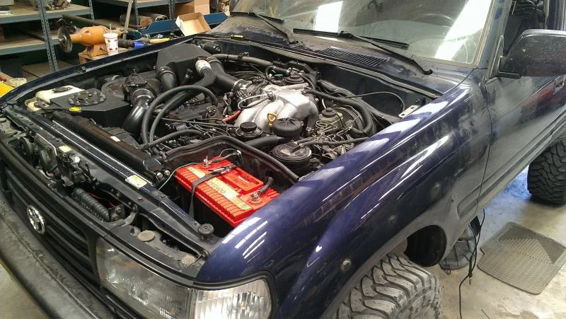

More assembly being finished up. Almost ready to start it up.
The more I look at it (too much) the more I like the black valve cover. Once the blue and red silicone is replaced with black and I get some black heat paint on the intake/throttle body the look will be complete.
The titanium turbo blanket and titanium wrapped IC to throttle pipe will be gold. The rear of the IC is coming up 2 inches to get the needed clearance between the turbine housing and the rear intake pipe.
Almost ready for pickup. Just a few more details to button up such as gauge pod, some vacuum lines that need to be changed, and some other minor details.

Here is another photo from a few minutes ago. some minor changes. Still a few things to finish up. Should be ready for you tomorrow.
jamisobe picked up his Land Cruiser earlier today. Enjoy the truck Bret, I'll touch base with you this evening to see how your drive was and to follow up.
