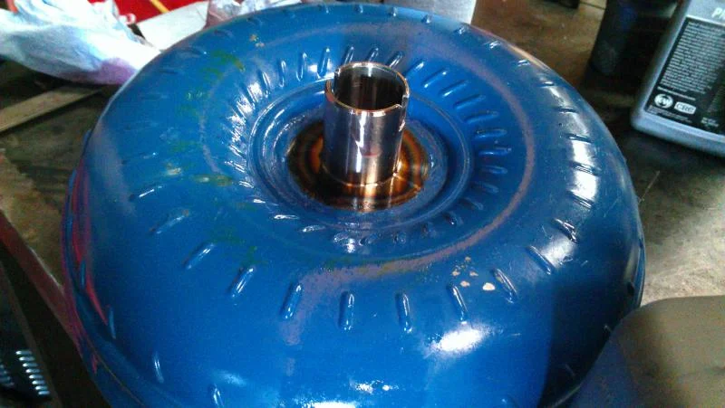

2600-2800 stall speed modified OEM torque converter
That is what I remember off the top of my head right now. I have faith that everything will work as expected and the time of truth approaches quickly... :)
