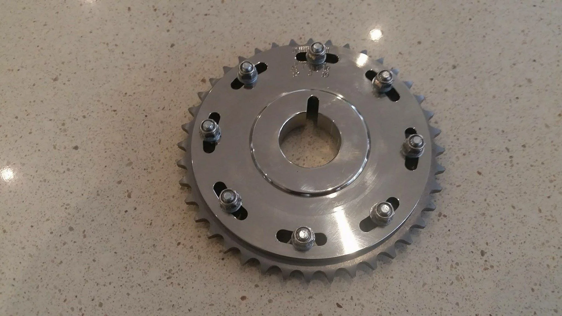

Whilst i'm here I'll just leave a picture of the new 1FZ adjustable cam gears that I'm now producing - they are an aluminum CNC anodised centre fitted with a machined, new OEM Toyota gear and stainless fasteners. They have 10 degrees adv and ret cam timing adjustment. They are intended mainly for adjusting the timing of custom cams in relatively modified 1FZs to get it perfect, but they may also give some benefit in mildly modded motors - I would be interested in supplying a couple to guys for testing purposes - if it makes a difference you can have it at cost, if the motor makes no additional power or doesn't result in any measurable, just send it back for zero $$!
If anyone's interested drop me a PM. (if moderators want to delete this shameless plug - fair enough! :D I literally have only just begun to produce these so haven't got as far as working out final pricing or actually promoting them - I will be doing that sometime in the new year)

This looks good and I would like one if they are available. However what we really need are adjustable gears so we can fix relationships between the two cams if necessary. Although that's pretty tough as no one seems to know stock specs. I am just waiting on a new stand but then I will measure stock cam specs. But that still doesn't tell all because we don't know what they are supposed to be, I will only know what they are. Got all my measuring tools ready, just waiting on a new stand

First name is Ryan, but many years in the military so I go by either Ryan or Scott either is fine. lol. It is available from a guy in Australia names Sean Gannon sean75@gmail.com. He is working on an adjustable exhaust gear but as of now this is the only one and you will see why once you open the engine up. It has been a while since I have talked to him, but he might already have it done.
