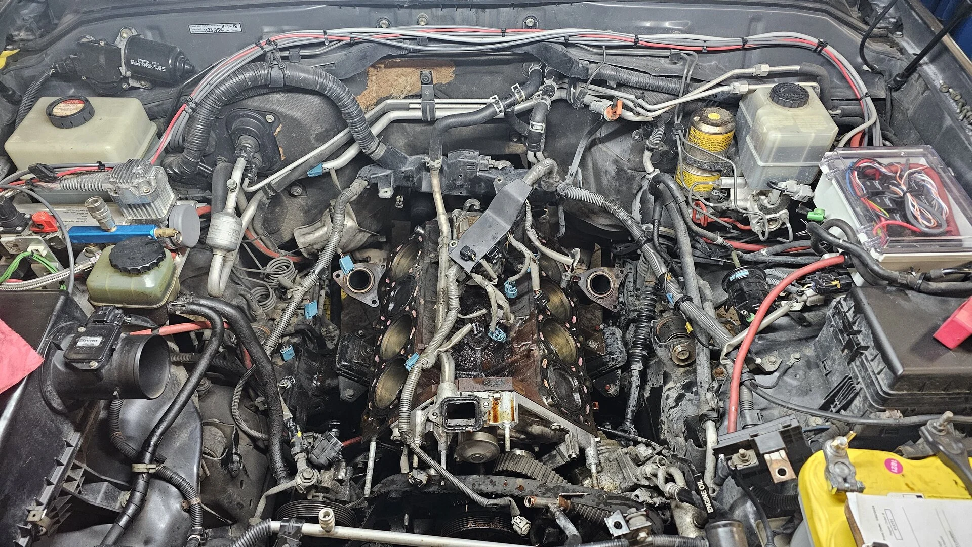

I had my shop pull the heads.
  • New OE exhaust manifolds.
  • Drivers head (with blown plug) was replaced with a reman head.
  • Passenger head was pulled and sent to a machine shop for rebuild. Surfaced to match reman head.
  • Starter replaced with Denso Reman.
  • Injectors replaced with Denso
  • Coils replaced with Denso new.
  • Sparkplugs replaced with Denso new.
  • Oil filter replaced with Denso new.
  • Timing belt, tensioner & waterpump job. Aisin. I was 50k into timing job so we just reset the clock for 90k.

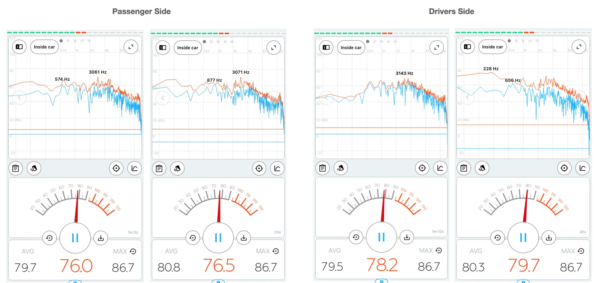

Exhaust tick is gone. The engine sounds louder. 50 miles after the service, she kinda sounded like a diesel. 200 miles in, I *think* shes getting quieter, and settling into the standard 2UZ sounds, but still seems pretty loud compared to the older background to the exhaust tick. Really glad to have the tick gone (and be driving her again) but weary of the louder sound.

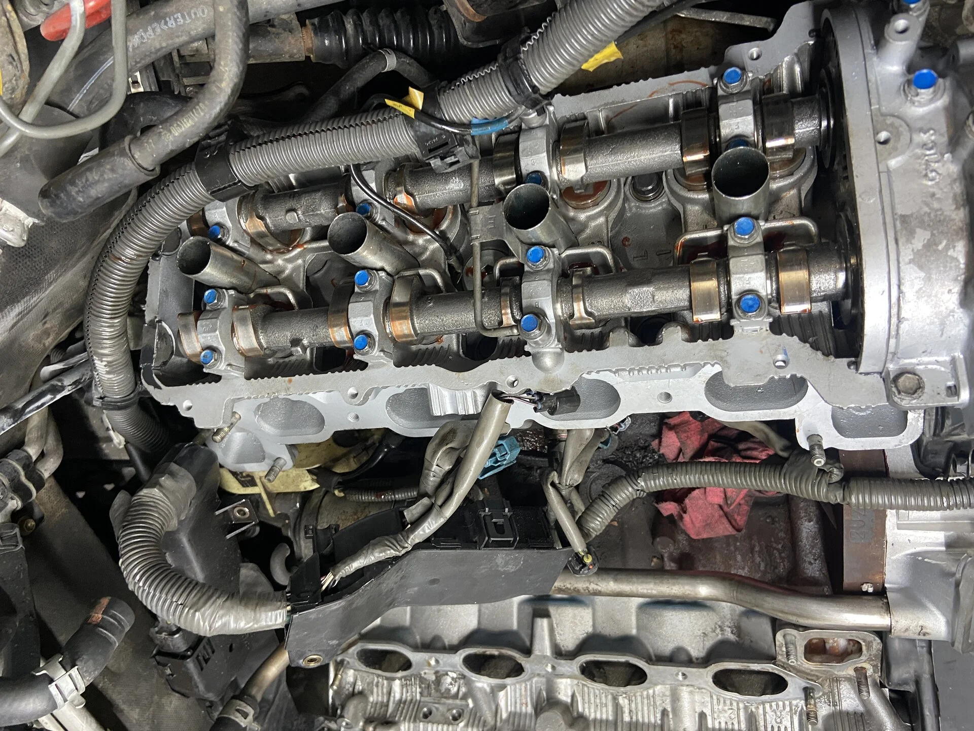

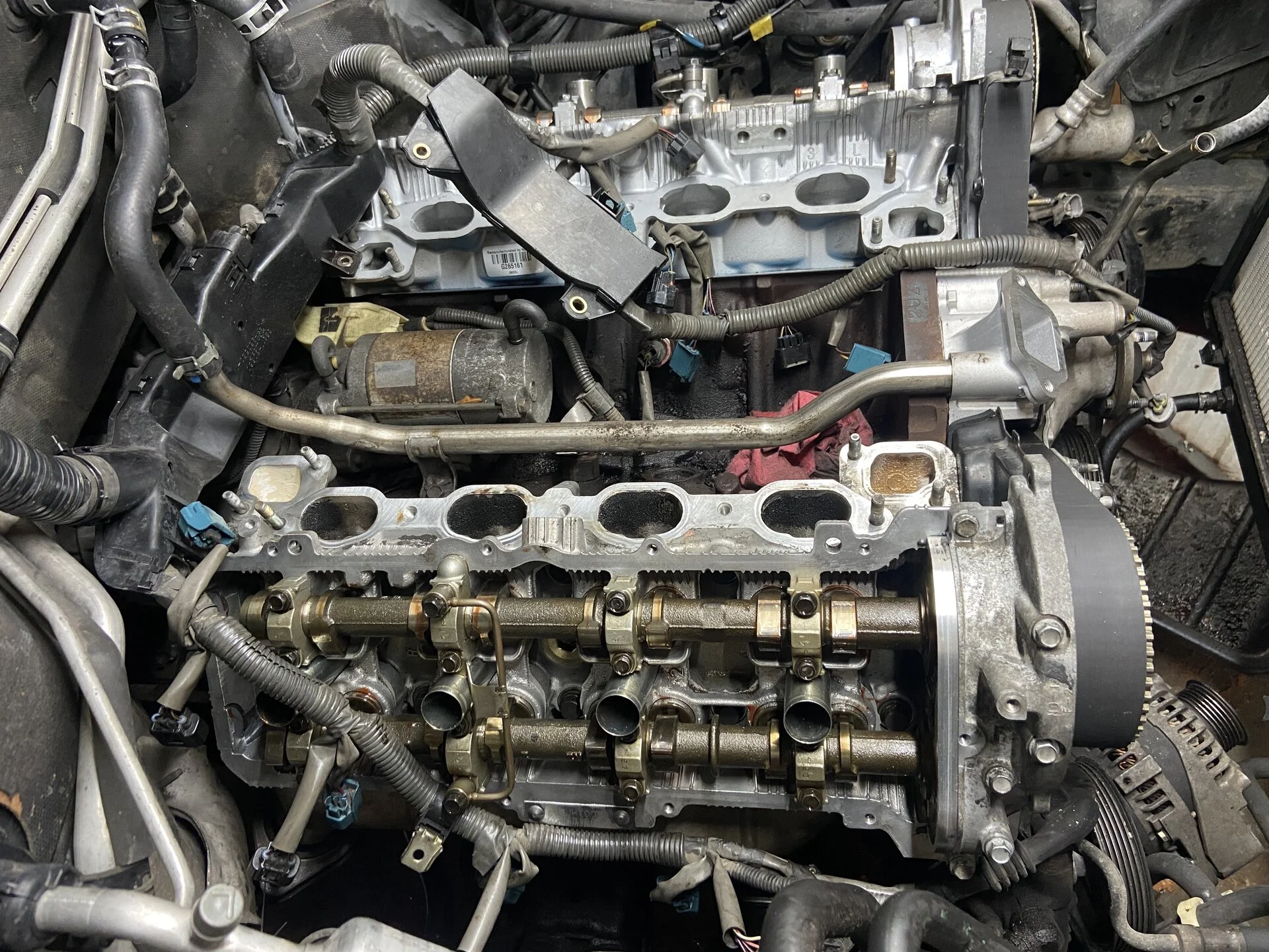

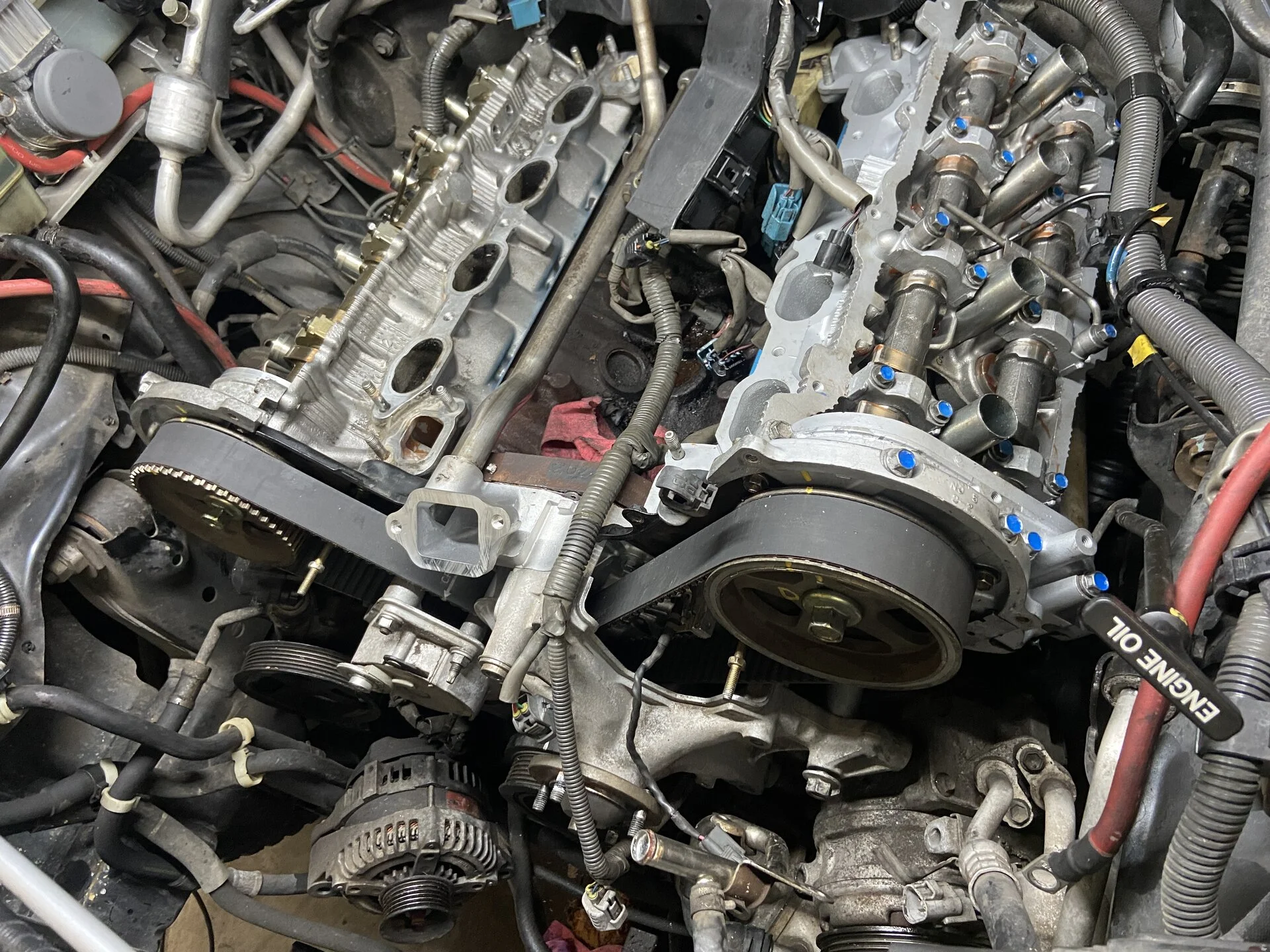

Reman with blue bolts:

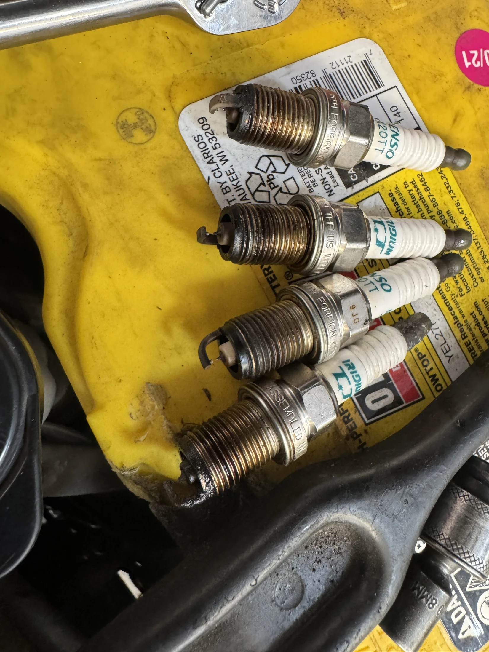

Original head after rebuild. Note I've consistently used non-synthetic oil every 5k miles. Shop used synthetic this time.

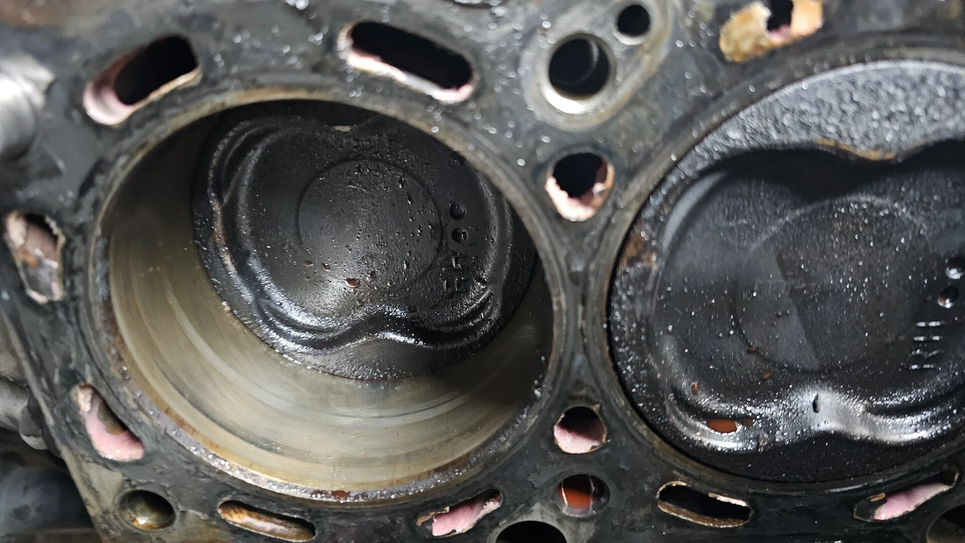

What is this pink crap!!?? I've spent soooo much time trying to clean up my cooling system. Multiple flushes previous to this photo. My gosh.
But checkout the hone marks still present on all the cylinders at 270k!

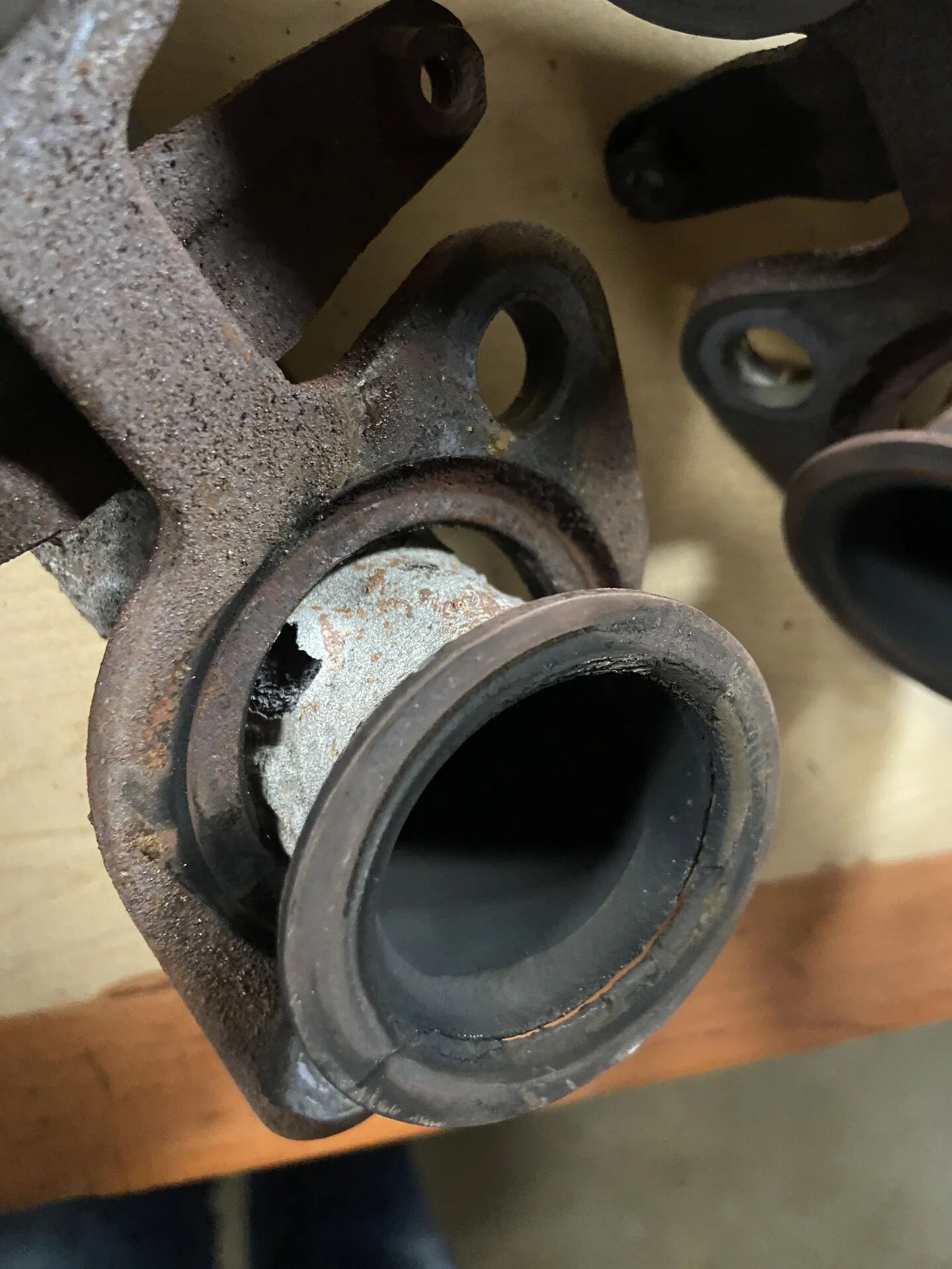

And here's what started this whole mess in the first place. My exhaust tick. As I heard the tick getting louder over last few years, I thought the crack was getting worse, but in reality I guess my sparkplug #7 was slowly winding itself out of the block.
First, I'm glad you're back on the road. :cheers: Curious, what was finale tab$?
As you now know. I always advise when a tick, tick, tick heard. Check to see if spark plugs are tight. If after doing so, tick still heard. It's the exhaust manifold. My 01 had both exhaust manifold replaced, at under 60K miles. I just replaced my DS 03 at 317K. The fact the exhaust manifold tick (crack), is so common in the 4.7L. That the spark aren't often a consideration, when the tick heard. But fact is, more spark plugs are the primary reason we hear the tick, tick, tick, pop, pop, pop!

I'd very likely have replaced the fan bracket and possible drive belt tensioner.

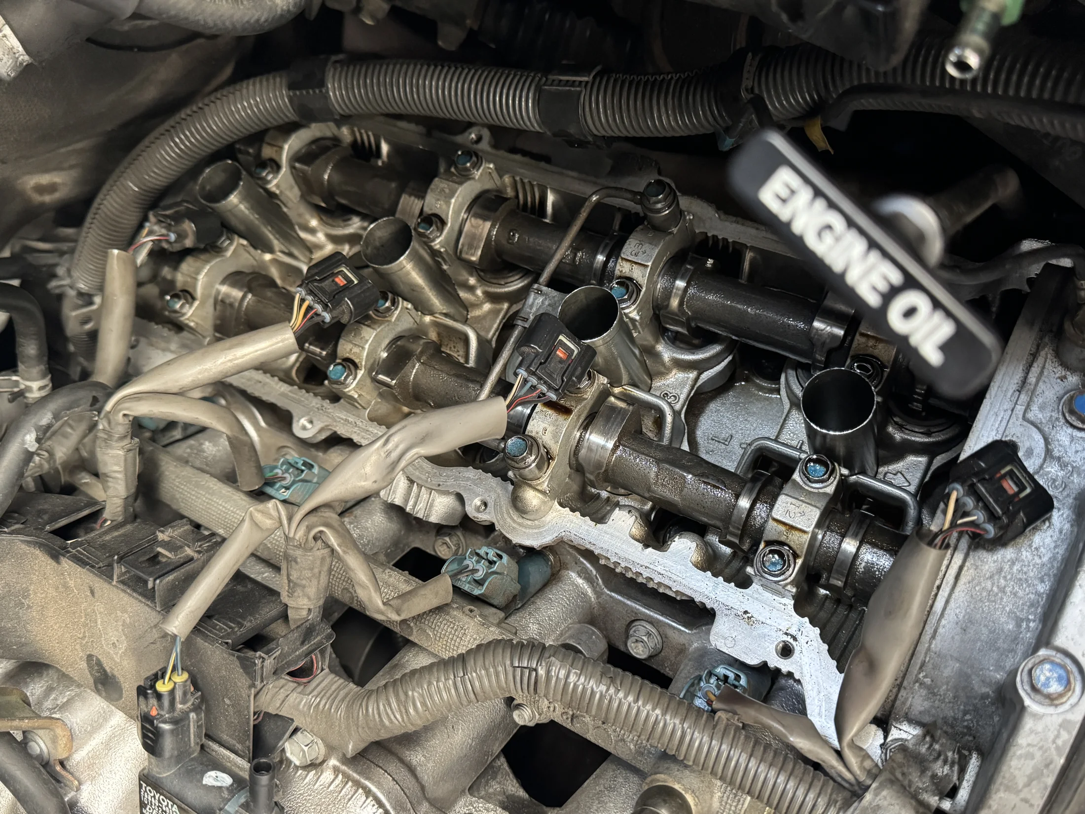

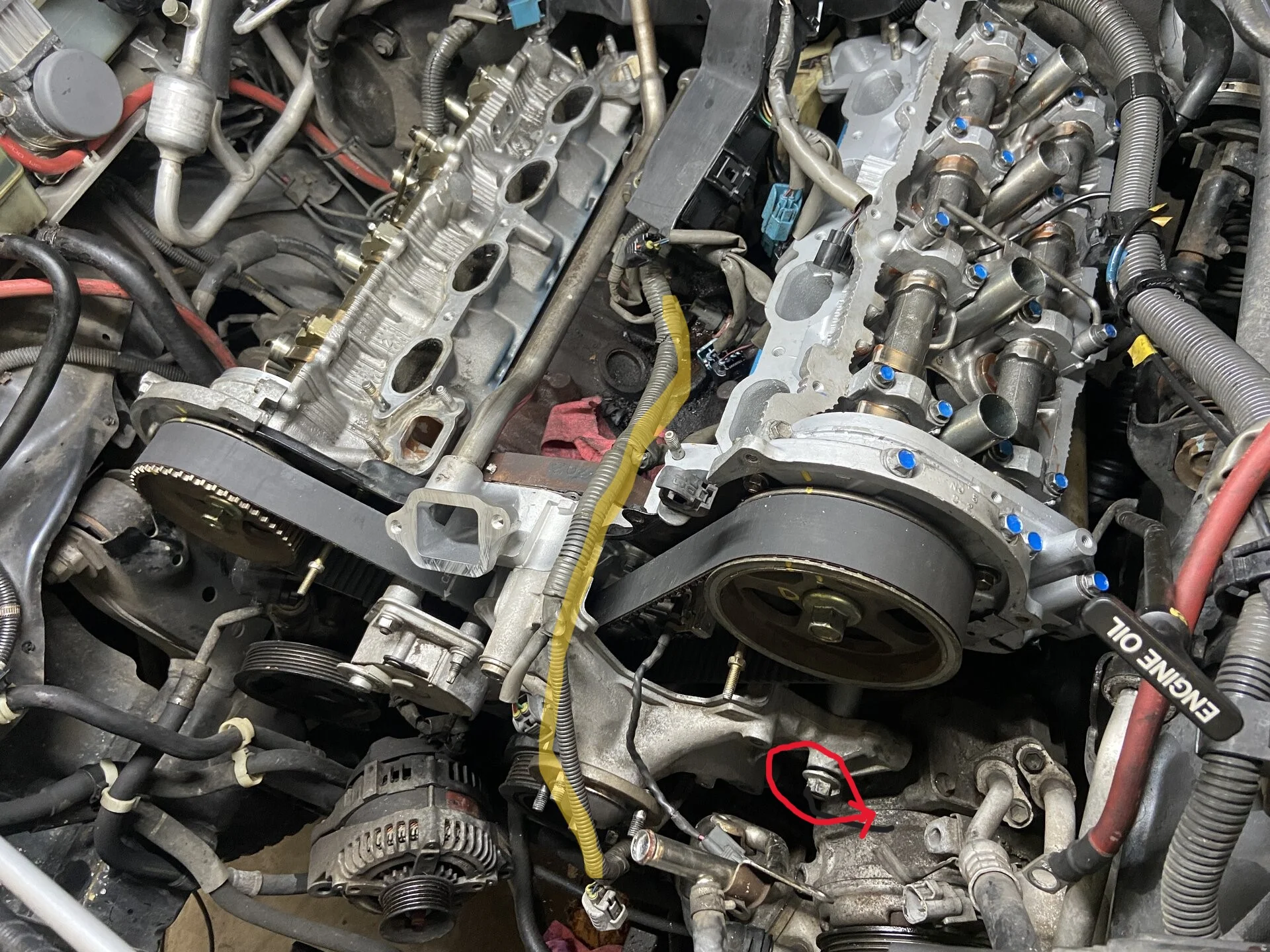

Looks like (not a final assembly picture), they routed crank sensor & oil sending unit wire harness wrong. If that the case, have them rout properly, behind fan bracket. They can replace fan bracket at that time, since removing anyway.
Indication is, wires routed wrong. But since, fan bracket bolt still loose. So not a final assembly picture. I'd check now, to see if routed correct.

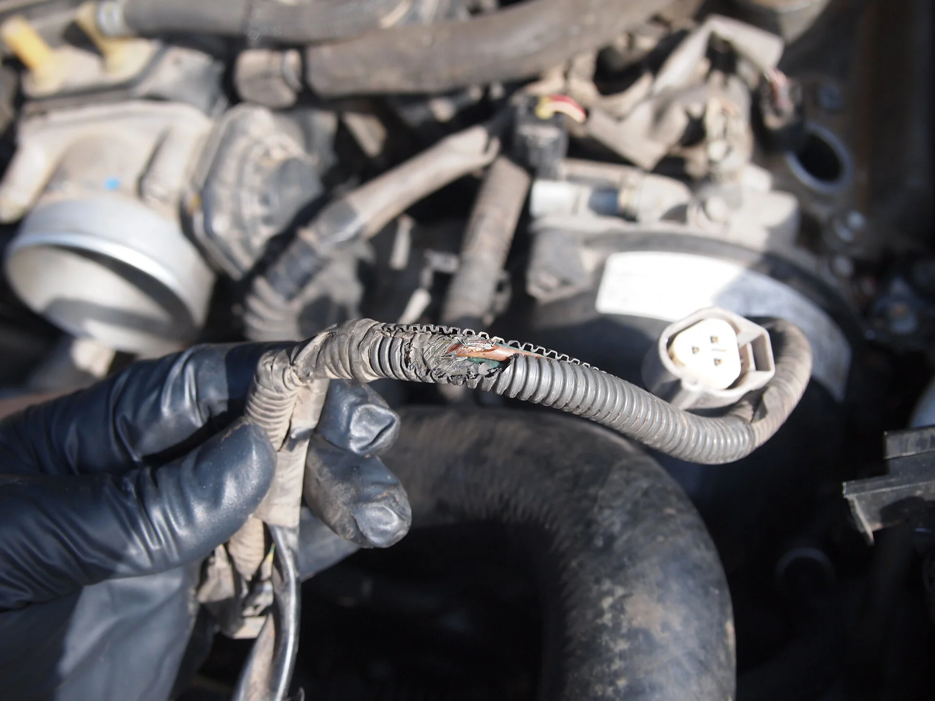

Here's one routed wrong, seen after assembly.
The wires, can rub on drive belt and be cut.

I inspect fan brackets (FB) first, while engine running with stethoscope. When out of engine by spinning by hand. Any sound it's on the way out. If it just keeps spinning, it's on the way out. FSM also states; if any oil seen on bearing seal, replace FB.
I rarely reuse a fan bracket, when I've one out.
Dust stick to oil, weeping from bearing seal. This is sign, of very early stage seal failure. Fan bracket shaft bearing, will not likely last another 90K miles.
Looking close, one can see a little oil glistening, lower right area of bearing seal. Even this one, I didn't reuse during T-belt service.
You two choices on which fan bracket to buy. Toyota Aisin or Aisin. Toyota Aisin is top shelve.
Lol phone says drivers side is 3dB louder when I hold the phone over drivers side vs passenger side. But theres also an airbox in the way on the passenger side. NOT the best way to measure this. I think the video audio was actually surprisingly representative.

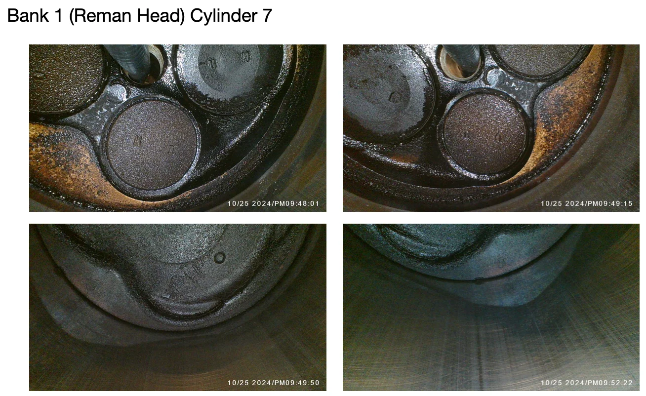

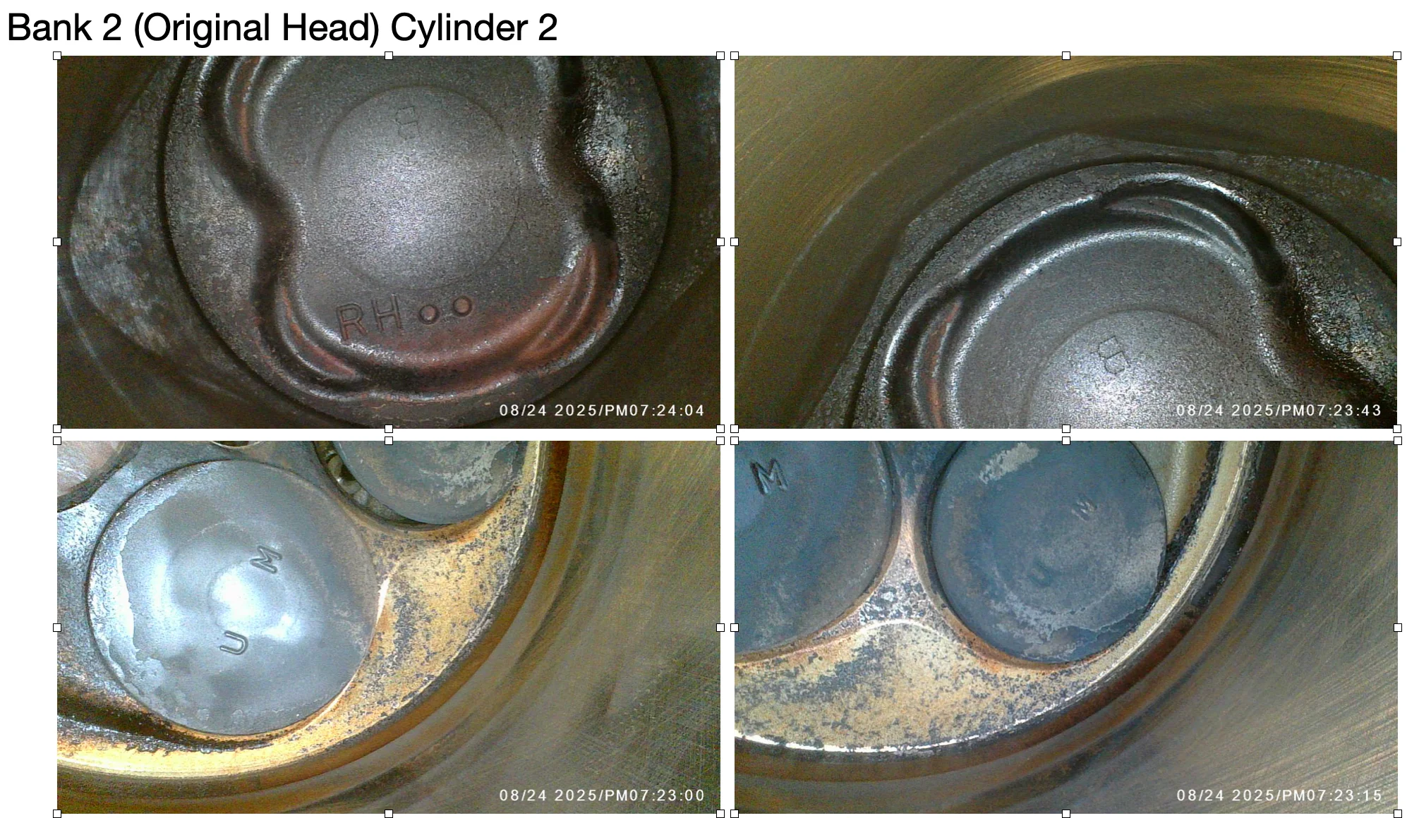

Scoped all cylinders Sunday night, then came back the next evening and scoped a few again.
Its clear that oil is seeping out of the valves on the "new" head. Bank 2 with original, rebuilt head looks nice and dry.
1756208469694-webp.3978540

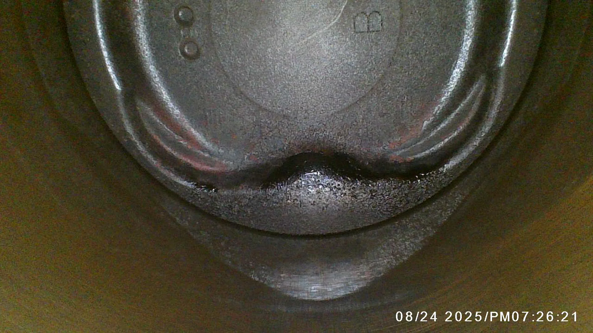

Oil in cylinder after sitting (engine cool down). Is associated with valve stem seals, and may indicate issue with valve guide.
Cylinder #4 second picture where we see "RH" on piston, is looking to clean. I also see what appears to be a pink residue. Are you also losing coolant?
I'd pressurize coolant system to 15 to 17 PSI, on warm engine and scope cylinders. Keep pressure at 15 PSI, and continue inspecting cylinders periodically as engine cools, and after engine cools overnight (8 hours). You're looking for coolant drips from head gasket (leak).

@2001LC what do you mean by "too clean"? Here are some more photos of CYL 4.
Not sure what this is:
To me, the spots on the pistons look like oxidation ... rust. No experience to know if this is normal or not.

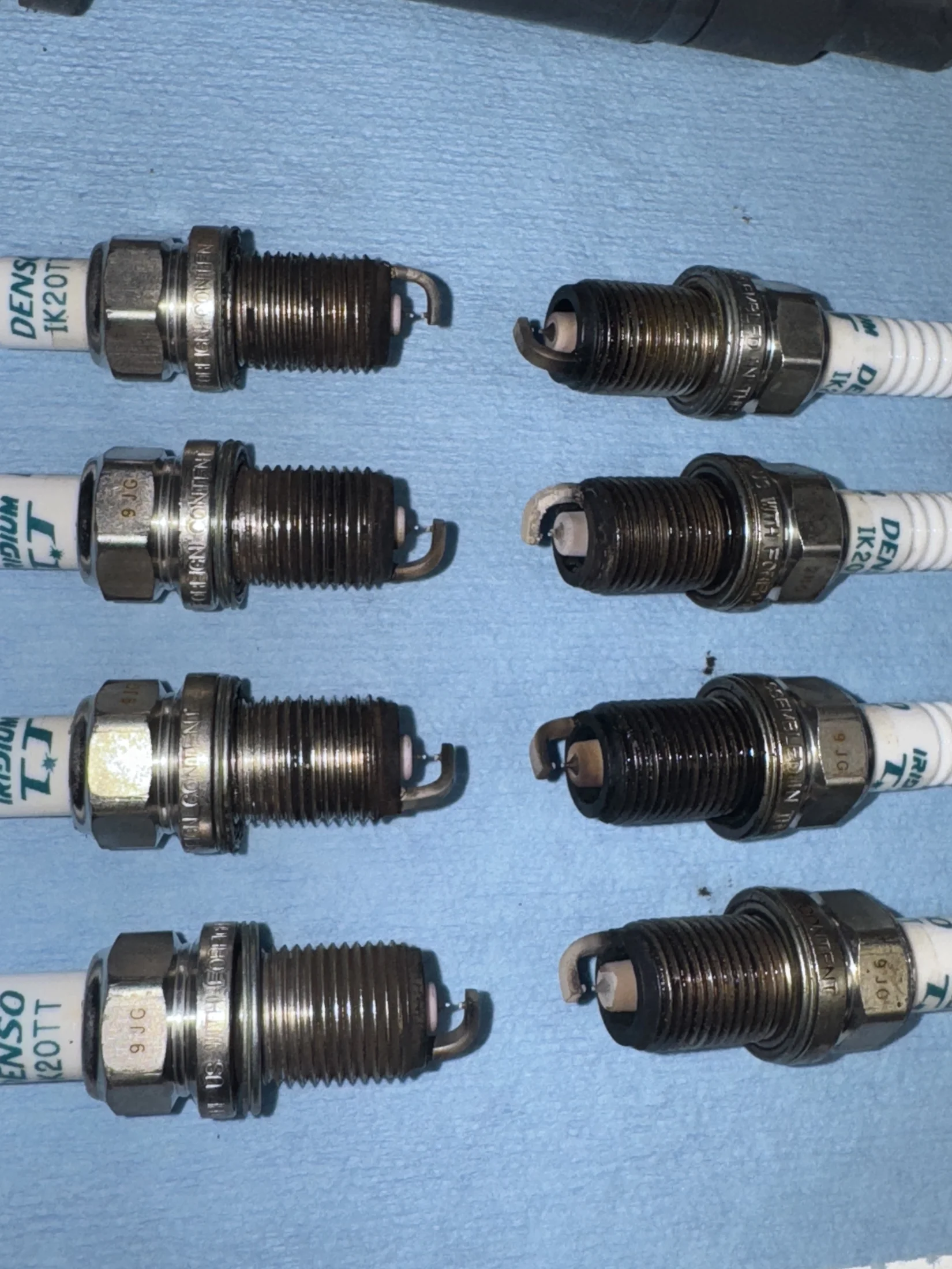

Sound improved after topping up oil. What's best way to measure oil pressure? External gauge or reading from techstream?
Side-by-side of plugs. Dry on bank 2, wet on bank 1.
