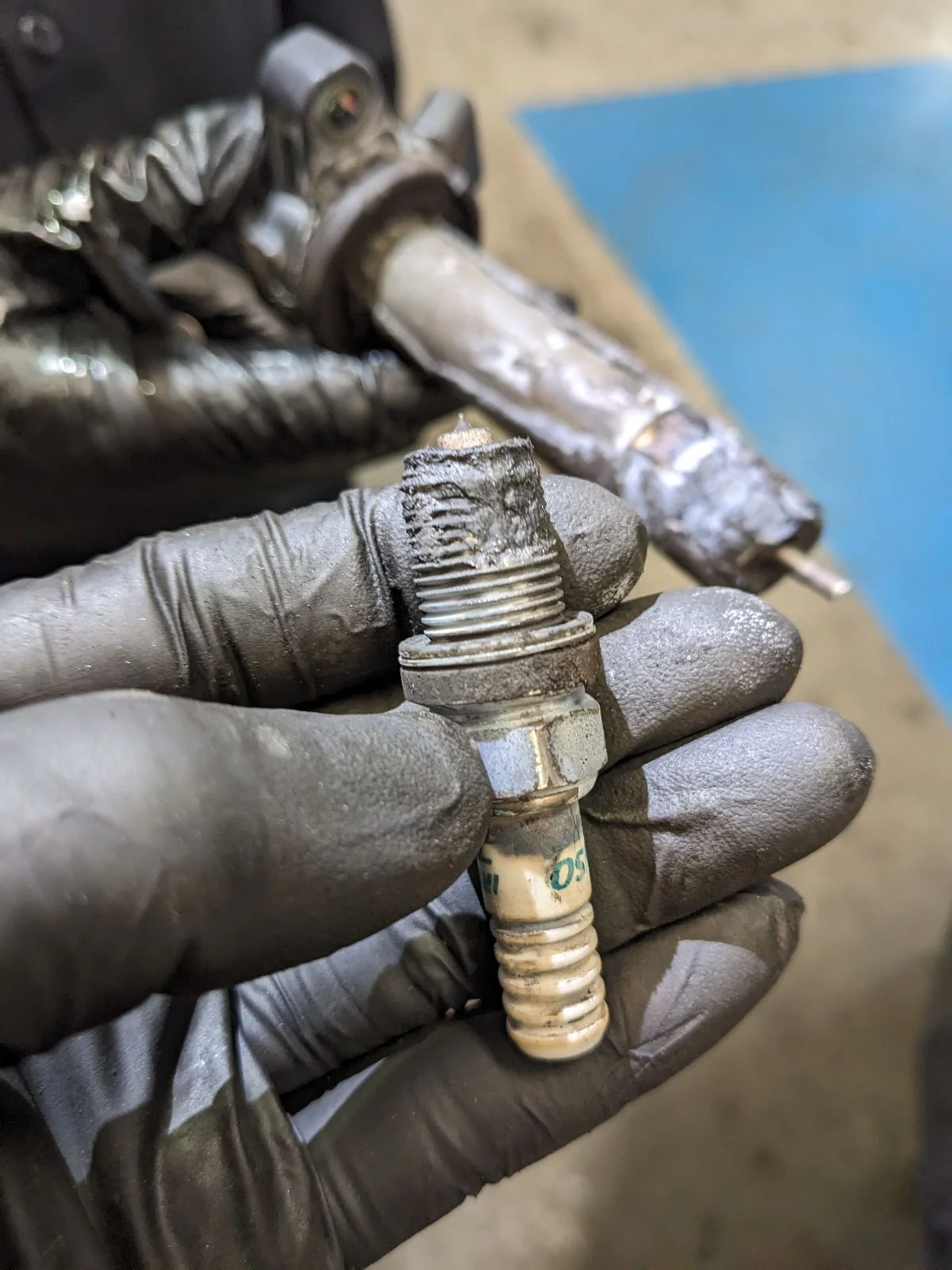

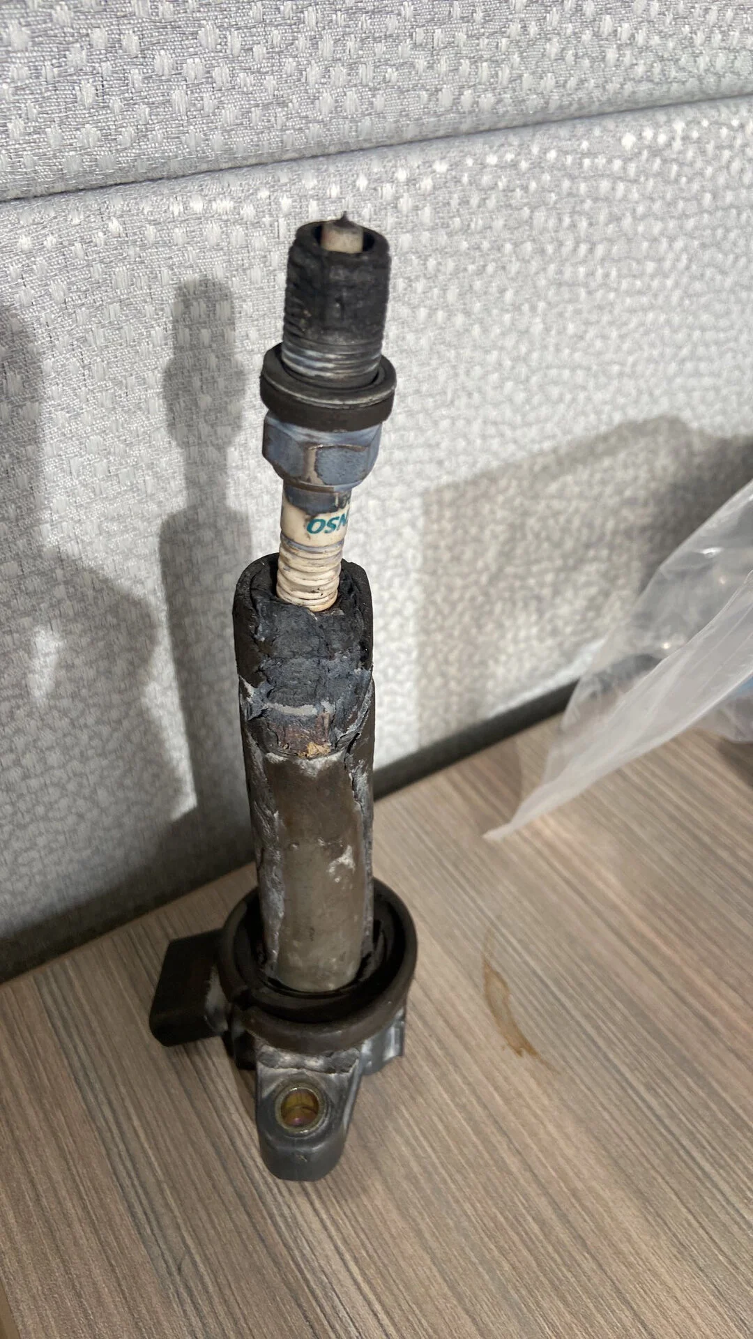

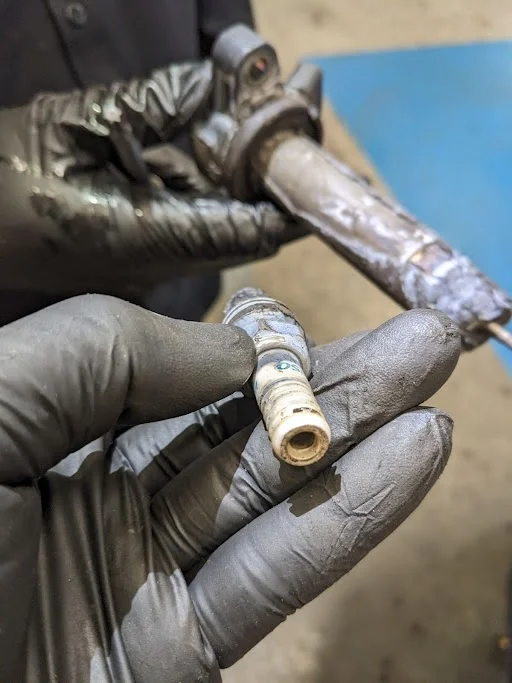

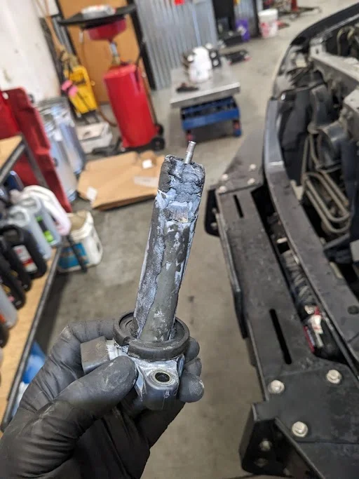

Immediately after I finished the front-end rebuilds and got brand spankin new Nokian tires mounted, I blew a spark plug out of cylinder 7. I had it towed directly to a mechanic once it sounded horrible and they found the damage (see pics below). Note the tip of the spark-plug fell into the cylinder. Owner of the shop has a built 100 series, but they aren't Toyota specific. Shop is recommending putting either a used engine in, or a reman from FVP Powertrain (FVP Engines & Transmissions | Underhood Powertrain | FVP Parts - https://www.fvpparts.com/products/underhood/powertrain/engines-transmissions). Their experience with FVP is favorable, and the reman will have 4 year unlimited mile warranty. I have found 2 other reman suppliers with 7year warranties.

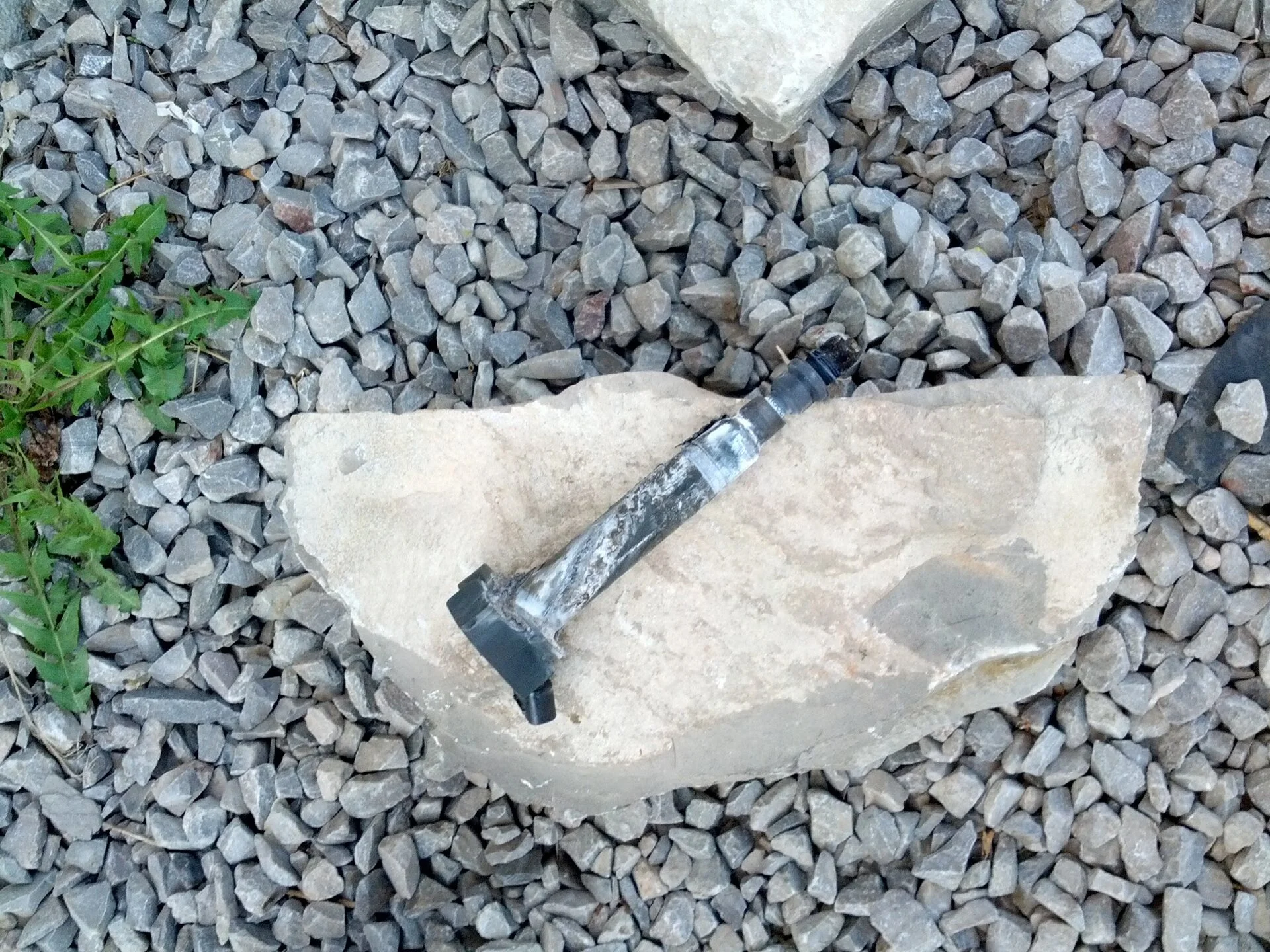

I had same issue.
Non OEM coil
Get piece off the motor and use helicoil. It has been over 10years and 100k miles and couple of spark plug changes.
If he doesn’t feel comfortable then find an RV place (they have done these alot on Ford motors) or a Ford shop.
No need to spend all that money.
Helicoil and peel out.

Like Bomar said, heli-coil or time-sert and go. Ford V10 owners have been dealing with for many years and most just throw an insert of their choosing and go. It's not a terrible job to do with the head on but it's better than pulling the head off, unless it's a must.
You'll get varying results for feedback on this, in the end it's up to you. You hav nothing to lose by at least attempting to throw an insert in and seeing what happens.
Like everyone else said borescope pictures of the cylinder will be the most revealing to see what damage the head of the spark plug did in there. If you decide to go with an insert I would only recommend timesert. Can’t hurt to give that a try and check compression numbers.

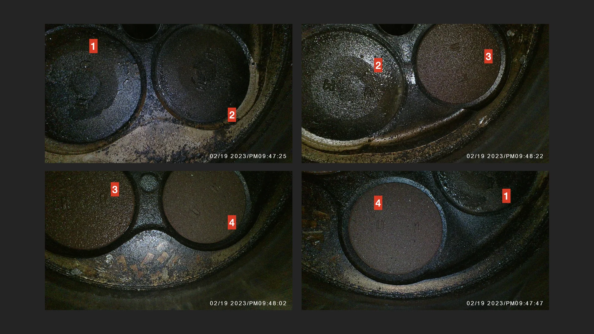

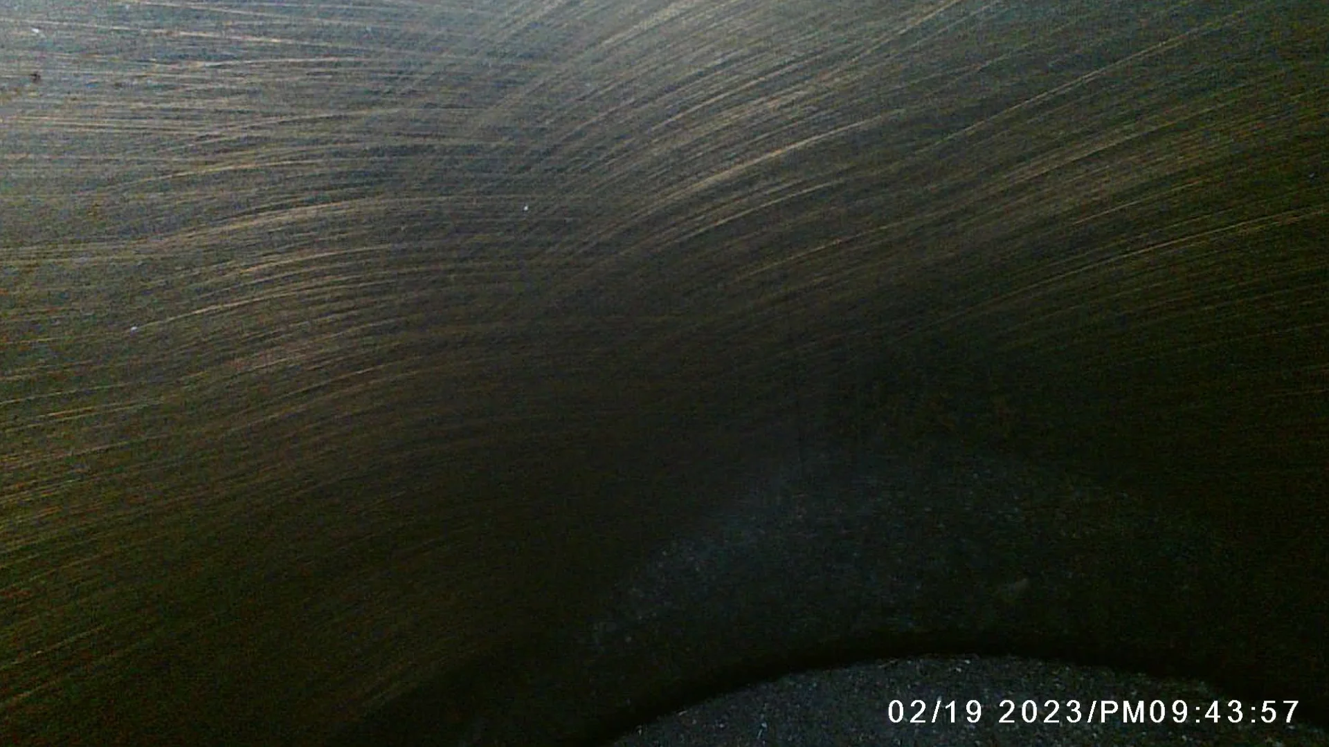

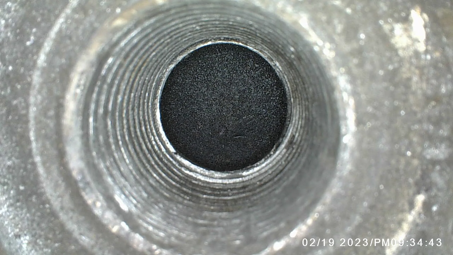

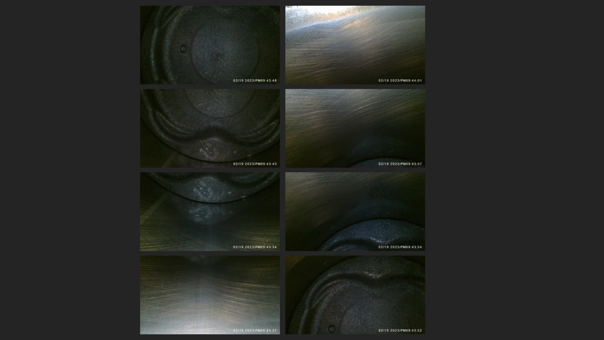

I ordered this scope Amazon product ASIN B0CJY5C9QX with an articulating head and took photos of the cylinder today. At 270k the cross-hatching is impressive!
Looks like metal piece dropped in, left some marks, and was ejected out the valves.
Now we're thinking that we just throw on a new head and fix the exhaust manifold leaks (R&R of both heads / manifolds). Agreed it might work to throw a spark plug in and drive off, but I want to set this up right to depend on the rig. Assumption is that threads in block are degraded.
looks minty, even the thread LOOK ok, maybe re tap? and run it
Maybe because I turn wrenches all day every day for the last few decades and just plain tired with little desire to work on my own projects, but I see nothing that would keep me from throwing some new plugs and coils in it and calling it a job well done.
The upper few threads look a little squared but a chaser could clean them up. Should hold torque just fine, if not then you know the next step. You have nothing to lose by trying.
