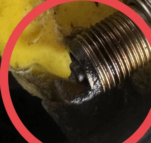

Triple-locked LX470 blew plug out of cylinder 7 at 270k. New engine advice?

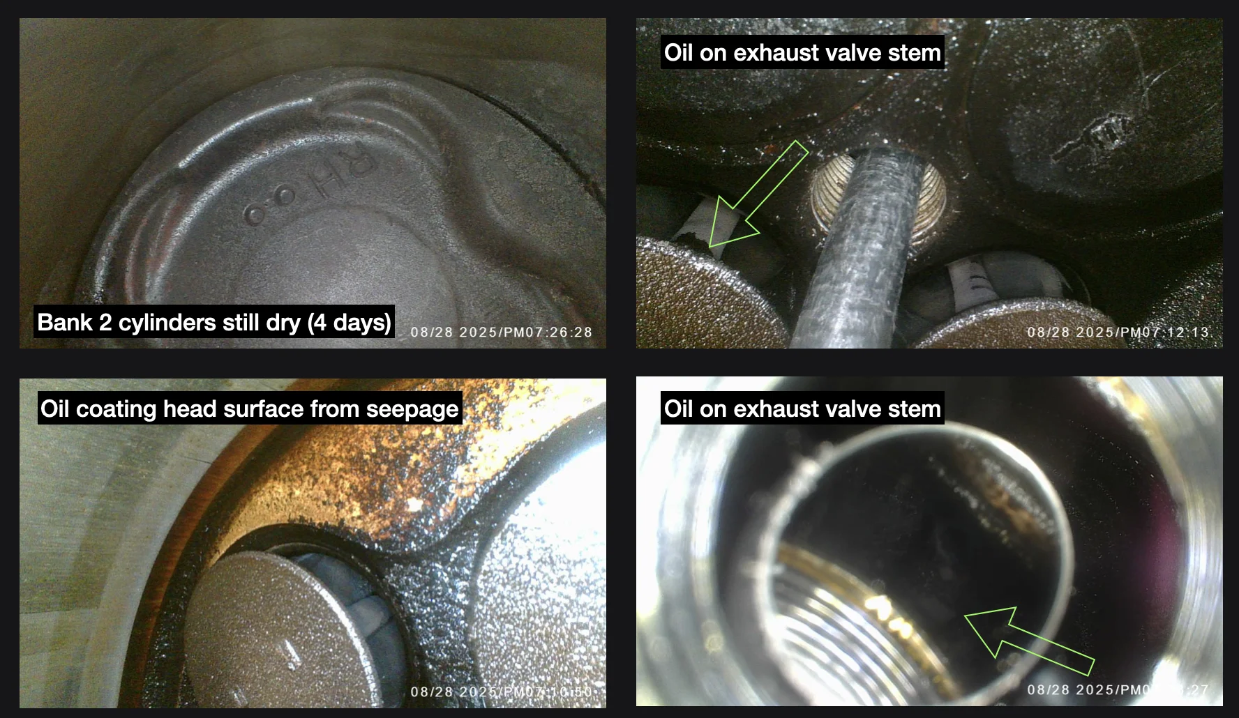

Update! Mechanic has agreed to put in new valve seals for me on the offending head. He reached out to the head remanufacturer and they won’t do anything because 12mo warranty expired. Really pleased that he's backing up his shops work. I ended up pulling the injectors to get some photos of the valve stems, pretty cool what you can see with the bore scope.
Also manually rotated the crankshaft to reposition valves so I could see on backside of exhaust valve stems.

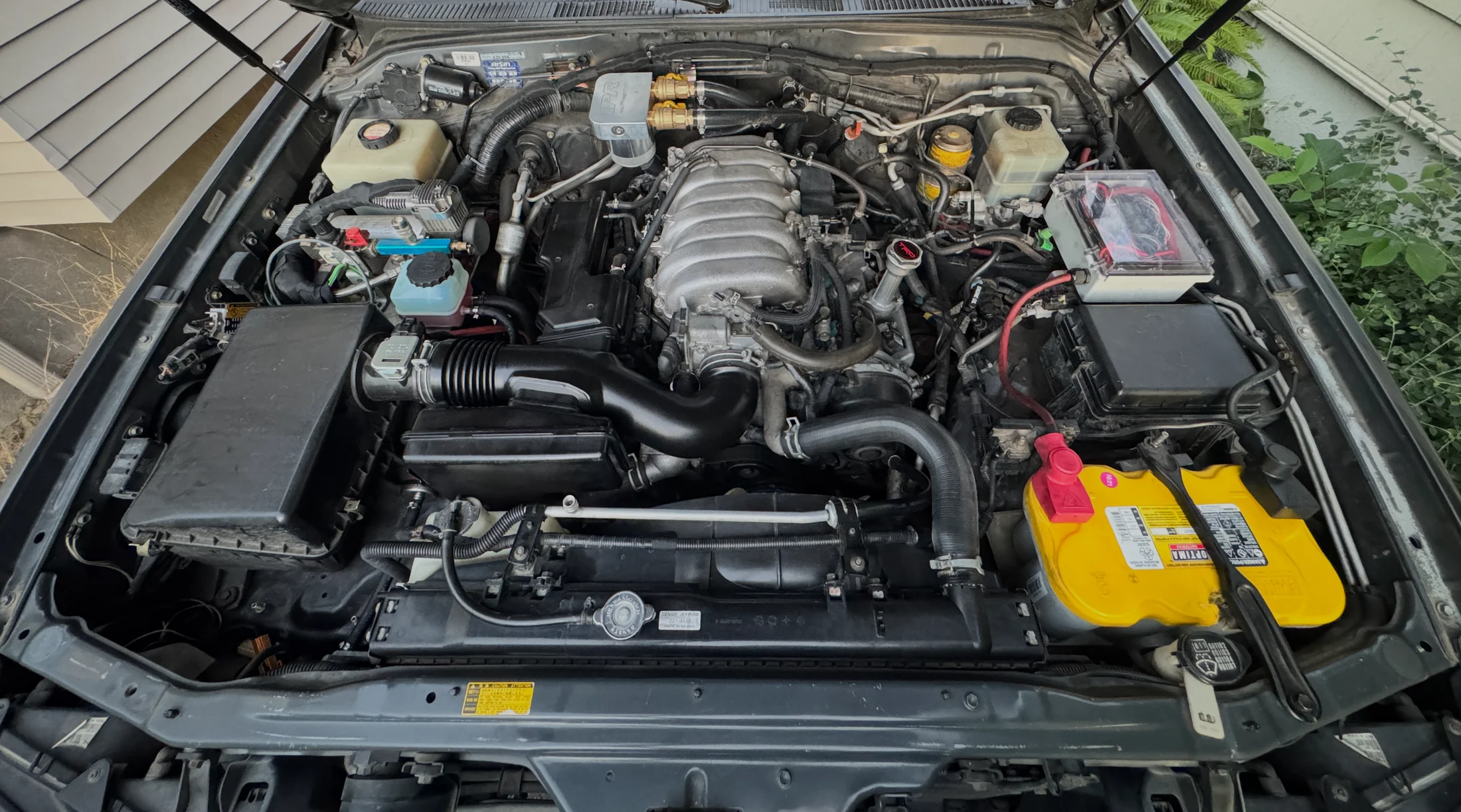

Addressed some comments above regarding my power steering as well. Its flushed now fully properly ... ok I put in a new pump too and an inline filter.
And new fuel pressure regulator / pulsation damper.
Off to mechanic in a week to get new seals!
