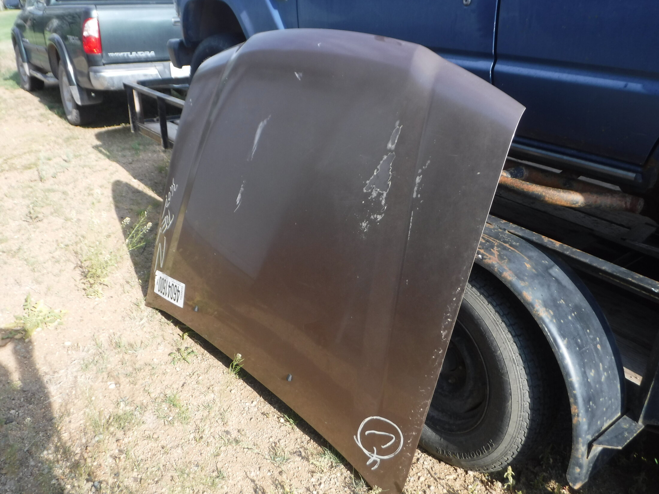

So I feel like I hit the jackpot.
While mindlessly meandering around the classifieds, I noticed something in the background of FS thread for a part out 2UZFE engine...
A 4P3 Desert Bronze metallic hood. I reached out and was able to pick it up from the seller of the engine ( @3_puppies )
It travels its first leg of its journey today...from Helena, MT to Bozeman, MT. Thanks, Drew!
Shipping it traditionally would have been cost prohibitive so having an option
that involves rock star mud members helping out is the only way this would have made sense.
Obviously not perfect, but SO SO SO much better than the current hood which has 15-20 hail dents and almost NO clear coat left.
Question for you guys:
What's the white paint (used by the wreckers, I assume)? What's the best approach for removing it.
Obviously, the sticker is razor blade and Goo-Gone territory.
It's my game plan to arrest the clear damage on this one by sanding it back a bit then re-clearing it.
I'm not looking for perfect...some patina that won't get worse is fine by me. I'll probably do the same
for the top shoulders of the front fenders as well and a couple other areas.
I have enough paint, though, that I can fully repaint the mirrors and door handles.

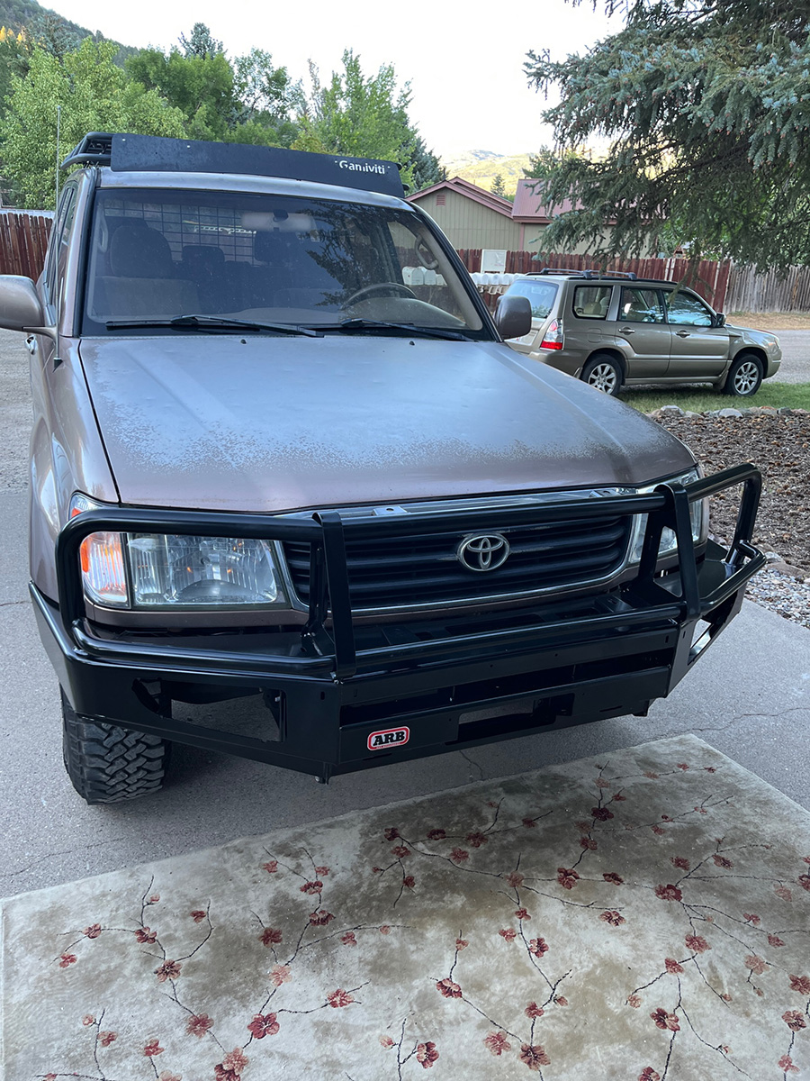

A reminder shot of the current hood...
I'd guess the white paint goes off when polishing/ buffing. Likely a kind of sharpie?!
Or you just wet sand with 2000 grit and polish over afterwards
It looks to be fat tipped paint pen - I'll test the acetone on a small portion to see. I want to lift it up and off, as opposed to taking the risk of spreading it around...we'll see.
