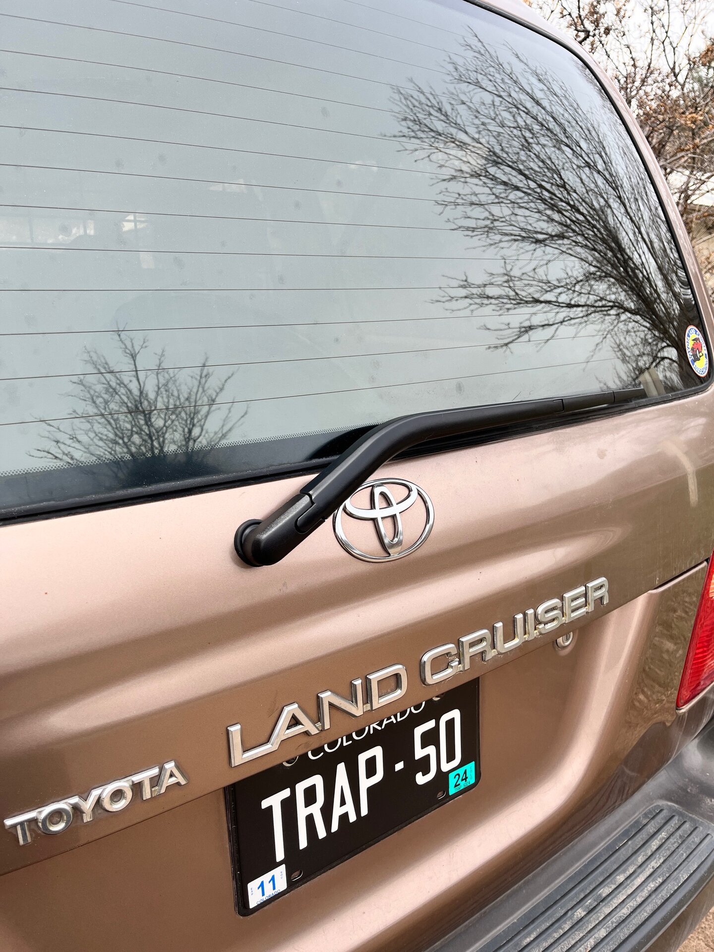

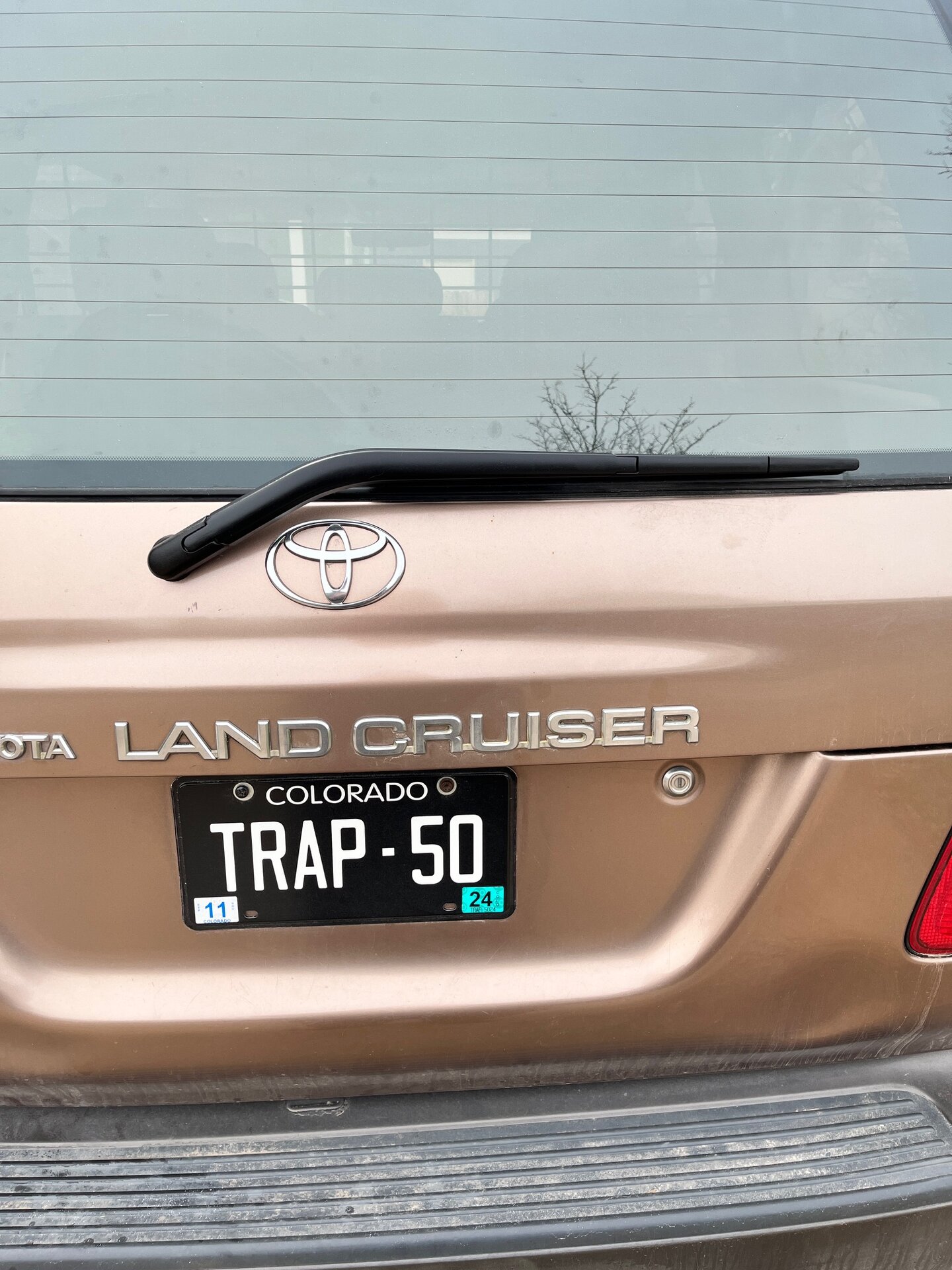

New rear wiper arm and blade - JDM "Prius" mod
Thanks, @cruiserpatch !

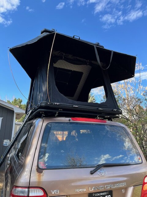

Man this looks spliffy! I may have to get this on the list of things to do....
Nice find! You'll never go back to a regular tent after this.....! :)
I like the sentiment and the comment...
The RTT is for the wife and kid, I'm too fat to get up and down that ladder
and I can't sleep anywhere near my wife...she SNORES loud and can fall back to
sleep after being woken in less than 10 seconds.
I have a Gazelle T3X Overland Edition pop-up tent and a cot for myself. :)

How was the packaging from shipping? Also, did you have to have a lift gate truck or did it deliver in a regular UPS truck? Looks great!!
Packaging was good...there was a dent on the roof but not a biggie for me.
I get the feeling it kind of flummoxed the UPS guys because a manager made a special trip
in an otherwise empty regular/small UPS truck and needed me to help get it off the truck (178 lbs.)
It was protected by:
Plastic corner armor
foam sheet inside
thin particle board inside
wrapped in plastic
It sat on the side of my house in the box over the winter and while there was a little mold
on the thin particle board, none made it's way to the exterior or interior of the tent.
All in all, very impressed with the quality of the fabrics, stitching, sleeping pad, shell seal and hardware/accessories.
It's literally the exact same footprint/size as the Gamiviti roof rack
Quick question for anyone reading...
After mounting the RTT, the rear went down a touch and it seemed like the front came UP a bit
At least my measurements of the front hub to fender number climbed to a little over 22" to maybe 22.25"
So I had lost most of the "forward rake" that 100's like for handling and driving out.
I got underneath and brought the front TB bars down to just under 22"
So the question:
Do I need to get it re-aligned?
The alignment was performed w/o the RTT and the front number right at or just barely above 22"

In theory, no. Since you returned the front ride height back to its original setting then the geometry should follow.
Could the geometry change too, yes, but by very little if any. Learning how to do a simple string alignment will allow you to
make all the changes you want without having to pay constant alignments or worry about wearing out a set of tires.
You can always use your cell phone to get a camber reading and compare to your recent alignment printout. If your camber is on or near on the money then the toe will be ok too.
