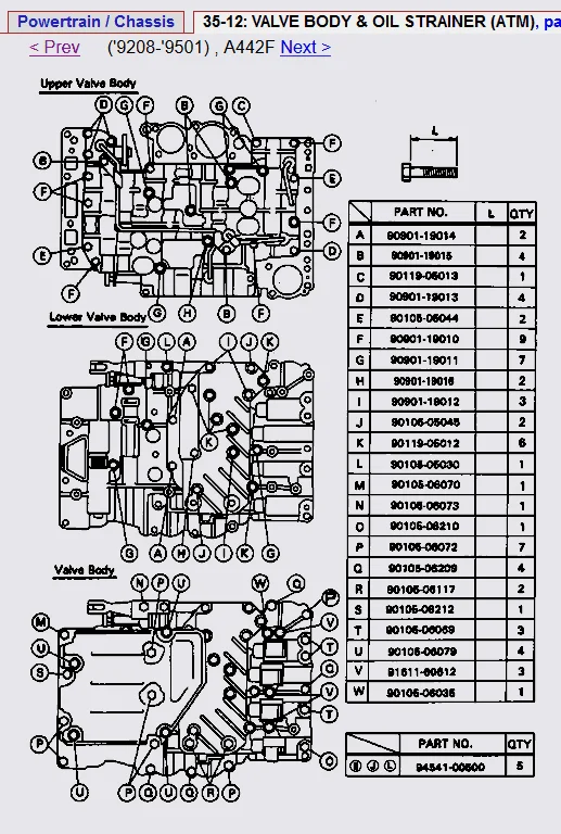

Automatic transmissions are black magic. All you have to do is look at the collection of bolts to attach the valve body.
It's easier to let the smoke out of an automatic transmission than a Lucas wiring harness.....:doh:
Screenshot_2019-03-16 35-12 VALVE BODY OIL STRAINER (ATM) diagram, 1993 TOYOTA LAND CRUISER.webp
