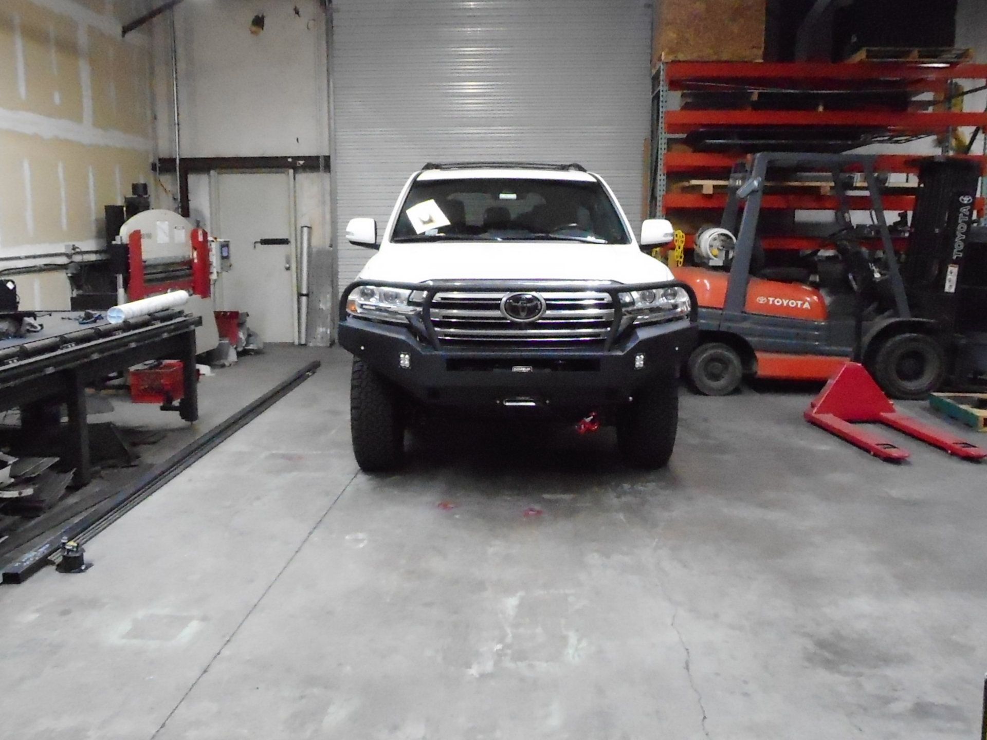

Who’s rig is this? License plate says San Clemente (15 minutes away). I’d love to check it out.
They are in San Clemente. I'm not sure if they are on MUD though. I'll contact them and see if they'd be cool with a drive bye, etc.
I contacted the customer and they gave me the okay for you to call them to come over and play.
I'll PM you the info.
