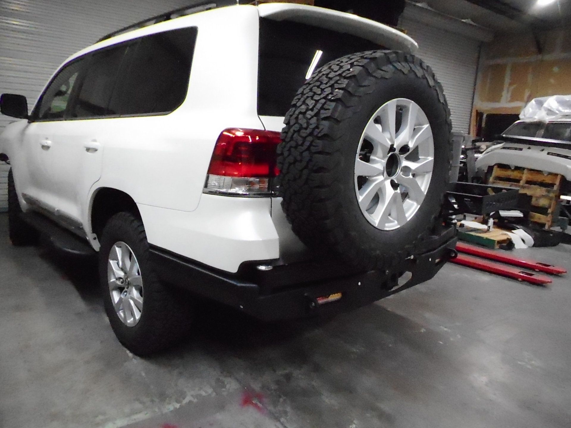

I had a customer back out on a 200 rear (due to moving out of the country) so I have contacted my buyer to see if he will allow me to sell this rear. If not, if will be chopped up and scrapped. But, there may be one available in a few weeks for sale.
Jason
Jason

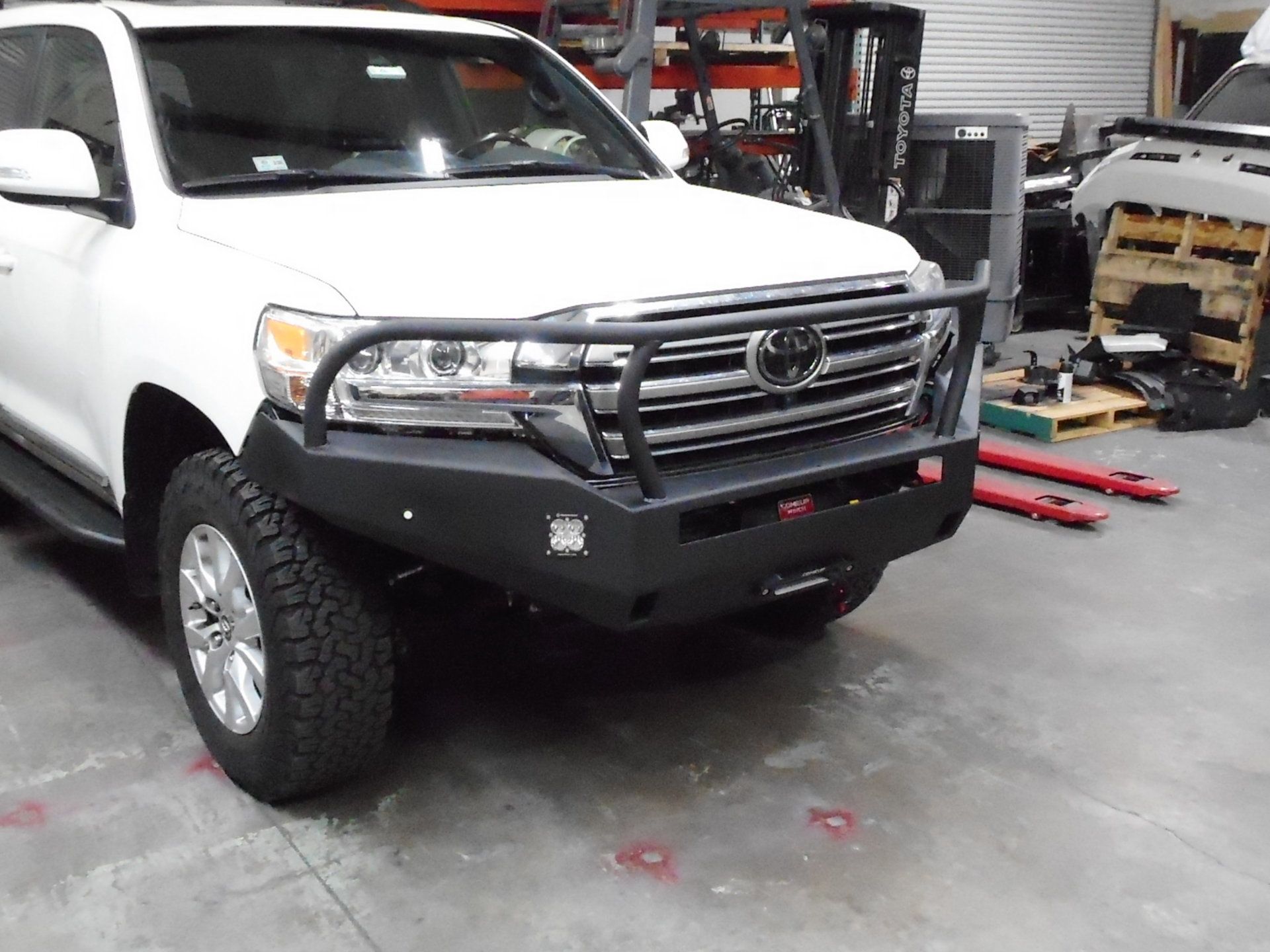

About an inch on clearance, maybe a tad more is correct for this bumper. Sounds like they jacked it too high trying to meet a statement that has nothing to do with my design. Loosen all the bolts and let it down slightly and that should take care of this. In pic below you can see the tabs are about 1/8"-3/16" above the bumper. You'll be close on bumper to main body of the light as well. maybe the same gap as tabs.

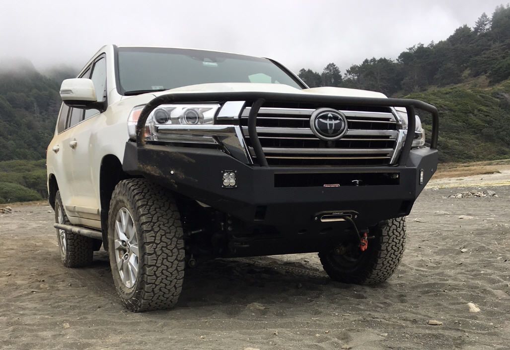

Thought I'd update on my setup.
  • 5,000 miles on the bumper including trails in Telluride/Ouray, Hovenweep, and Big Bend and one winch recovery and it's working out well. A couple hundred miles of washboard roads as well as tons of hard highway bumps and the gussets and reinforced welds on the factory bumper frame mount are holding up nicely.
    • I know Jason wasn't worried but after hearing of a few issues with the VPR bumper as well as the original Toyota OEM bullbars in Australia I thought a second method of securing it would be additional peace of mind. I picked up a couple 8" long 5/8" grade 8 J-bolts and was hoping to run one through the frame and bumper, similar to what ARB/TJM/Ironman do, but the inside of the frame is too narrow for them to fit. Ah well. Maybe in the future I'll see if I can source or fab something similar to what they offer, but for now everything is holding up well so I'm not too concerned. If anyone has a use for these bolts and nuts let me know as they were expensive (for bolts)
  • Parking sensors are in. I found I had to break off all the plastic clips from the retaining ring *except* the top one. Once I did that the sensor snapped in easily. The side/bottom tabs would get squeezed inwards and prevent the sensor from inserting fully. Sanded with some 120-grit, primed, and painted to match.
  • I bought some inexpensive windshield washer from Amazon, drilled a couple 3/8" holes, and plugged them in. They work, though the shoot kinda low. I may look for some adjustable ones in the future, though to be fair I really don't use them.
  • I think I mentioned this before but I had loosened the bumper bolts and attempted to adjust and then re-tighten them, but it didn't make a significant difference on clearance with the headlight... maybe 1/16" tops, probably closer to 1/32". So I took a dremel to the bumper and notched it a bit where the headlight juts down in close proximity to the bumper, then touched it up with some oil-based rustoleum. While I didn't have any issues in Telluride or Big Bend, it does look like there's some slight rubbing of the bumper against that lens "tab" as it was slightly "blemished". (Side note: I did look at @indycole's bumper in Telluride but the 2016+ lens is different and there's way more clearance). I don't have a photo of the notch but if anyone is interested I can remove the bulb trim and snap one. I tried to follow the line from the wing so there's only one off-angle cut and it almost looks "natural"
  • 3/4" bulb-style trim installed around the bumper. It looks fine by the quarter panels but under the headlights I'm not entirely crazy about the look as it's not flat so I may just remove it. I'm open to other ideas if anyone has any.
Overall I'm happy with the result now. I know TonyP said he hadn't had any issues wheeling with it, but I still think the bumper should be notched for clearance. Granted I'm not a certified engineer, just a guy who is OCD about his truck.
