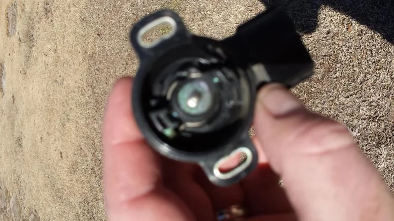

When I first experienced intermittent problems (every 6 months or so only in bad weather) I was hesitant to change the part too. Especially when it wasn't clear that a new part would not have the same issue.
But then the thing had a habit of failing intermittently but only when my father-in-law was driving the truck hauling my kids around. I was then forced to fix the problem in a permanent way.
I did a destructive look into the old unit and found that the sweeping contact points had left streaks of copper across all the contact pads on the dial that might have been shorting out. No other obvious failure point could be seen but opening the sensor had resulted in a lot of very small pieces so it was hard to say what the problem could be.
